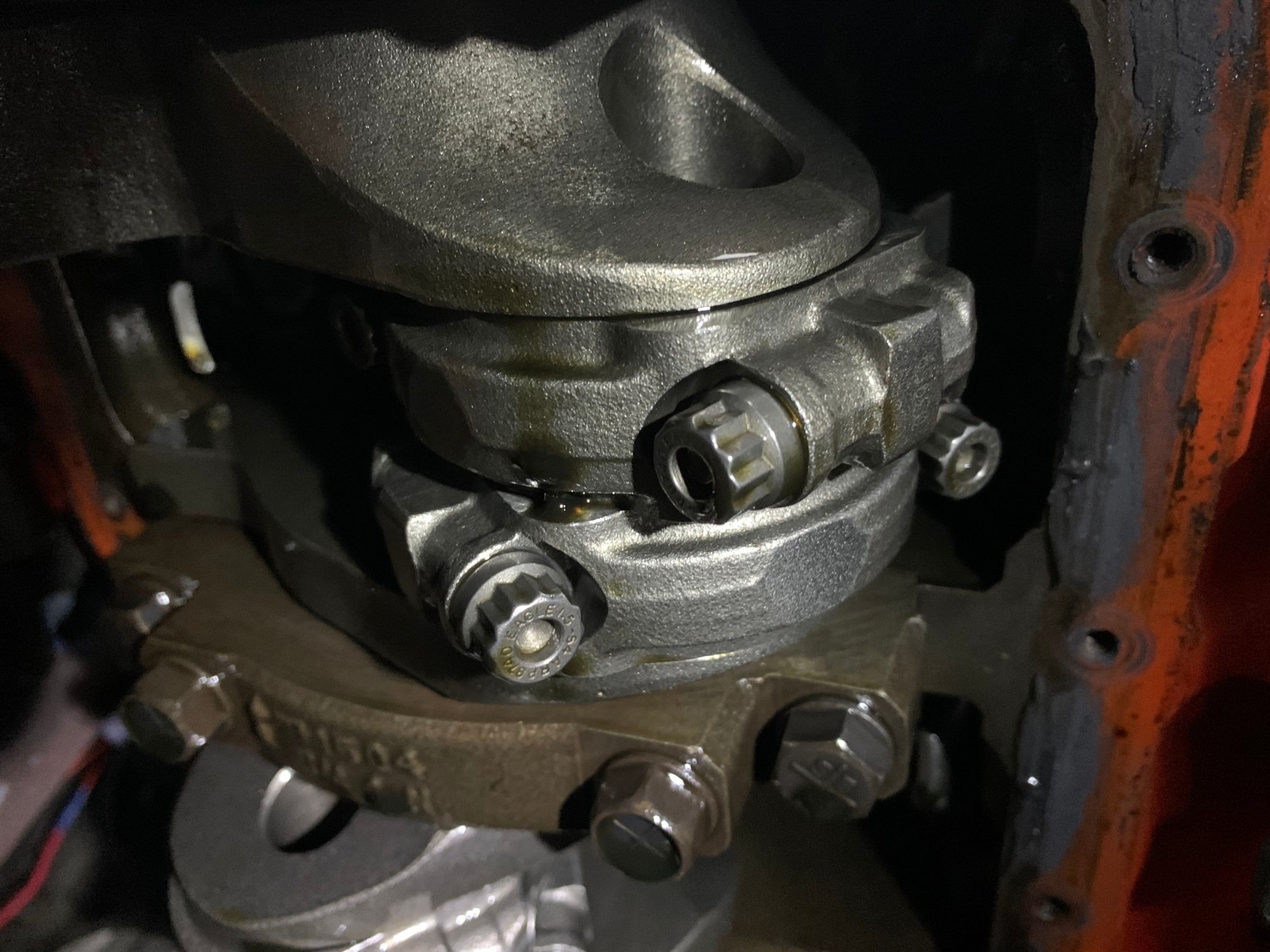

So I decided to take a whack at swapping my tire old Frankenstinian creation for a performance 400. I have no ideas what to expect from the new/used engine.
In preparation I already threw off the intake that looks like it’s too big and wouldn’t fit under my hood anyway. My Edelbrock EPS took its spot.

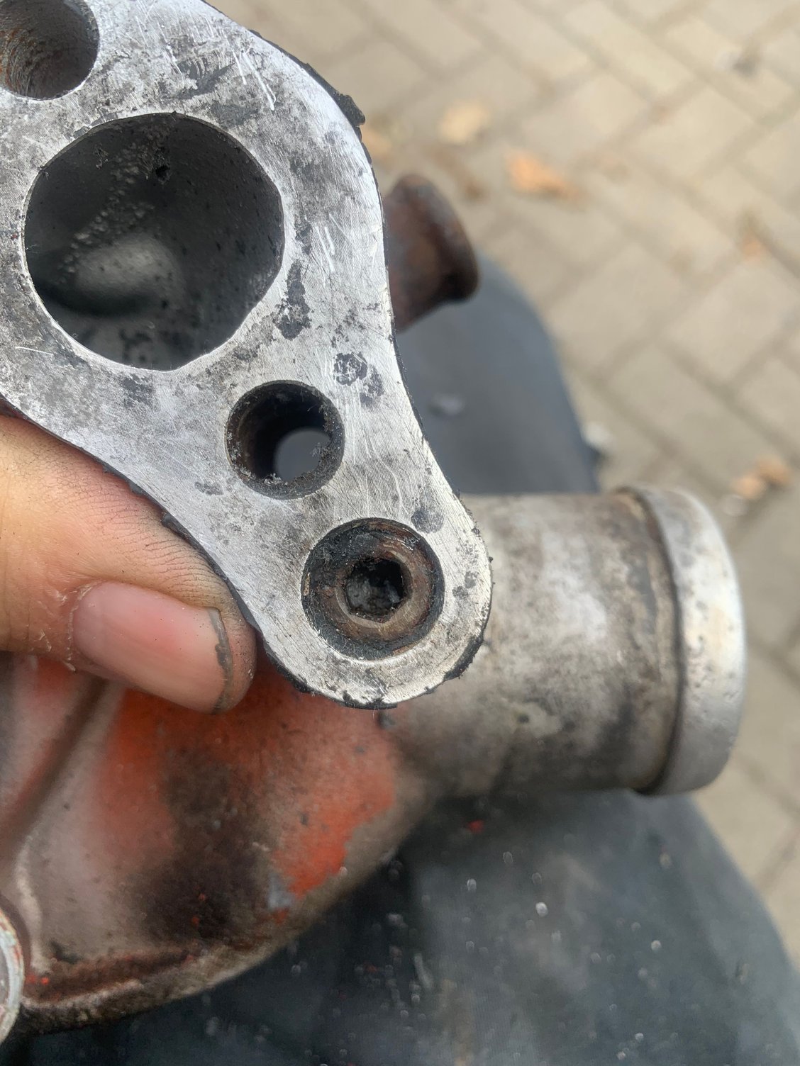

I also pulled off my water pump and, Bubba strikes again...
I discovered that the bypass was plugged. Not sure what this would have as effect but I have had problems purging the coolant circuit. It has never been working to my satisfaction. Perhaps this is why.

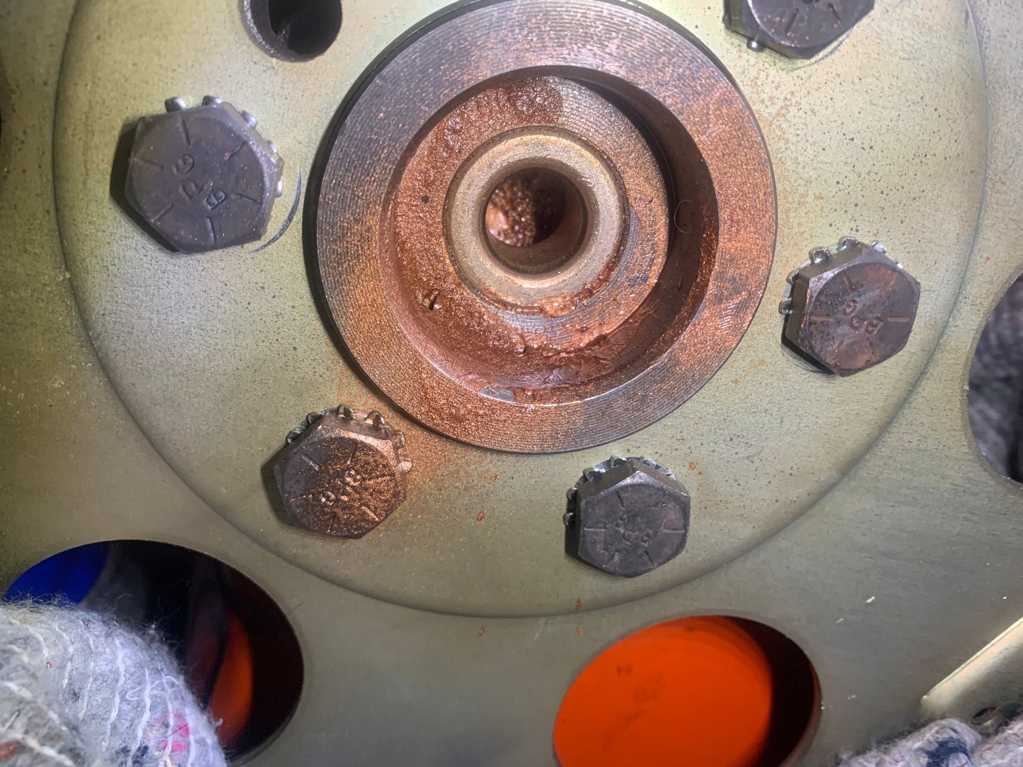

Tried freezing the pilot bearing overnight before pounding it in; that worked quite well.

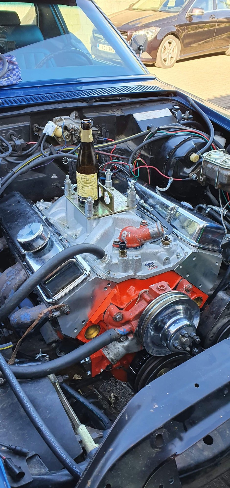

Made some progress
Old, tired 350
Out it goes.
Swapped over transmission
In goes the new.
And a well deserved Karemliet beer

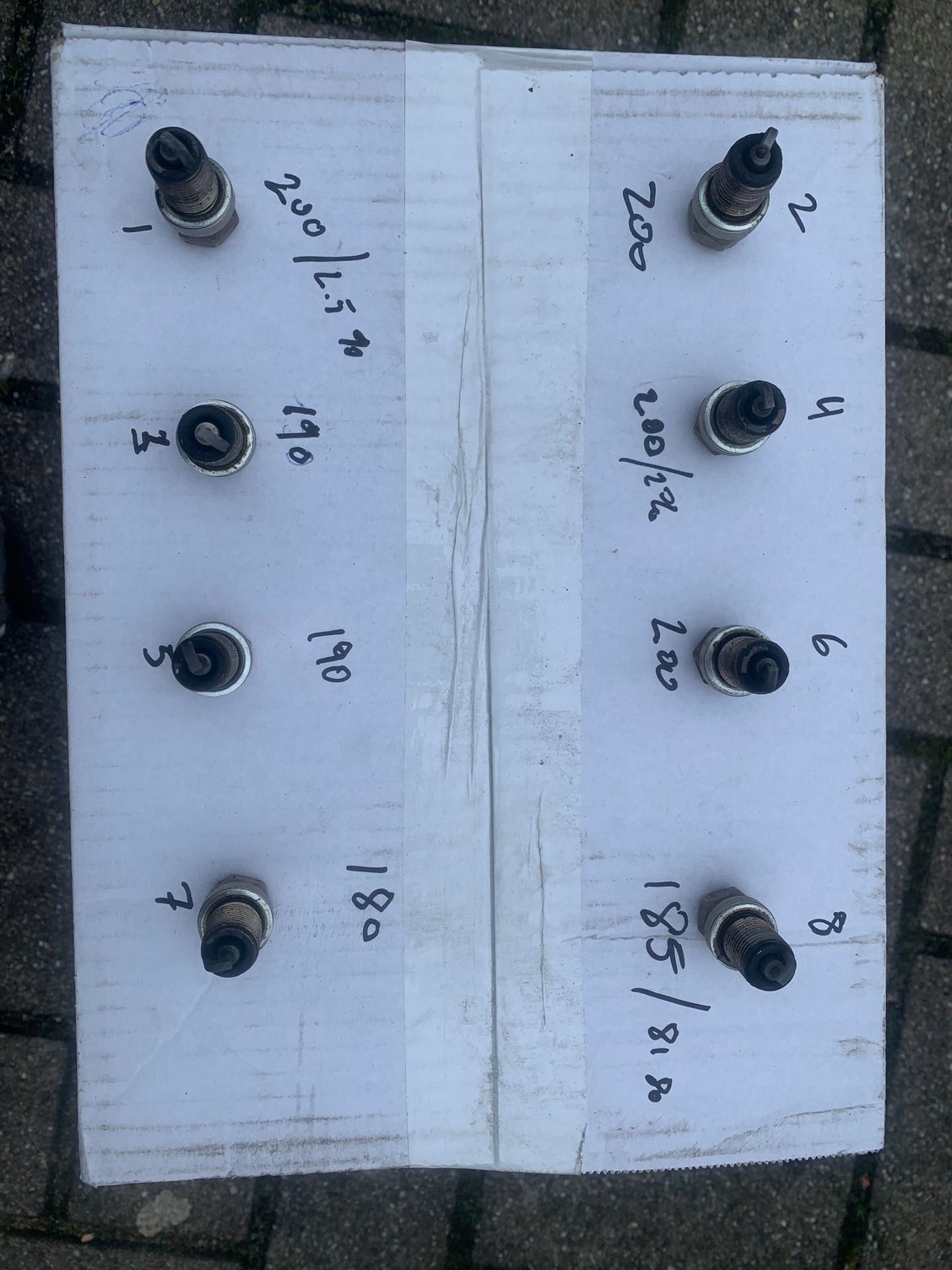

The oil pressure is good. At operating temp I get 35 PSI at idle and close to 70 PSI up in the RPM. The exhaust is clean. The plugs looked clean. I did not check the compression because at this point I am quite sure that this is a freshly built engine.

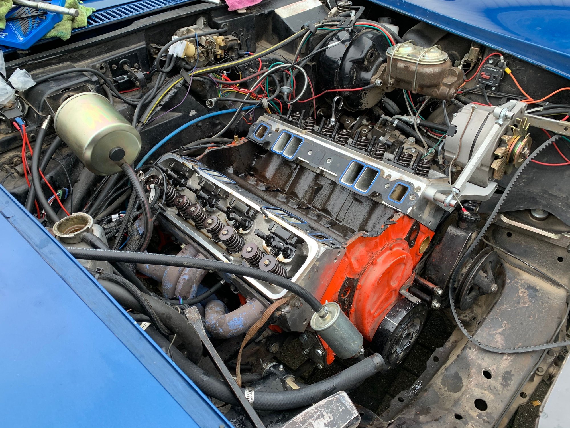

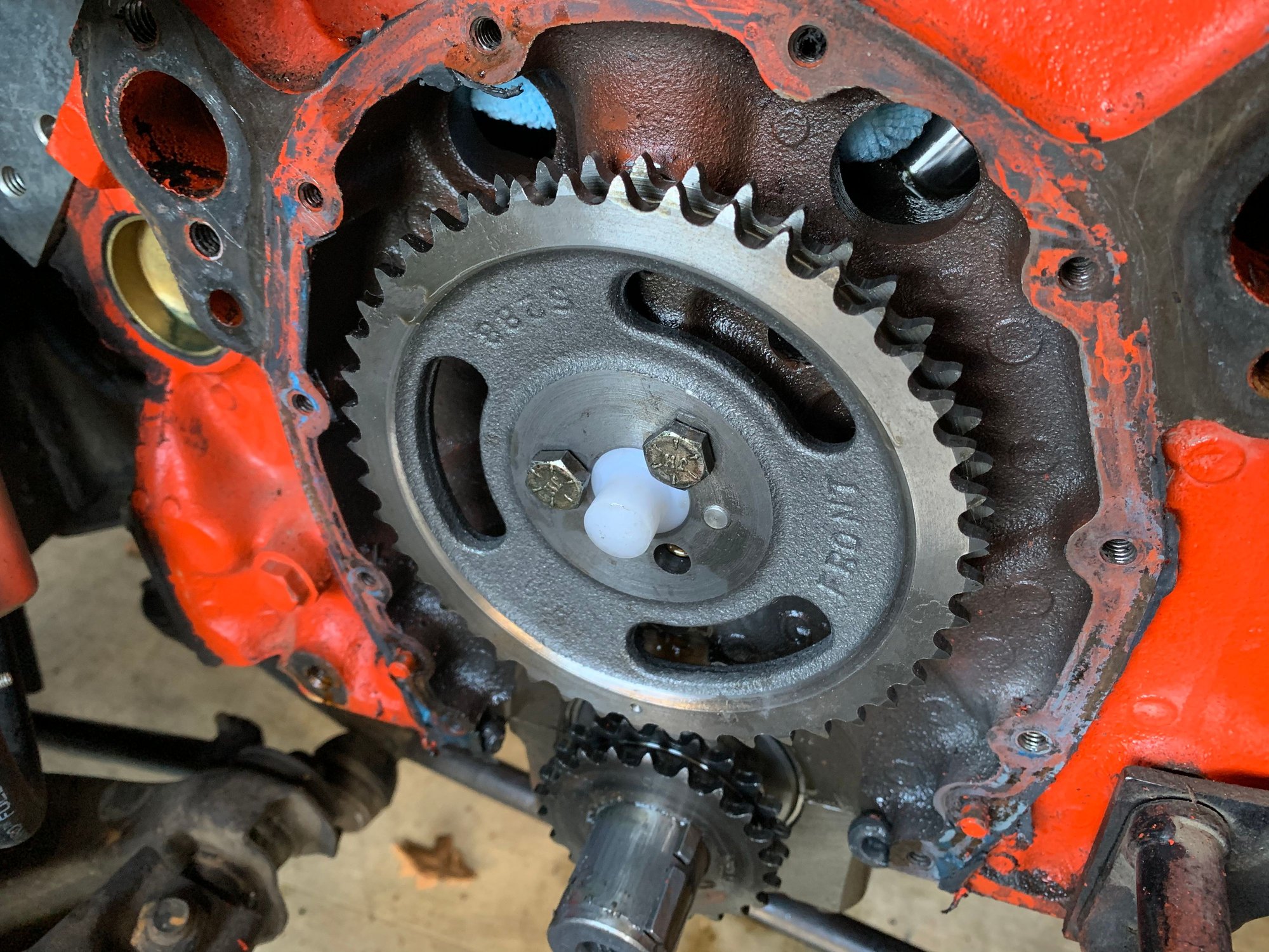

Mmmm. Came to the conclusion that the cam that’s in there (whatever it is) is too big for me.
Let’s go.
Mmm. Looks pretty fresh in there.

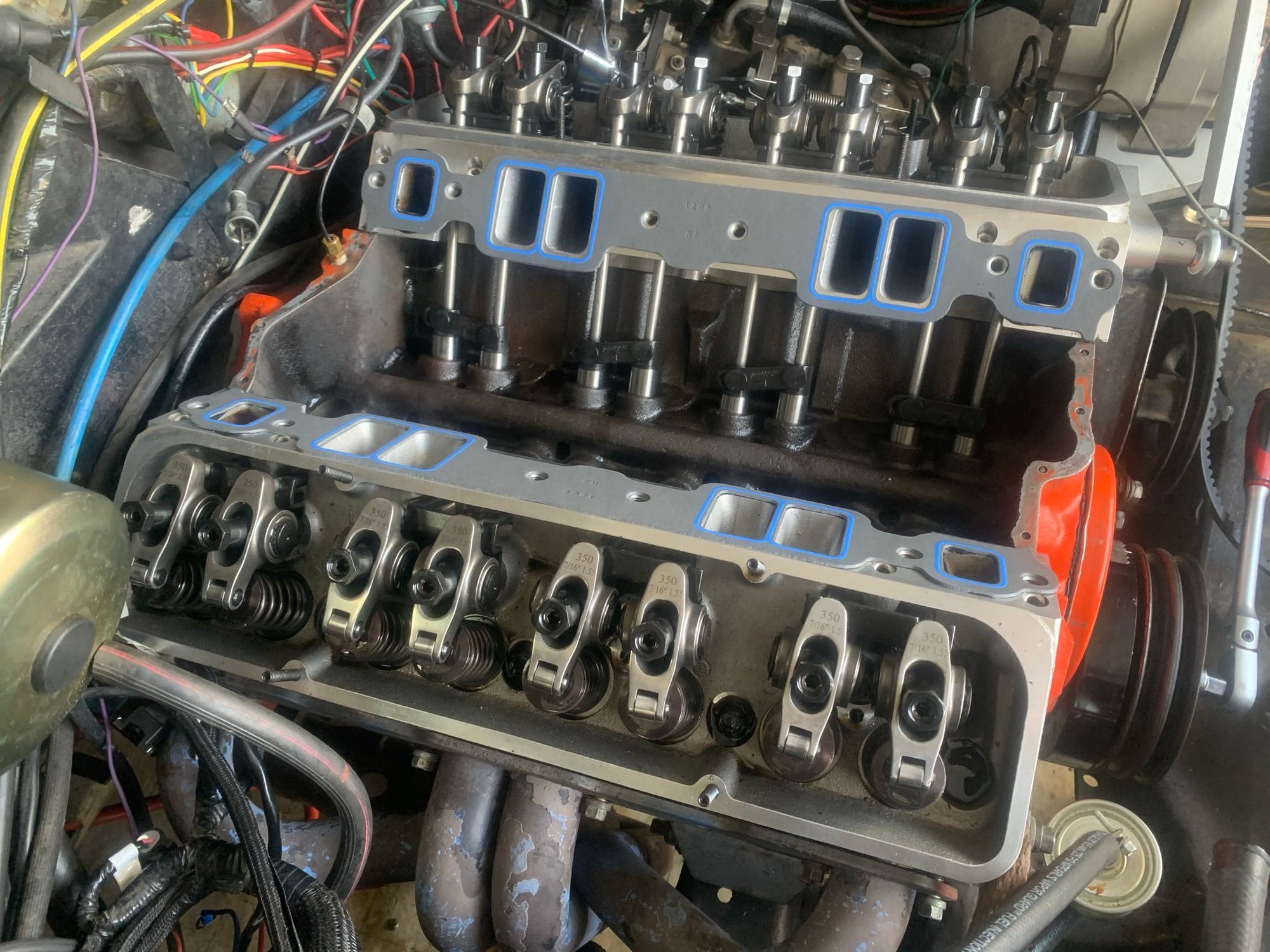

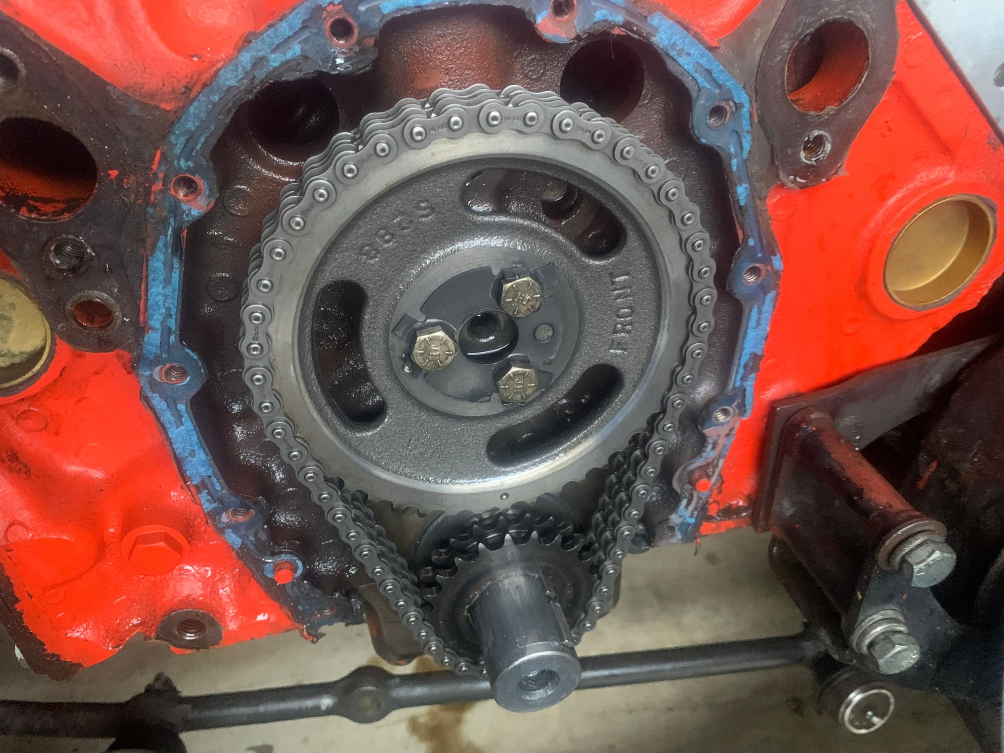

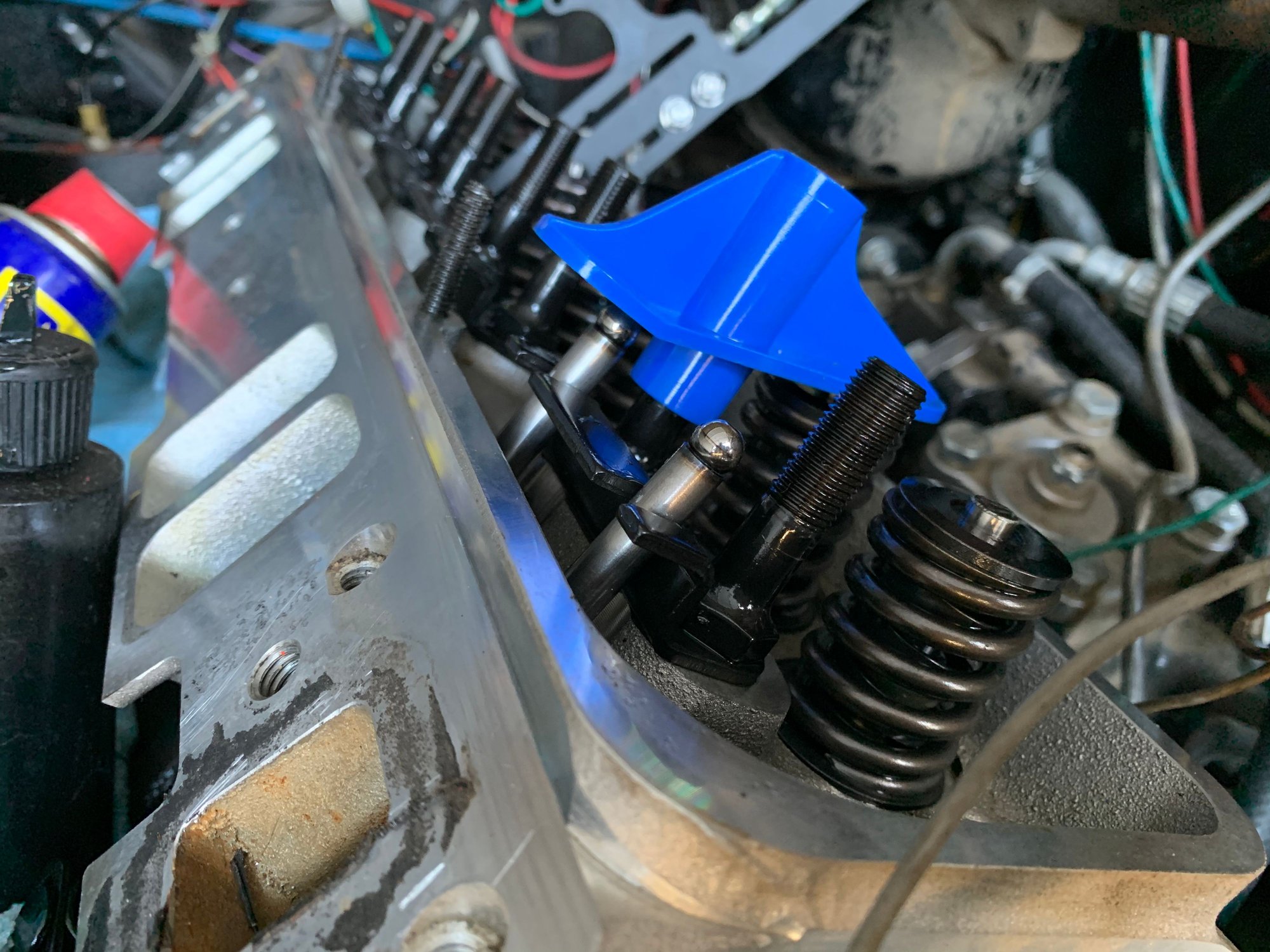

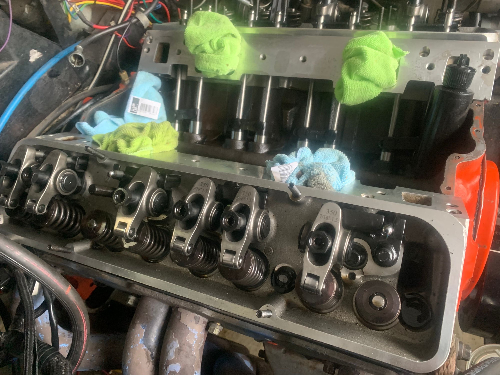

The new cam has arrived. I decided to go with a roller cam. My goal here is to match or slightly exceed the L46’s 350 HP and 380 TQ erring on the side of more torque.
This here, installed in my 400 SBC should do the trick.
https://www.summitracing.com/parts/CCA-12-422-8
Test fitting the cam button: spot on.
Checking rocker arm geometry: spot on.

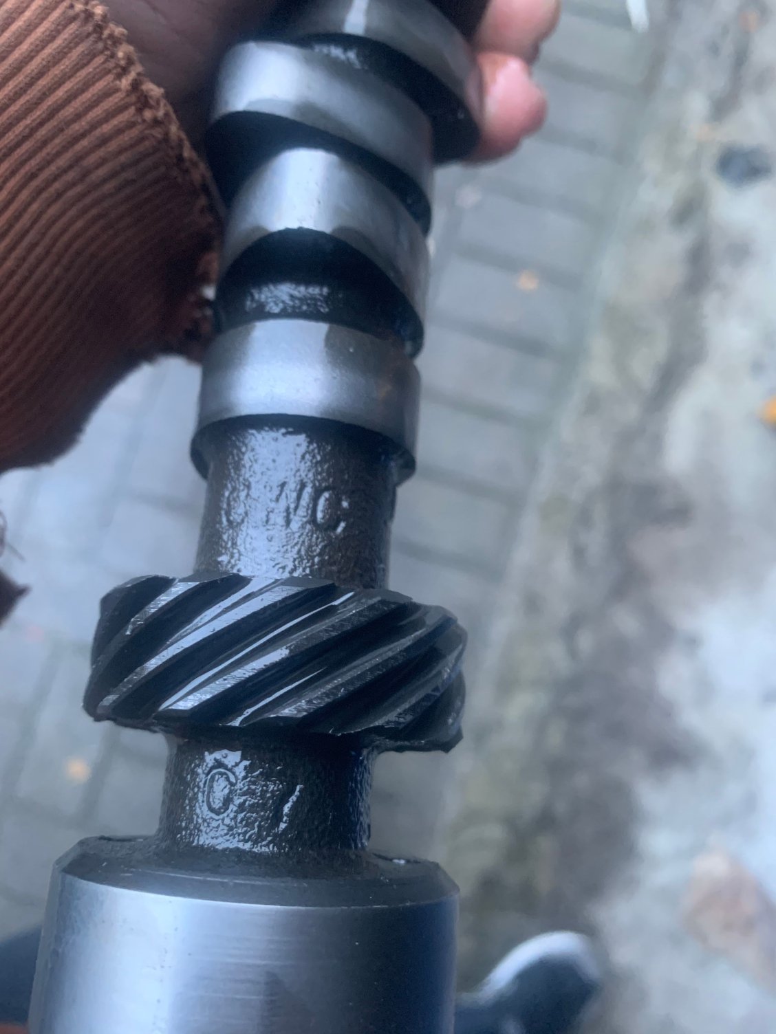

Dorian, have you determined who made the cam you removed?
"CWC" is CWC Textron, the largest maker of OEM and generic cams and cam blanks. CWC makes the cam shaft blank. It's then sent to the customer for them to grind.

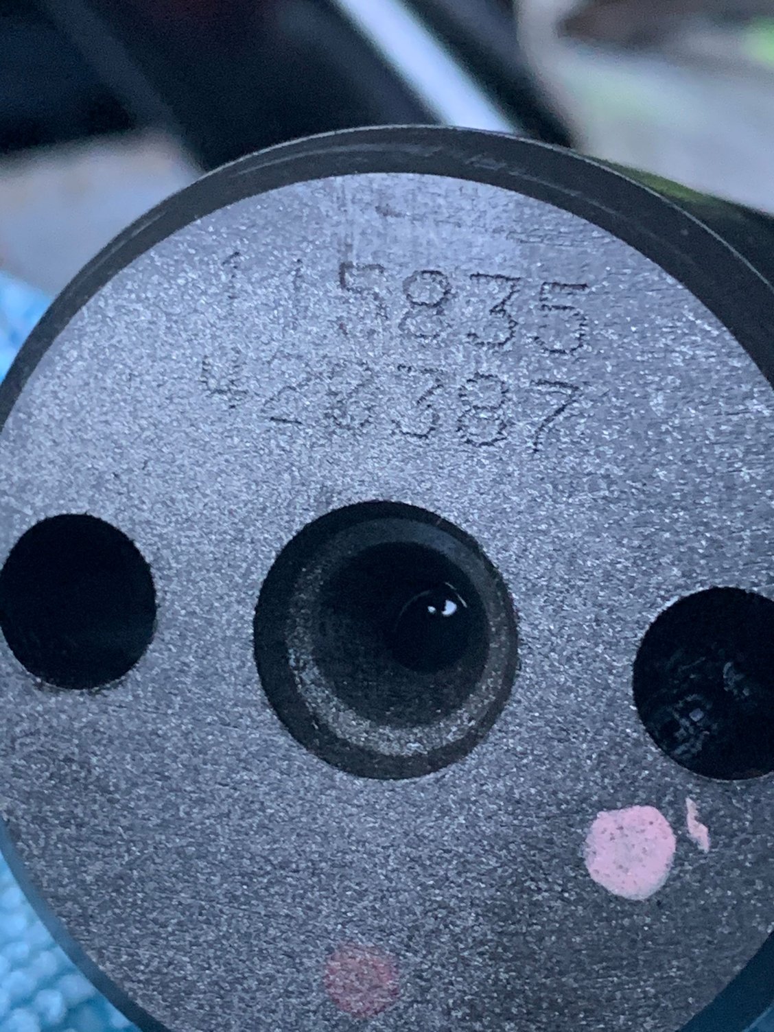

I have no idea what cam is in there. All I could determine by measuring is that the intake and exhaust were 0.480 with 1.5 rockers. My rockers are 1.55
The duration and LSA are unknown.

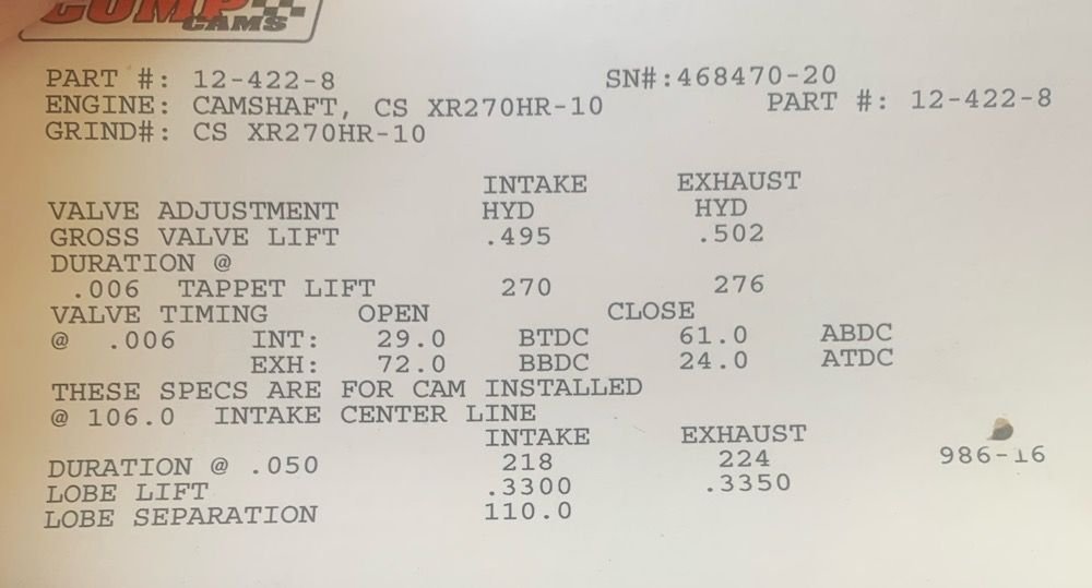

Below is the card of the cam I plan to use. It is a hydraulic roller.

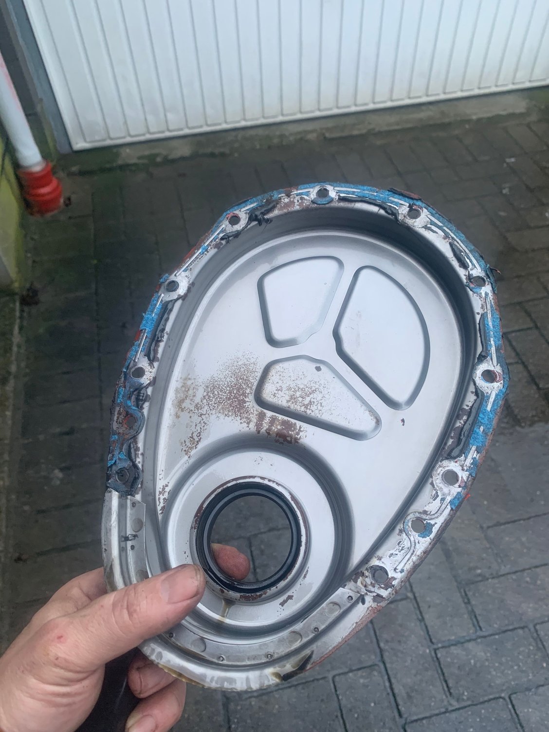

Two hours later
Not particularly flat. It will need more work.

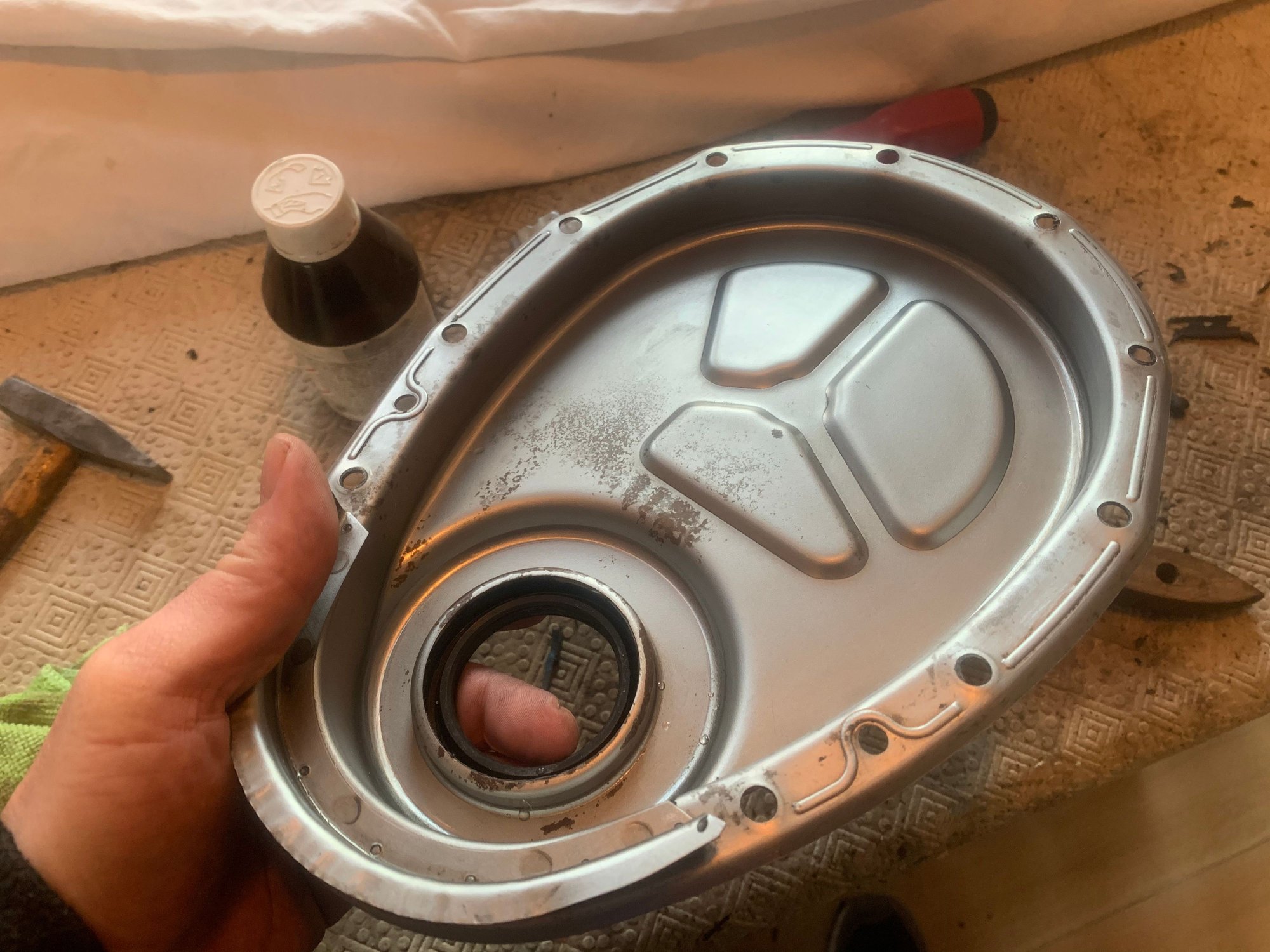

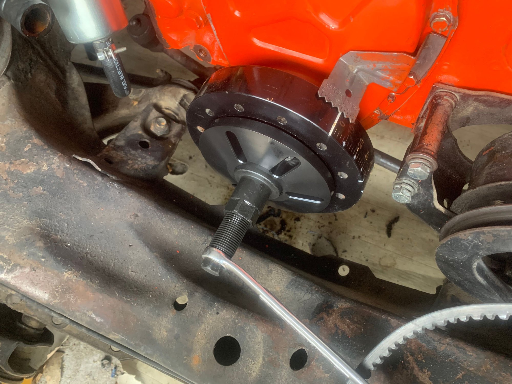

Easy does it...
Enough for today.

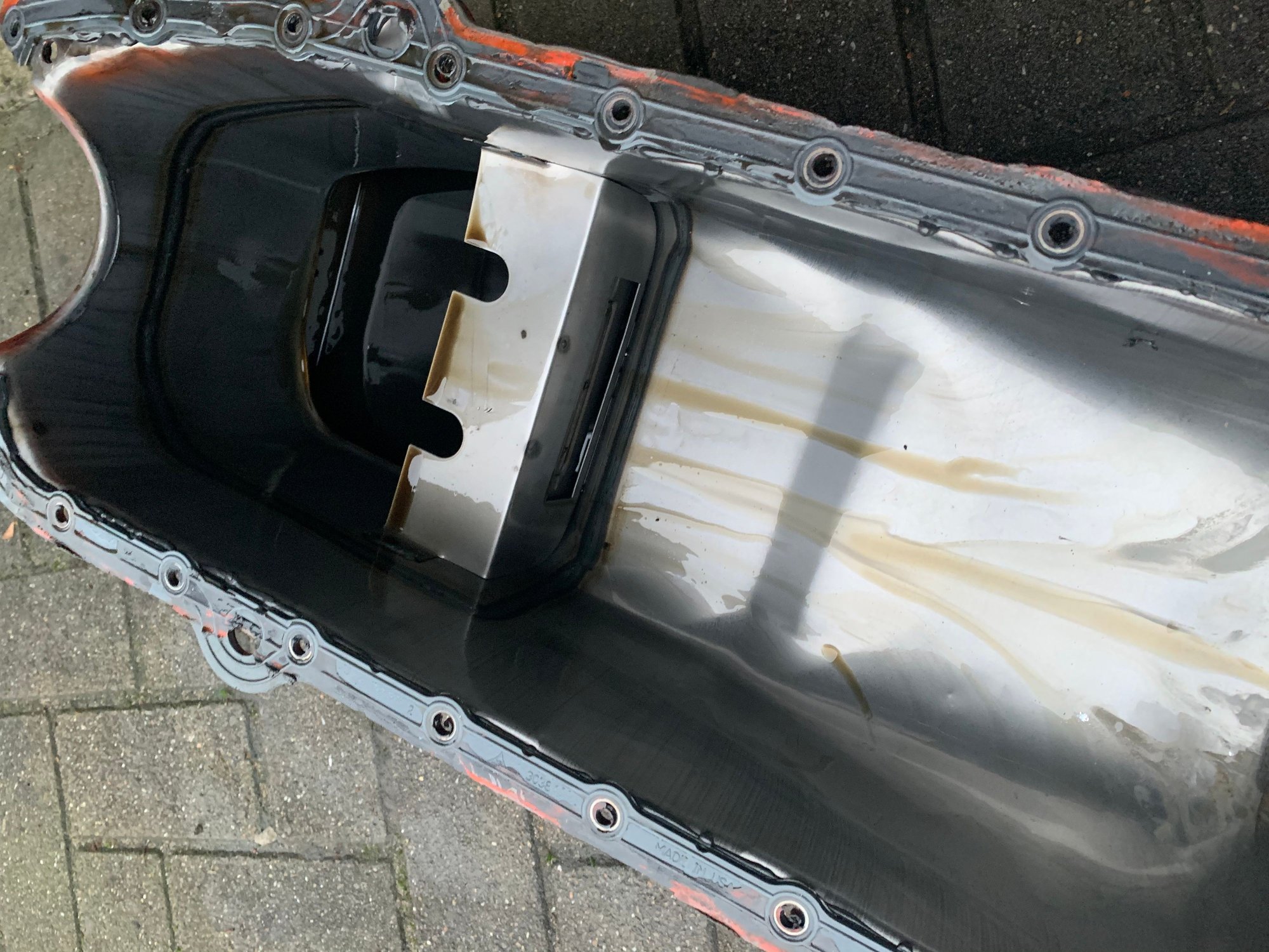

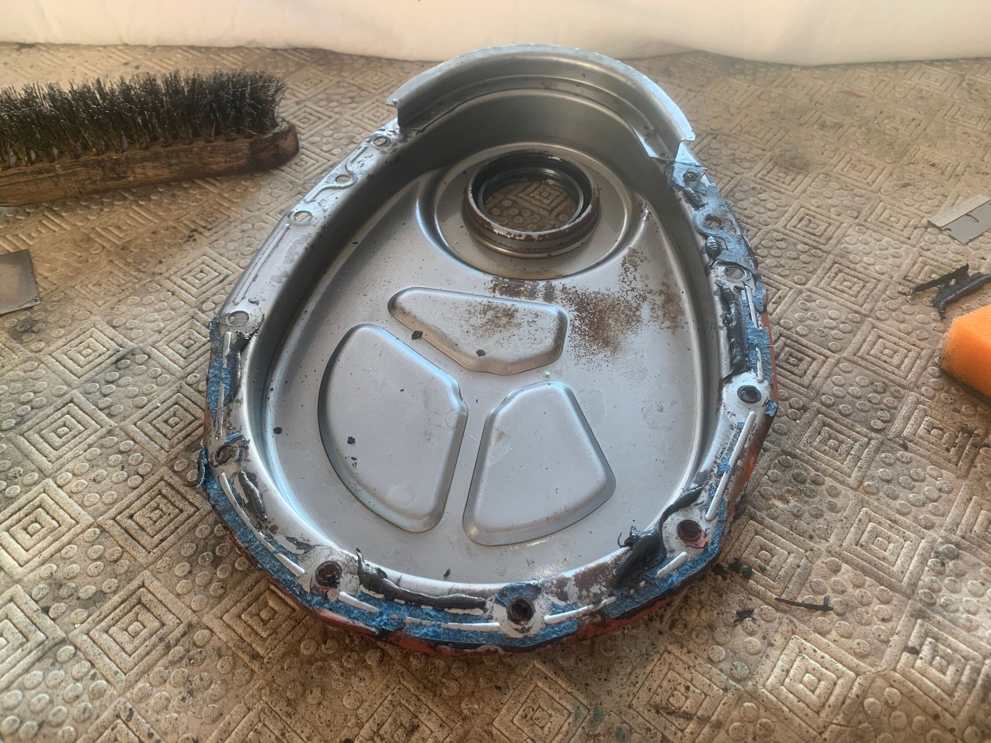

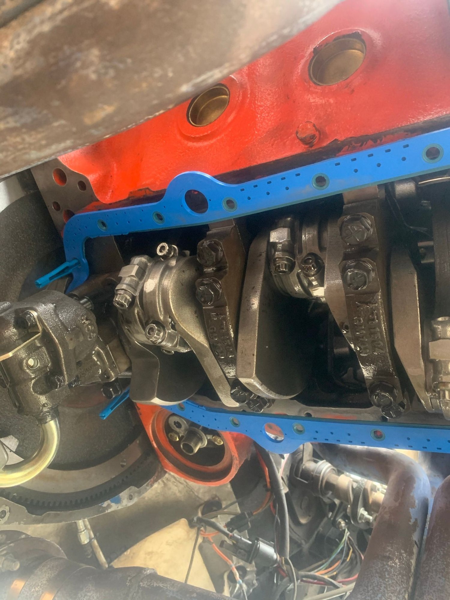

Sometimes the Our Lady of Blessed Acceleration smiles upon you. I was dreading reinstalling the starter. It was silly easy. I was also worried about the oil pan. It was fairly straightforward as well. I think I should be able to do a test drive tomorrow.
For the one piece gasket I decided to be a guinea pig and NOT add blobs of RTV in the corners for the oil pan install. It says to install dry. Let’s see how well that works. I do like the product.

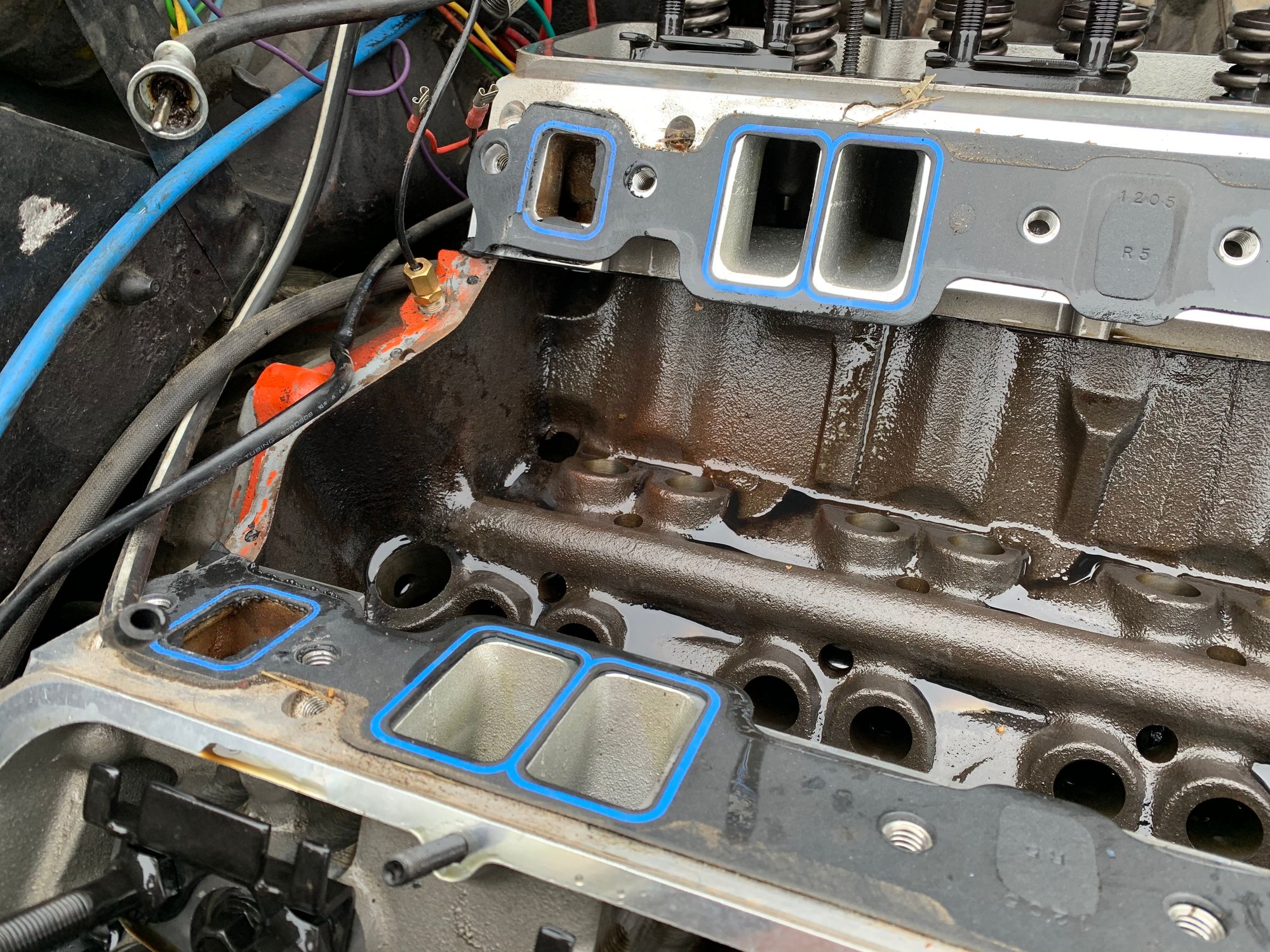

One issue many members have shown is major vacuum leaks along the China Walls.
Many don’t use any gasket along to wall, but build up a thick bead of silicone, let it set up some and gently set the intake on.
Good luck.

Mmmm. The “no blobs of RTV in the corners” for the oil pan looks like a fail... unless I am missing something.
in the meantime.
