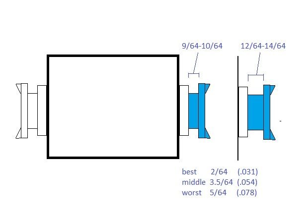

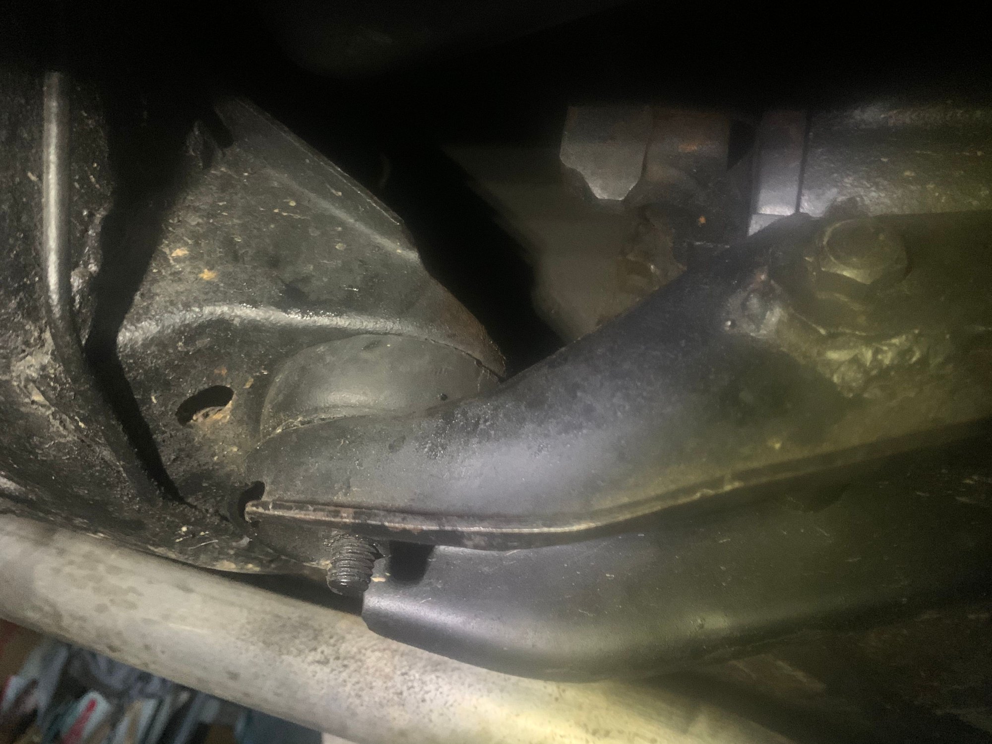

Well, I guess after rebuilding the trailing arms I’m used to tighter tolerances and have become a bit paranoid.
On the driver’s side, the loosest, I’m at 0.045 end play. Now, this translates to quite a bit of play at the top of the tire.
Note too self: rebuild the carrier in a couple of years.

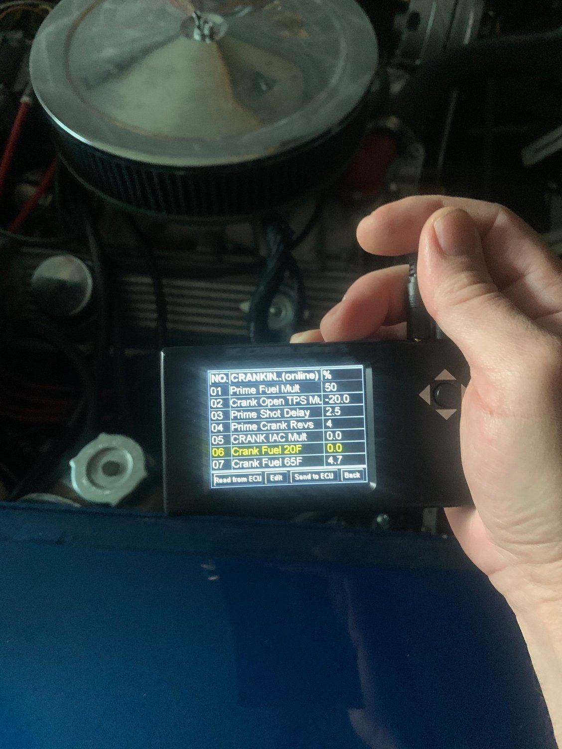

Hmmm. I can’t drive the car anywhere due to the lockdown. Might as well tune the start
With a glass of rosé, why not?
Add a little fuel to start up and reduce the prime shot.
Cold start... still needs a little work
No idea why my breathing sounds like I’m hyperventilating. And no idea why my selfie appears a second time hereunder.

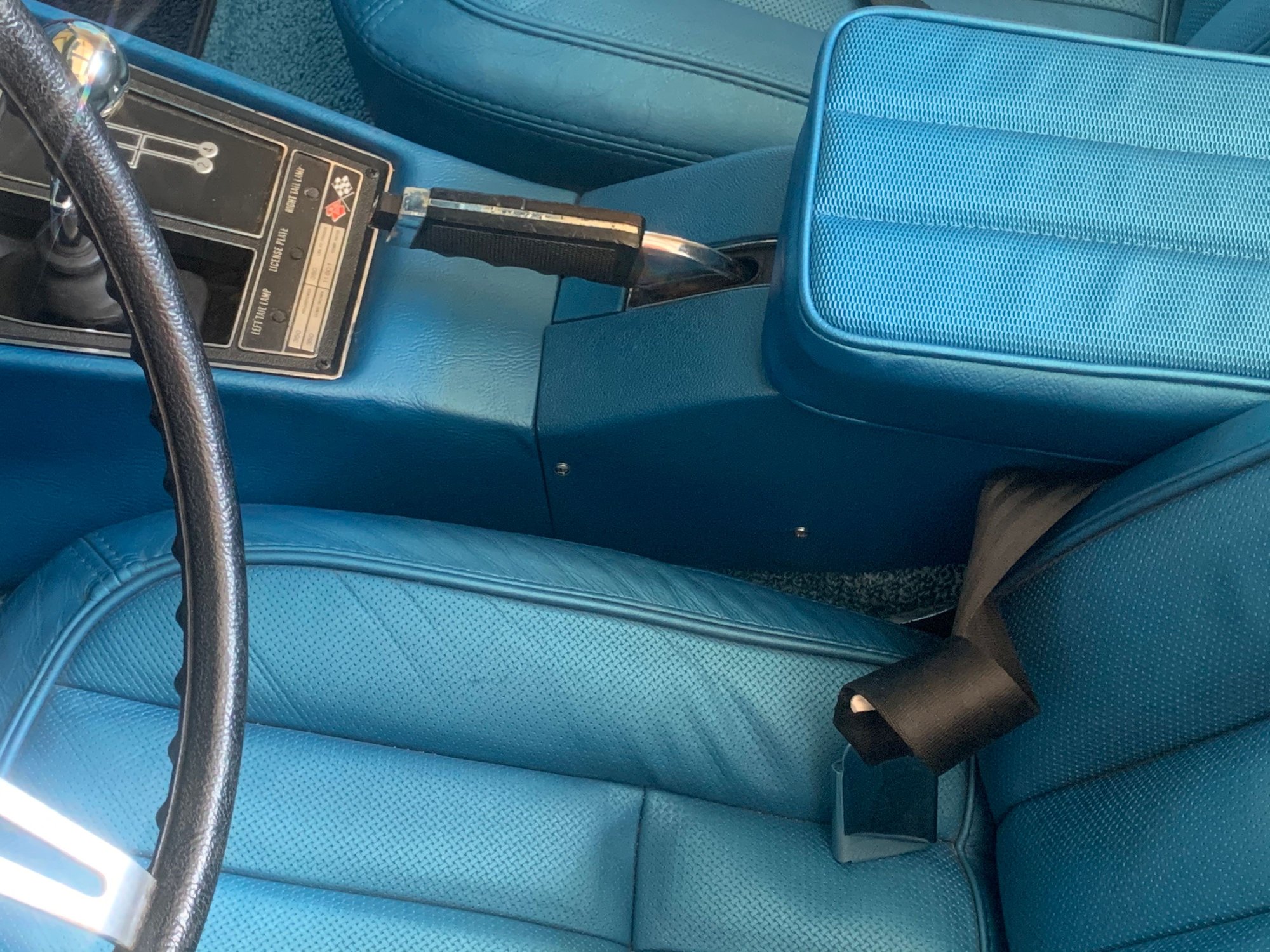

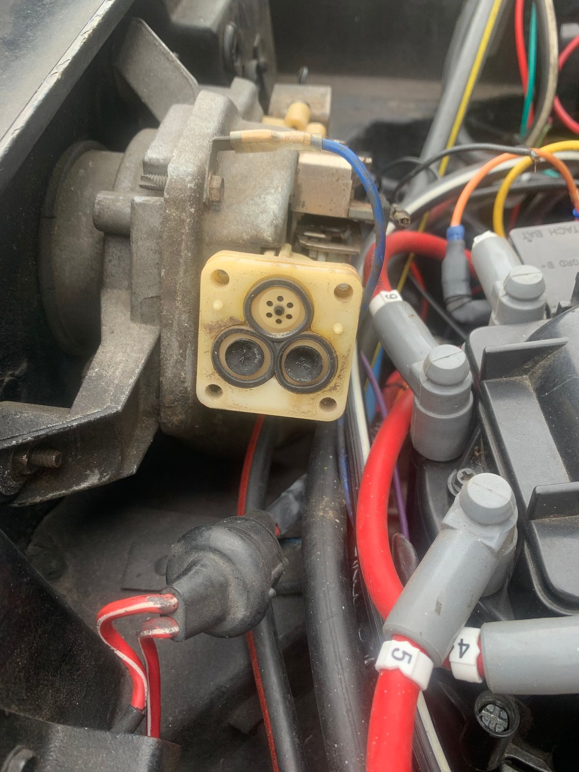

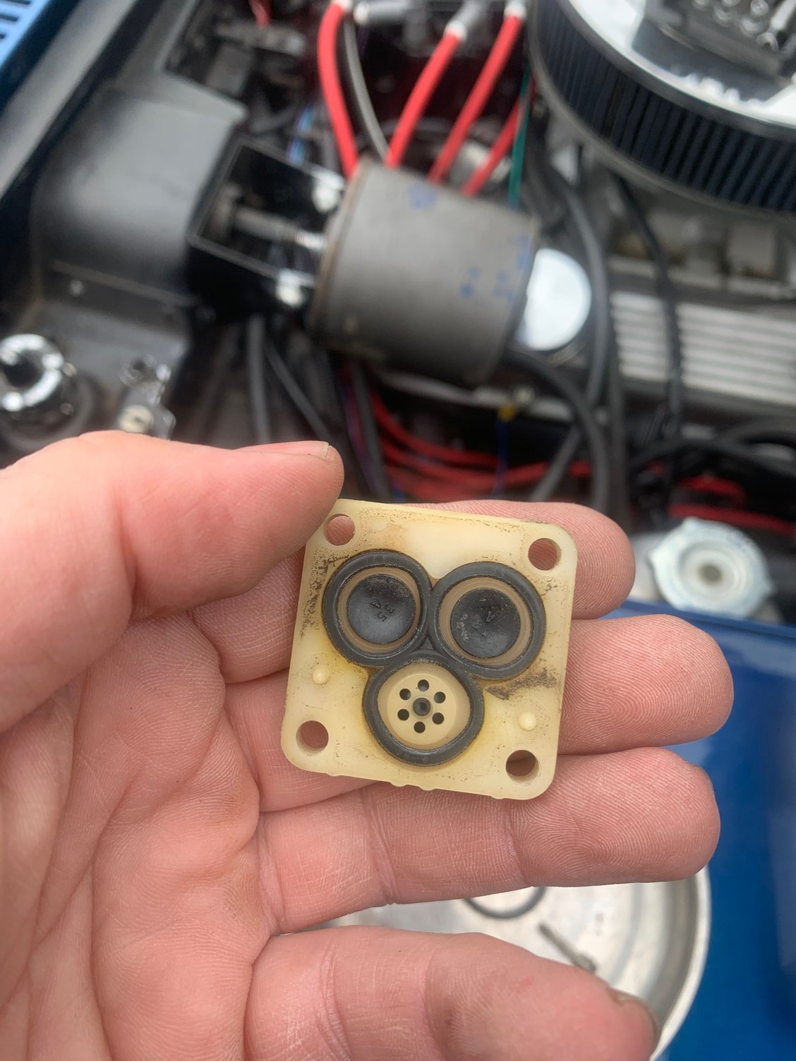

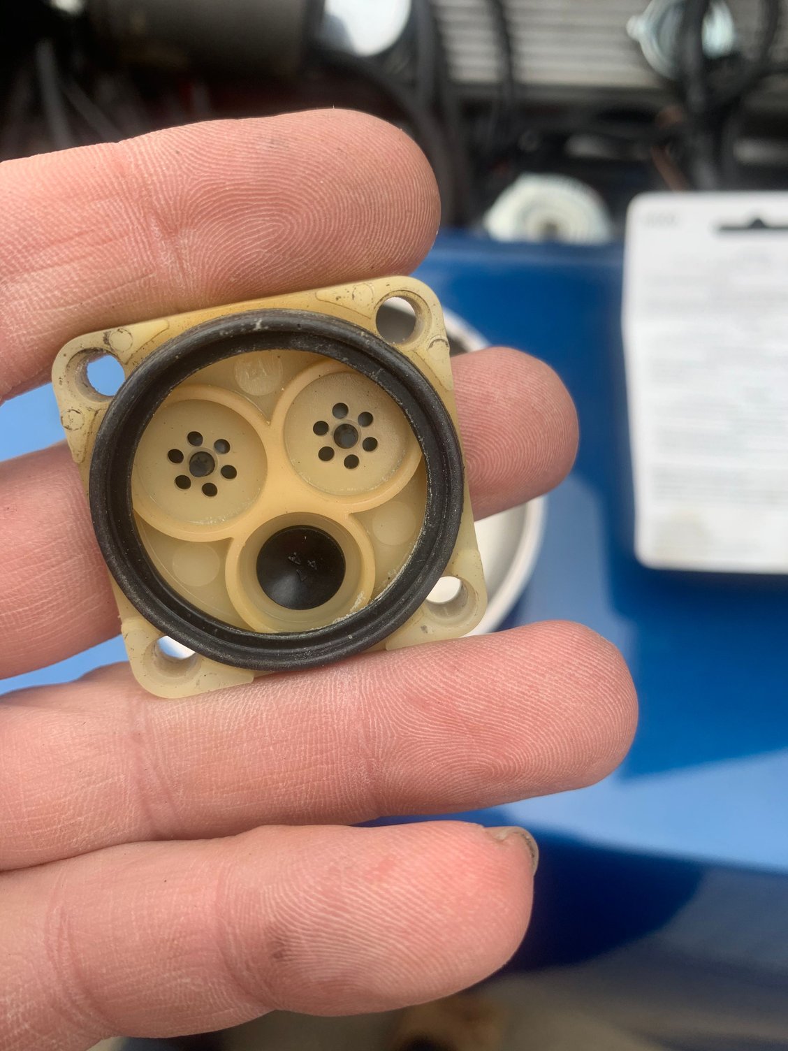

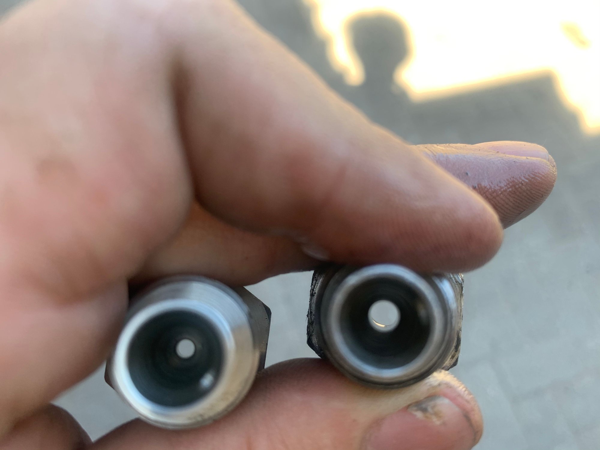

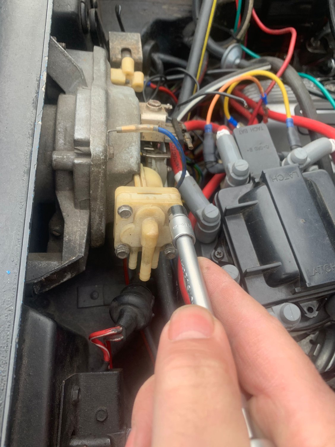

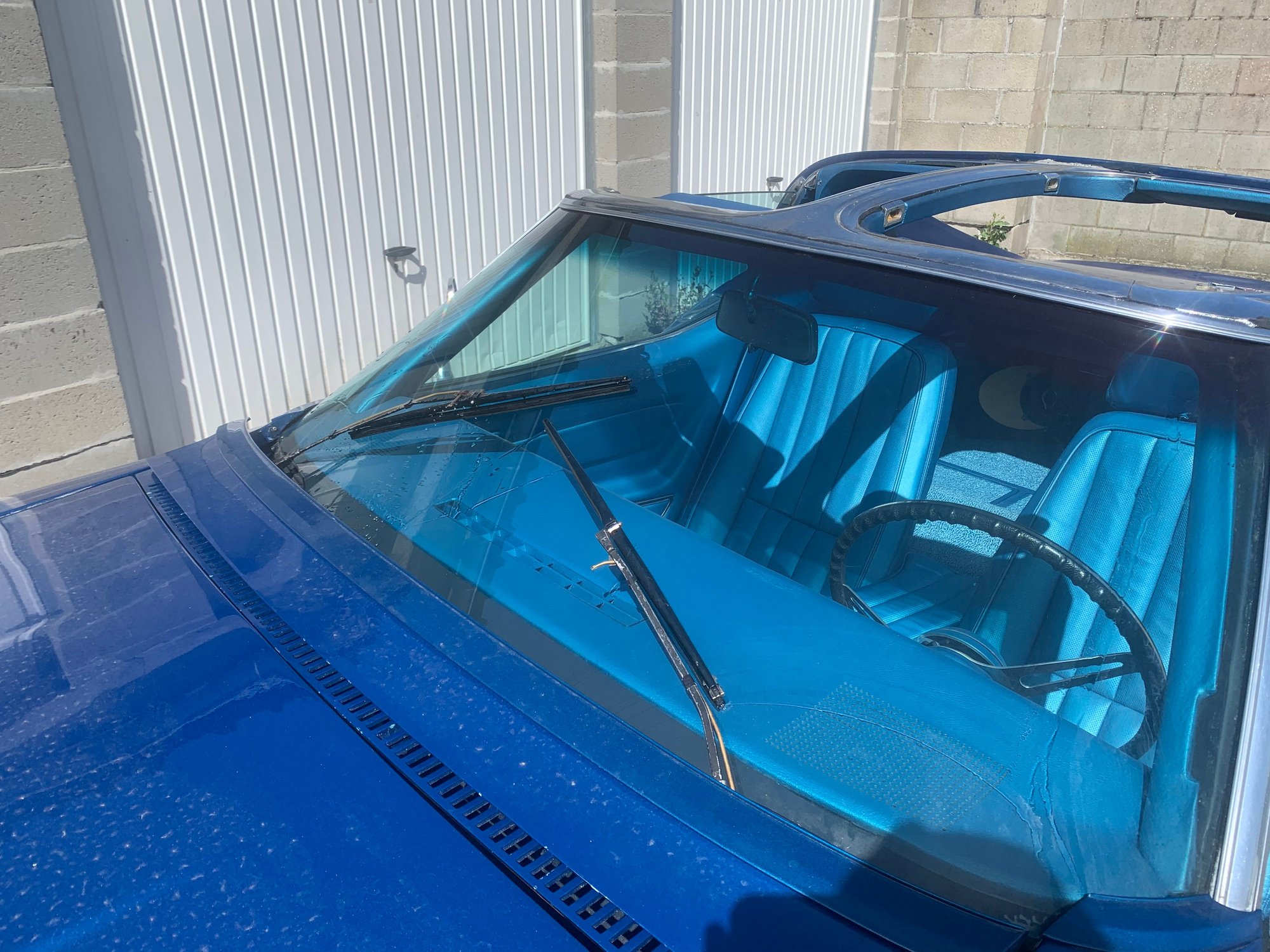

The T-filler was missing and always gave me the feeling this interior wasn’t complete. Not too difficult a job. My hand just fits to remove the rear bolt. To get this in, the console needs to be slid in from the back and then the rear is lowered in.
Time to rebuild the washer pump.
Testing before final assembly... That was easy.

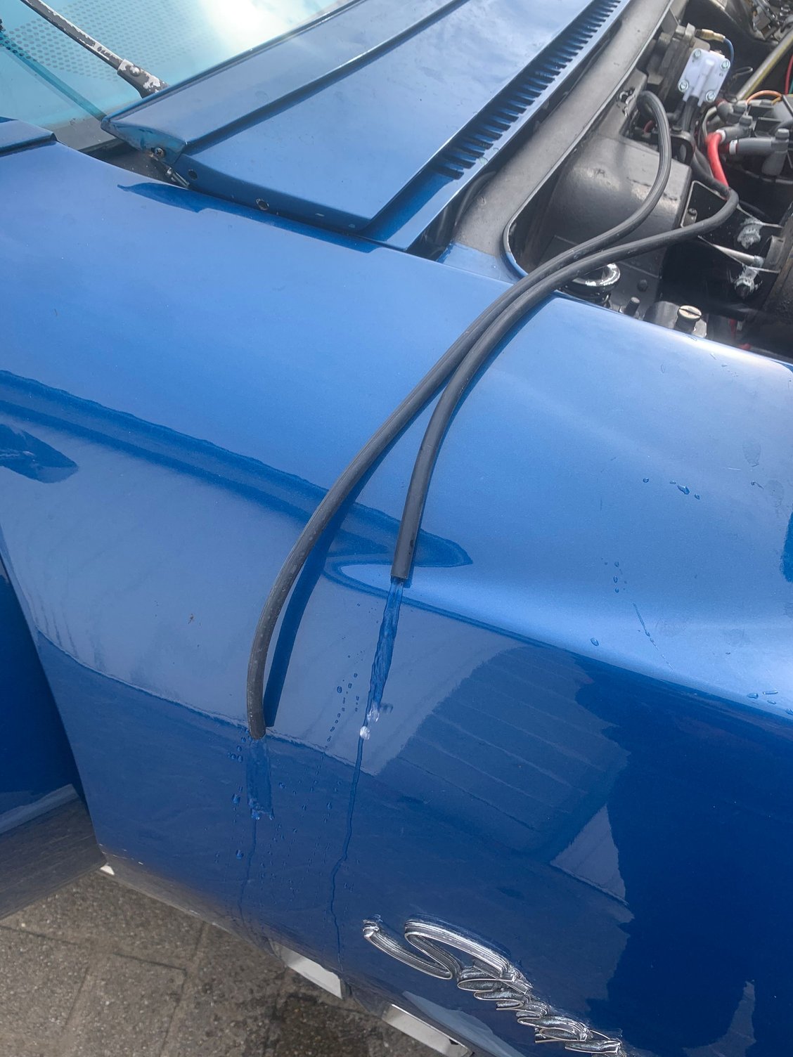

The brass tubing however was half a nightmare. It’s fairly close. The bends have to be tweaked a bit to fit relaxed. Bending tubing by hand is always scary. The plastic clips work nicely. I guess I’ll have to paint the wiper arms now; they look unfinished.
Something seems to be plugging the left brass tube, but for now, I can live with it. I know this is a few tweaks short of fully operational.
I wonder when it was last that these brass tubes were there and washing. The headlight washers are all plumbed in. Is still need to check the secondary solenoid - for another day. Not sure when.

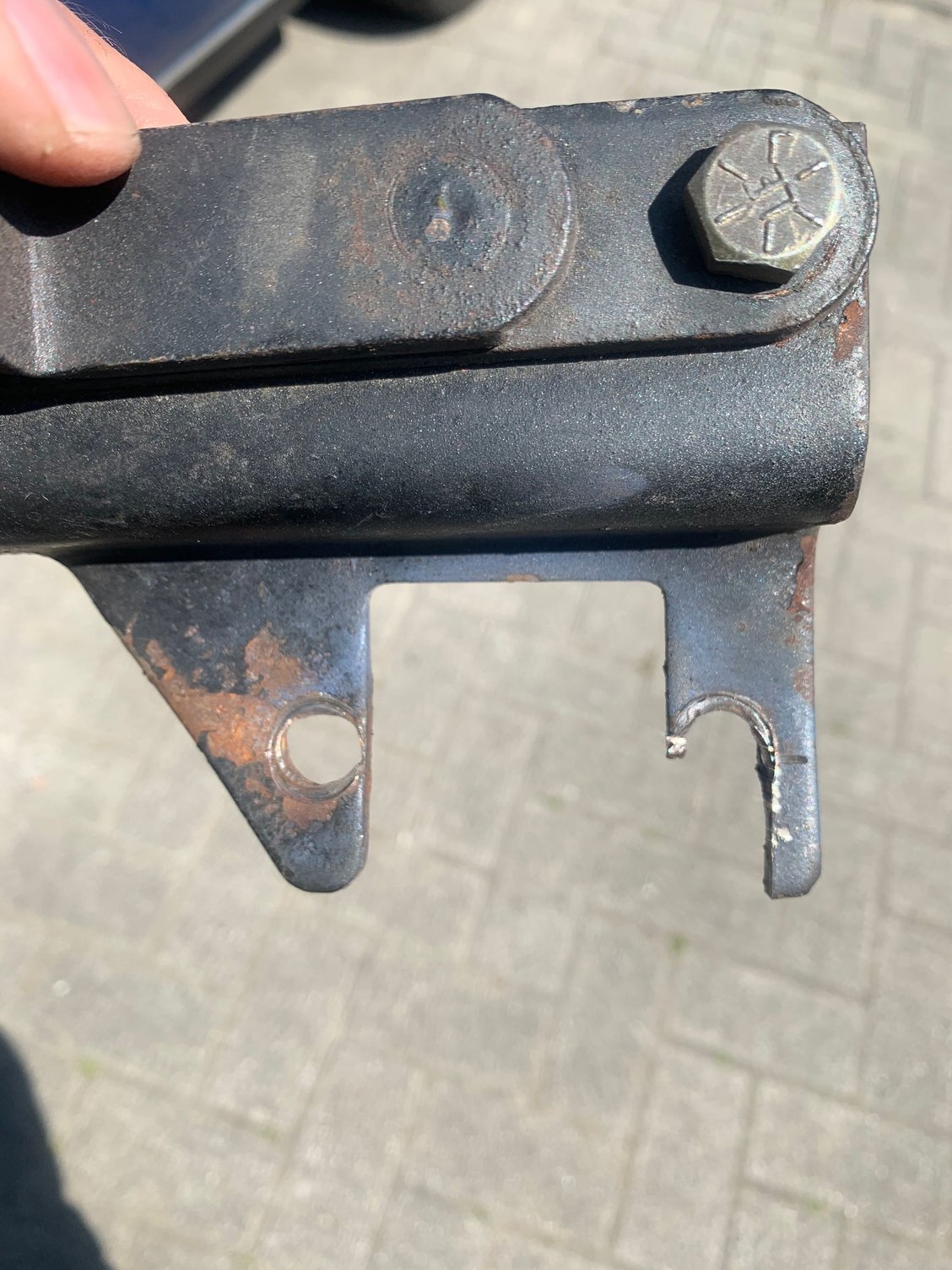

The parking break was easy enough to adjust, if time consuming. I think it needs to be a little tighter still, but I will let it settle in a bit. Fully pulled, it does its job.
Always check! Since I had the wheels off I figured I’d check the trailing arm pivot bolts. Sure enough, they were neither torqued nor pinned Good job, alignment shop.

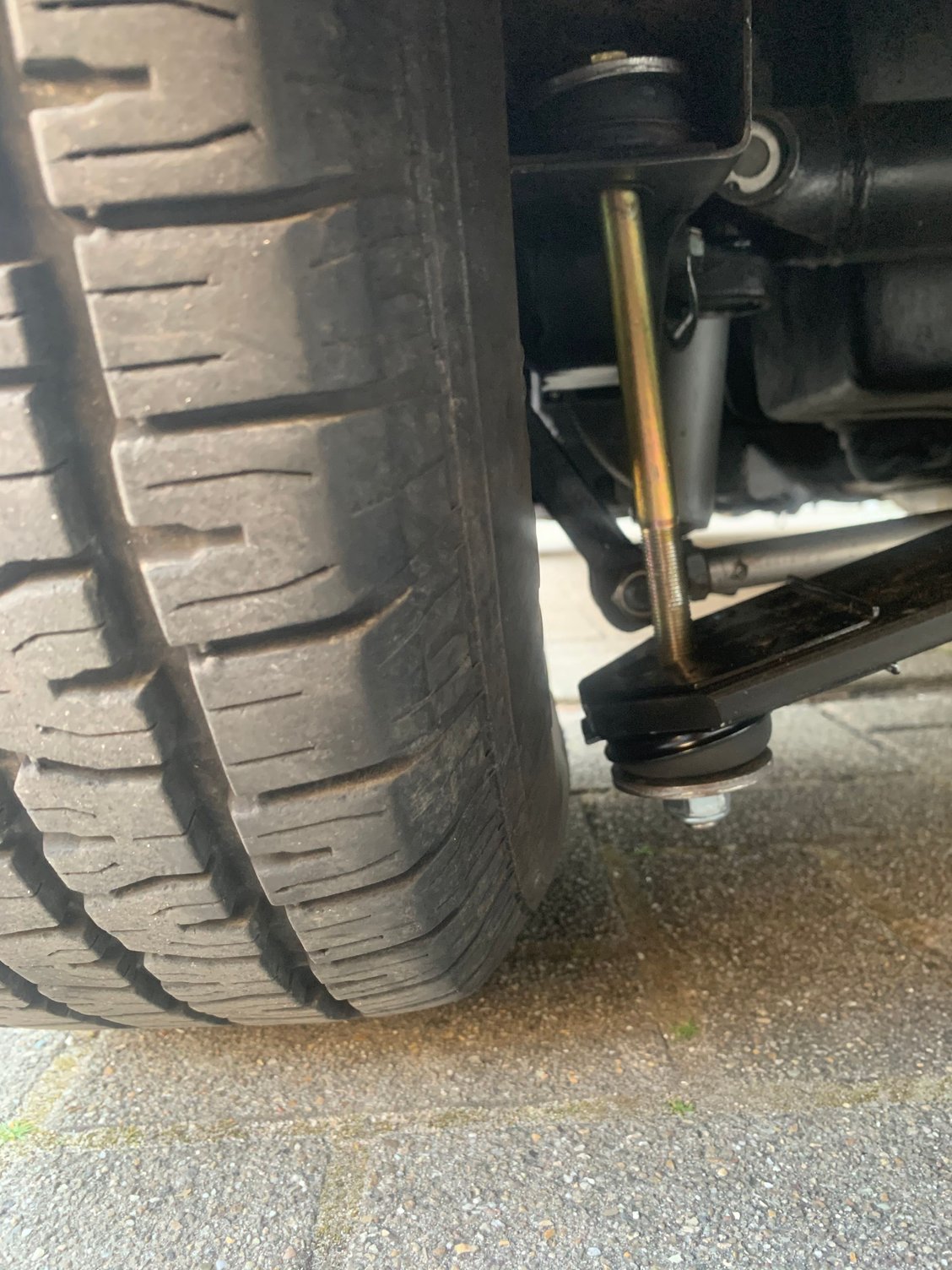

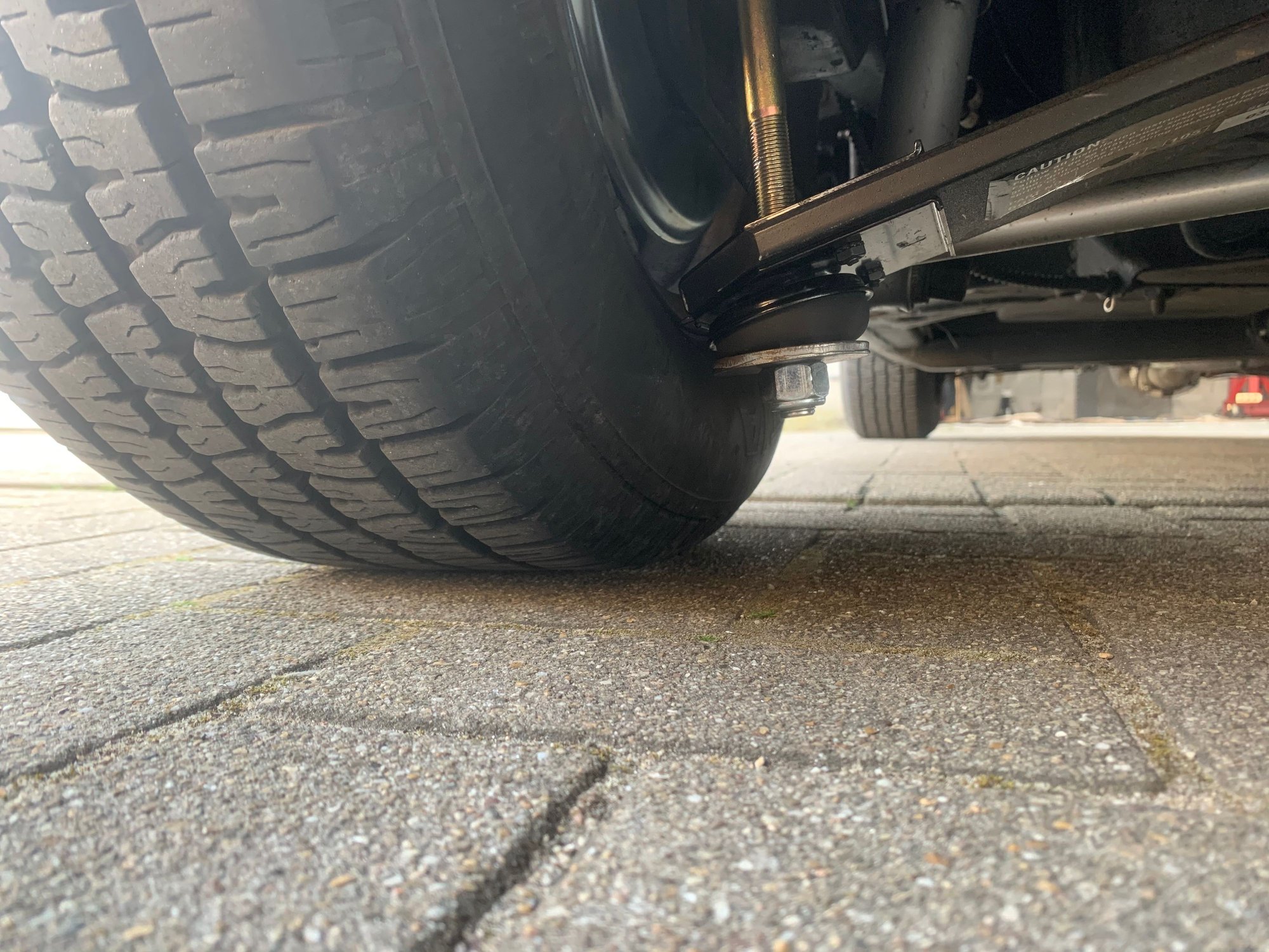

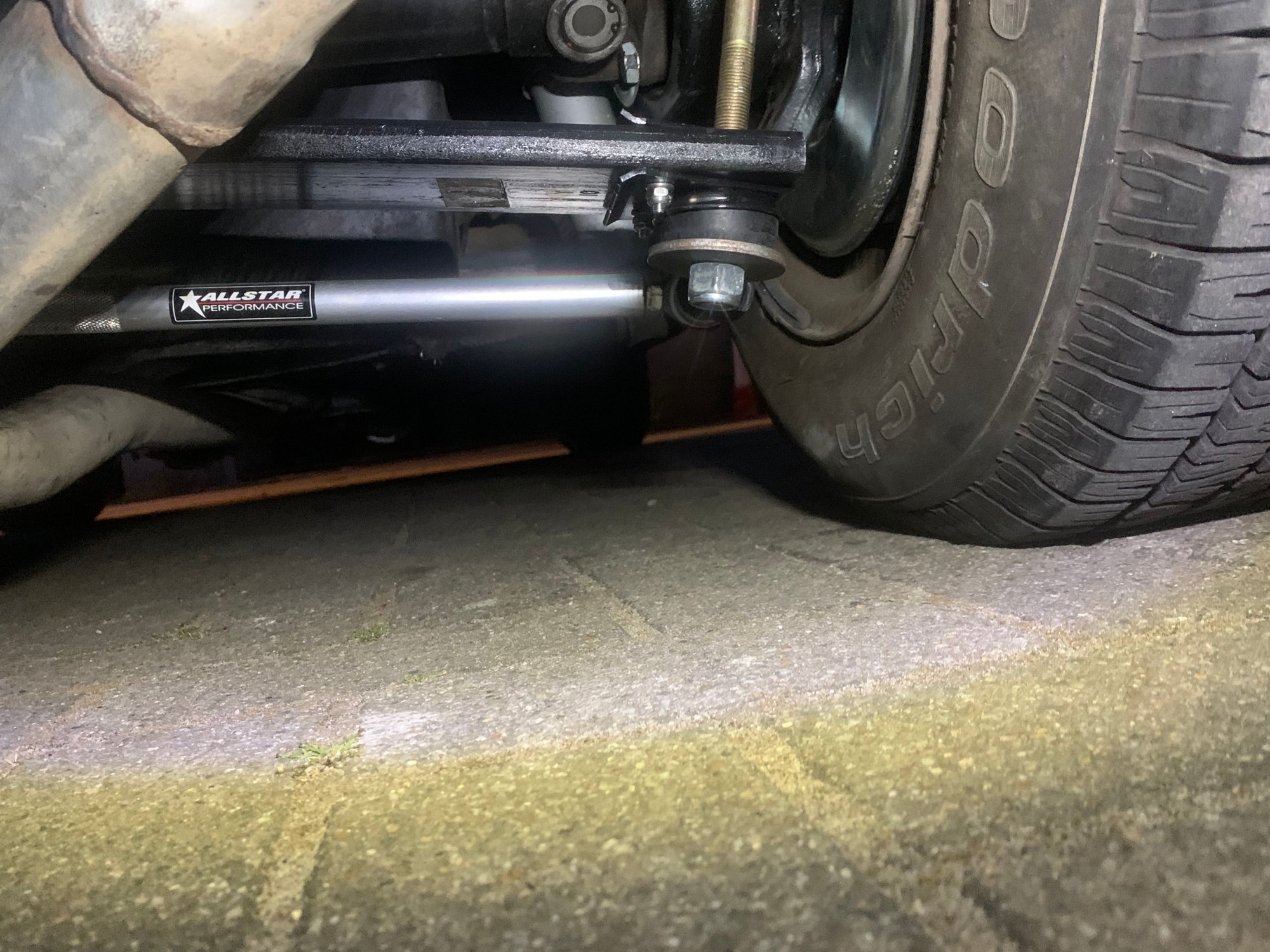

Time to address the rear suspension.

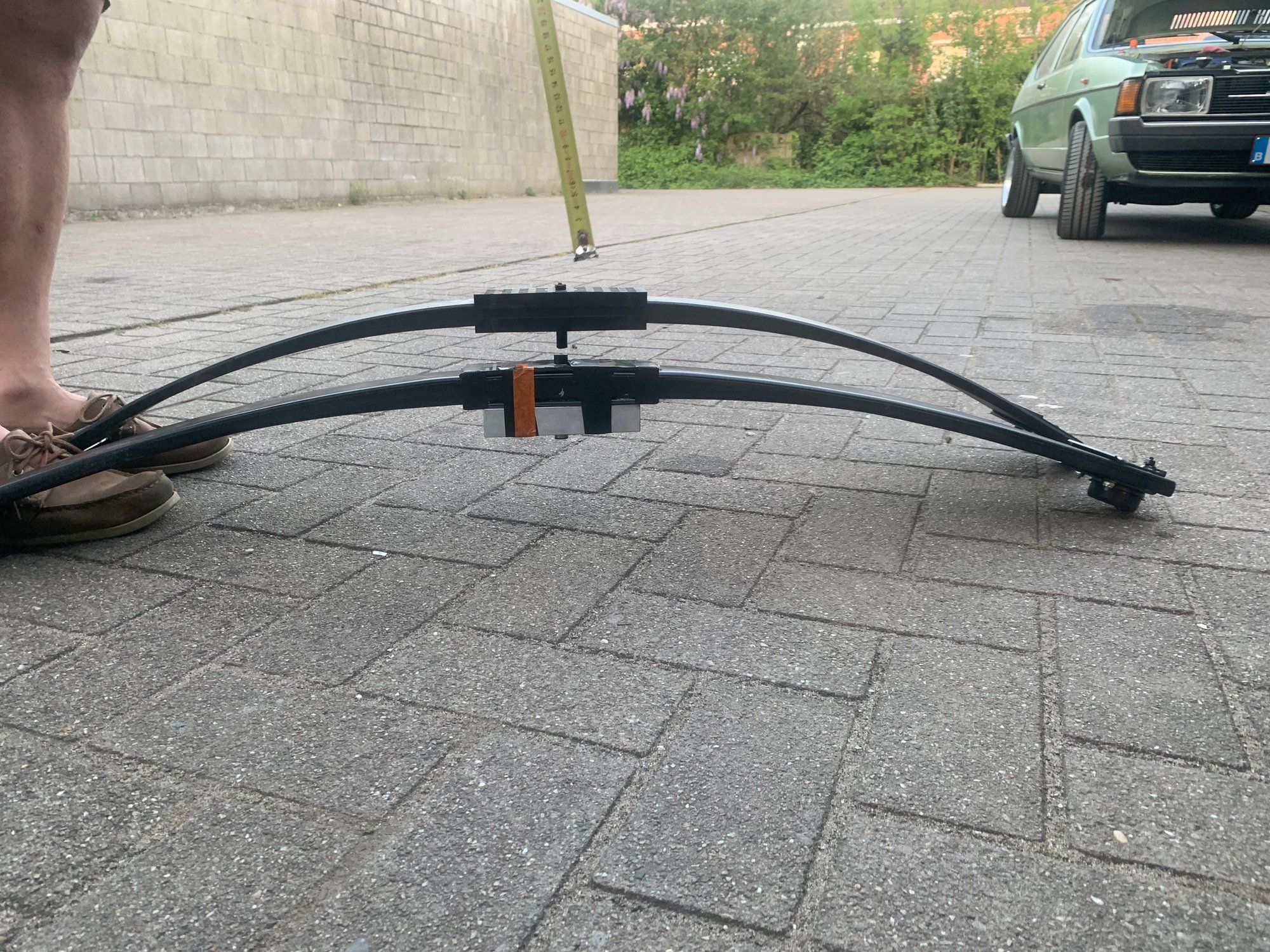

I had replaced the rear spring with a composite spring and it sat too high. I tried using 10-inch bolts, but found that although the ride height was correct, the end bolts were too close to the pavement.
Old Apr 23, 2020 | 01:17 PM
  #450
DorianC3's Avatar
DorianC3
Joined: Nov 2017
Posts: 2,369
Likes: 520
It turns out it was related to the “TRW” spring.
for full details see here:
https://www.corvetteforum.com/forums...h-still-9.html
I replaced it with, a Vansteel 330# spring trimmed .5 inches.
Dunno why... I like it already.
Clear difference.
Horizontal half shafts
Ride height spot on.
And good clearance.

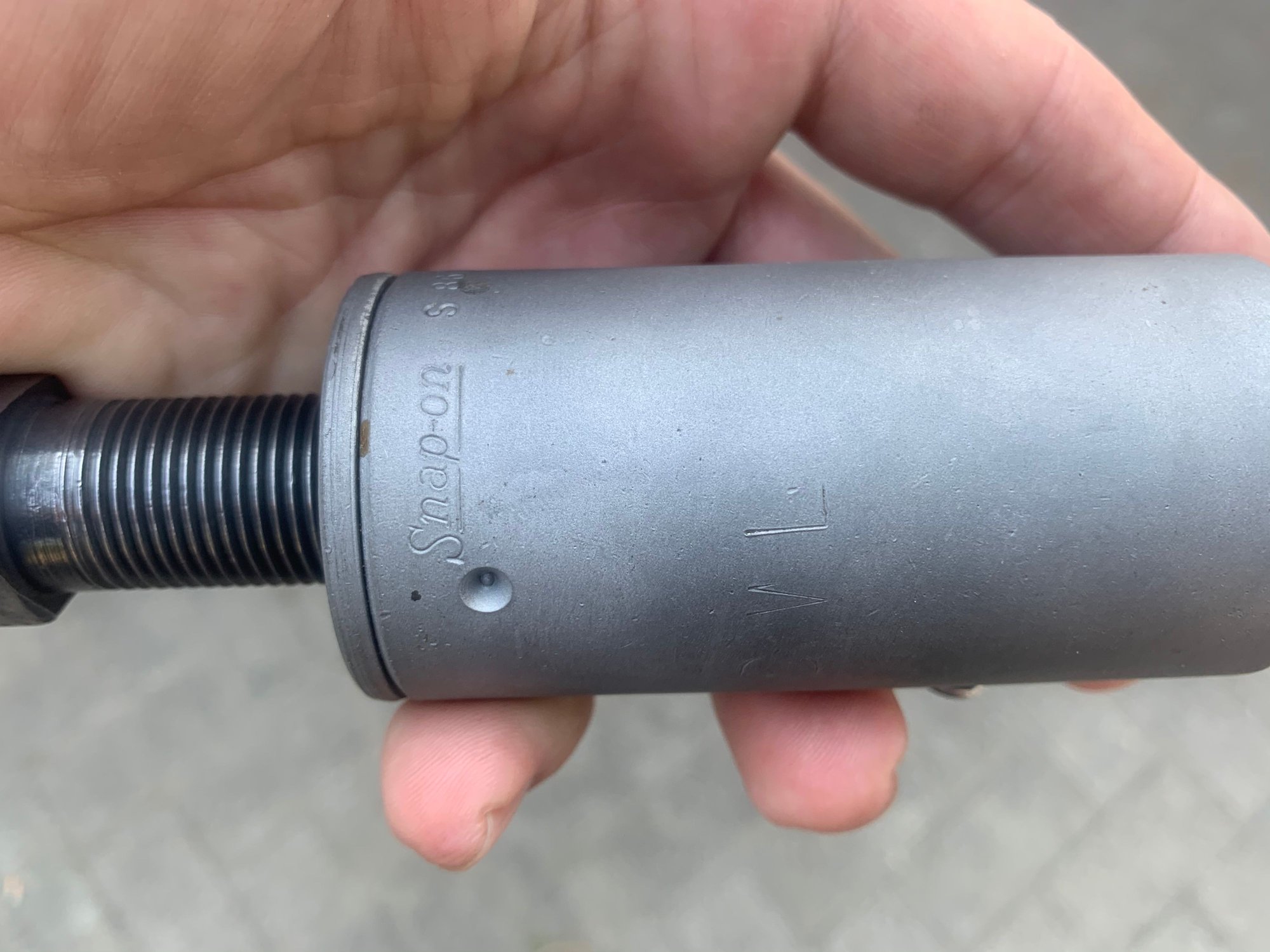

I got this off of eBay for $80
My first Snap-On tool.

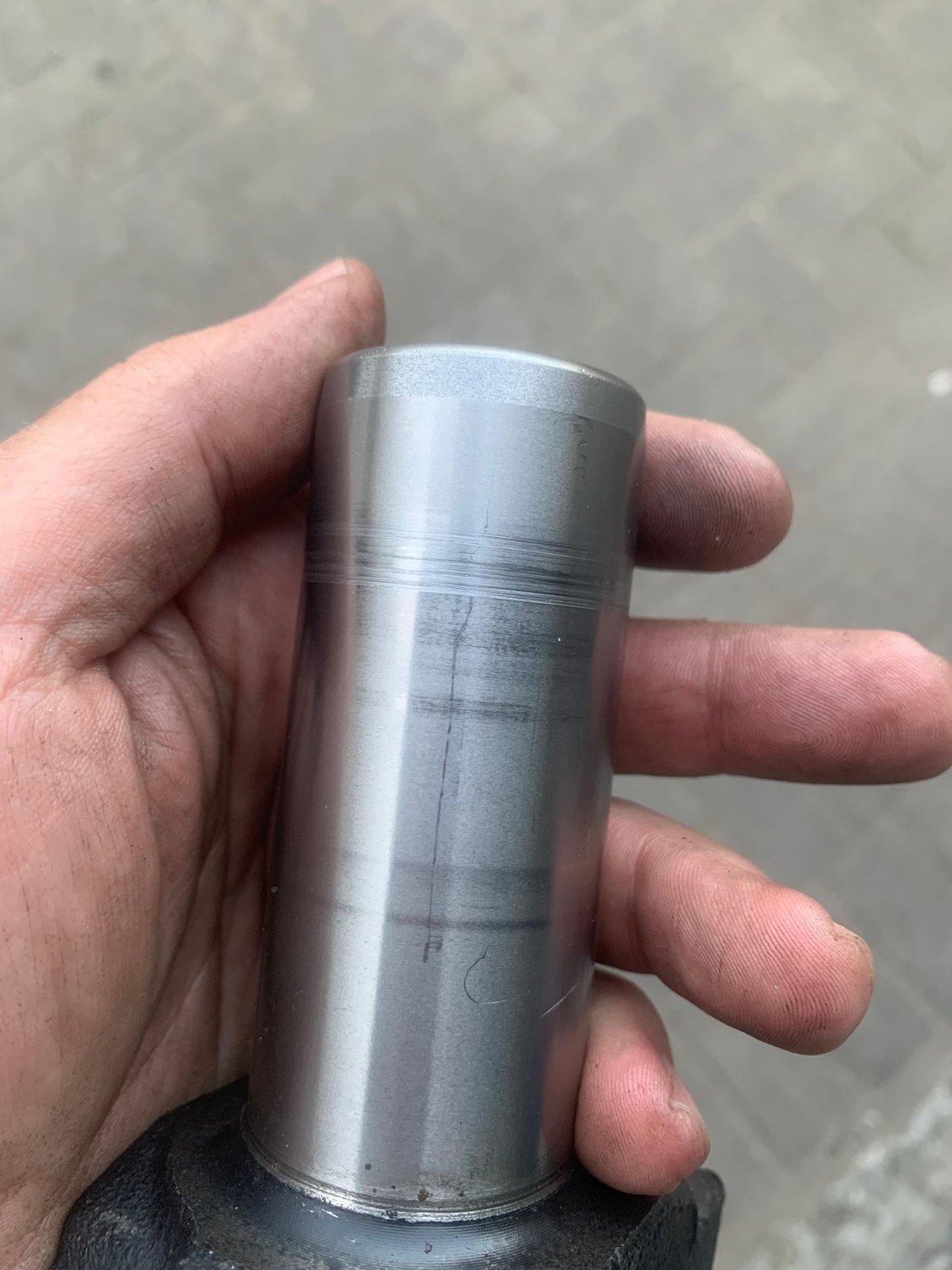

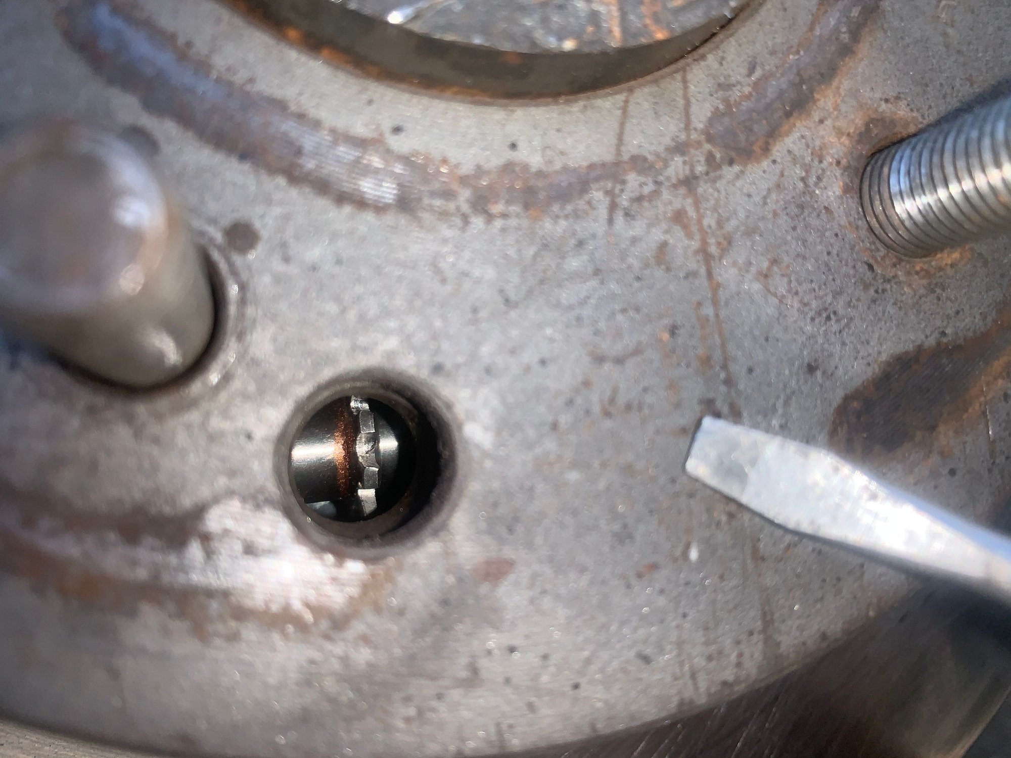

First I dropped the drive shaft and looky here. There’s already evidence of vibration damage in the short time I drove the car.

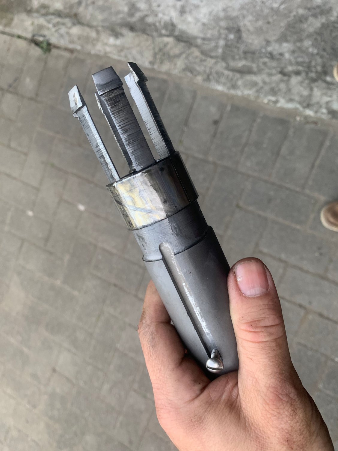

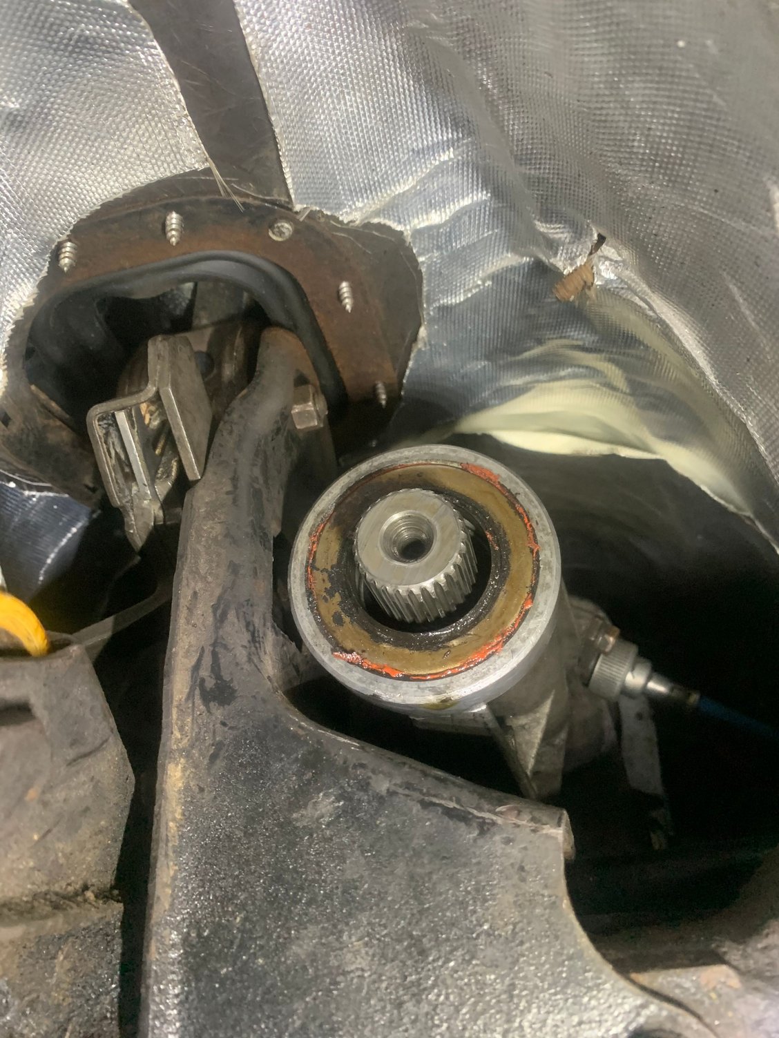

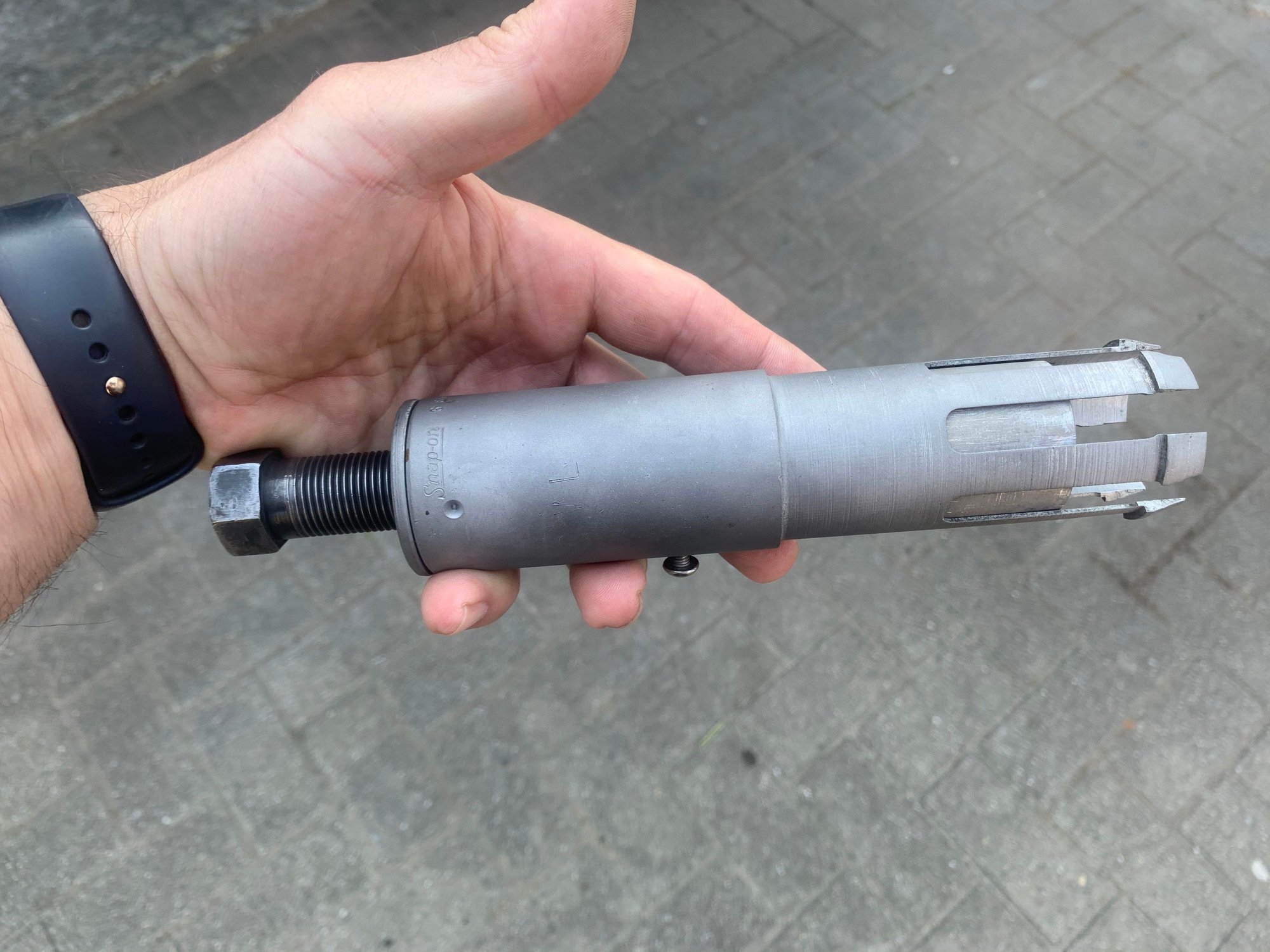

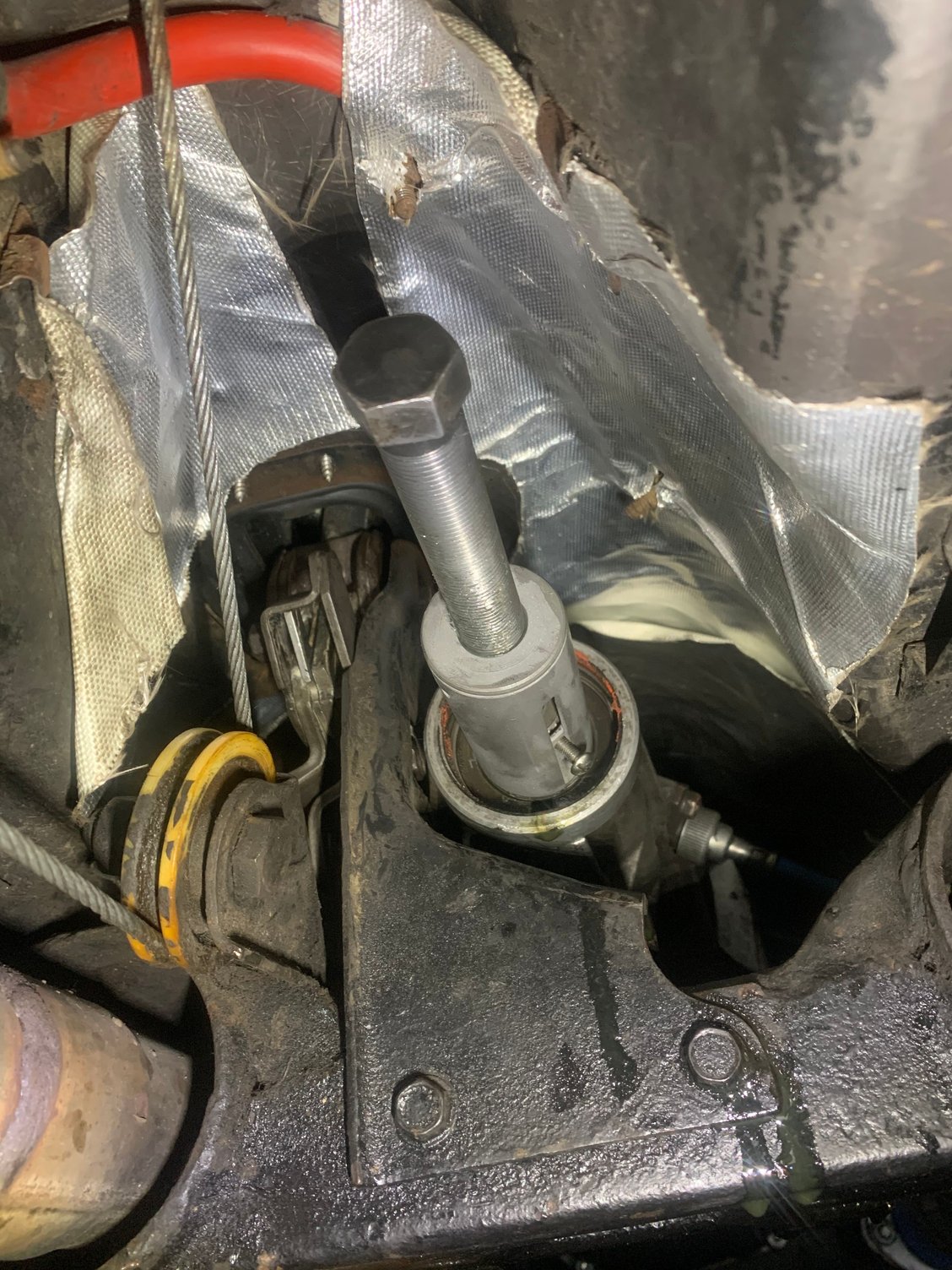

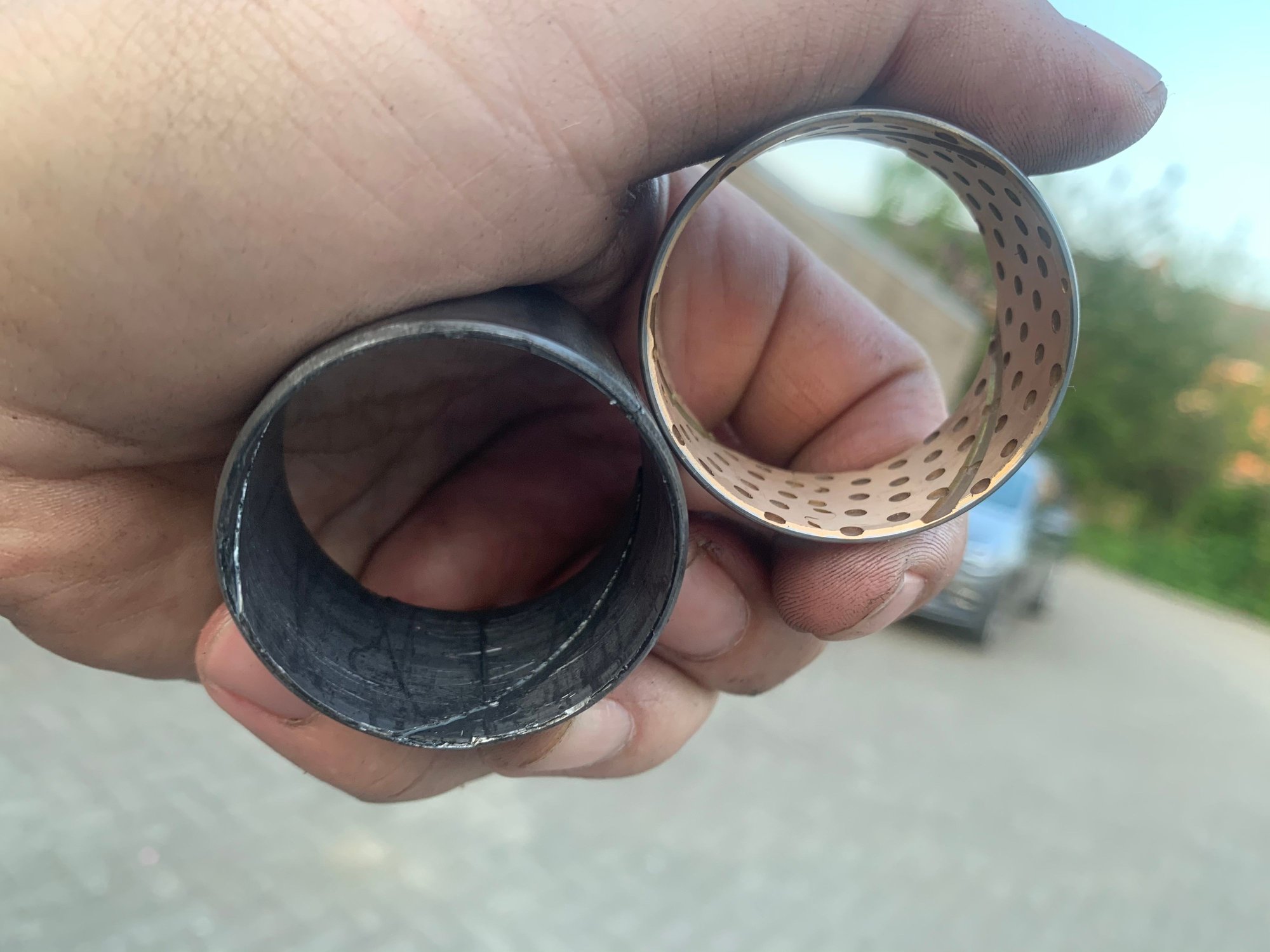

Let’s get a closer look at the bushing.
The oil seal has been replaced
off it comes.
On goes the puller.
And it worked like a charm.
Well...
Yeah
Old Apr 23, 2020 | 03:23 PM

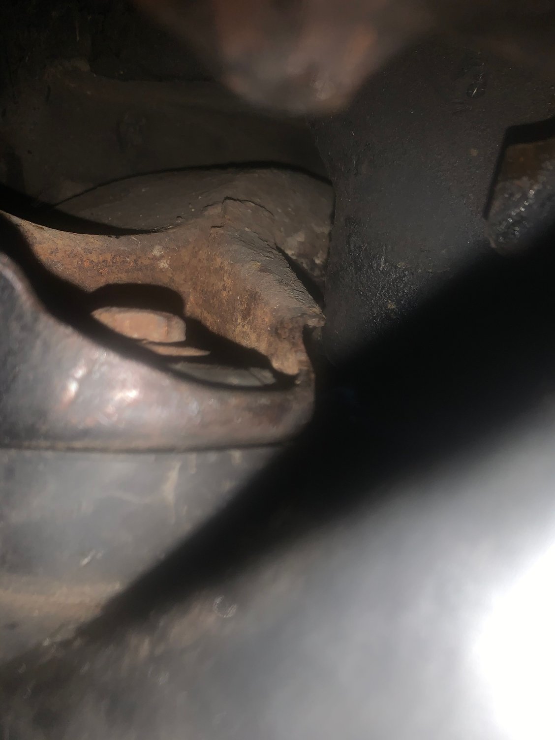

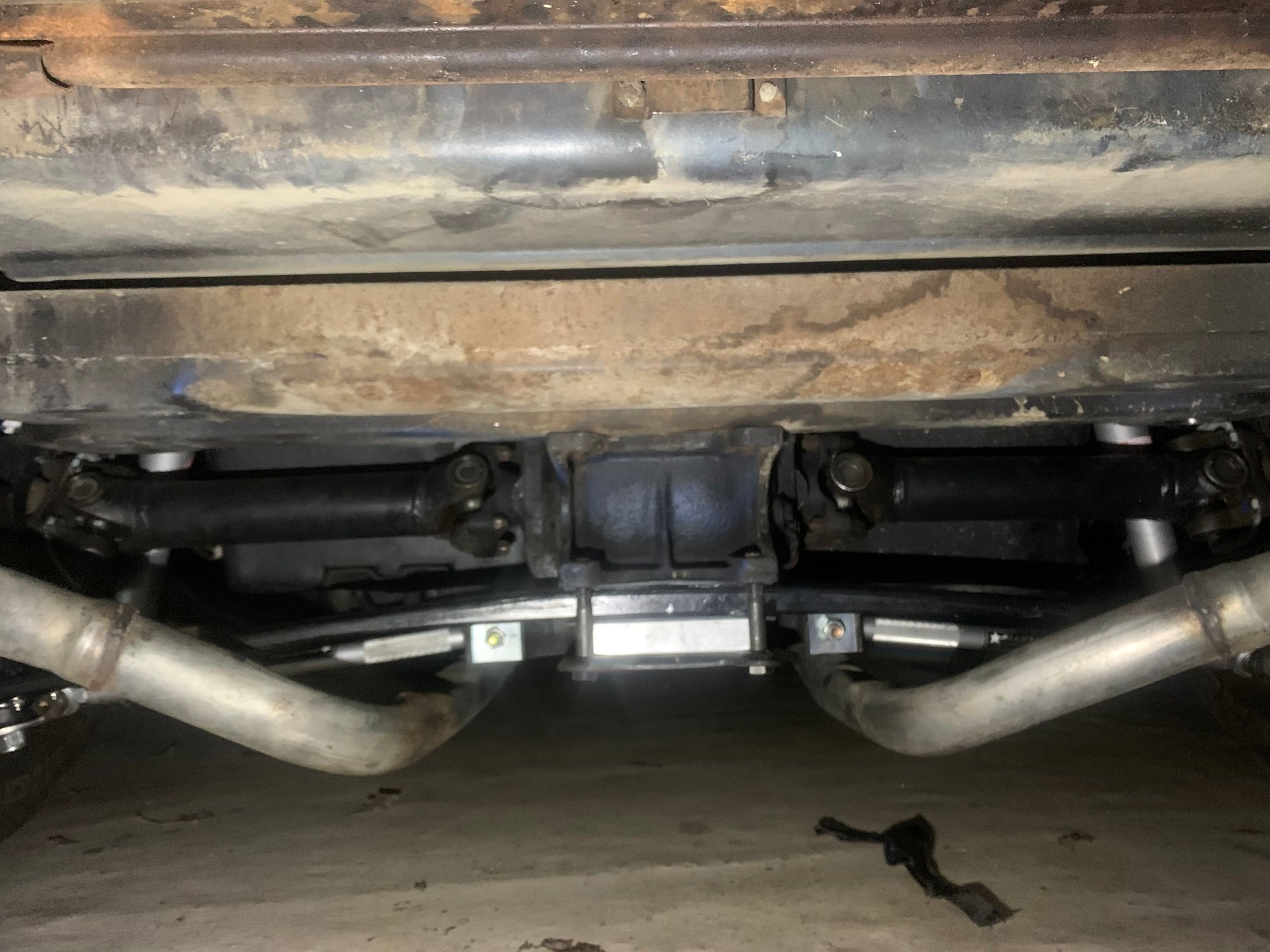

Presumably the issues is somewhere in here

I had suspected for a little while that there might be an issue with my driveline.
From what I read, the trans should be angled down 2 degrees. Ideally the pinion should be angled up two degrees. However, I also understand that, from factory, C3 corvette pinion angles were at about 0.
I will have to recheck my measurements tomorrow, but I think my trans is spot on pointing down at 2 degrees. The pinion also seems to be pointing down and close to 4 degrees... I will have to recheck it.
So the pinion needs to be raised 4 to 6 degrees.
As I understand it (after reading tons of articles) to raise the pinion, you need to trim the snubber/doughnut bushing and or shim the rear crossmember.
Correct ?
I suspect trimming the snubber will not be enough. I will have to shim the crossmember. Hopefully that won't be as aggravating as it sounds...

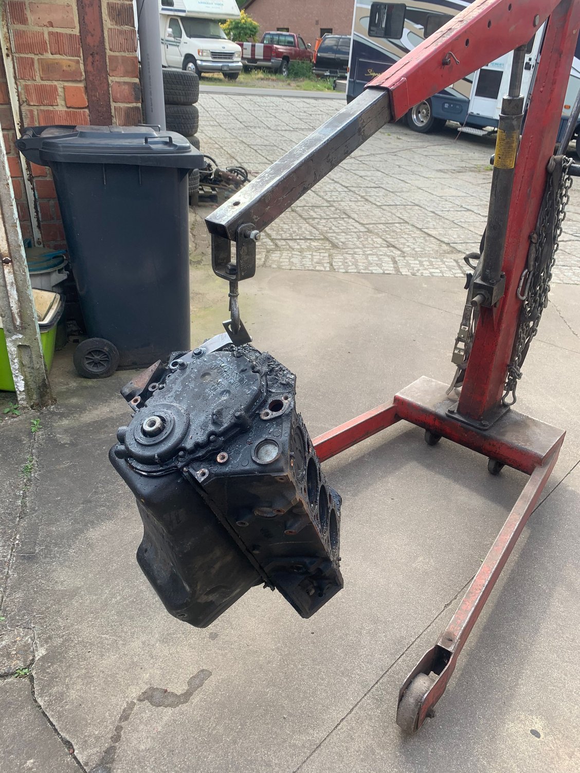

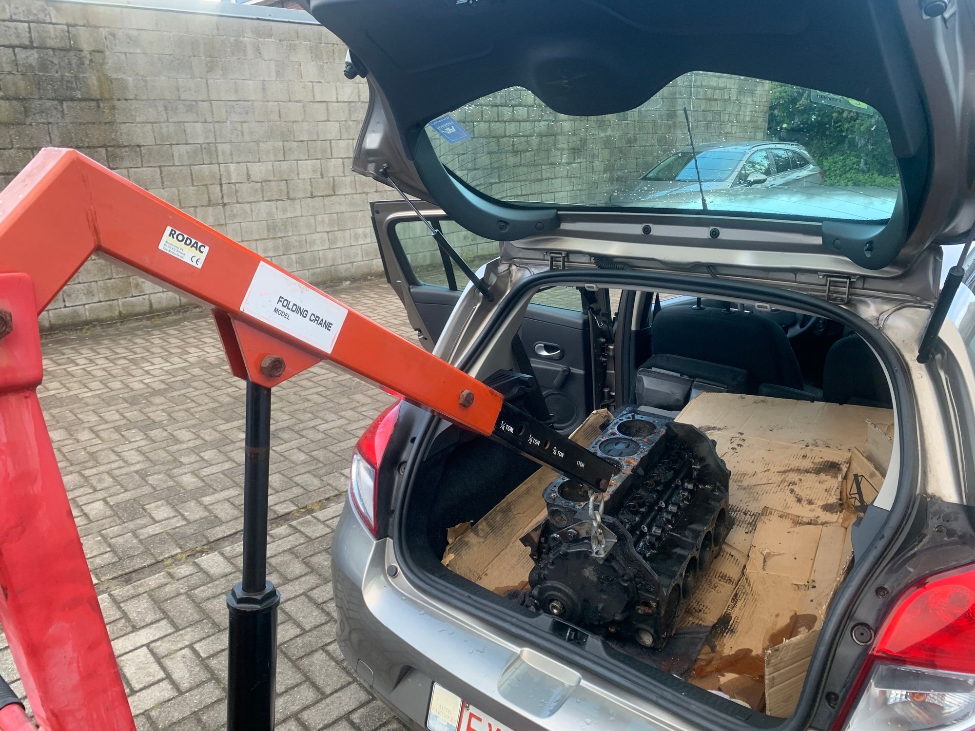

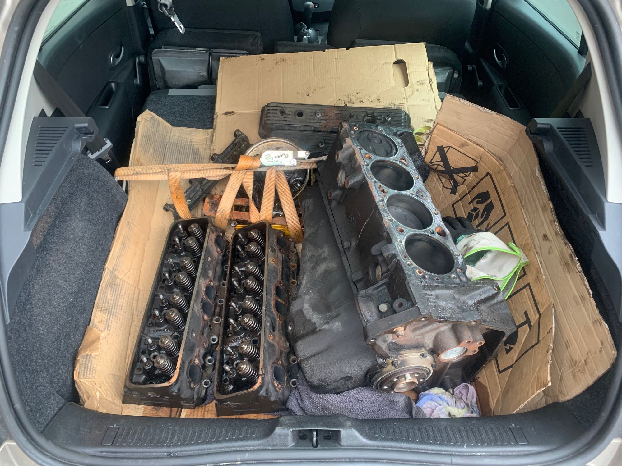

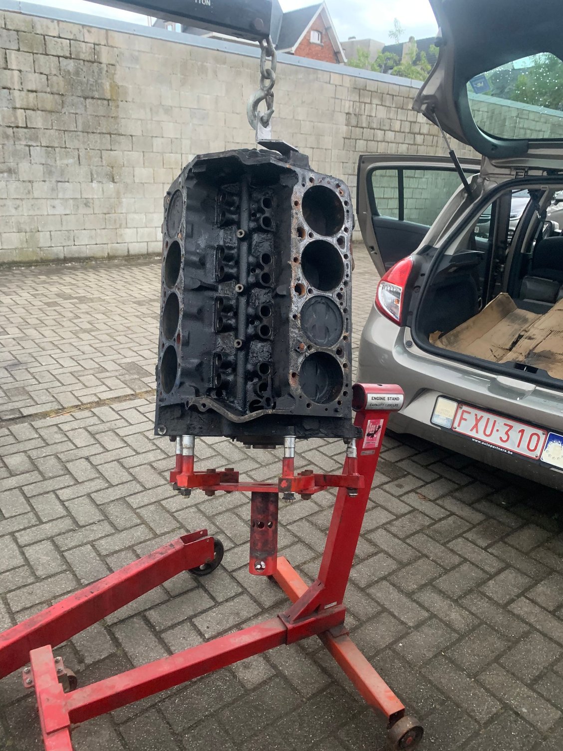

I have never been happy with the motor in my Corvette. It seems to be a super budget rebuild. It leaks oil. It has bits and bobs of bubba in it and I don’t trust it. I think is is also a possible source of vibration that I’m feeling.
I lucked out
I scored a 350 SBC from a 2000 van. It was scrapped because it was burning too much oil. Supposedly it needed a ring job. Forensics will tell.

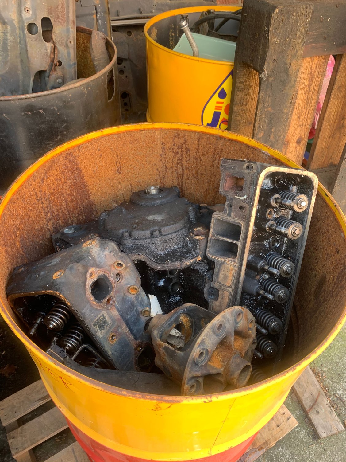

But first let’s get it out of the rain. It rained yesterday and is supposed to rain again this PM. So, I made a break for it
I wasn’t kidding when I said it was being scrapped.
Cherry picking time.
Ever see a V8 in a Clio ?
Enough padding. In-laws will never know
If it works it ain’t stupid.

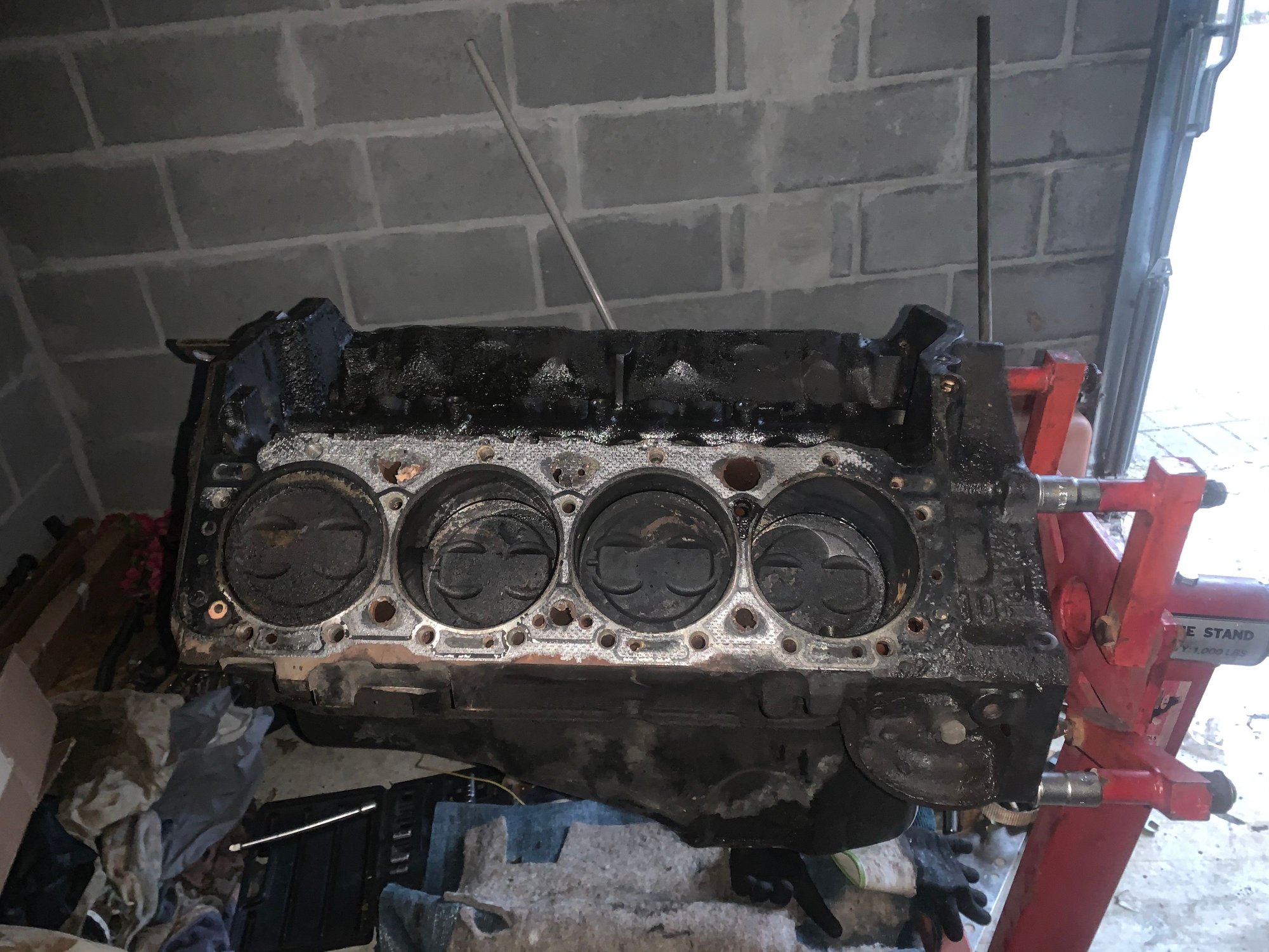

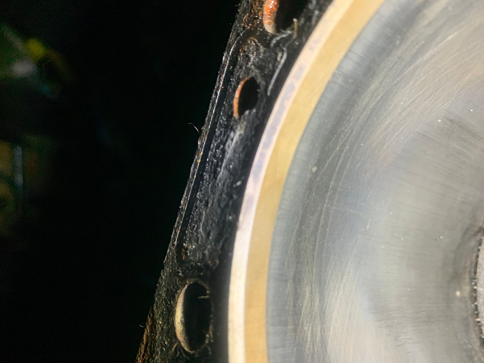

I barely beat a torrential downpour. It got dark too. I didn’t have time to closely inspect but it looks promising. I turned the crank over a few times and emptied half a van of WD-40. The last thing I want is rust damage.
No detectable ridge #happy
It’s too dark to further inspect.
Tomorrow I’ll drop the pan. For the moment lifters are cleaned and in oil and everything else was eithe oiled or hit with WD-40
Curious what tomorrow will bring
To The Force Awakens...

The plan is... a smart budget rebuild.
If the cylinders are in good shape, I’ll do a quick hone and new rings.
A mild performance cam. Mild work on heads... and I’ll call it good.
The goal is to match the now-missing L46’s performance. That is, slightly North of 350 HP and 380 TQ. Definitely want reasonable idle with enough vacuum to run headlights, wiper door and power brakes.

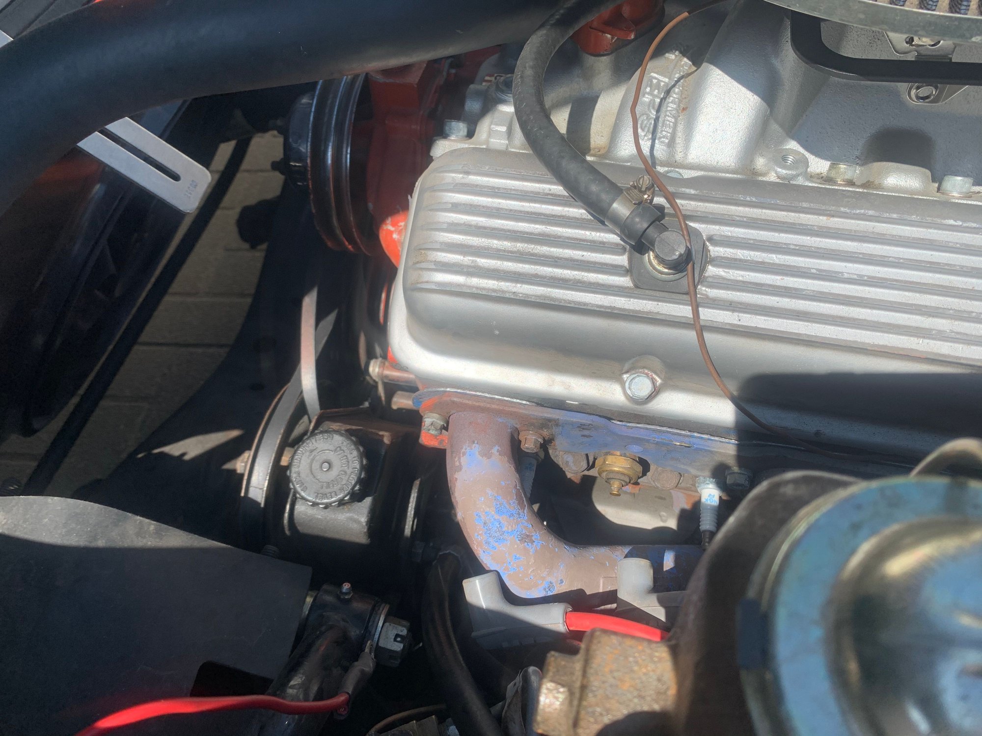

The discovery was that the fuel in the Edelbrock fuel sump is boiling and leading to difficult hot starts and maybe even poor performance overall.
That will have to go. It’s just too hot under our hoods for this system.

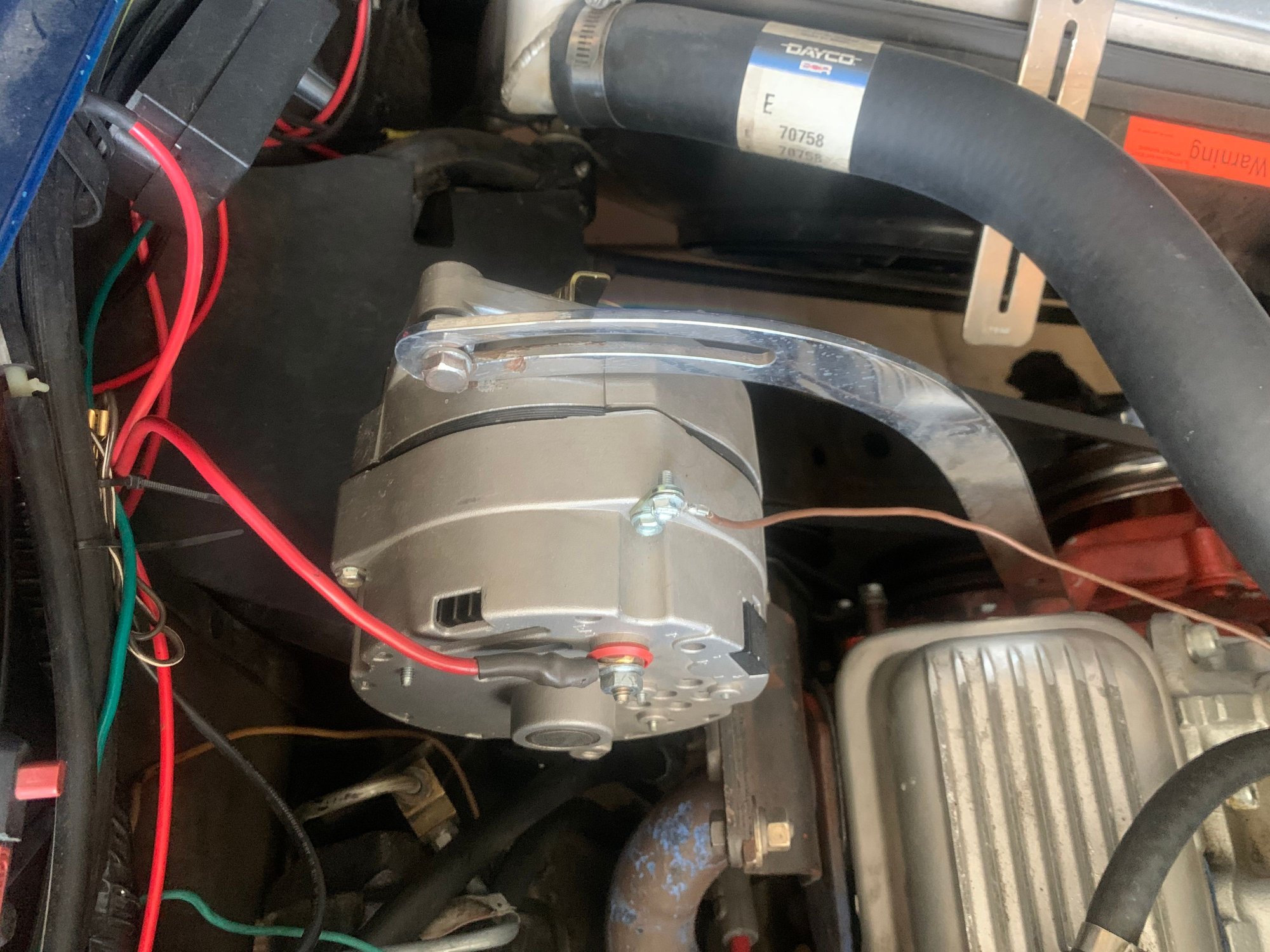

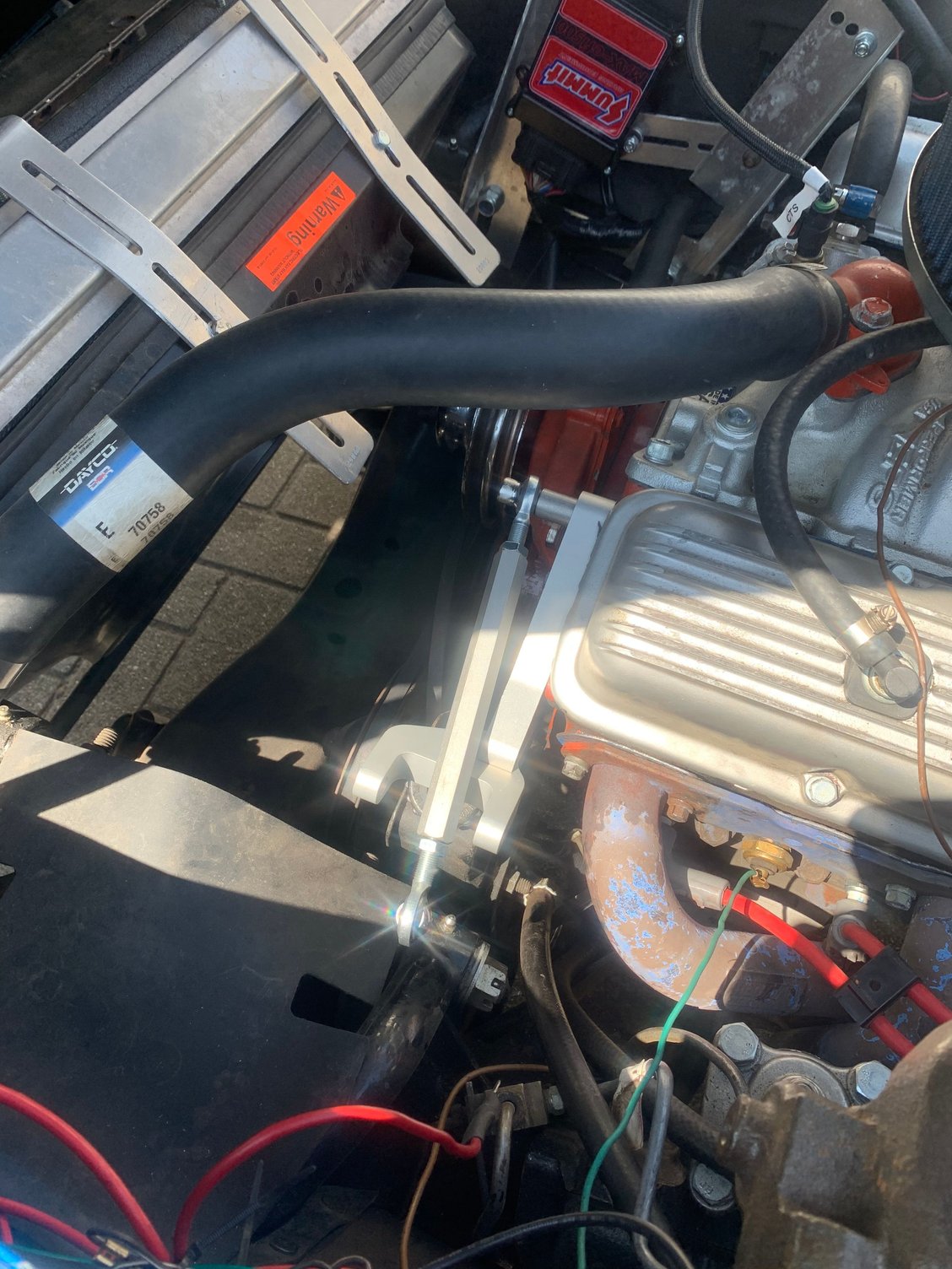

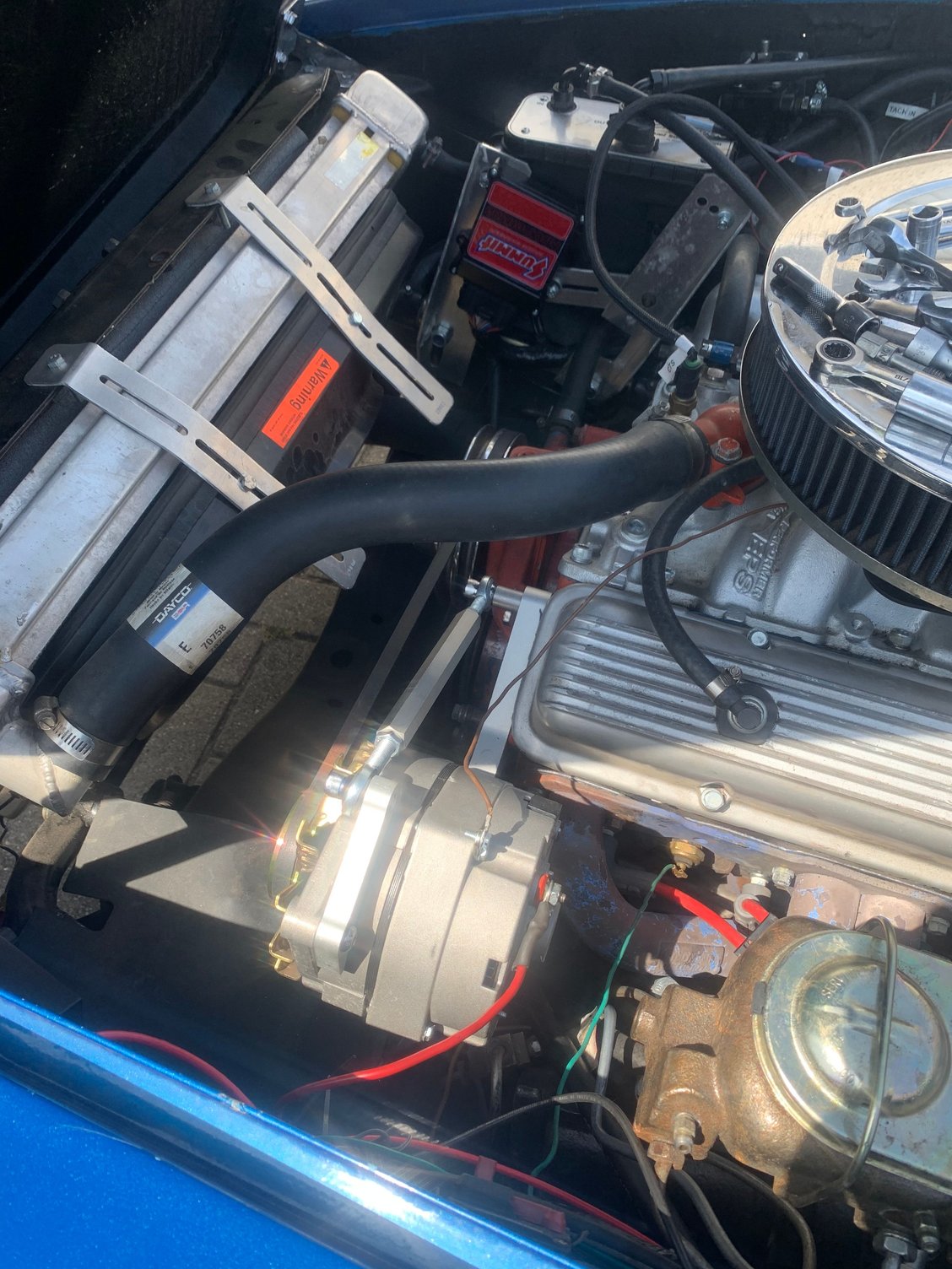

I never did like the alternator bracket. The alignment was pretty bad. It’s seemed to be twisting over.
I guess this explains why the bracket was not aligning properly.
Mmm. I prefer not having a bracket on my header bolts.
Half install done.
Nice kit. Simple. Effective. I think my belt could be a little smaller.
I replaced the restrictor in the power steering pump. This got rid of the over boost and gave a much better road feel. Definitely sportier and inspires confidence. #reommended.
