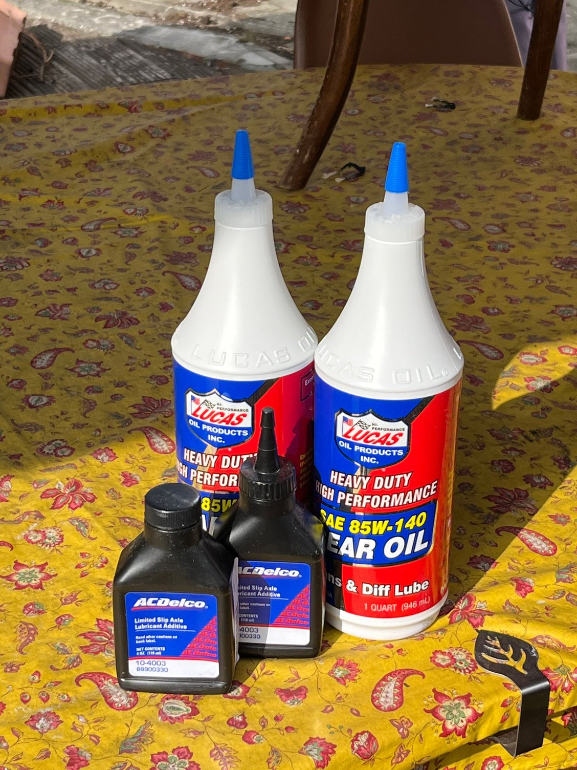

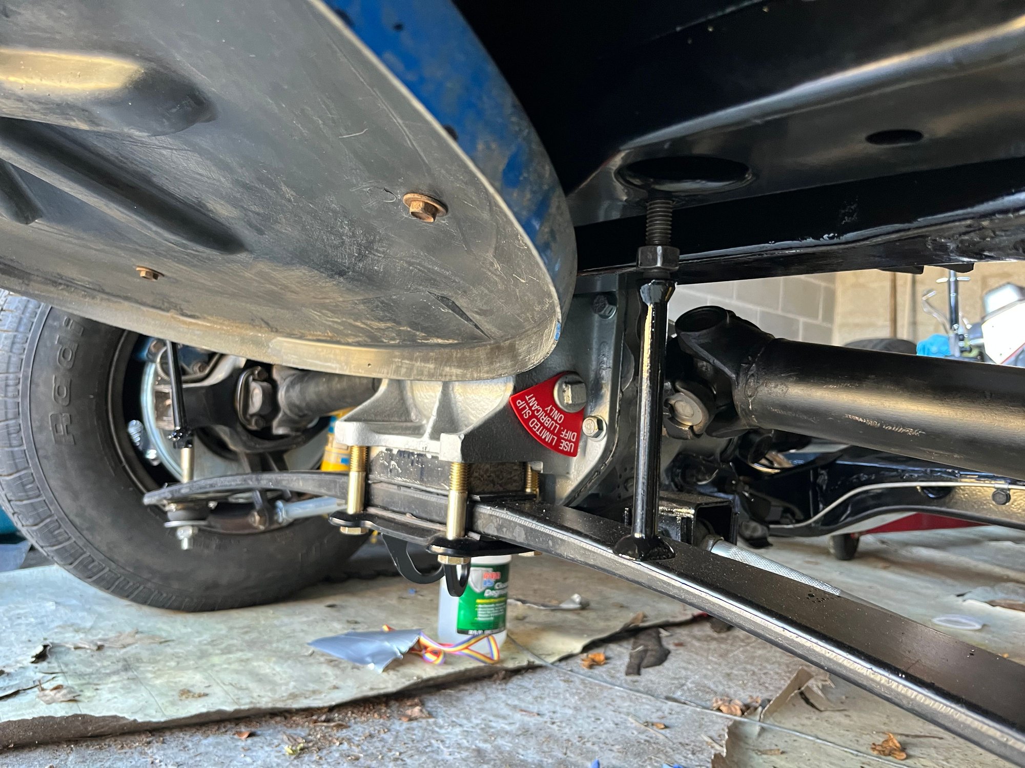

Wow. That was fast. I found this yesterday for sale in the Netherlands. Was slightly challenging to find here. But all good. Will be following Gary’s recommendation. Two bottles of limited slip and top up with Lucas 85W-140

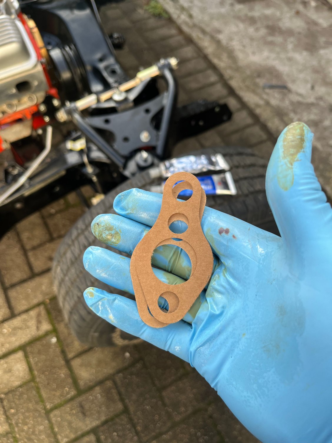

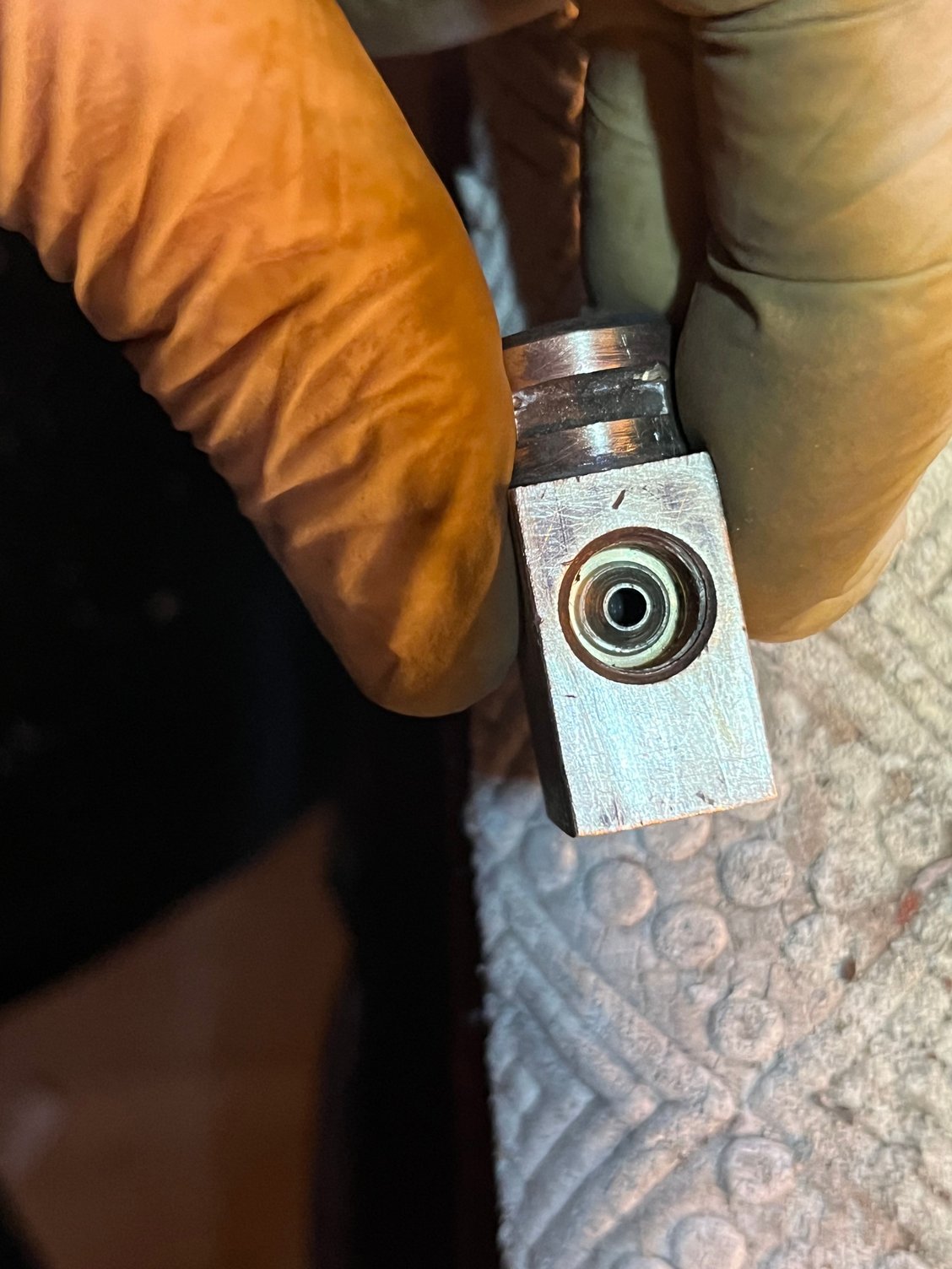

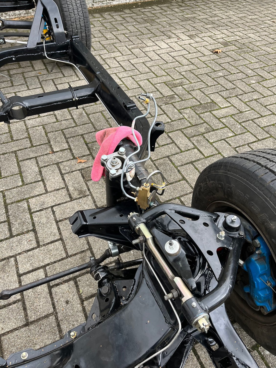

So I completed the brake lines and installed the front shocks. I spent a few hours cleaning them. I also decided to use the conical copper gaskets rather than hoping they stainless steel lines would not leak. I hope those washers did not shift while I installed the lines. I did my best. I could défini feel the washers crushing. I suppose that’s a good sign.

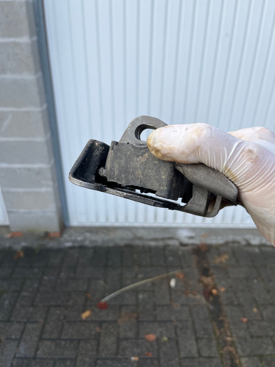

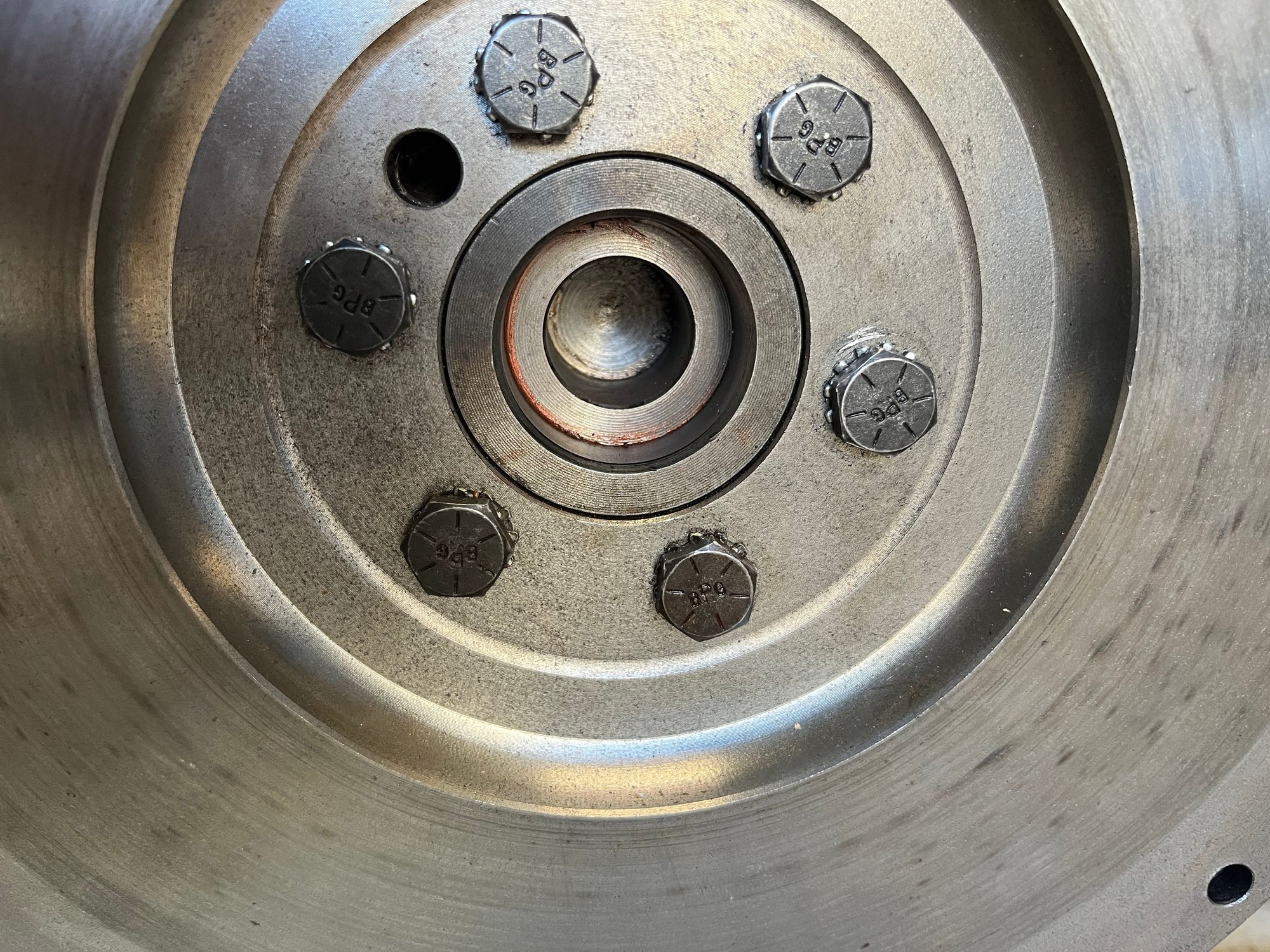

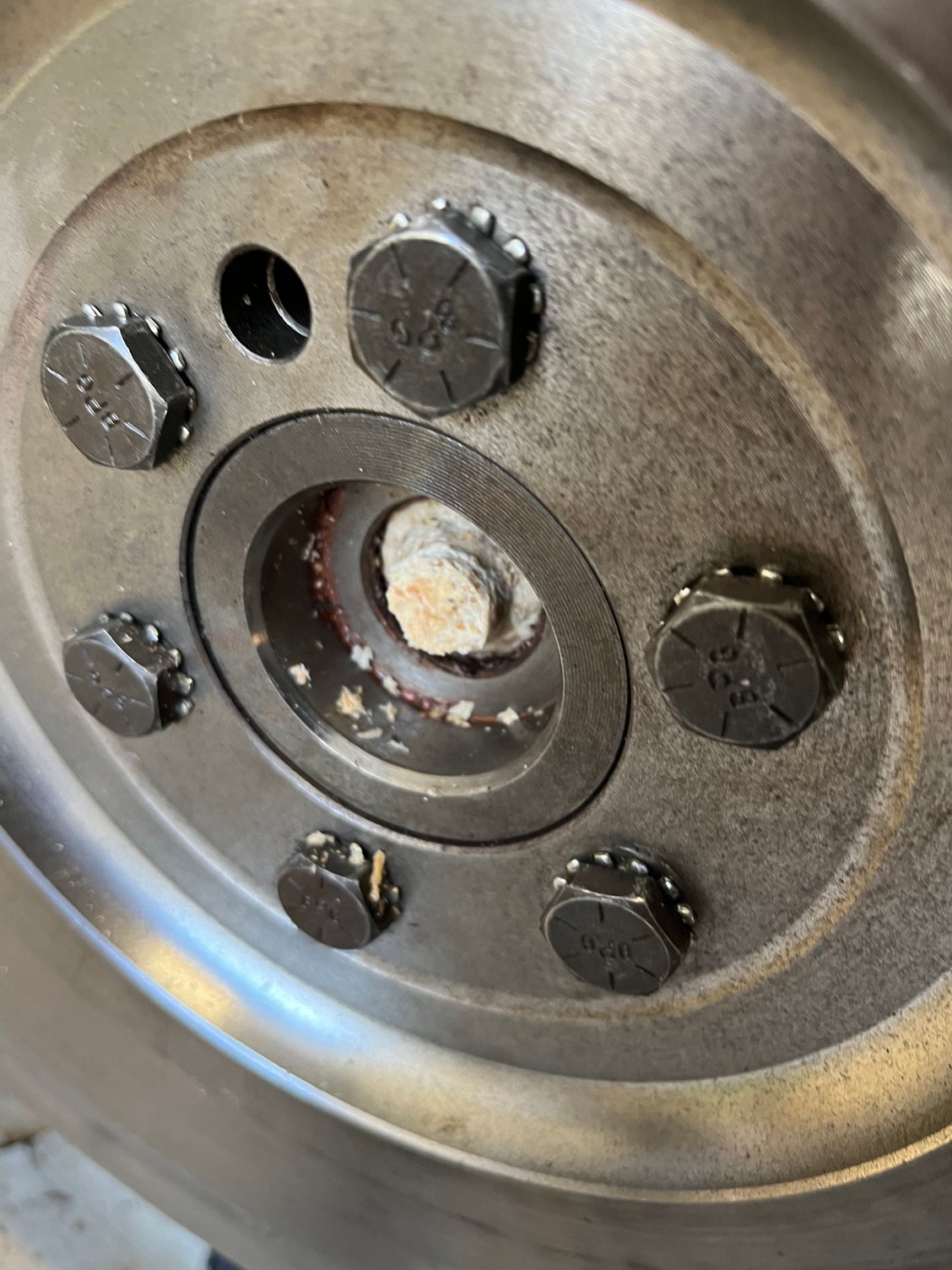

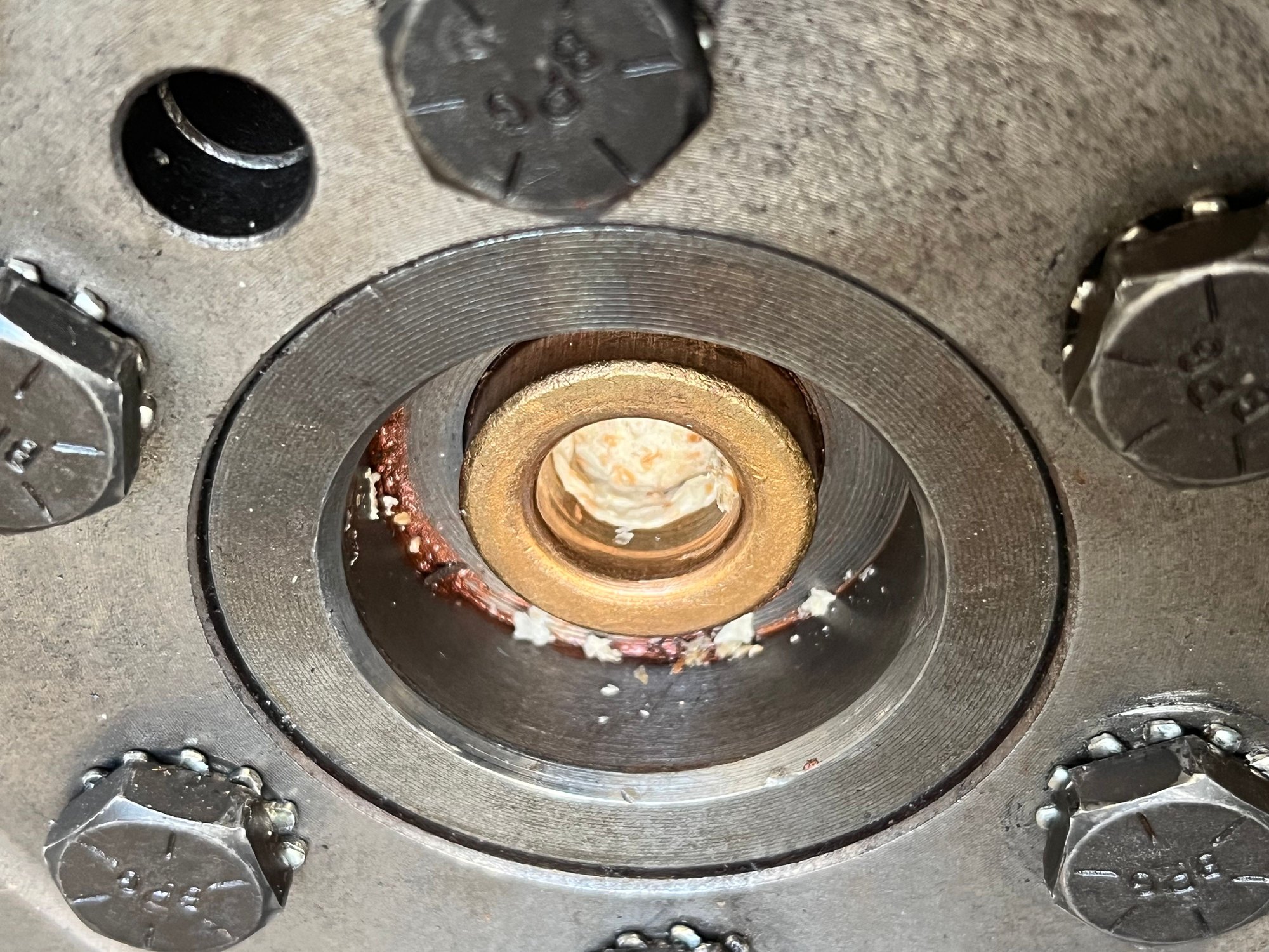

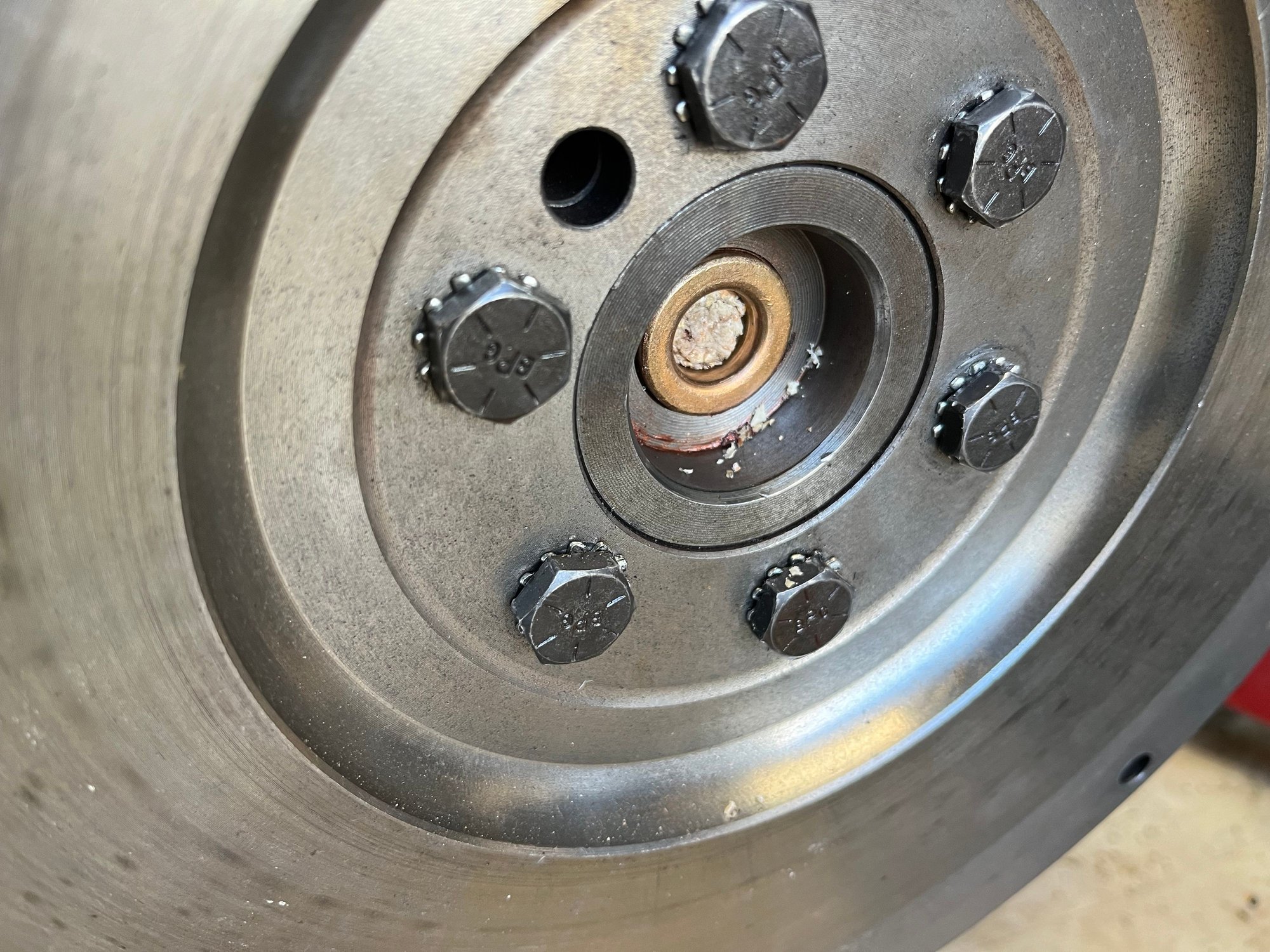

So just when you think the coast is clear to make good progress, you discover something like this:
Looks good, huh ?
Surprise MF !!!
These are three years old. This would explain a lot of vibration issues I had been dealing with.
For now, I am going to install the engine so that I can work on it: remove the pilot bearing, recheck runout, etc.

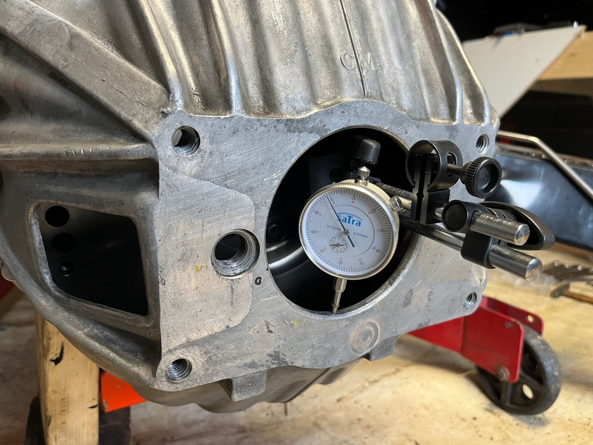

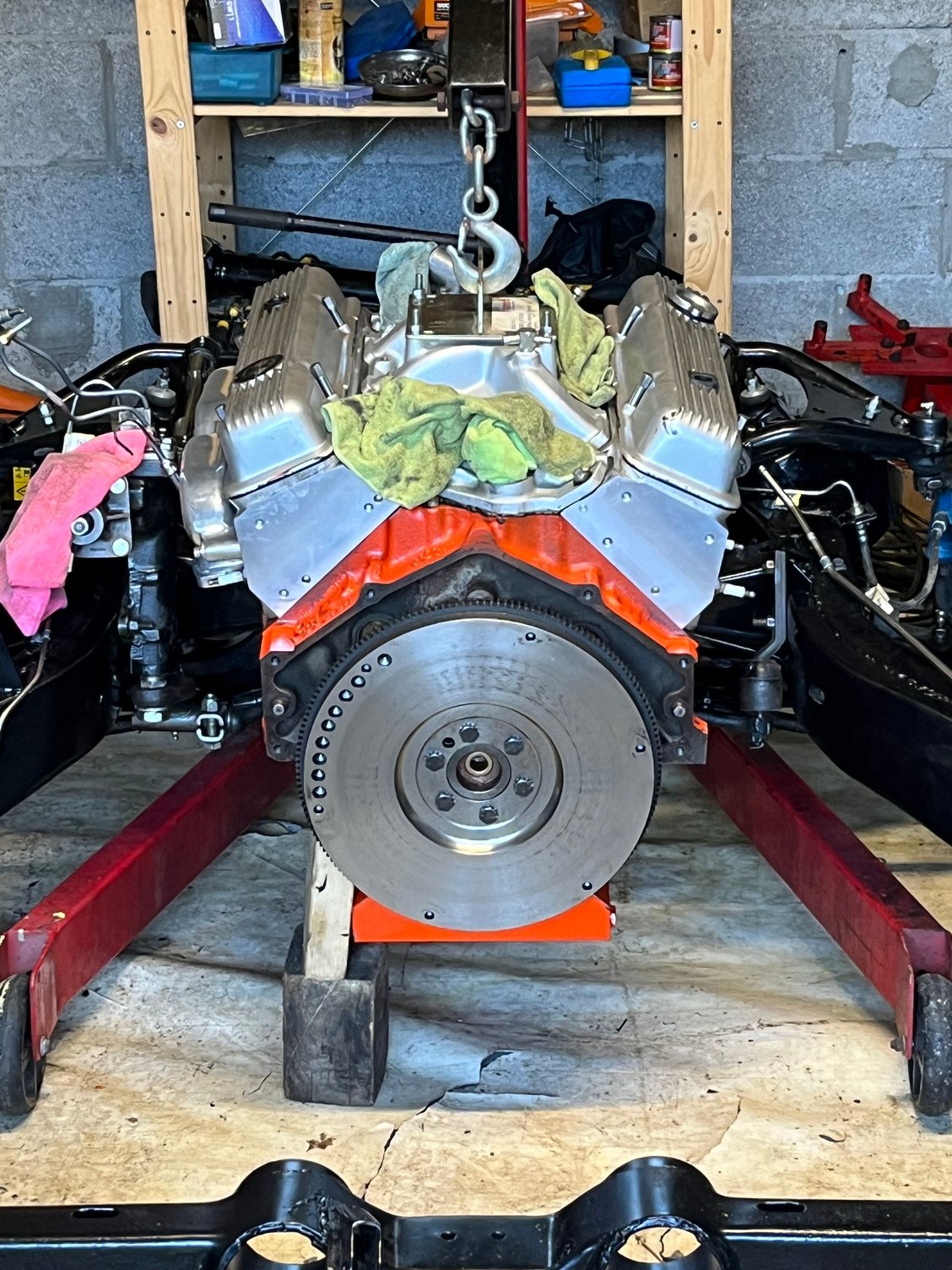

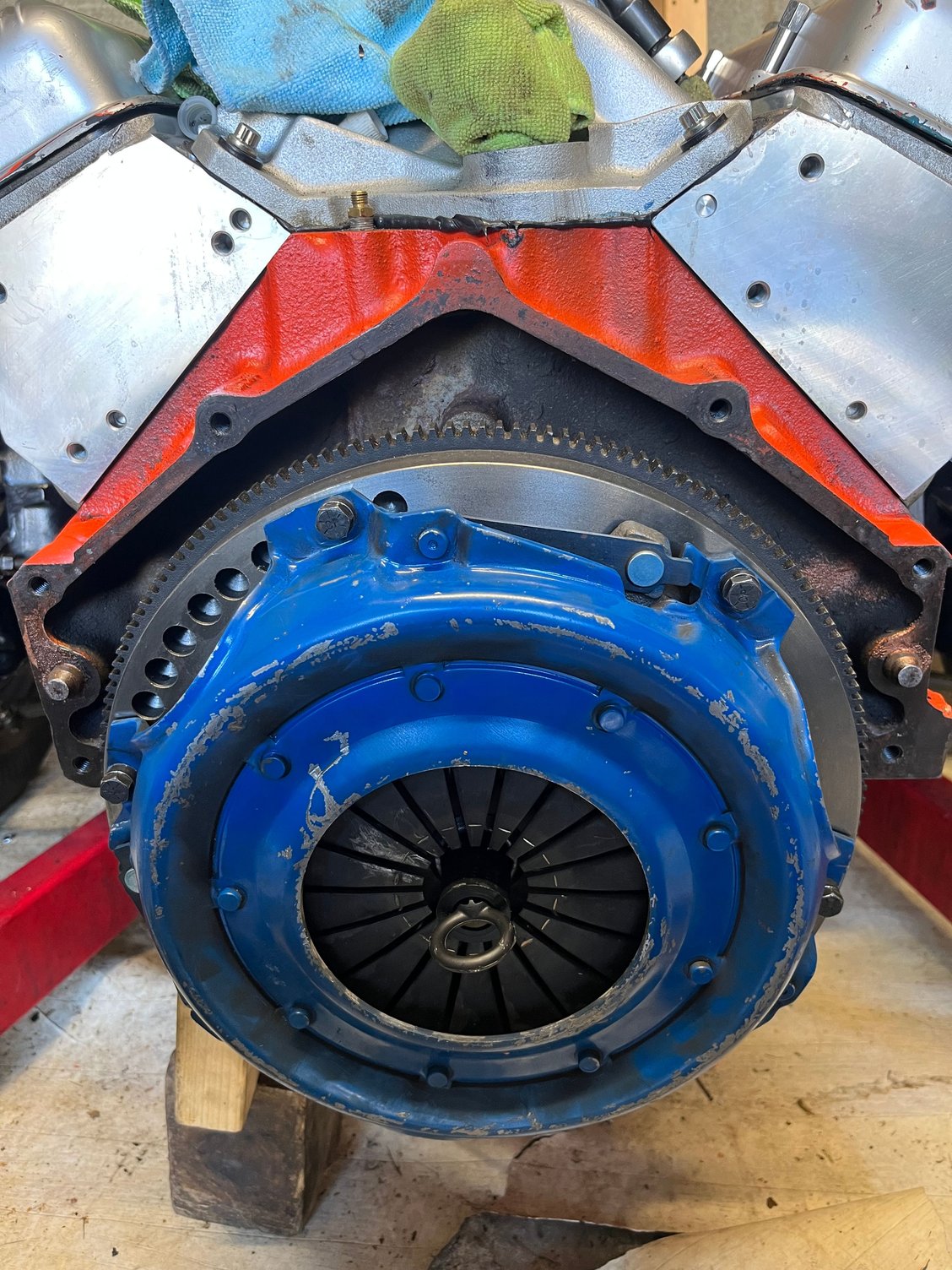

Runout is at 0.0035. Well within spec. #pleased
You can force out a pilot bearing with bread and a mallet ??
Hmmmm
Well I’ll be.
Easy clean up to boot #recommended

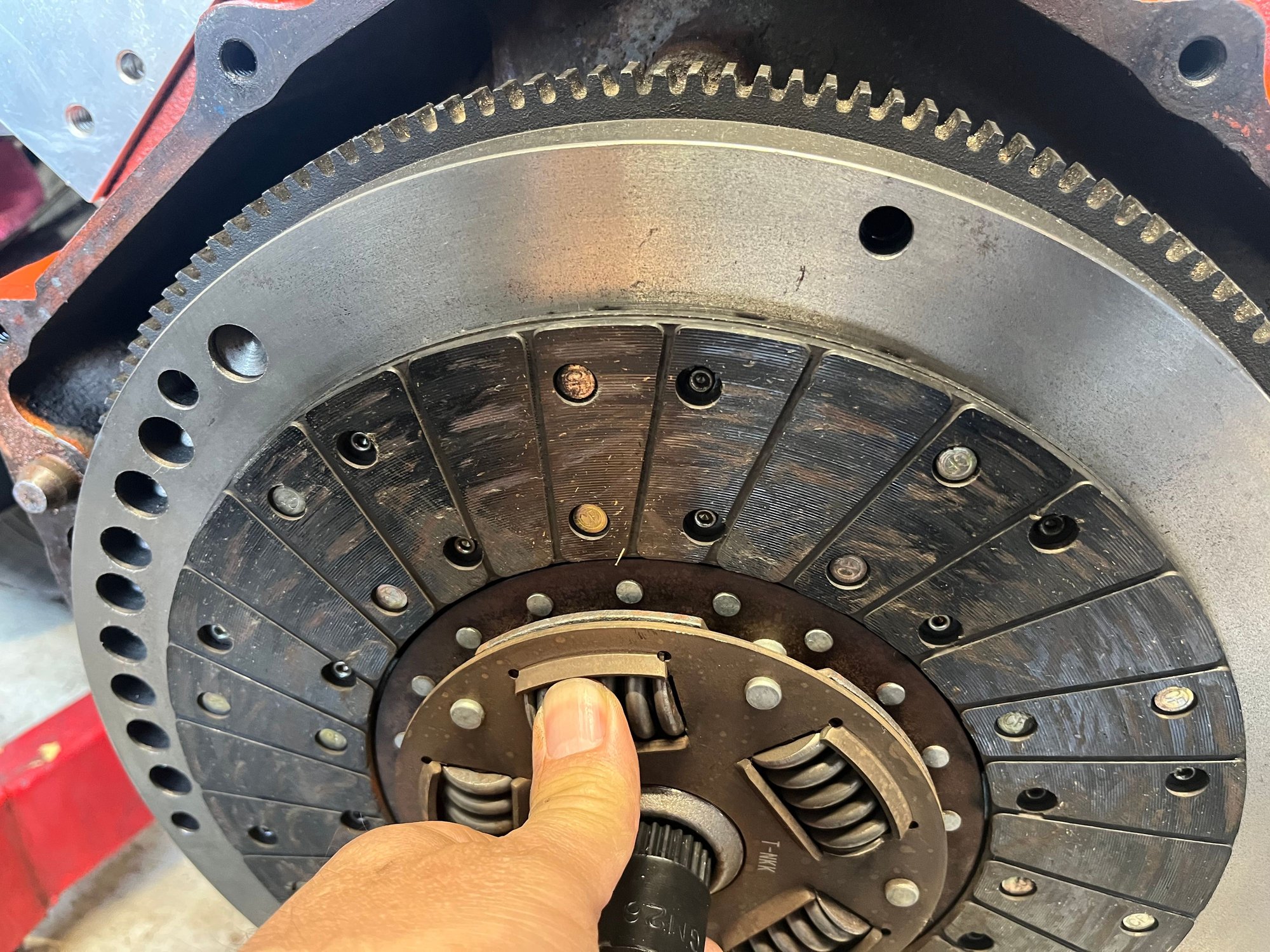

On goes clutch disc after a clean.
Followed by pressure plate. The air gap between pressure plate fingers and throw out bearing is perfect.

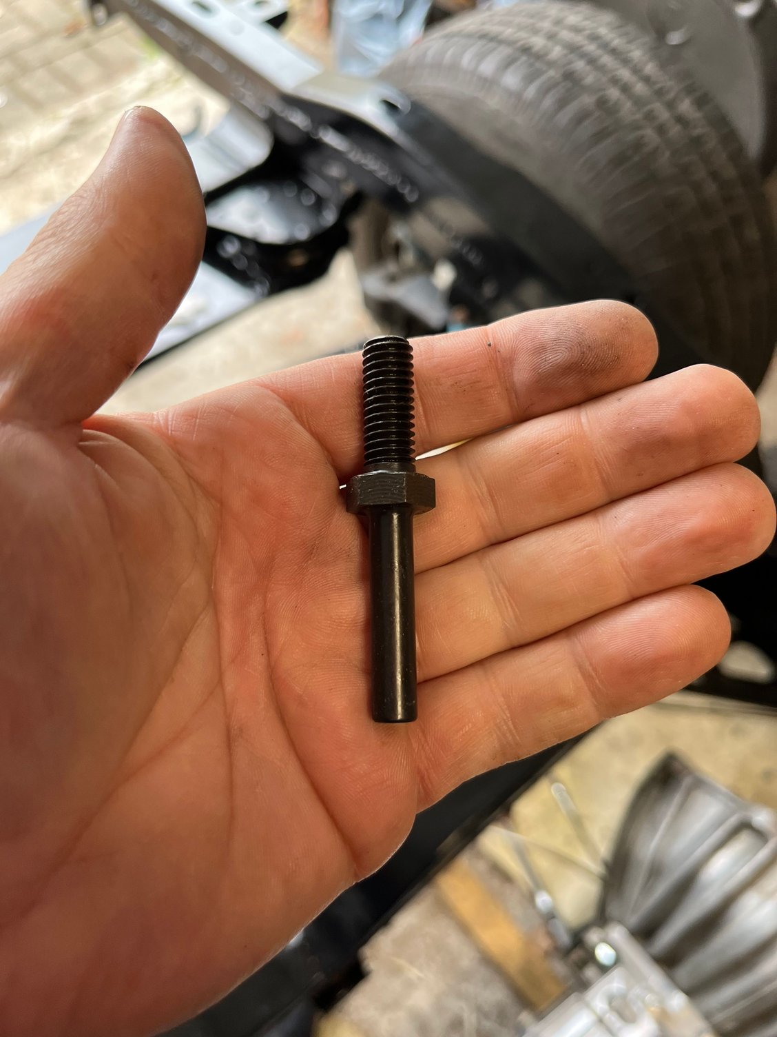

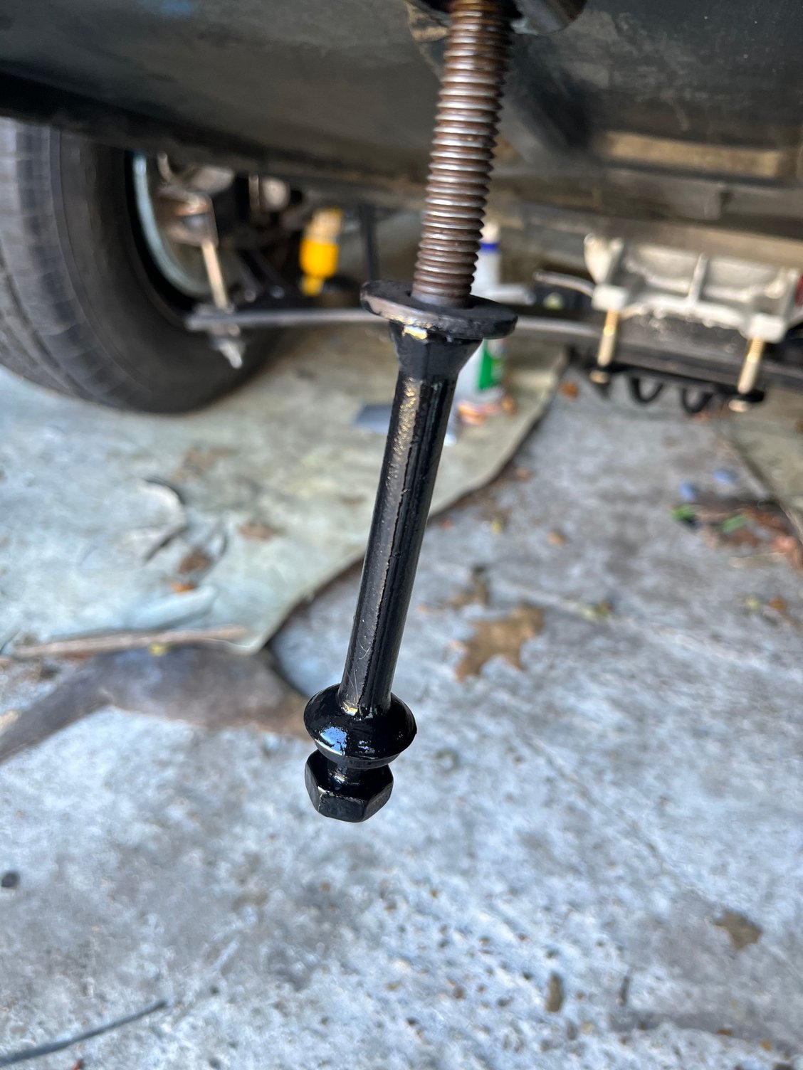

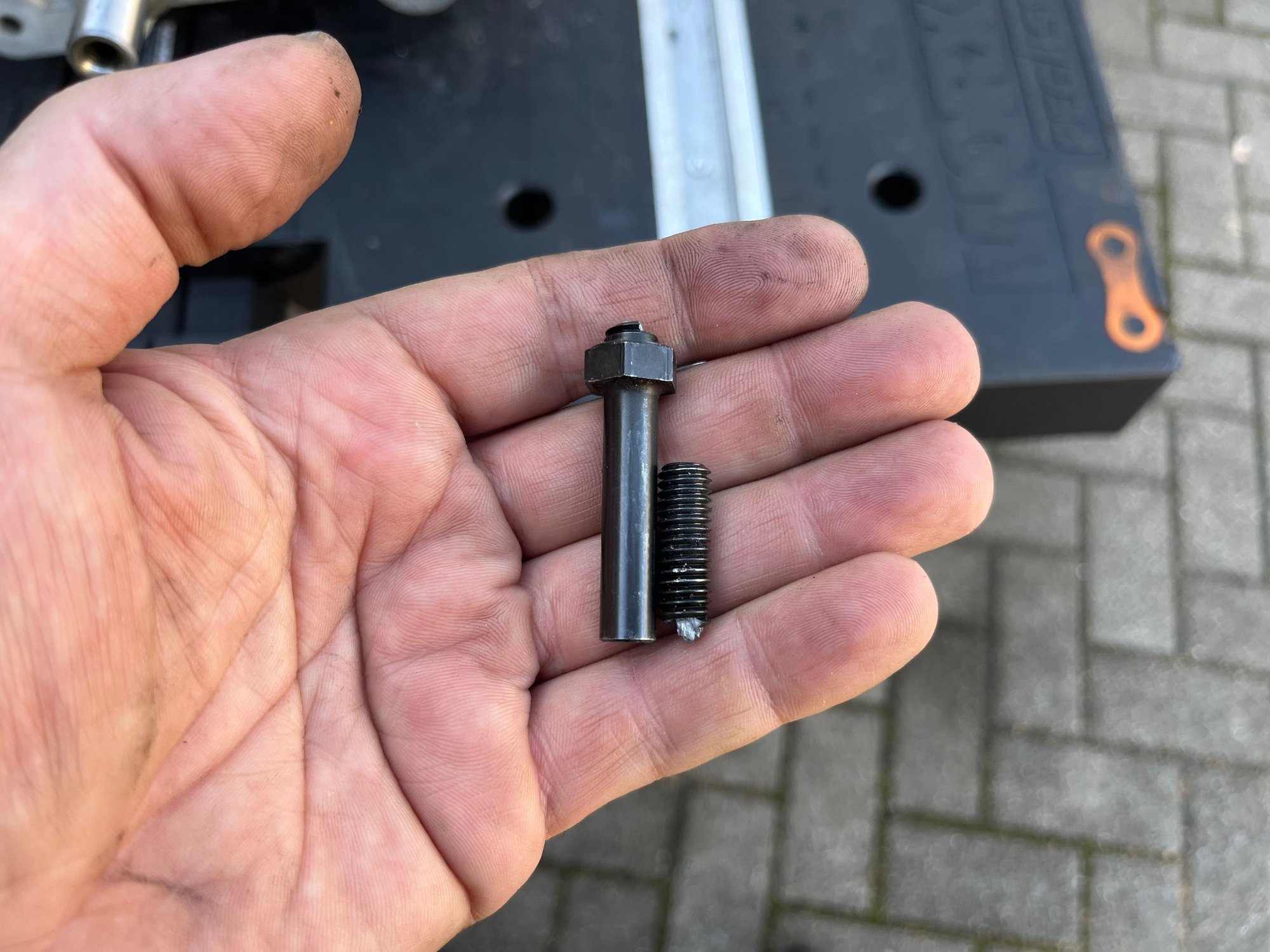

Aaaand a part fails. Add another week and $100 to the build.

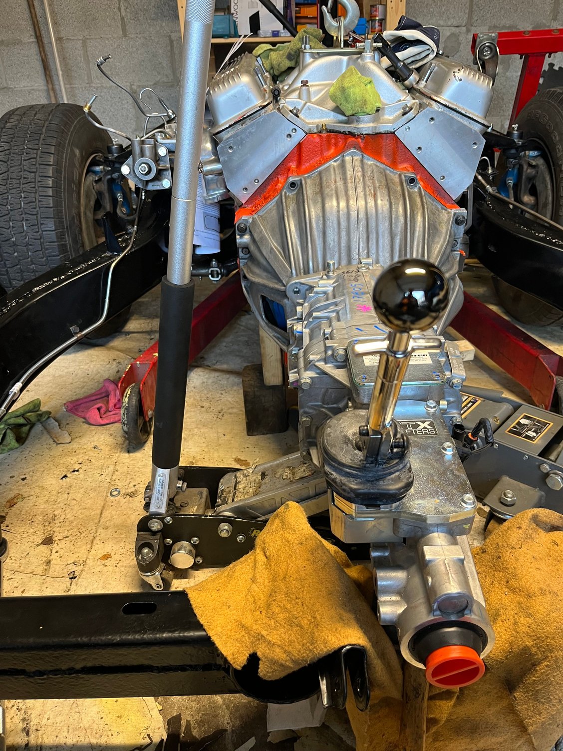

So, despite the broken stud - meaning no hydraulic throw out and a separated engine mount, I could not resist fitting the TKX, if only to play with it a bit and pretend I’m shifting. Take a little love where you can.

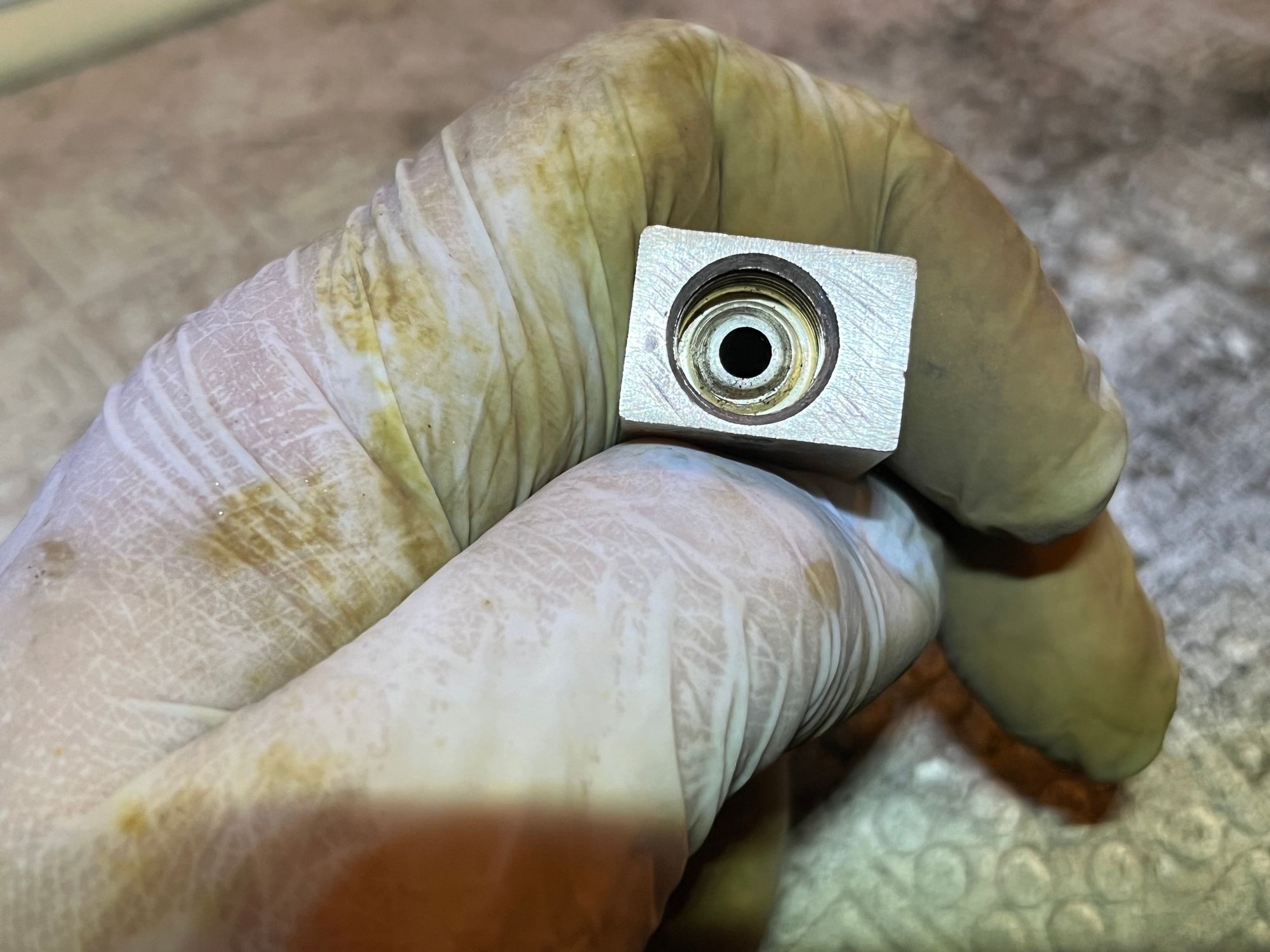

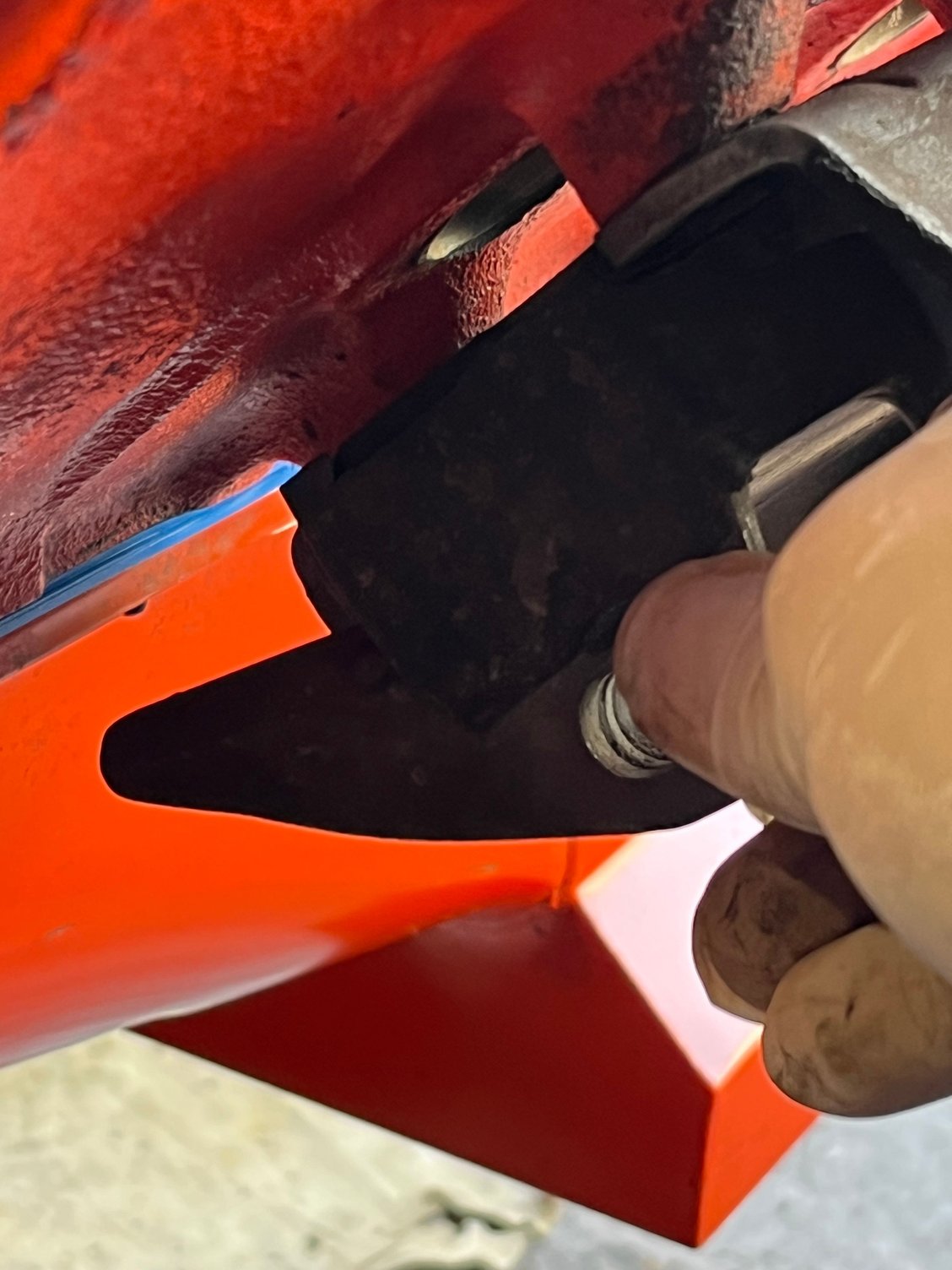

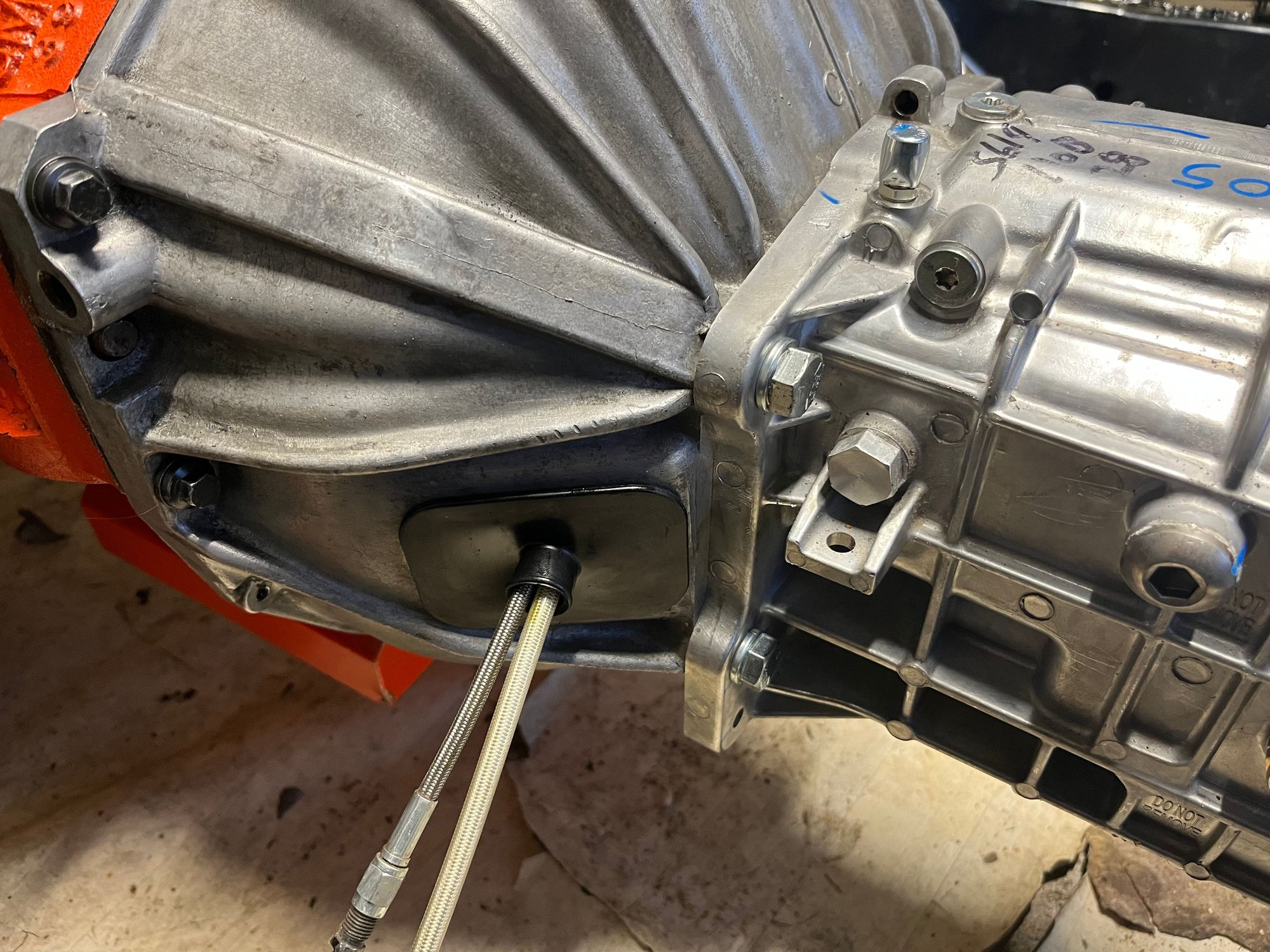

So, this little piece caused all the fuss. Ten day delay and $100+ expense.
Satisfying to see the new dust boot in place.

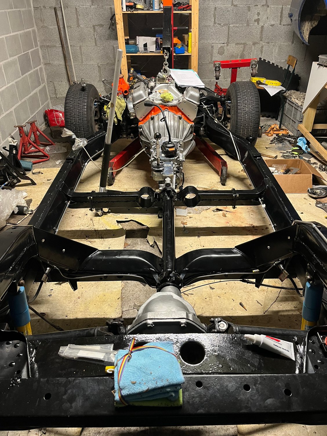

Seems to line up fine… but that’s with a sheared off motor mount. With solid mounts, this could be an issue. Beginning to look vaguely like a car.

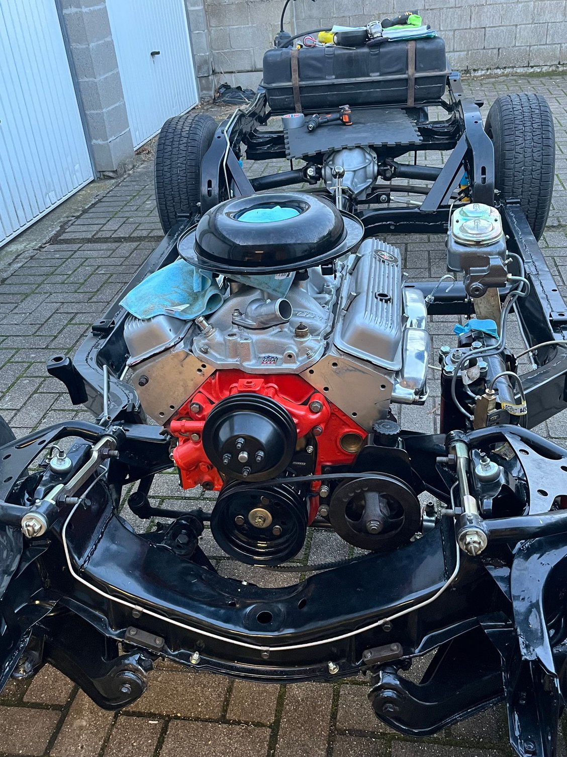

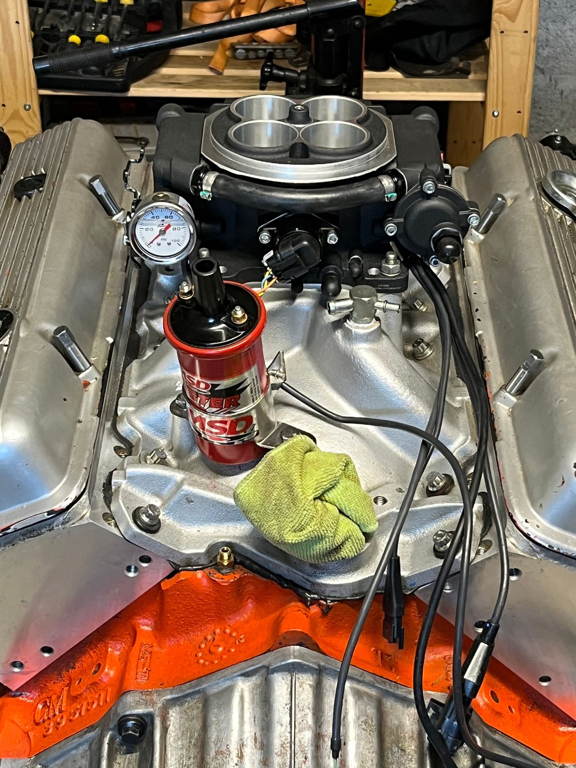

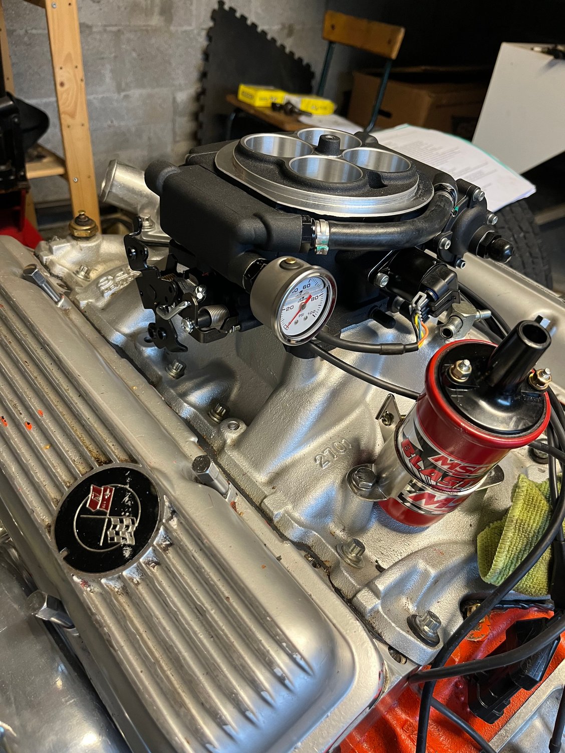

Test fitting the new Holley Sniper. Making sure the fuel pressure gauge clears.
Just another view.

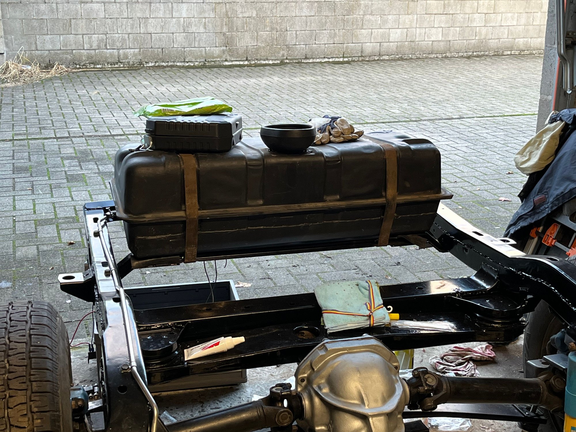

Gas tank is on. (Slowly my basement is getting decluttered.) Anti squeak reinstalled.

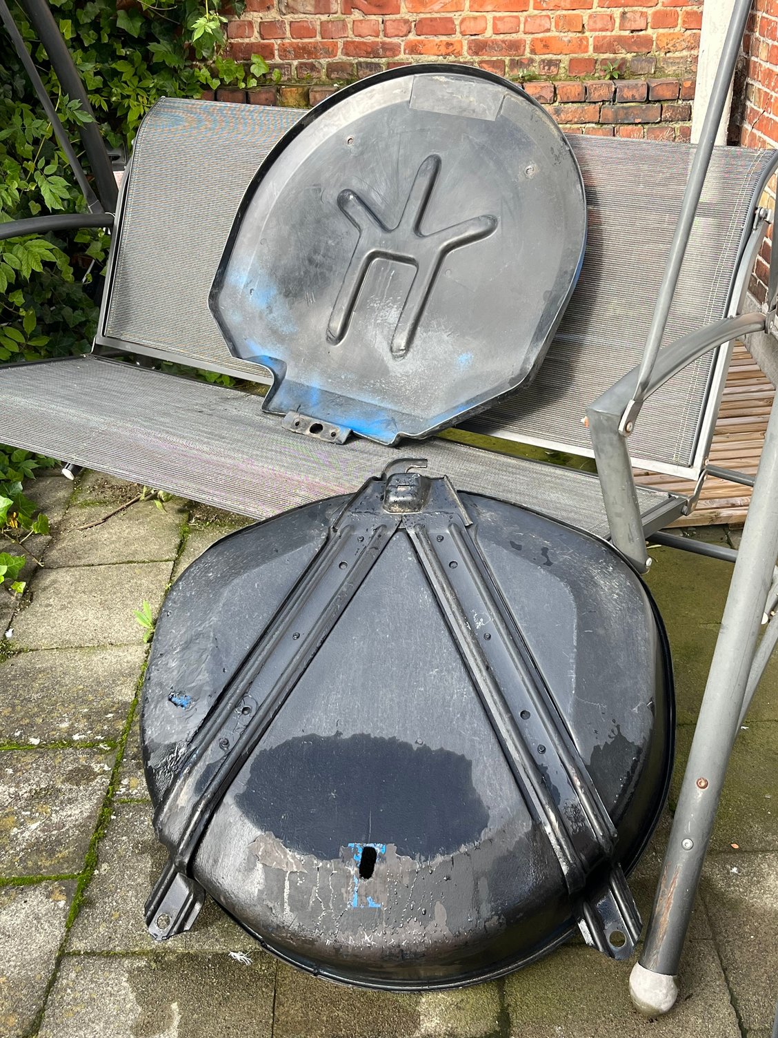

These probably have never been cleaned. I wonder if a should patch up that hole or allow for drainage ? Either way, it needs some work. It’s ugly AF. This will be my first hand at working with glass.
I would note that the PO had deviously put some duct tape on hole and painted over it.

Looking awesome.
I purchased the same coil and bracket for my engine.
I’ve since decided to move the coil from on top of the intake just to reduce the amount of heat it will be subjected too.
I know that’s how the factory mounted them but coils don’t last as long subjected to heat.

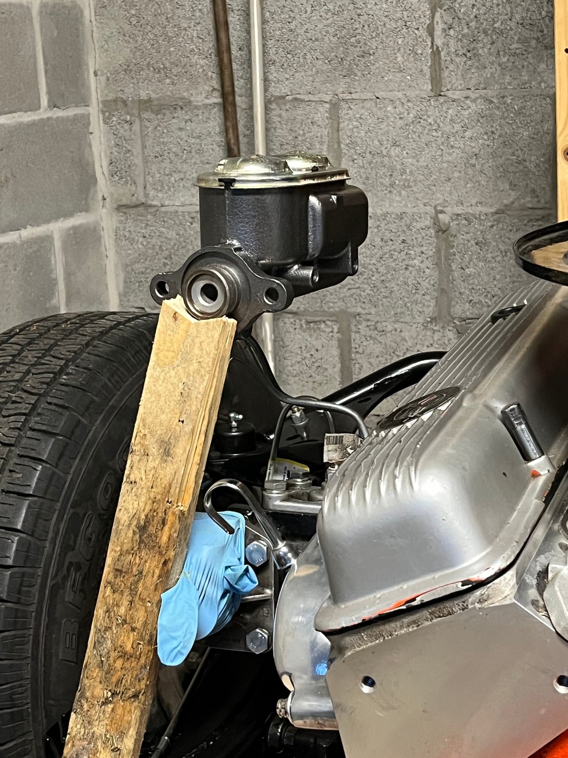

Not much done today but very oh so satisfying.

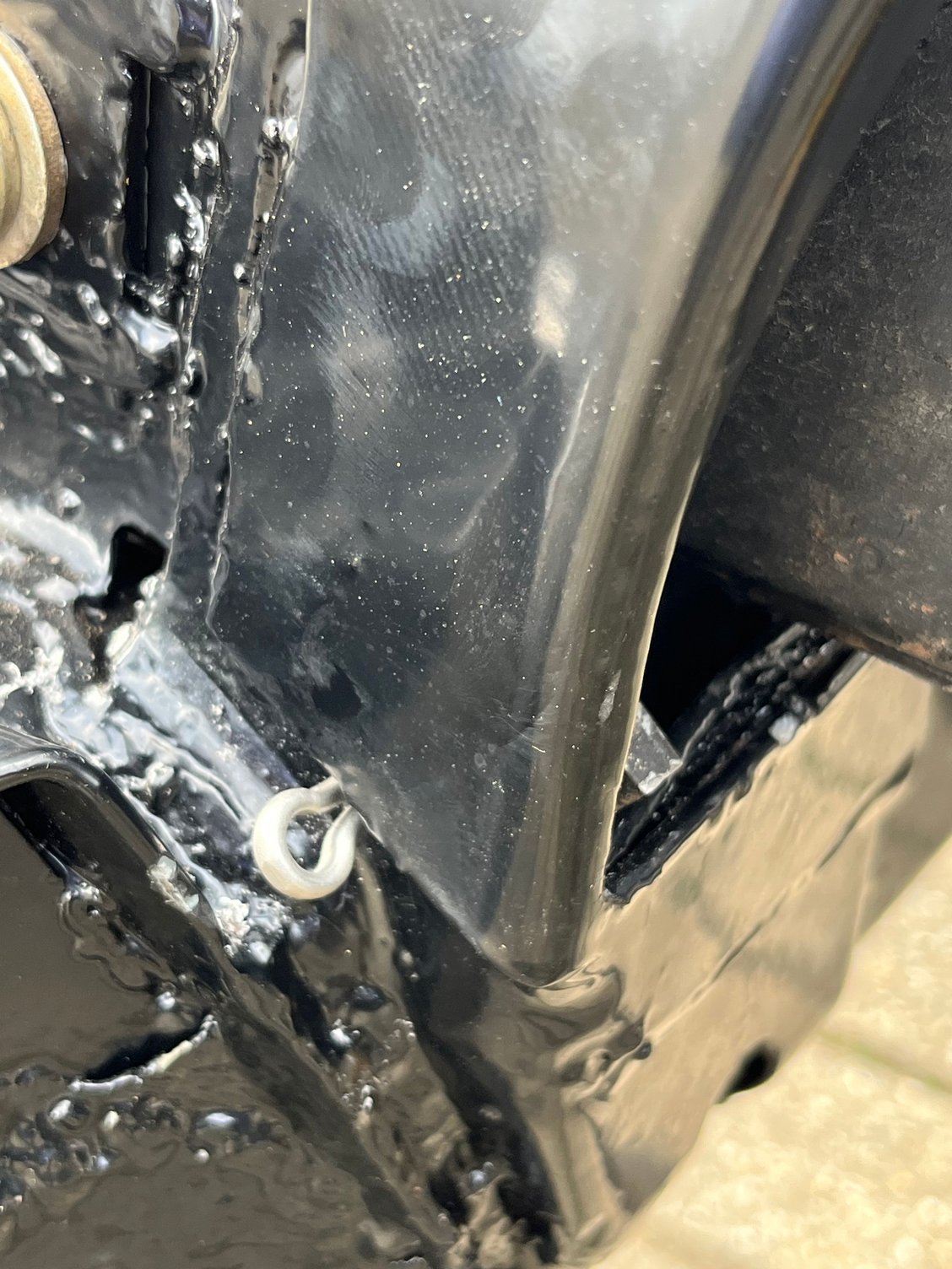

This one had been bothering me for a little while. The 1969 did not come with holes allowing for extra long cotter pins to retain the shims. With the body off, drilling was a cakewalk.

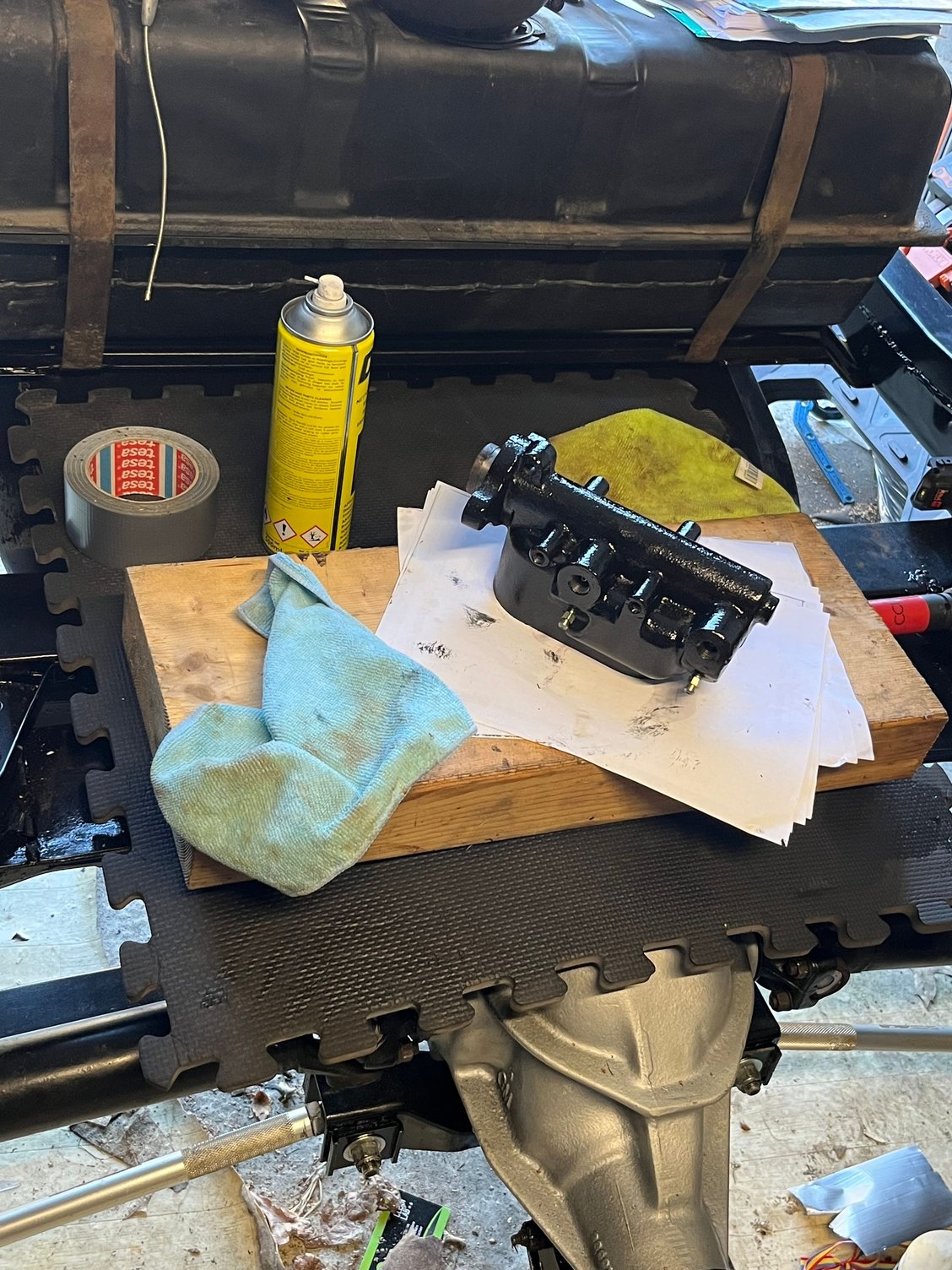

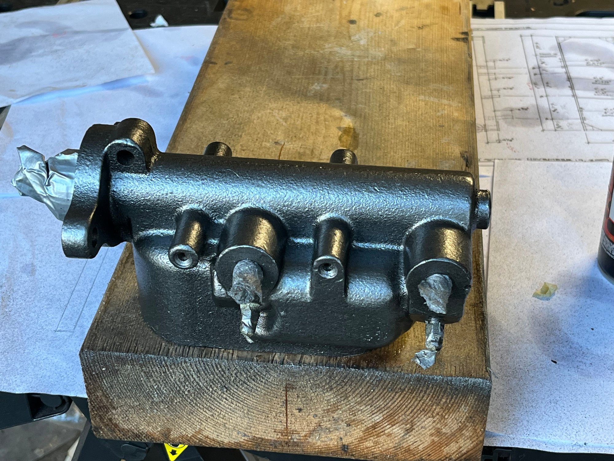

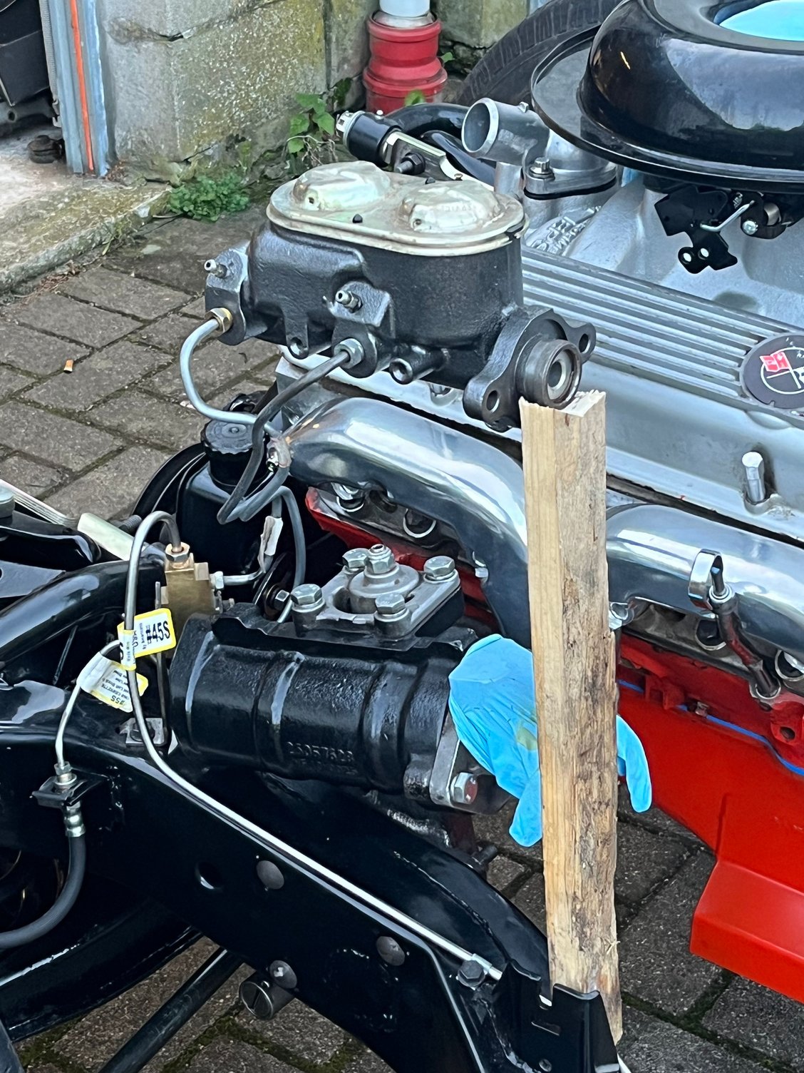

Tomorrow or this weekend I will fill the master cylinder and bleed the entire system. I’m hoping I’ll be able to find a way to actuate the piston and reveal any leaks the stainless steel lines might have. For now, I’ll support the master cylinder like so.
Power steering pump touched up. I believe I found the leak; the return line was not tight.
Another view of the master cylinder. Not sure that paint by Eastwood or POR-15 looks like cast iron to me. It looks darker on this picture.

Old Nov 1, 2023 | 01:05 PM
  #700
leigh1322's Avatar
leigh1322
Old Pro Solo Guy
Posts: 8,127
Likes: 4,488
From: Marlton NJ
Tip:
You should bench bleed the master cylinder.
Then once the lines are hooked up you might be able to use a big C-clamp to stroke the MC piston.
