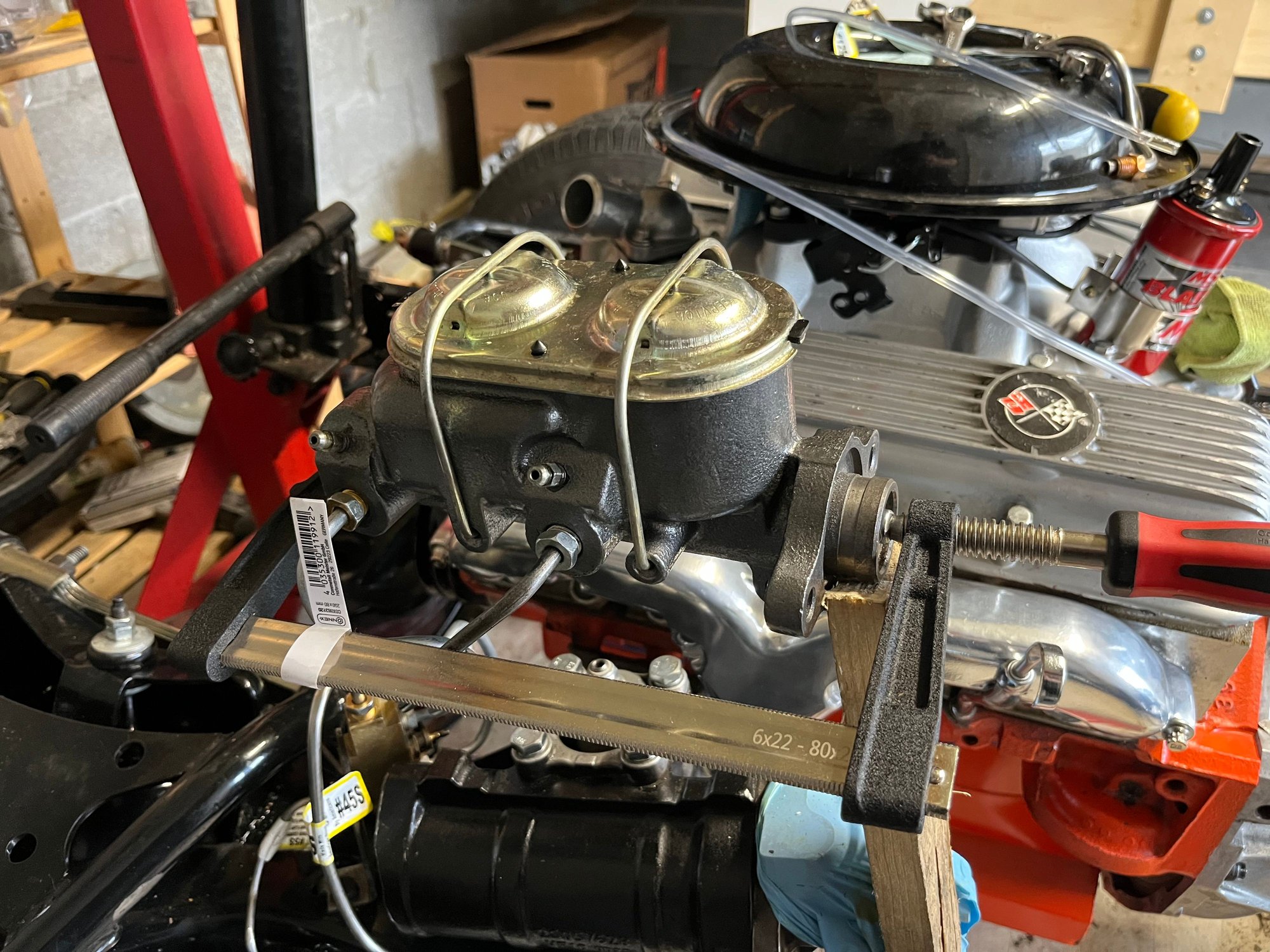

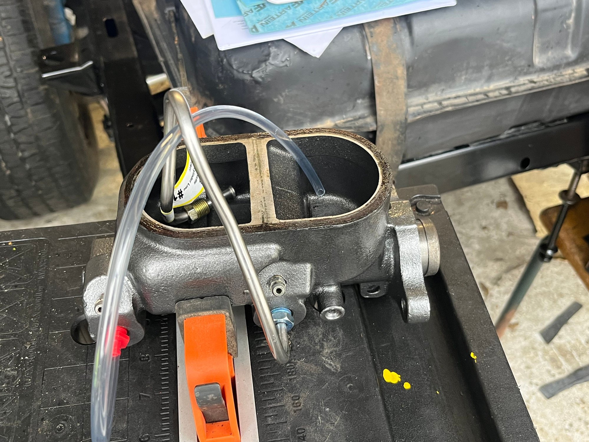

You should bench bleed the master cylinder.
Then once the lines are hooked up you might be able to use a big C-clamp to stroke the MC piston.
That’s what I’m thinking. Stay tuned !!!! I’ll be using that pressure bleeder thing. It works great !

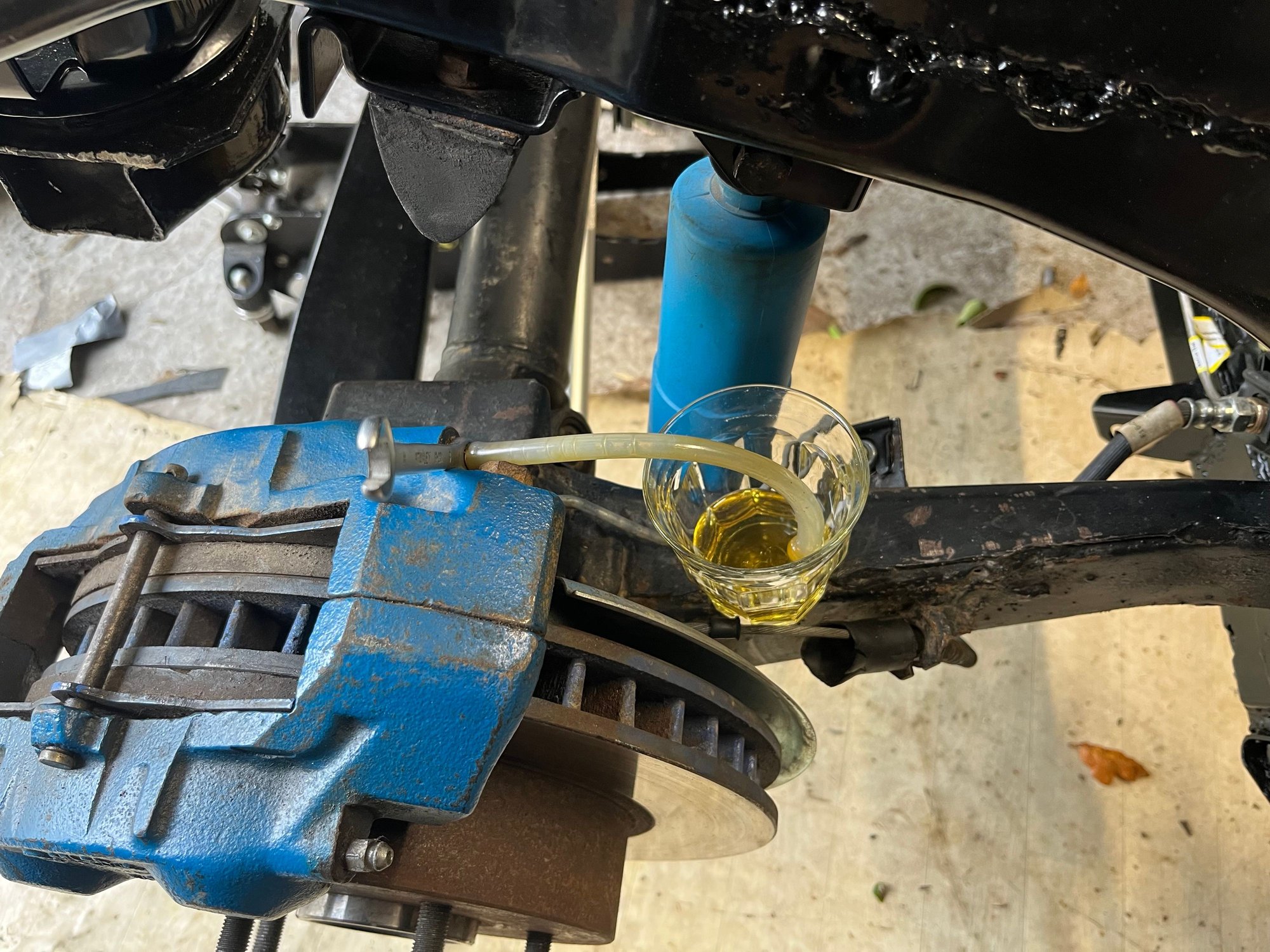

Done !!!!
I bench bled the master cylinder; but to be fair, with the power bleeder that pressurizes the MC, I don’t think this is a necessary step. It pushes the fluid right through.
I really like the power bleeder. Just open bleed and wait till bubbles are gone. Just don’t let the MC run dry.
That being said, the chains suck. You are better off using clamps.
And a c-clamp to test. I’m happy to report: zero leaked of the SS lines. I dreaded that.

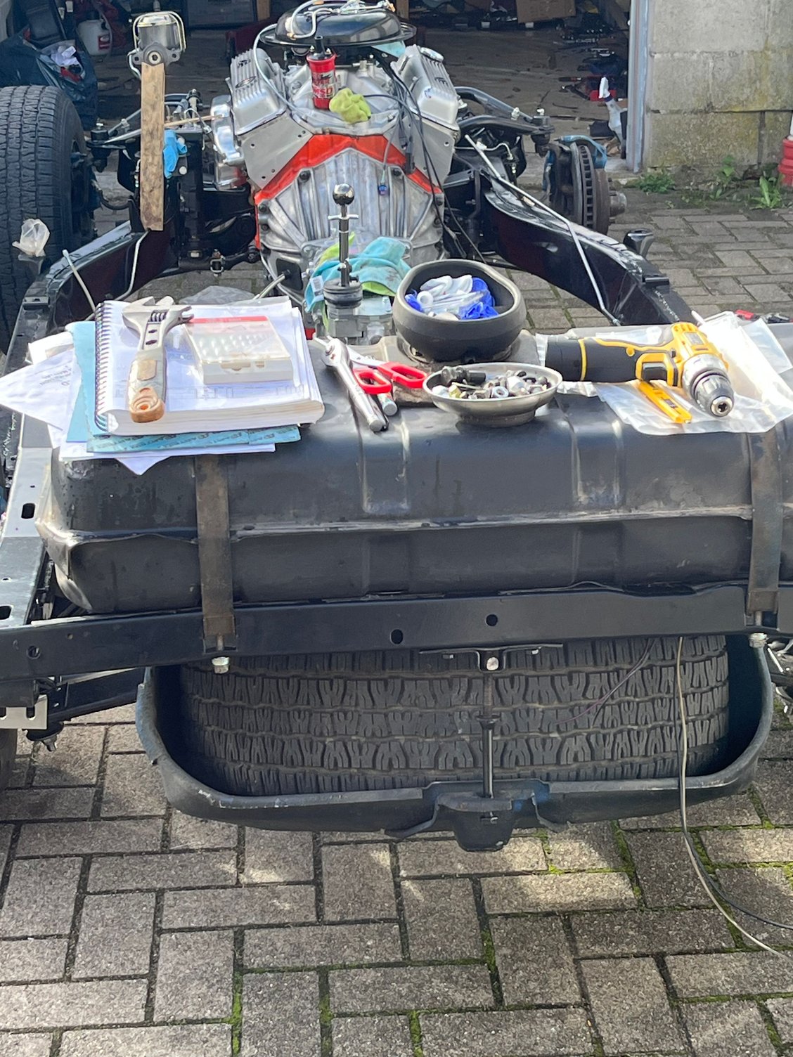

I temporarily installed the tire basket with my front in there. It has been empty since I took over the car. I did find a spare over here - not a straightforward feat. Thankfully, it seems to fit. I will have to repair the glass and paint. The PO patched a hole in the tire basket with duct tape and then painted over

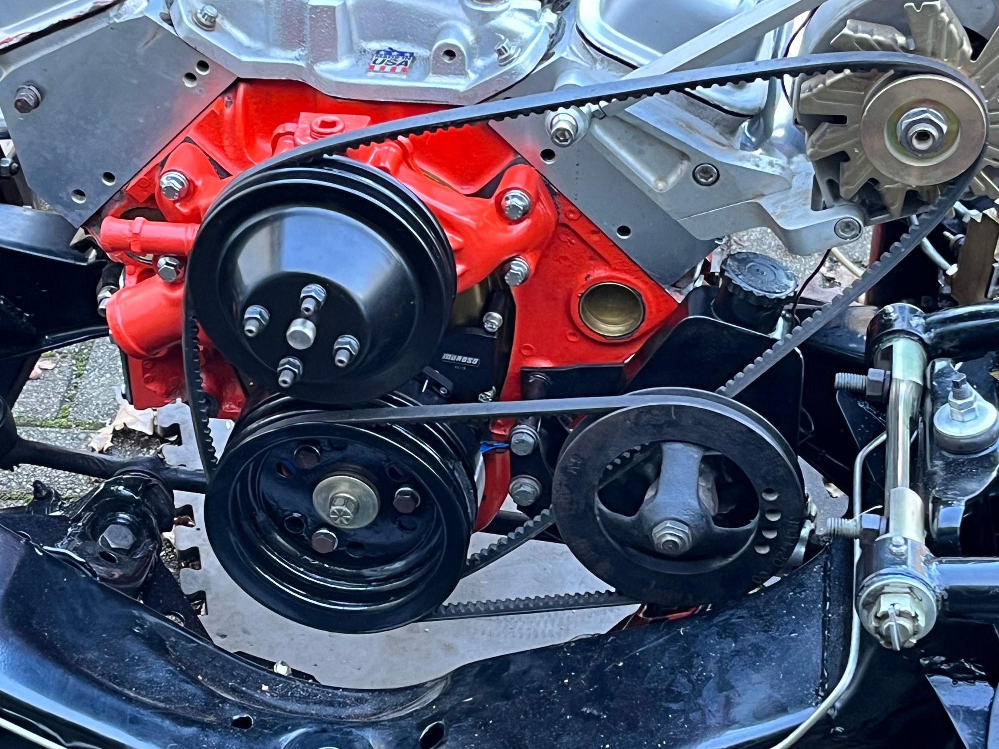

And yes…. I also did the pulley alignment check and wound up shimming

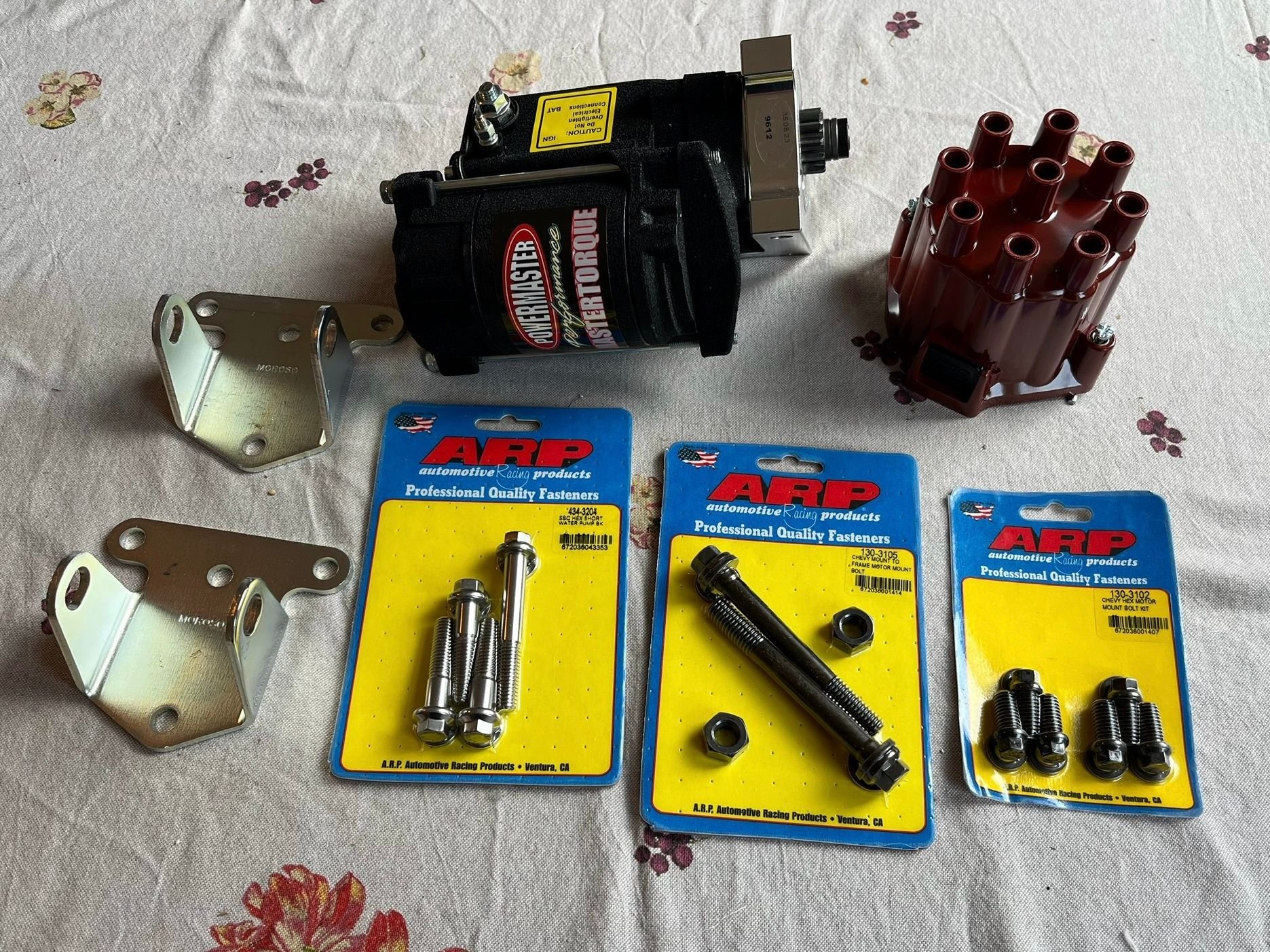

So finally, muh parts got here today. Due to a tightening of EU regulations on Russian steel, it only took 3 weeks to get here.
The small cap because I want to reinstall OEM shielding tin. As I understand the post caps will not clear. ARP because once you start using them, you get addicted to the quality and want it everywhere. The solid motor mounts because 400CID torque and the mini-starter because my current one is in poor shape and I’m tired of it threatening to fall on my face when I’m under the car.

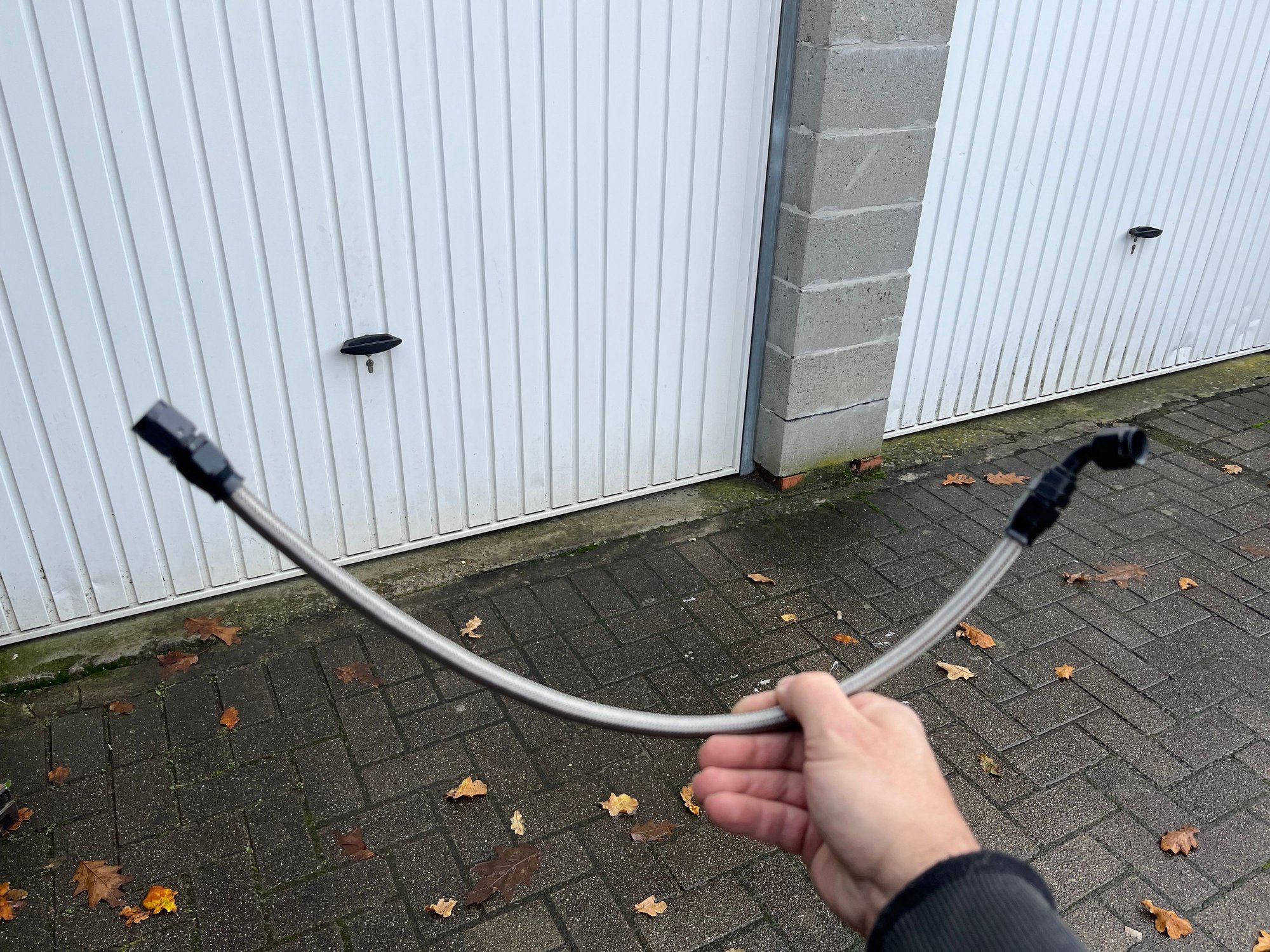

Teflon fuel lines. Made to measure. I’ll pressure test on turkey day.

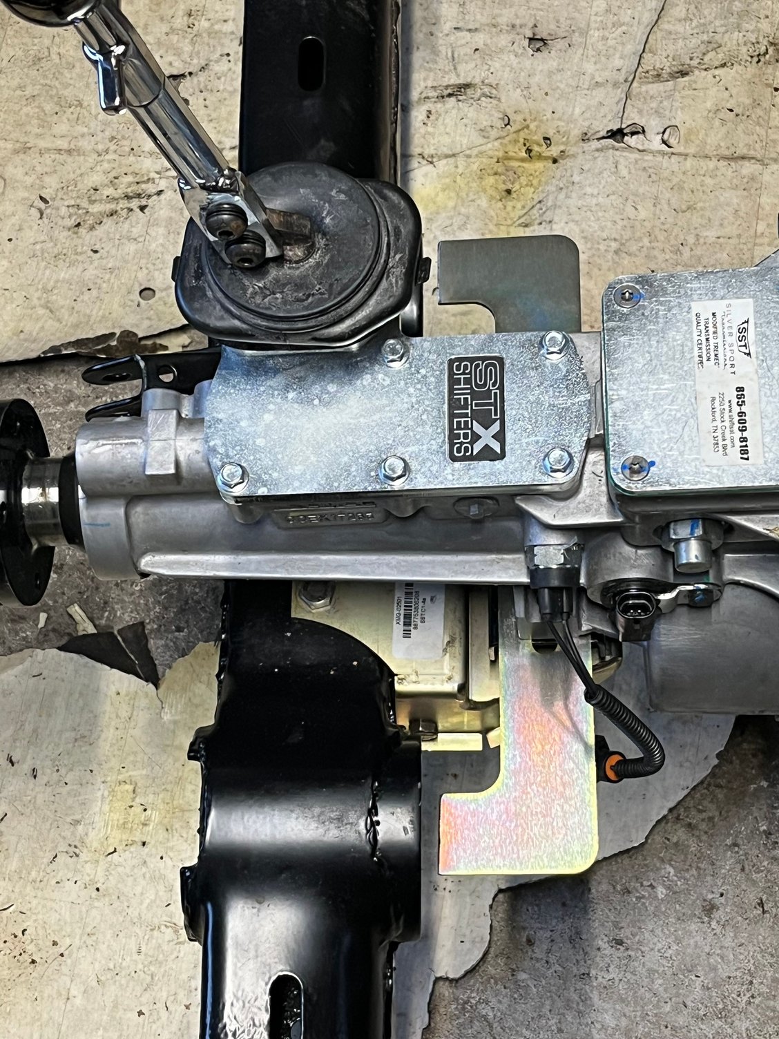

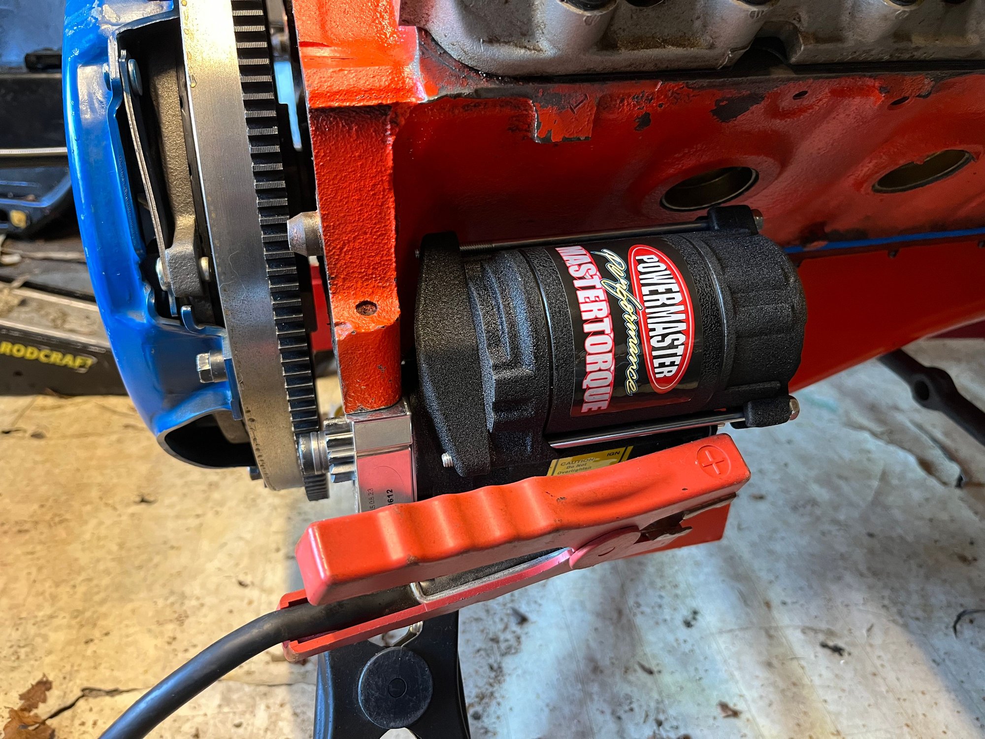

So, correctly installed the new mini-starter and tested it.
A shim was required. But other than that fine. It spins well.

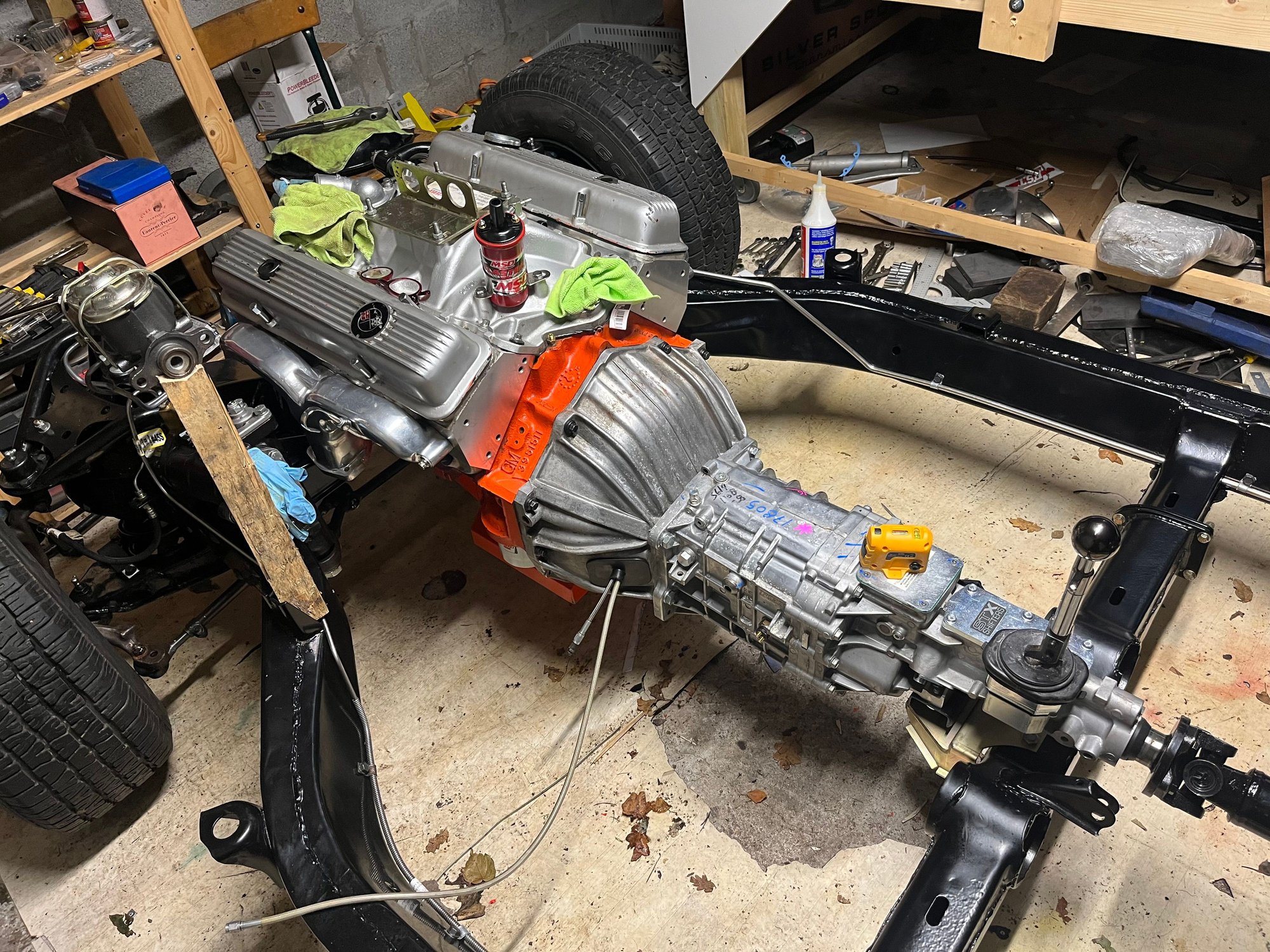

Problems started soon thereafter. The solid motor mounts have the trans pointing a little left (driver’s side) of the crossmember bracket.
With the rubber mounts, all I had to do was pry it over a little and that was fine.
With the solid mounts - first off it was very difficult to seat the engine. Now it is significantly off. With a ratchet strap I managet to get all the bolts in, but I am worried about the pressure the frame is under. I’ll try swapping out one solid mount for a rubber mount (driver’s side).
I hop I didn’t screw up the removable cross member.

I’m sure you know this, but the engines in these cars are mounted off center.
Did you compensate for this when you built the new crossmember?
Old Nov 23, 2023 | 02:00 PM
  #713
DorianC3's Avatar
DorianC3
Joined: Nov 2017
Posts: 2,352
Likes: 518
I did. Or at least I cut as carefully as I was skilled to do. From what I could tell I was off by a 1/16 or so. At least that’s what I believe I managed.
In any case, I kept the solid mount on the driver’s side and went back to rubber on the passenger side. This feels much better. You still need to pry it some, but only a little.

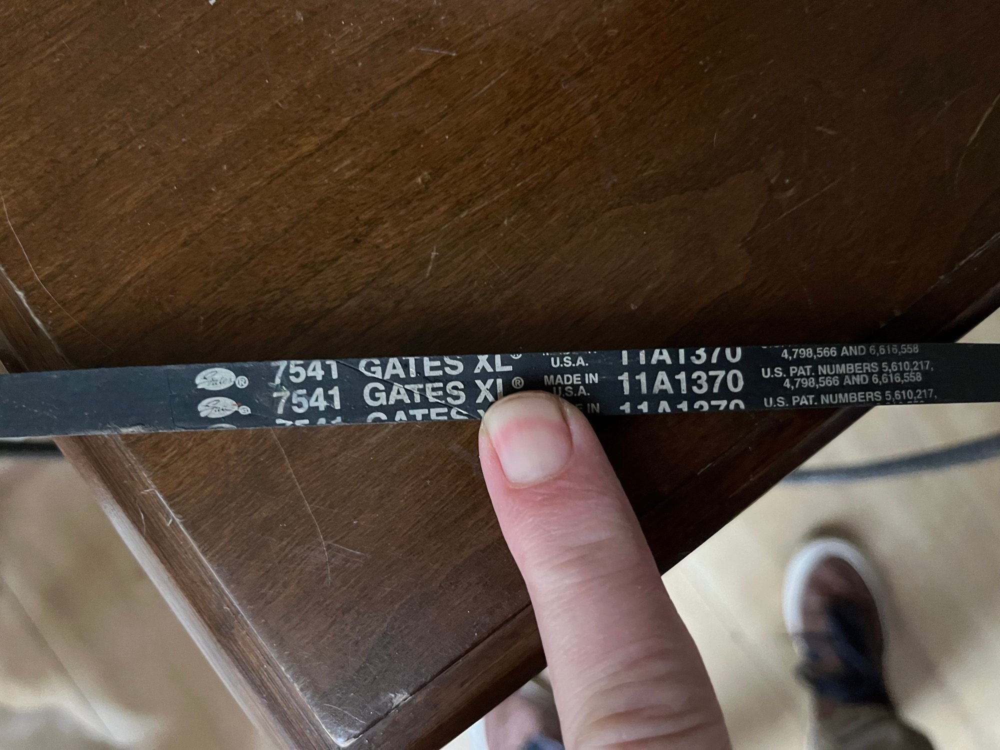

I fitted the power steering pump. That looks fine. The belt for alternator is too loose IMHO.

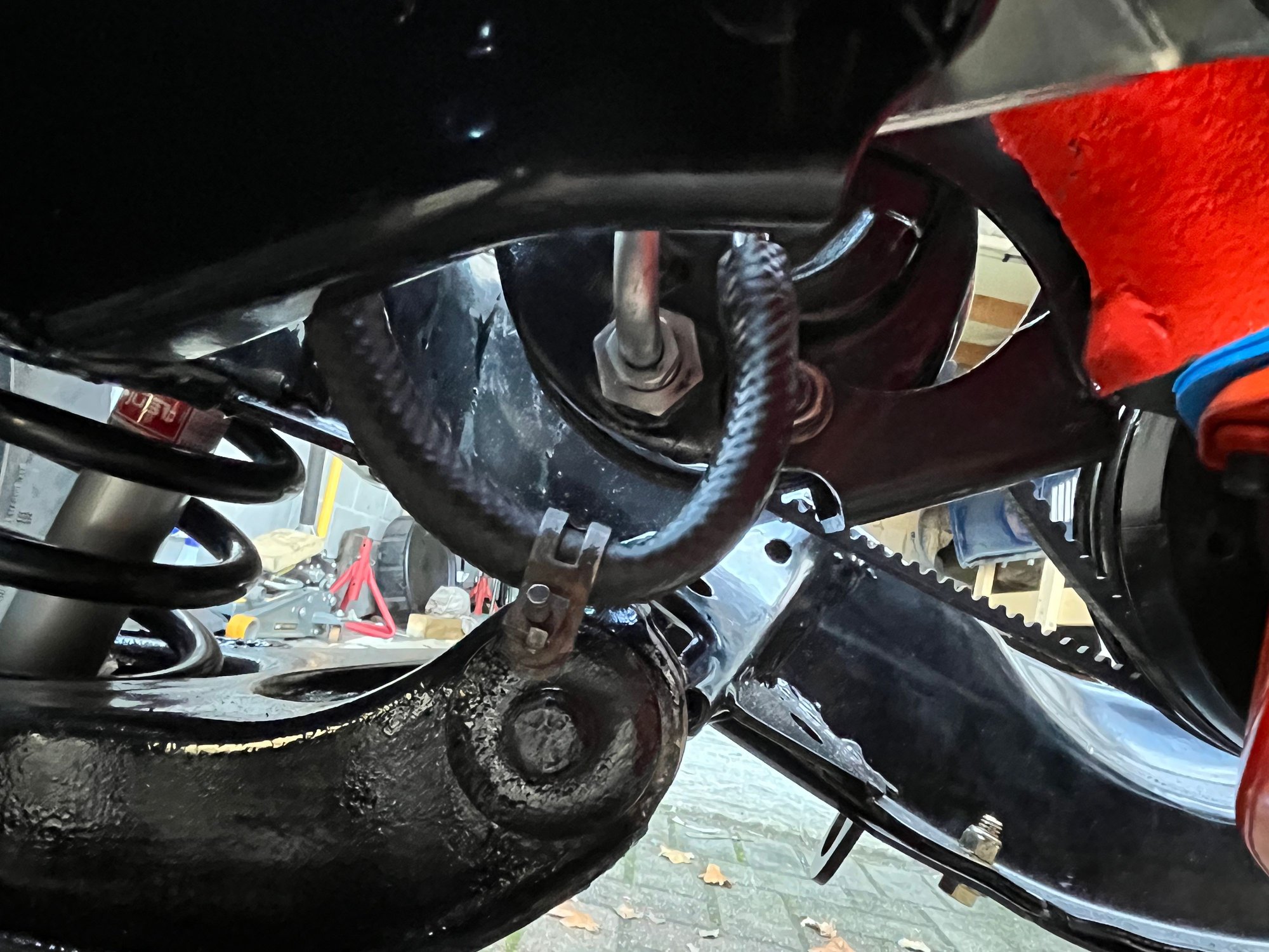

I don’t like this kink in PS return line, but no matter what I do, this is as minimal as I can get it. Any tips on minimizing the kink ? Maybe line it with a plate or wire of some kind ?
Of courses, this Is Belgium. I could not find a size smaller V-belt. I had to order one from Summit. Working on classic US is much more difficult here. This must be the smallest order from summit I ever made.

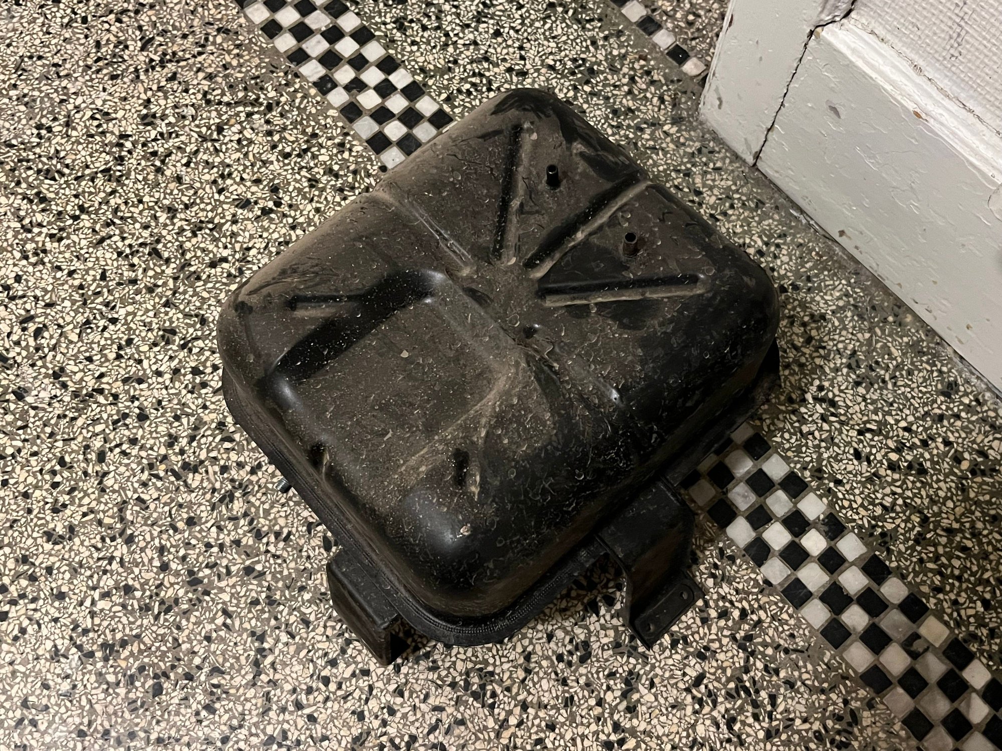

I also pulled the vacuum tank. A kind neighbor, who happens to teach welding, offered to seal the reservoir for me. I still need to clean it up for him.
