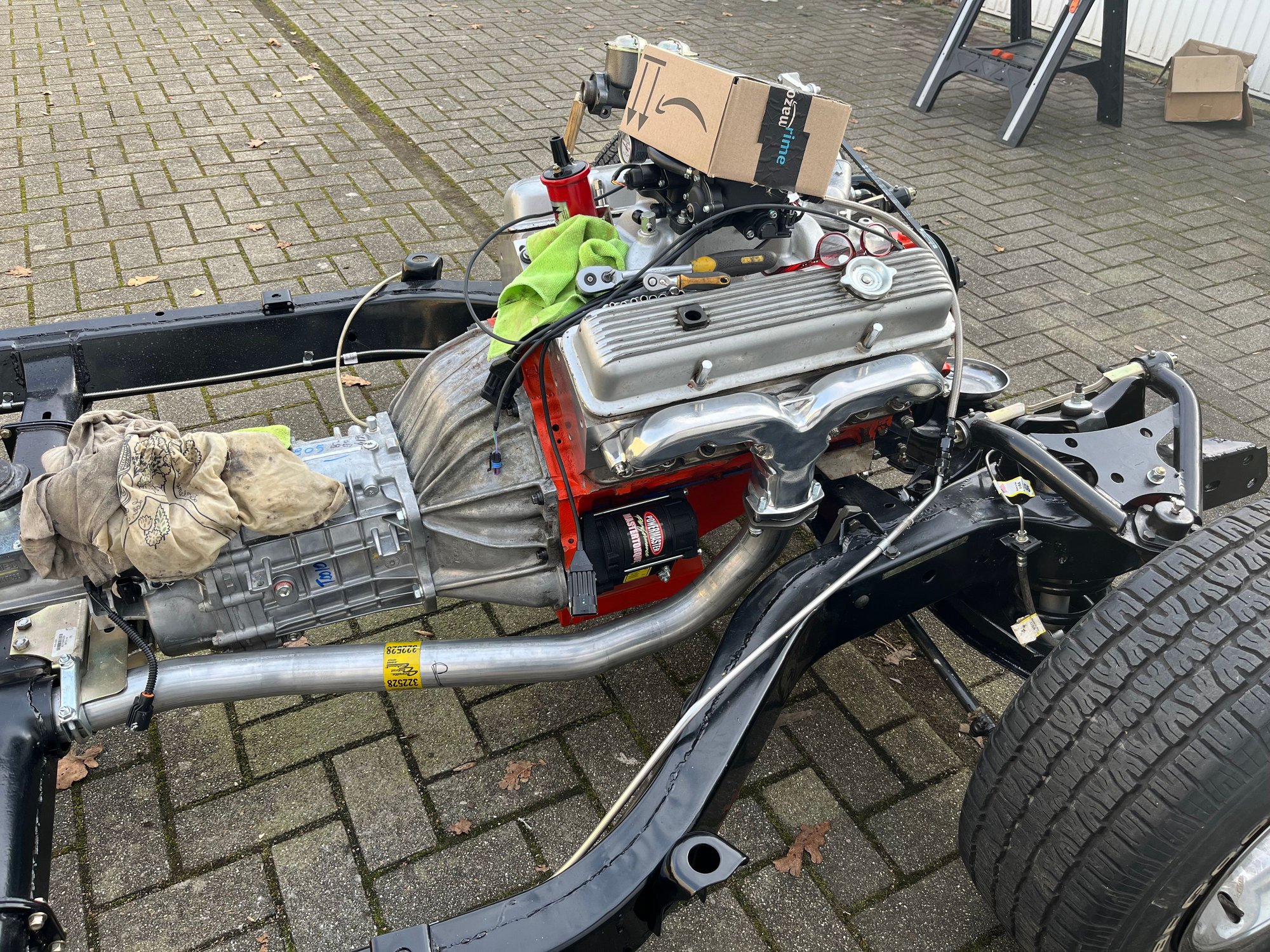

Well that’s kind. Someone I barely know made this for me:

Originally Posted by DorianC3
The belt for alternator is too loose IMHO.
I'm thinking that your on to something there!
Well, there’s enough thread (but just barely) to tighten correctly. Time to address this issue while I’m here.

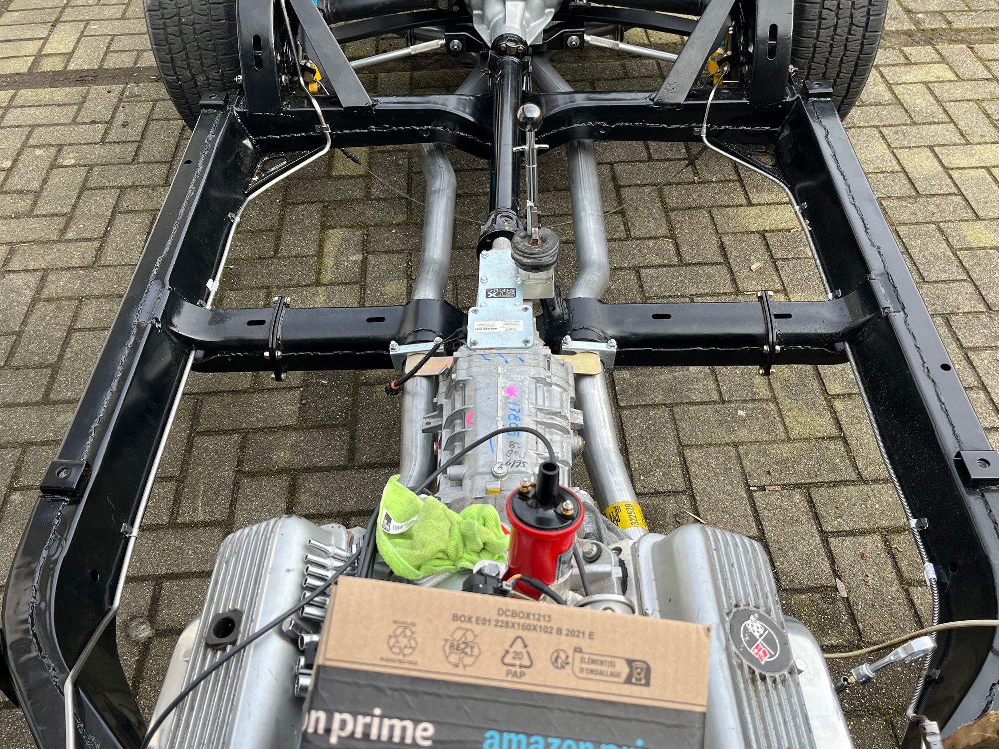

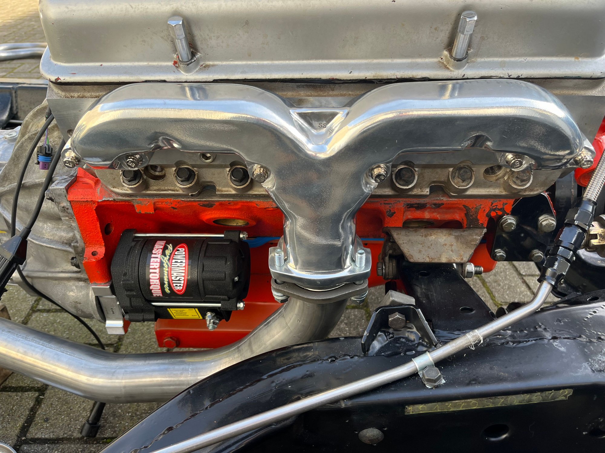

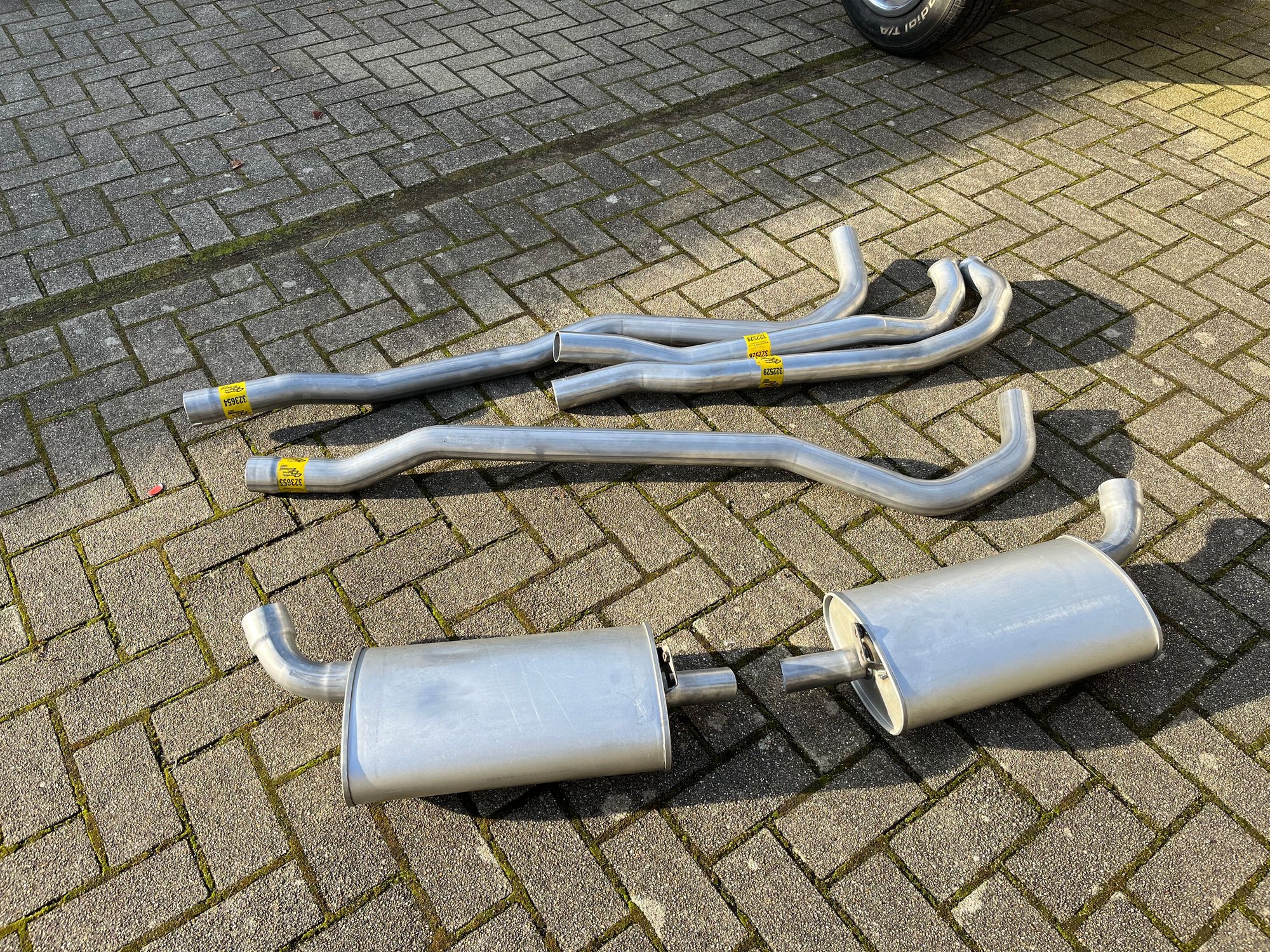

A Frankenstein set with primary pipes from a 1964 sporting a 2.5 inch diameter. The intermediates are from a 1969 as are the mufflers.
I’m impressed with the pipes. Made in Canada. My previous set was 2.25 and quite kinked. Stepping up to 2.5 - these look much bigger for only 1/4 of an inch.
The ram horns exit is 2.5 inches. I really like the way the manifold clears the plugs nicely. The bolts are too long at the collector. That’s an easy fix. Pleased also with the doughnut system.
I am please with the fit.

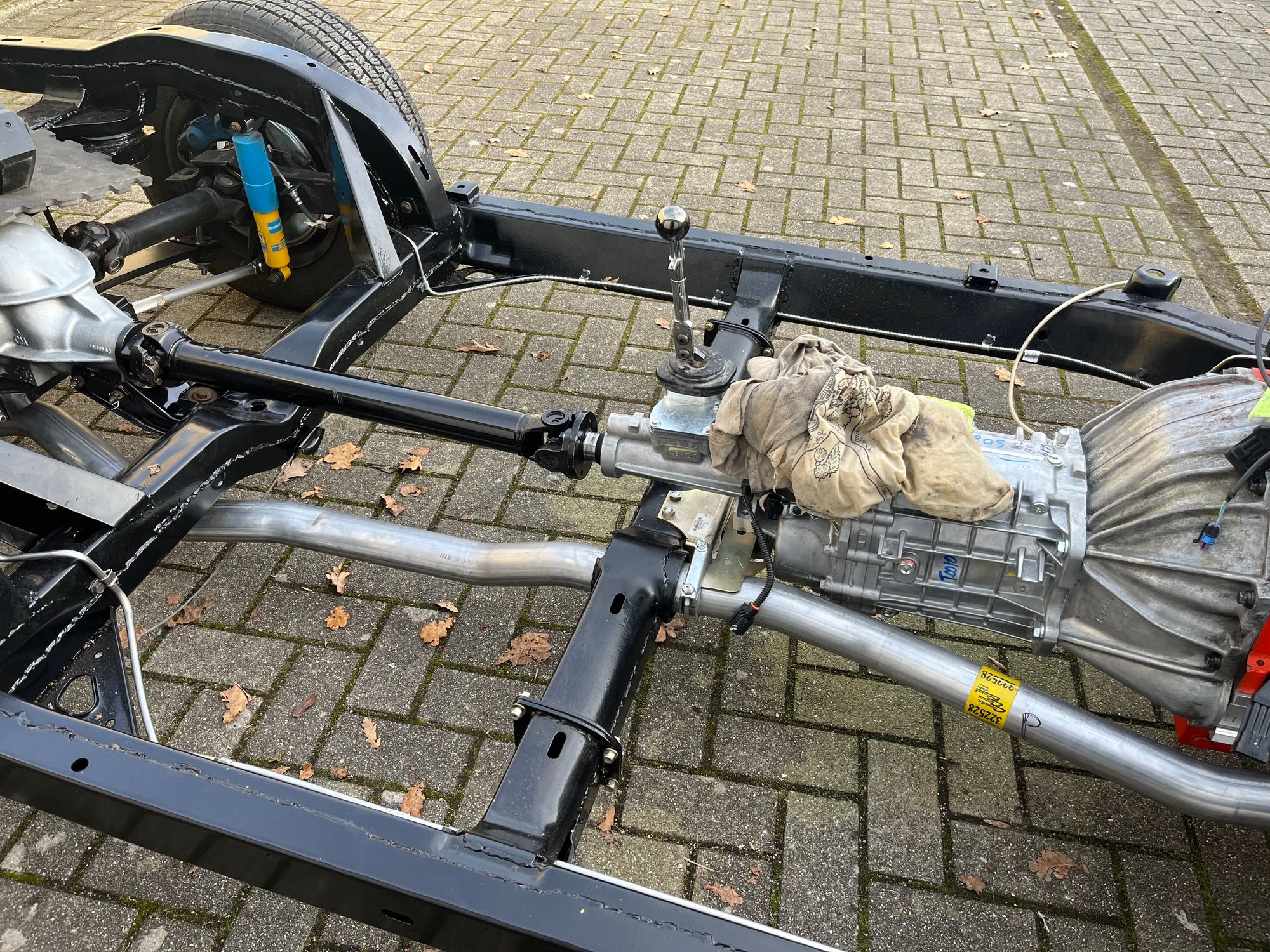

The mid-hanger is excellent engineering. Compliant enough to conform to the pipe. Stiff enough to stay clear of crossmember. And swings away from crossmember if it droops a little with time.
Seems ok.

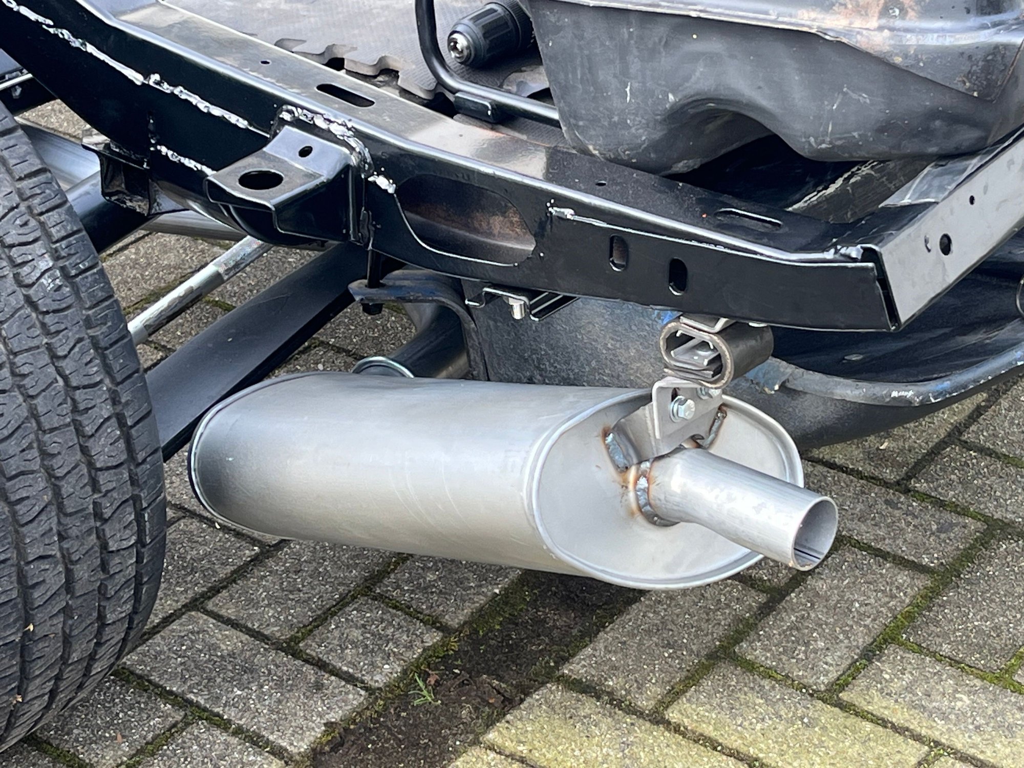

As viewed from rear.
And the OEM hanger. I really wanted this in particular restored. Finally away from that awful welded crap from a PO
