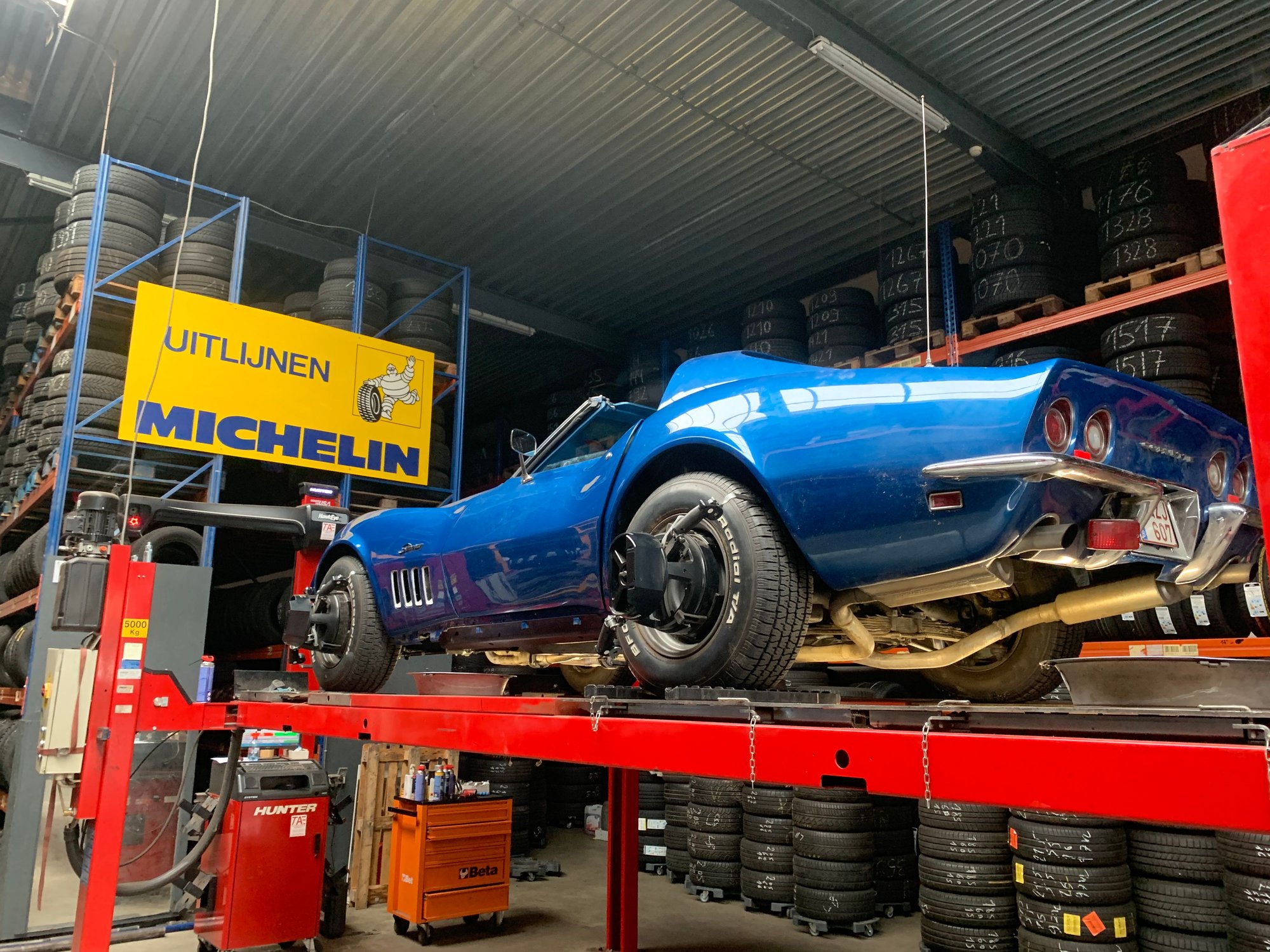

Soooo, I went to have the geometry done and it took an hour-and-a-half and he did a 1/4 @$$ job.
Looking at the rear I noticed that the right side was higher than the left.

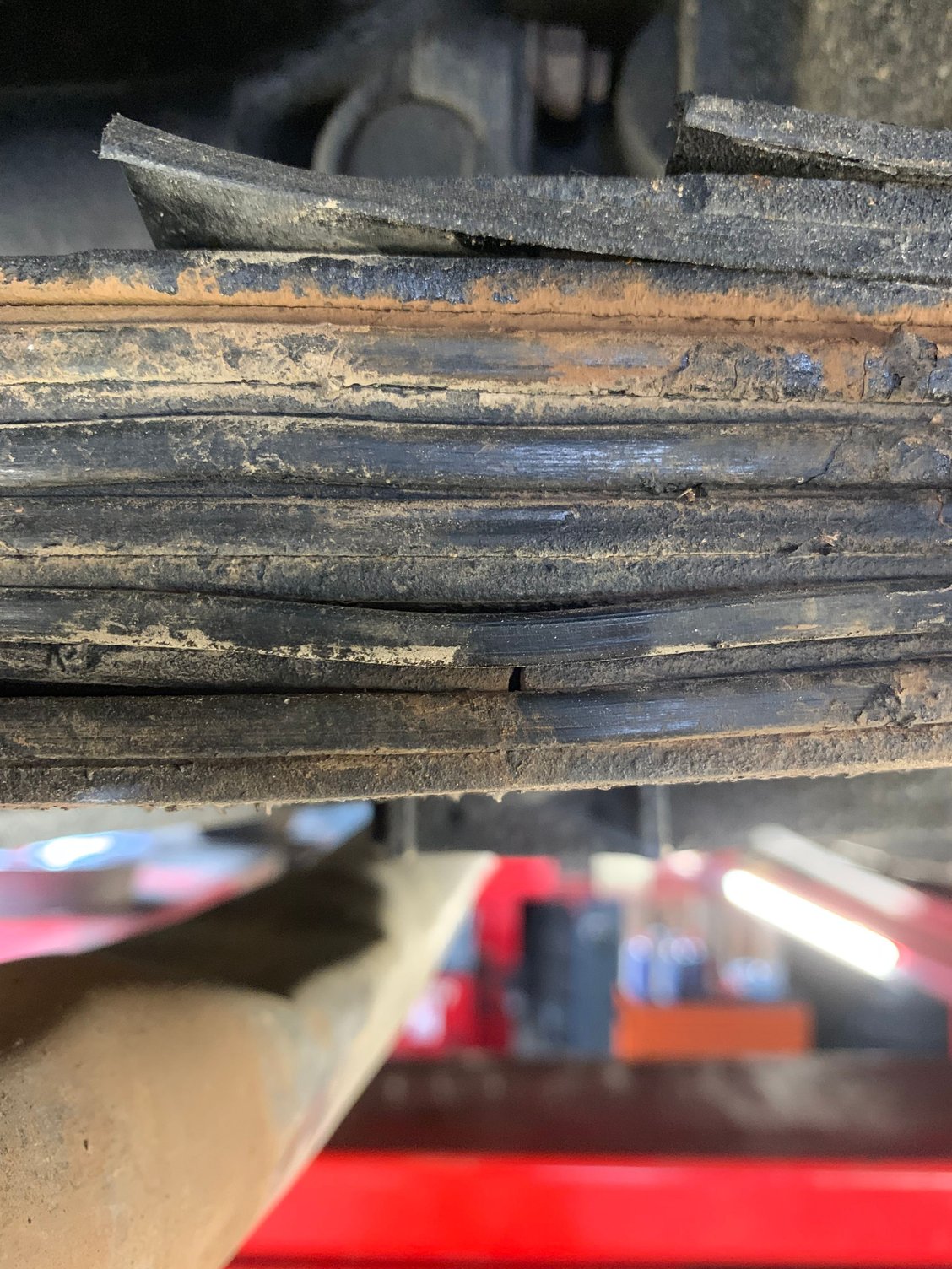

Upon closer inspection of the left side... I dunno if you can see it but there seems to be a broken leaf on the spring. It goes through to the other side.
The front of the car, with the performance coils, is somewhat higher than the rear so the rear will have to come down. I was planning on a new rear spring the winter anyway.
I think the guy didn’t bother doing a full job because I told him that I was going to lower the rear soon so I’d have to return anyway.
For the moment, I wanted the car to be safe ...or rather, not so wildly out of spec due to the complete front end rebuild that I would wrap the car around a tree.
I suppose he figured doing much more was a waste of time. The good news: $37.
Anyway I may have to find another place. I’ll first have to replace the rear spring and the rods. Hmmm... Maybe I’ll replace the rear bushings while I’m at it. For the moment it’s high time to enjoy the car and drive it some before the season is over.

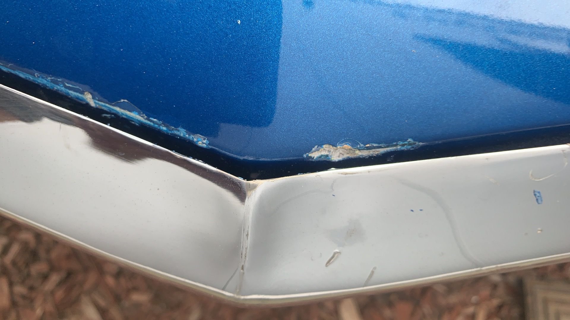

Lessons learned so far: the nose is longer than you think
Aw crap. Minimal... but really a silly mistake.

  • I am very sure one of the leafs on the rear spring is broken.

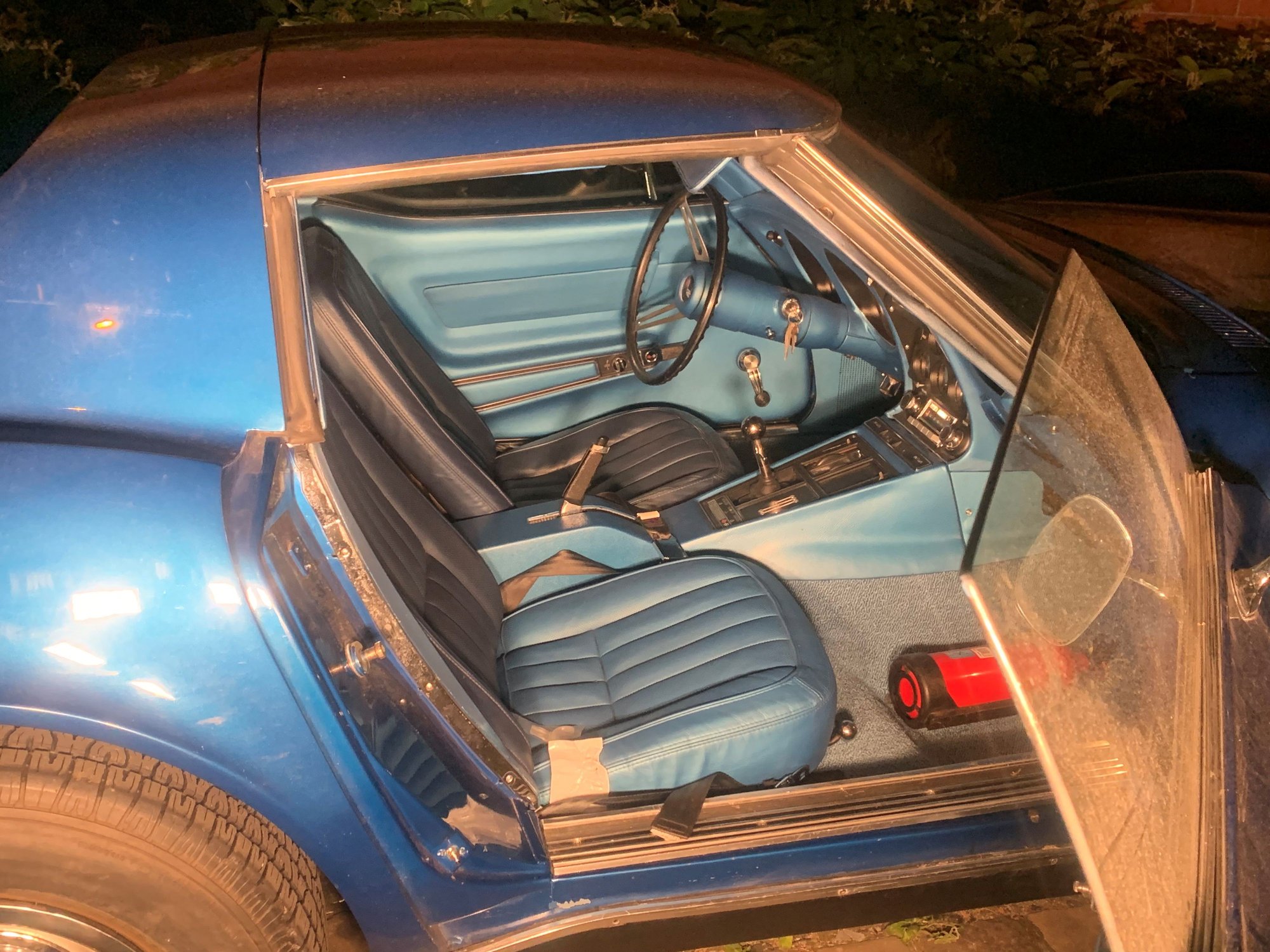

Soooo, the rally-tour was this Saturday. Rally-tours are fairly popular here in Belgium. Essentially it is a gathering of mostly vintage vehicles, several with a pedigree in rally racing. They give you a "road-book" with directions and you need to collect points on the way by spotting little specially placed road signs with letter on them that you have to record on a sheet of paper.
As always, I finished prepping the car at around midnight The door panels went back on without too much of a struggle. The brake light switch had to be tweaked. Window wipers needed to be installed - tho' no rain was forecast.
Simon got a bath at 0530
As you may notice, the passenger side seat cushion only has been dyed. This weekend I may do the rest.

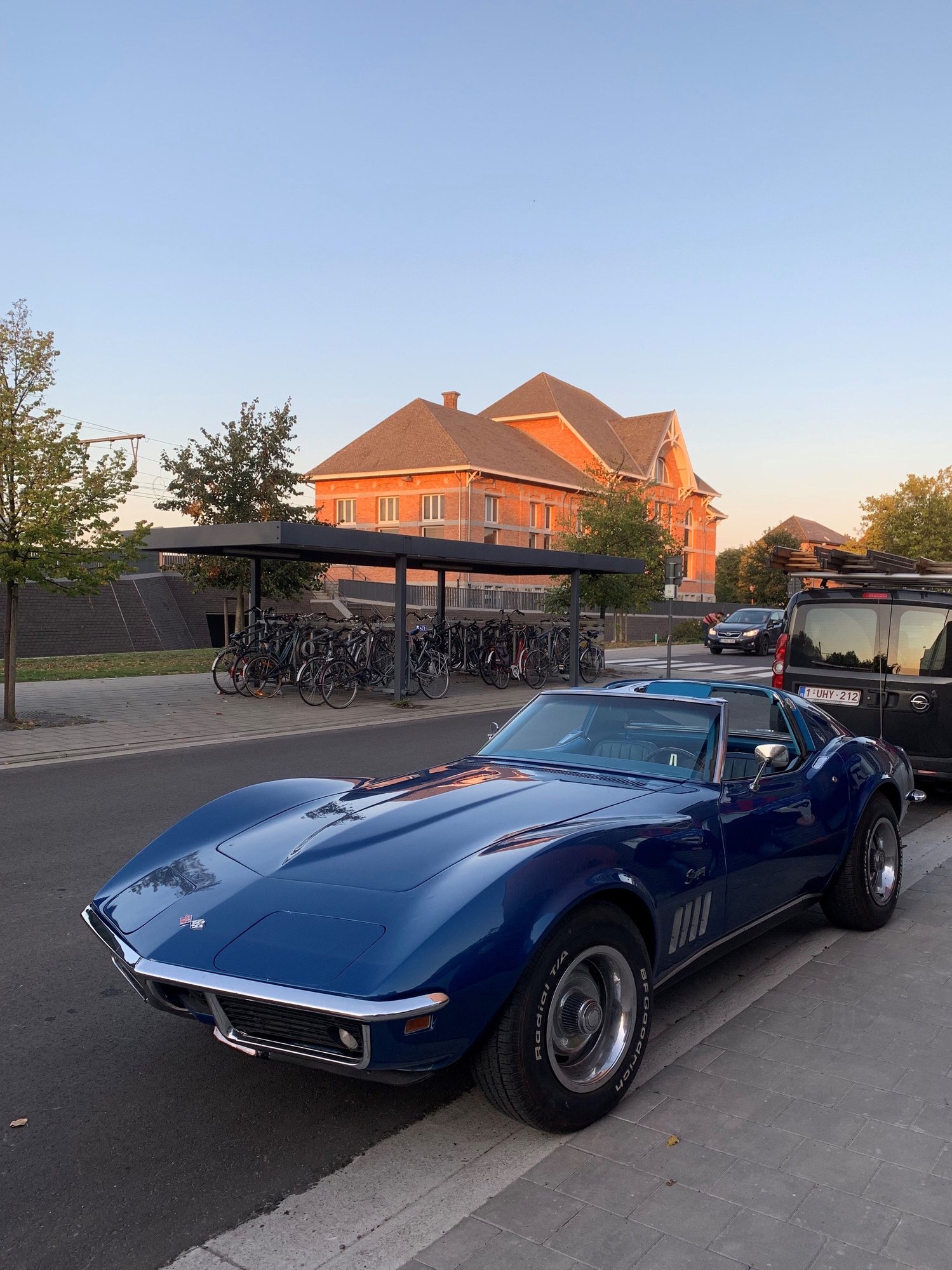

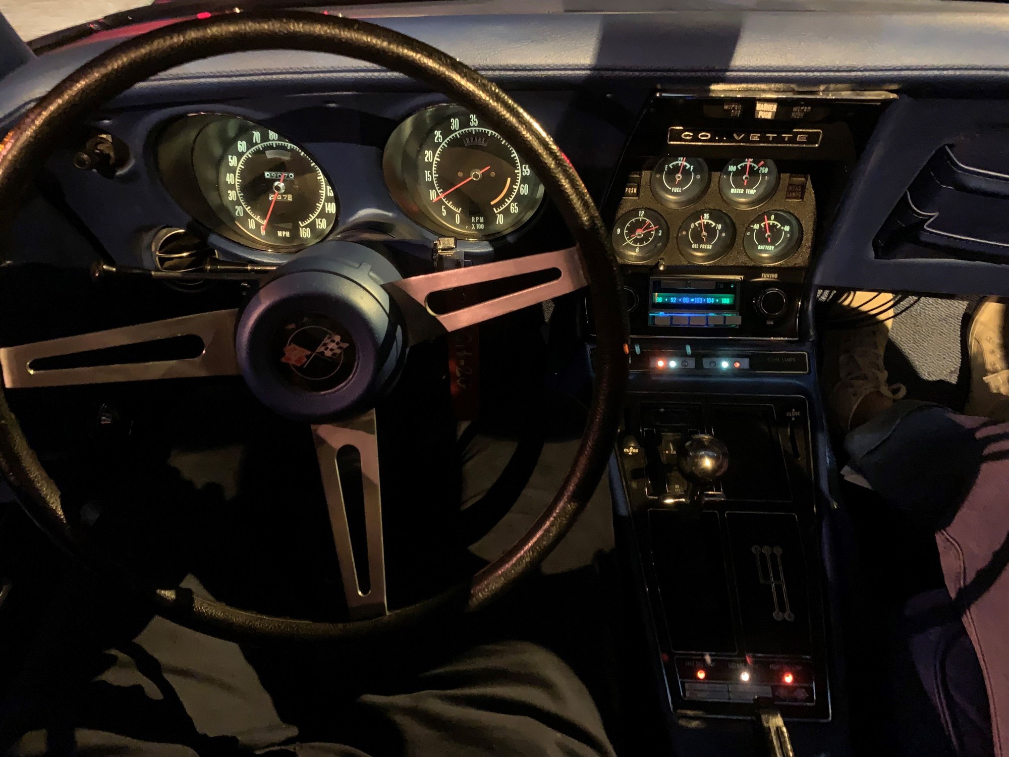

Music from The Right Stuff movie scene "Astronauts Walking" playing in my head we prepared to set out. (Yeah, that dumpster in the back kinda ruins things.)
Aaaannd, Houston... we have a problem. Right out of the gate Simon was coughing and sputtering. Something was clearly wrong. I had done a test drive Thursday (admittedly very short) but it ran extremely smoothly. I pulled up at the first gas station -I needed to fill 'er up anyway- and found that the electric choke was not opening. It was either power or ground. Ground seemed ok... We didn't have time to check the power because we needed to be at the start briefing by 0830. Solution: a strip of duct tape to lock it open. (Never leave home in a classic car without it.)
Performance was not ideal - but it got us there on time...
All the gauges worked properly. The cabin fan was not working. I will need to check that when I get home. The ride over (with the top on) was remarkably cool; the insulation I installed made a huge difference.
After 90 minutes of driving we got to our destination on time - well on time for coffee and croissants. (See Erwin, my co-pilot below.) We were close to the French border. The view was as lovely as the weather.
We got our briefing and one by one each car left with about a minute in between. As we were the last to register for the event, we were the last to depart: number 68. That was fine, that gave me time to look into the choke failure. It was a loose ACC wire on the fuse box. I must have knocked it when messing with the brake pedal switch. Once reattached the ride was super smooth again. So smooth that I am not sure that there will be much to gain with the upcoming fuel injection conversion. On the other hand... gas mileage sucked... even after the choke was fixed.

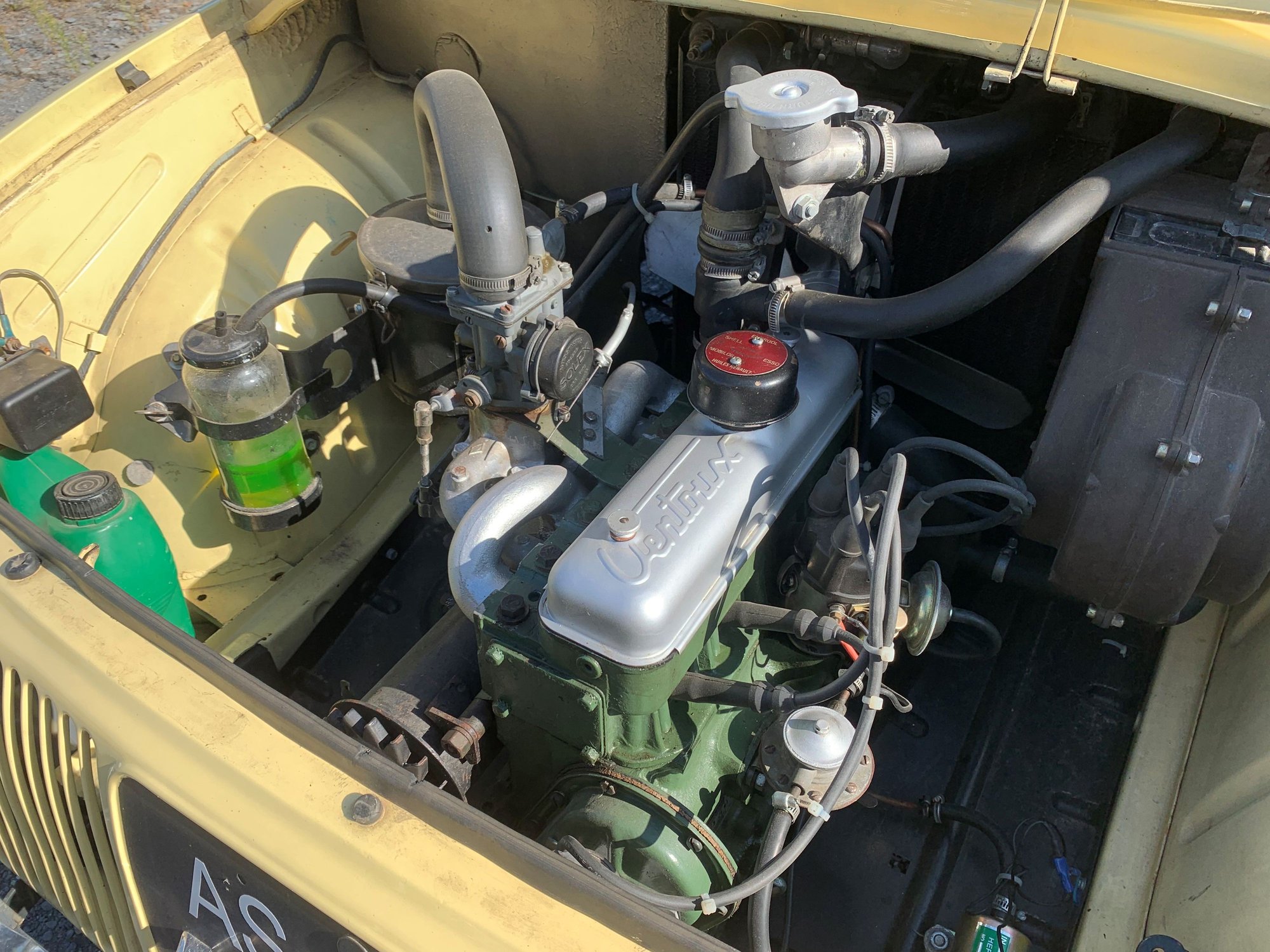

Some of the rides...
Yay, a C3
An another...
A French "Alpine", I think. Quite rare and also a "plastic fantastic"
My dad had one of these. #fun I wouldn't mind one myself.
A Renault with a rear, water-cooled (!) engine. I love the glass expansion tank
No idea what this is... but it looks cool

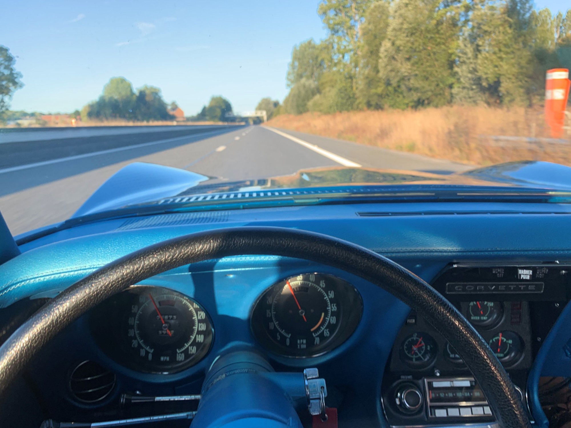

We didn't bother finishing the race... we proved our point and decided to skip dinner and go home instead for a wine and cheese.
Driving home - the slotted upper control arm cross shafts make for a reasonable highway cruise. Just the high rpm bothers me. One day: T-5
I do like the fiber optics - 100% restored and super nice
