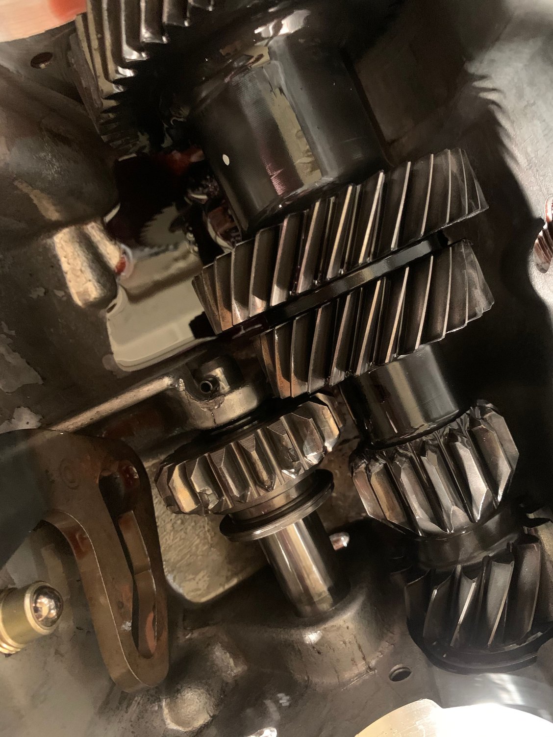

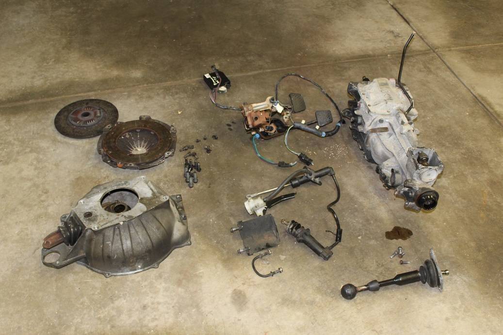

I also messed around a bit with my T5
See here and here

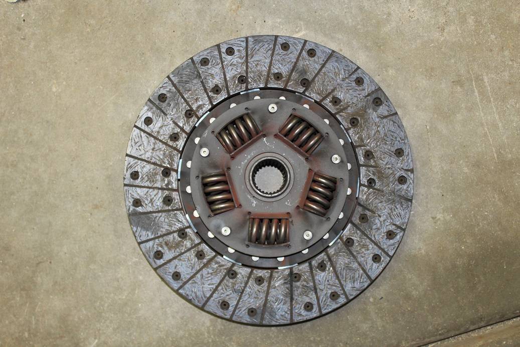

Piecing parts list together
Parts:
  • 11-inch clutch disc with 26 splines
  • Good/best quality short shifter. Suggestions welcome
  • Adapter plate (and re-use my Muncie bellhousing)
  • Input shaft cover
  • Shim set for countershaft
  • Adjustable pivot ball
  • Heim joint clutch linkage
  • Speedo gear and adapter. Cool and (EDIT: 7 and 17 or, 8 and 20 or, 9 and 22)
  • Extended pilot bushing - not needed it seems
Am I missing anything ?

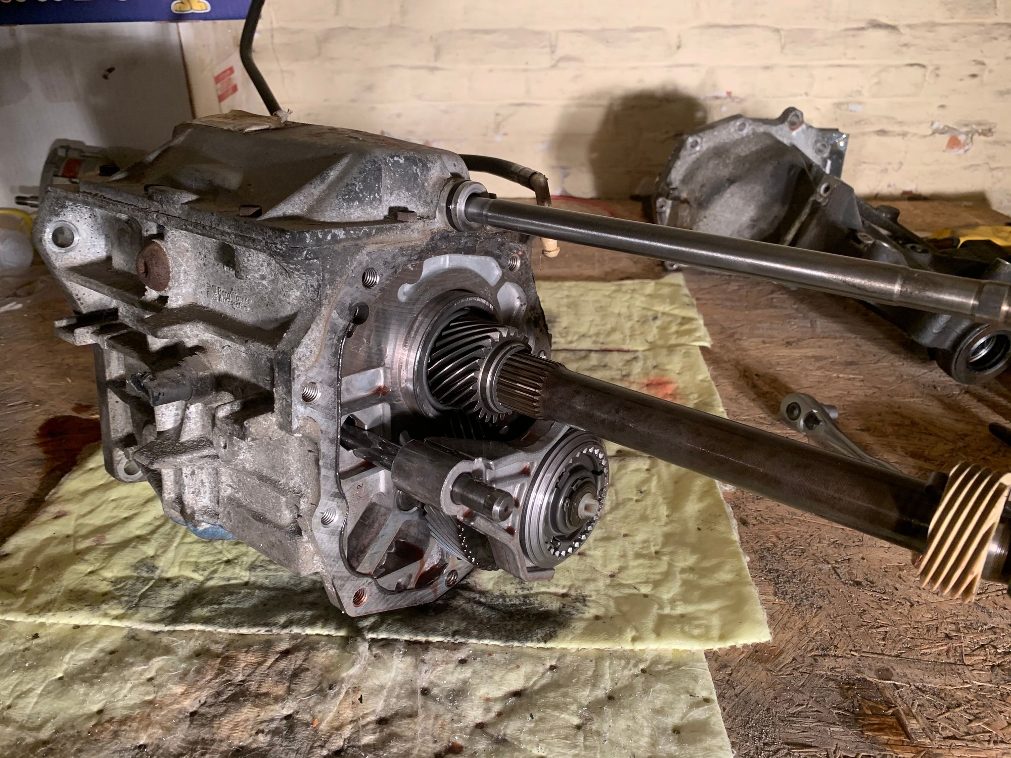

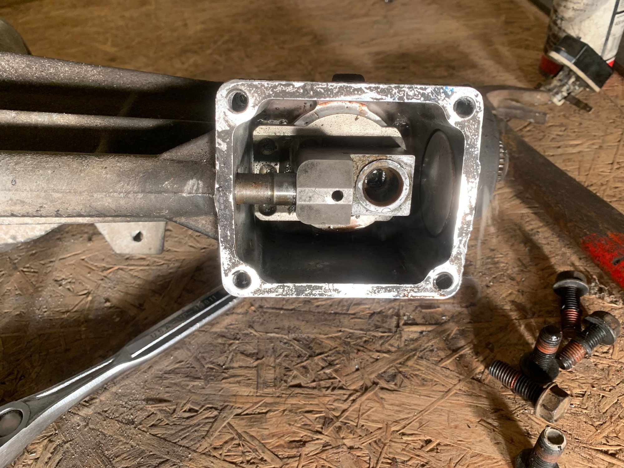

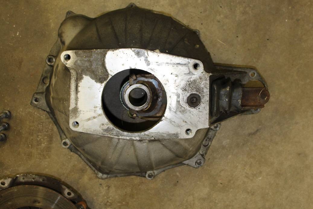

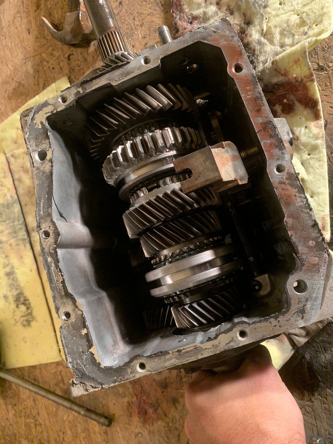

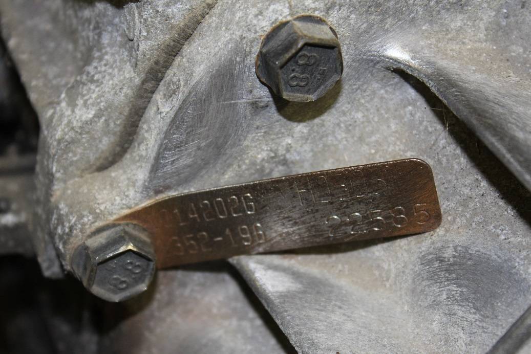

And some pics
Missing shifter. But I wouldn’t be reusing it anyway.

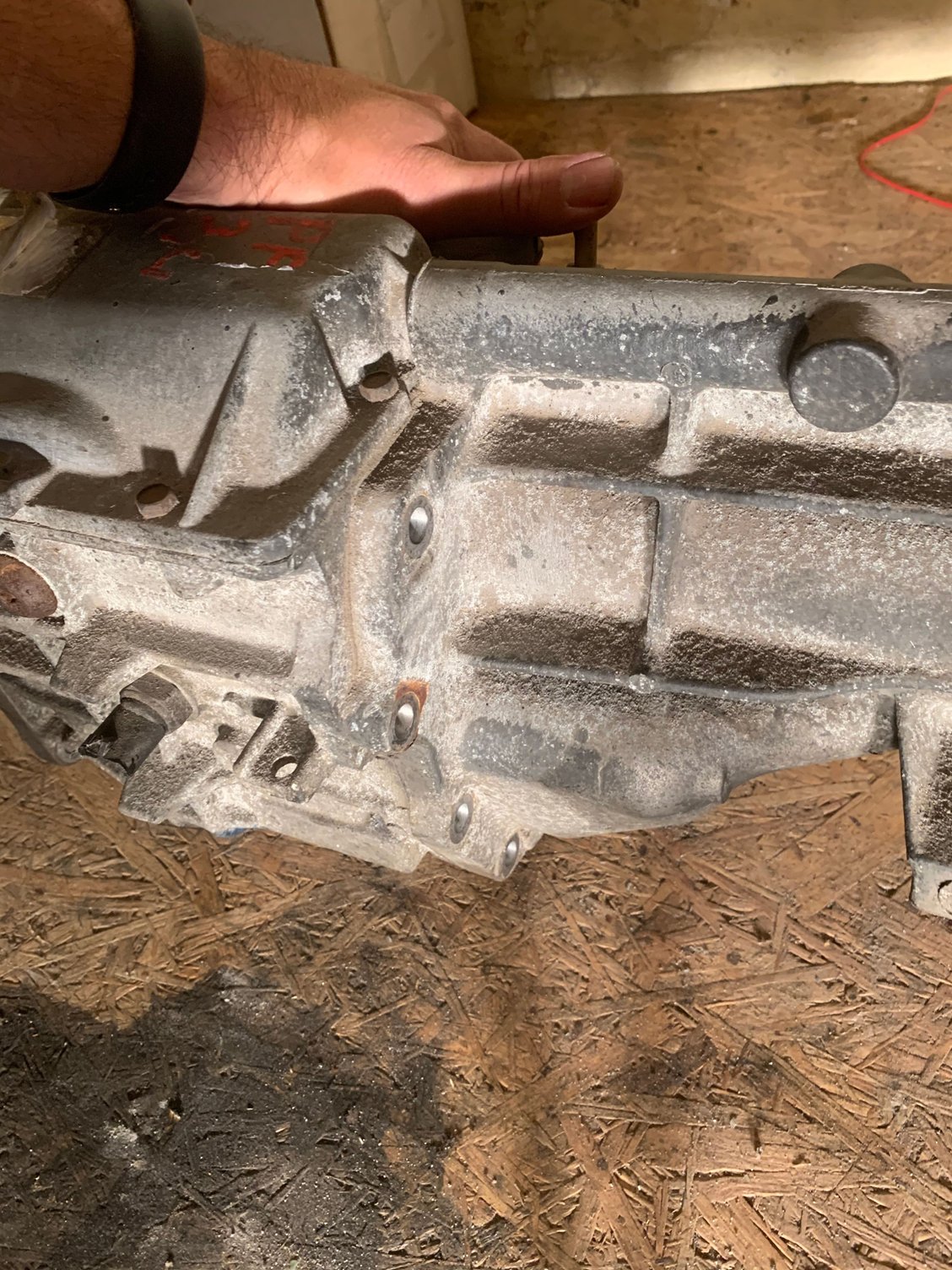

Cracking off tail housing bolts. They still have original sealant on them.
Clean. I will have to figure out the speedo gearing. Tips here are welcome.
Super good shape. Very little wear on pads.
Nice.

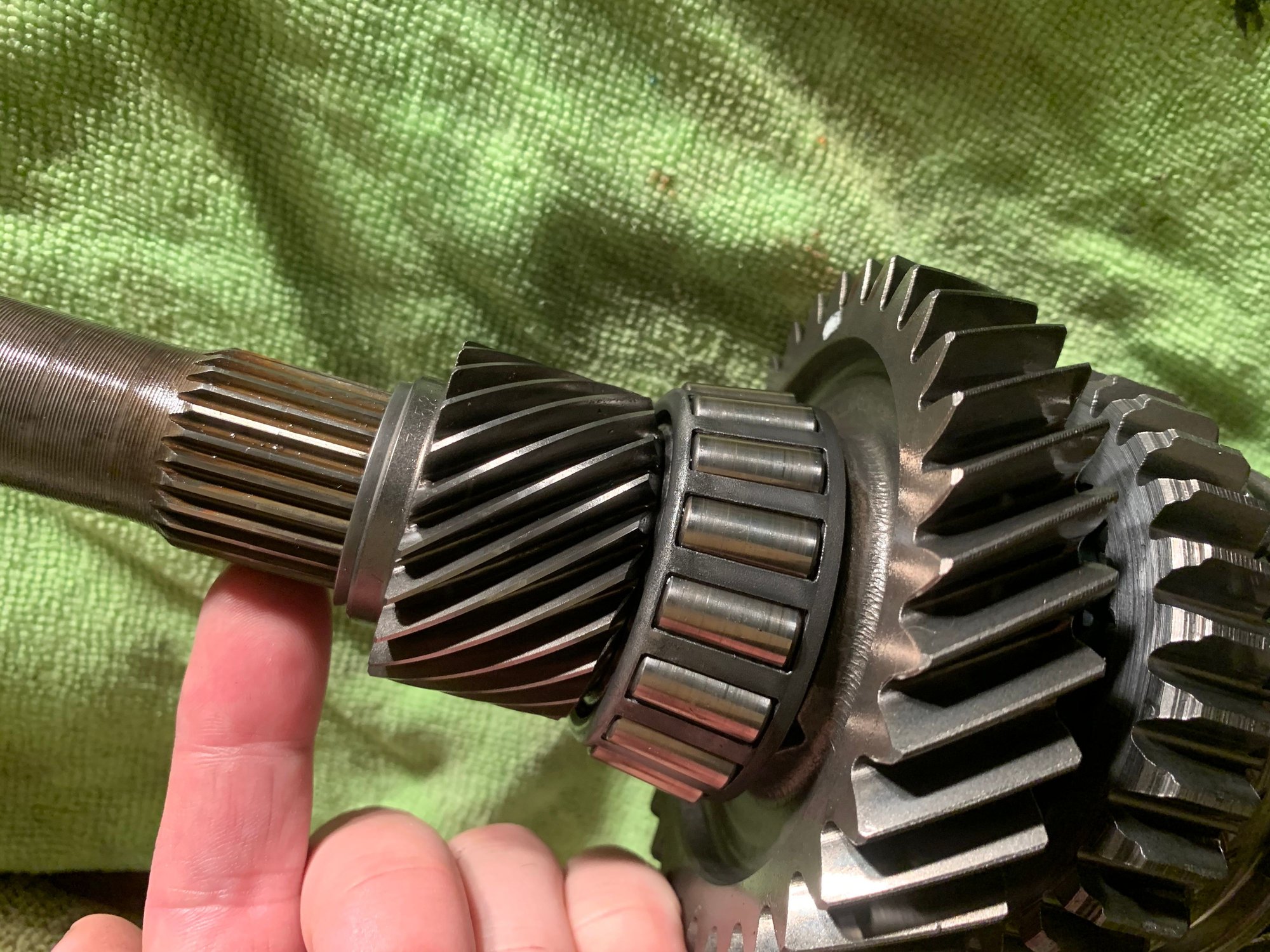

Some chips in reverse but other than that The counter shaftbhas some play - probably due to the cap stretching. I will shim that back to spec.
Nice.

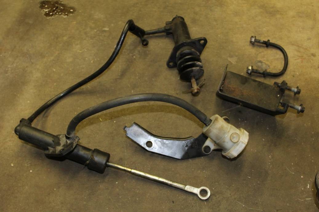

Here are some of the parts:

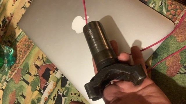

The driveline had a vibration that would manifest itself as of 55 mph. It was more of an annoyance than anything else, but it took the fun out of driving. I always thought this was an imbalance in the motor but now I am thinking it is driveline related. After taking a closer look, I think I found the source. When I got the car the transmount was so shot that it had lowered the height of the rear of the trans by a significant amount, like nearly half an inch. This is turn took its toll on the yoke and the front U-joint. I will be replacing the yoke + front and rear U-joint.

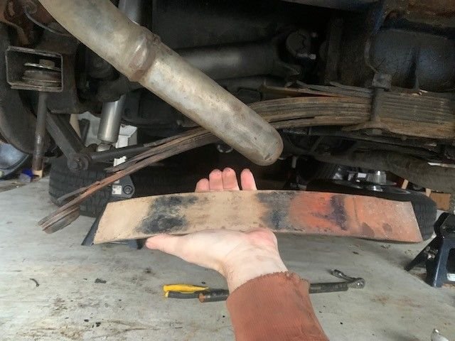

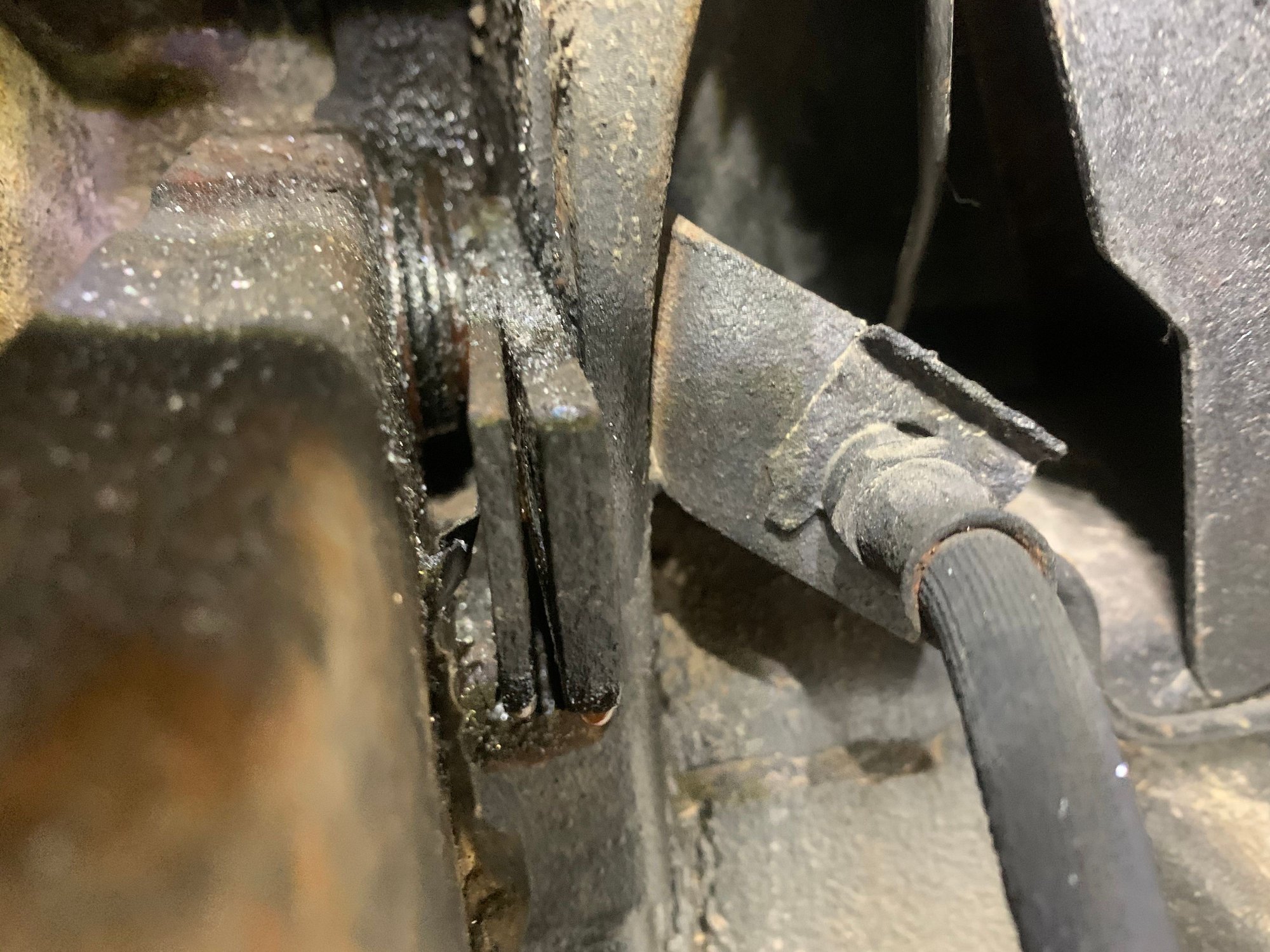

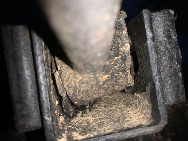

I also thought I noticed a crack in the rear spring.
Sure enough:
I will be replacing it with a composite one.
The front has been completely rebuilt. And yet the rear remained silly vague make me disappointed with the results. I must admit that I am worried that these cars are by nature vague... but, when I see left of the strut rod bushings, I now believe that my poor assessment of the C3 suspension might not be fair. In any case, the jury is still out. I will be replacing it with heim joints. Expensive but worth it, it seems.
I don't see anyway around it, I think I am going to have to saw the struts off the shock mounts.

I managed to get the strut out from under the diff. It is completely seized in the TA. I tried turning around the castelated nut and pounding ...but wisely gave up. According to what I read, the strut bushing rubber encases a split steel liner that needs to be "peeled" off. Point taken tho, I may order that tool if it is not too $$$.

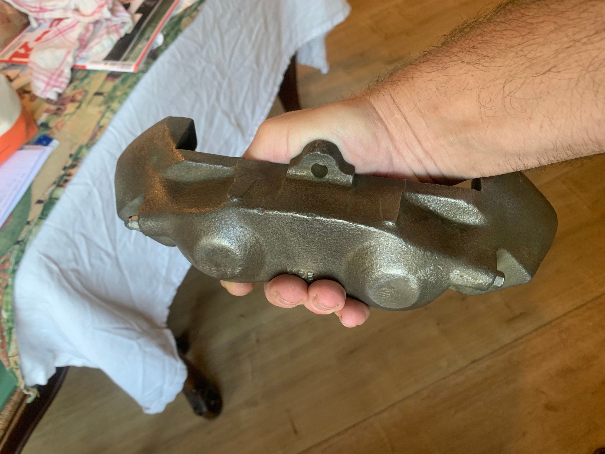

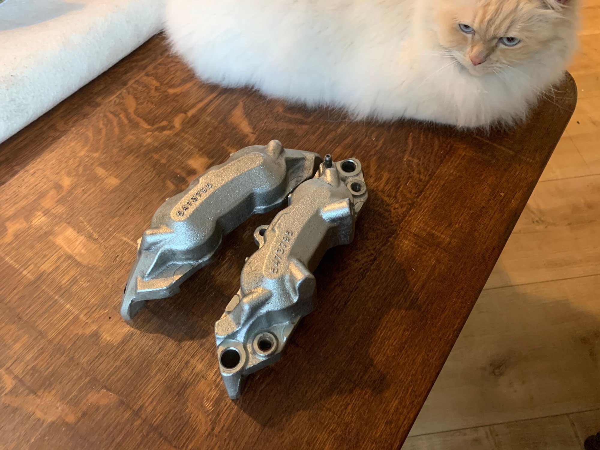

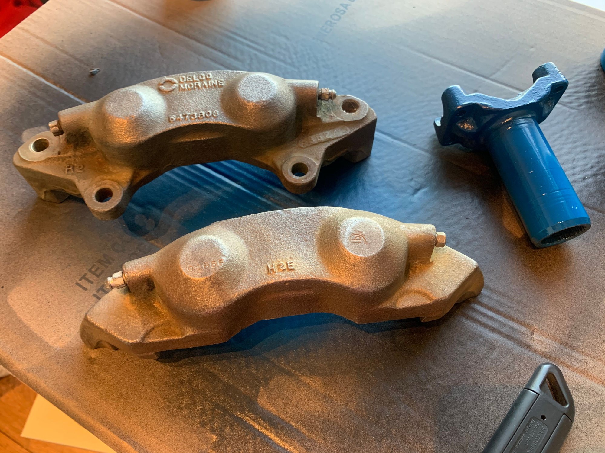

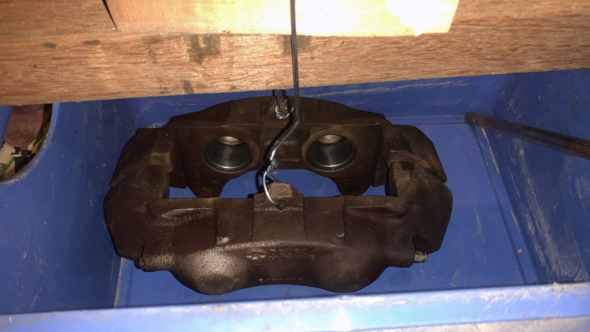

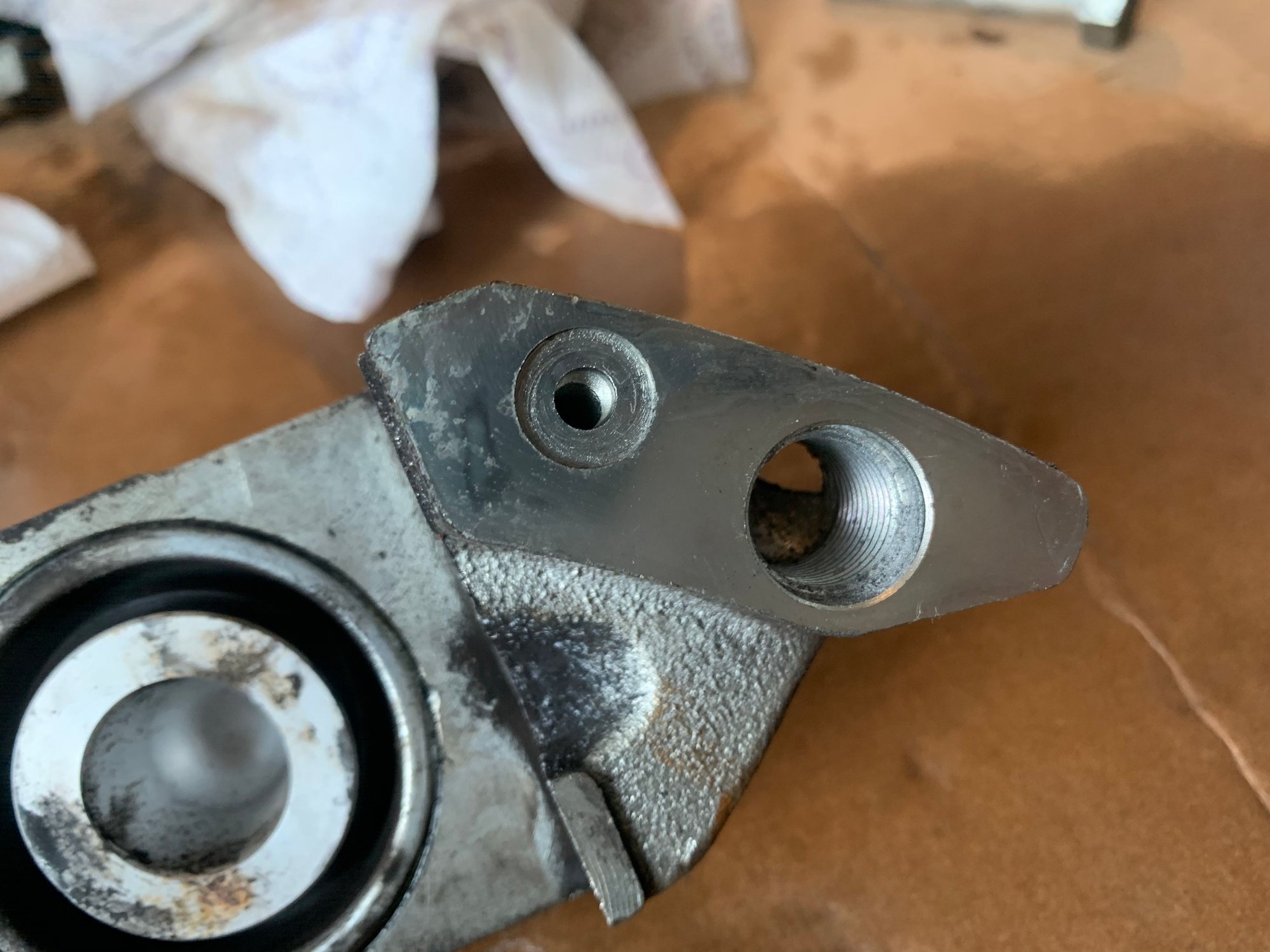

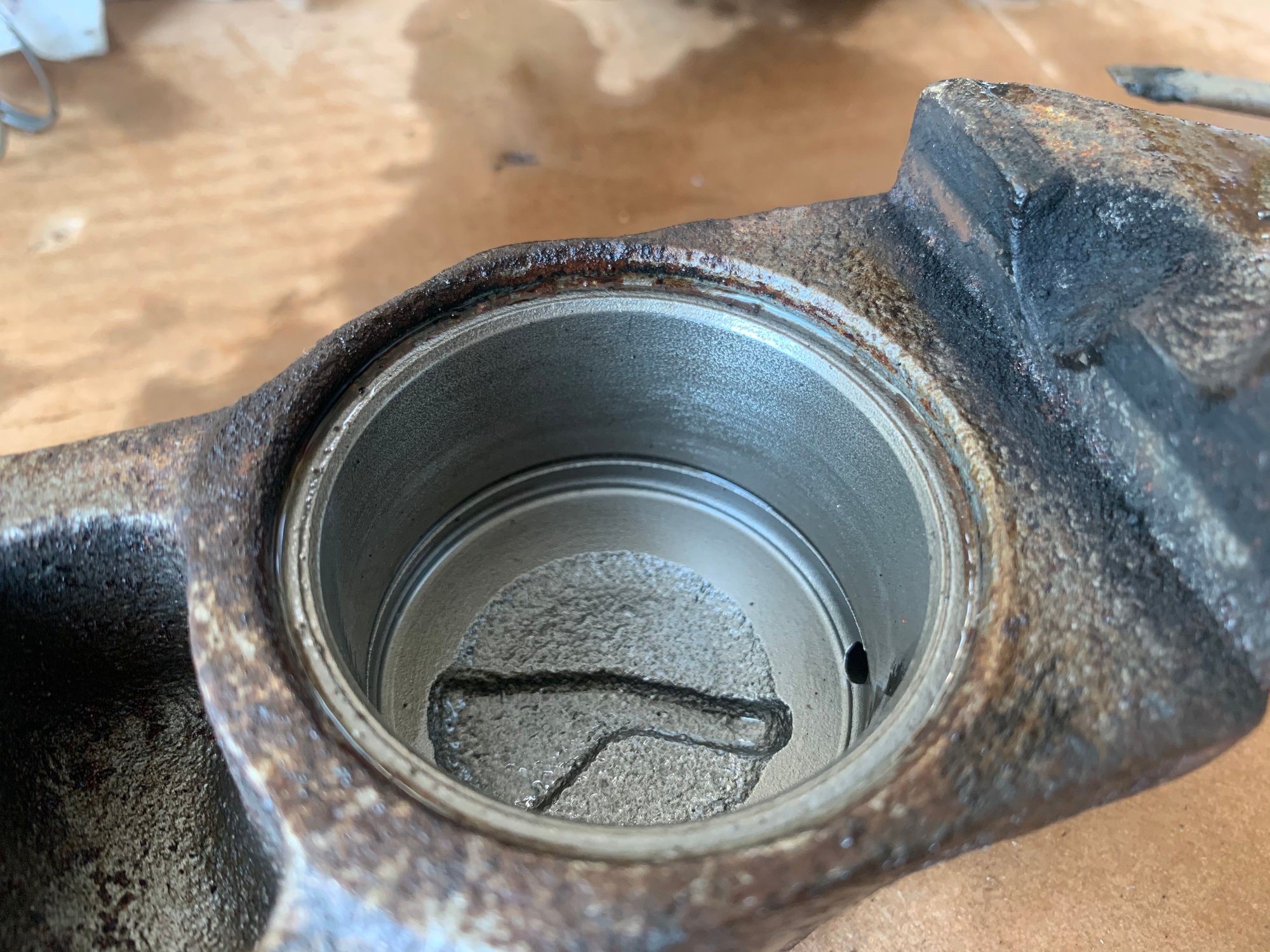

Of course, while I was at it, I disassembled the calipers. The bores look in good condition, as did the seals and pistons. The only thing a bit weak were the springs. All but one were a bit corroded and weak. I probably could have rebuilt them as is and they’d be fine. On the other hand, since they are off... might as well detail them and give them new pistons and O-ring seals.
First let’s get rid of the surface rust.

Yellow, red, silver, black ?
Old Jan 3, 2020 | 06:18 AM
  #374
bazza77's Avatar
bazza77
Joined: Jul 2010
Posts: 3,176
Likes: 633
From: perth western australia
BLUE ! same colour as the car
Of course you wont see much of them with the rally's !!!
Old Jan 3, 2020 | 08:20 AM
  #375
DorianC3's Avatar
DorianC3
Joined: Nov 2017
Posts: 2,352
Likes: 518
I went with blue. Silver required a white primer (which I didn’t have). Red and yellow seemed like these stock shoes would be posing to be more trick than they really are. So...

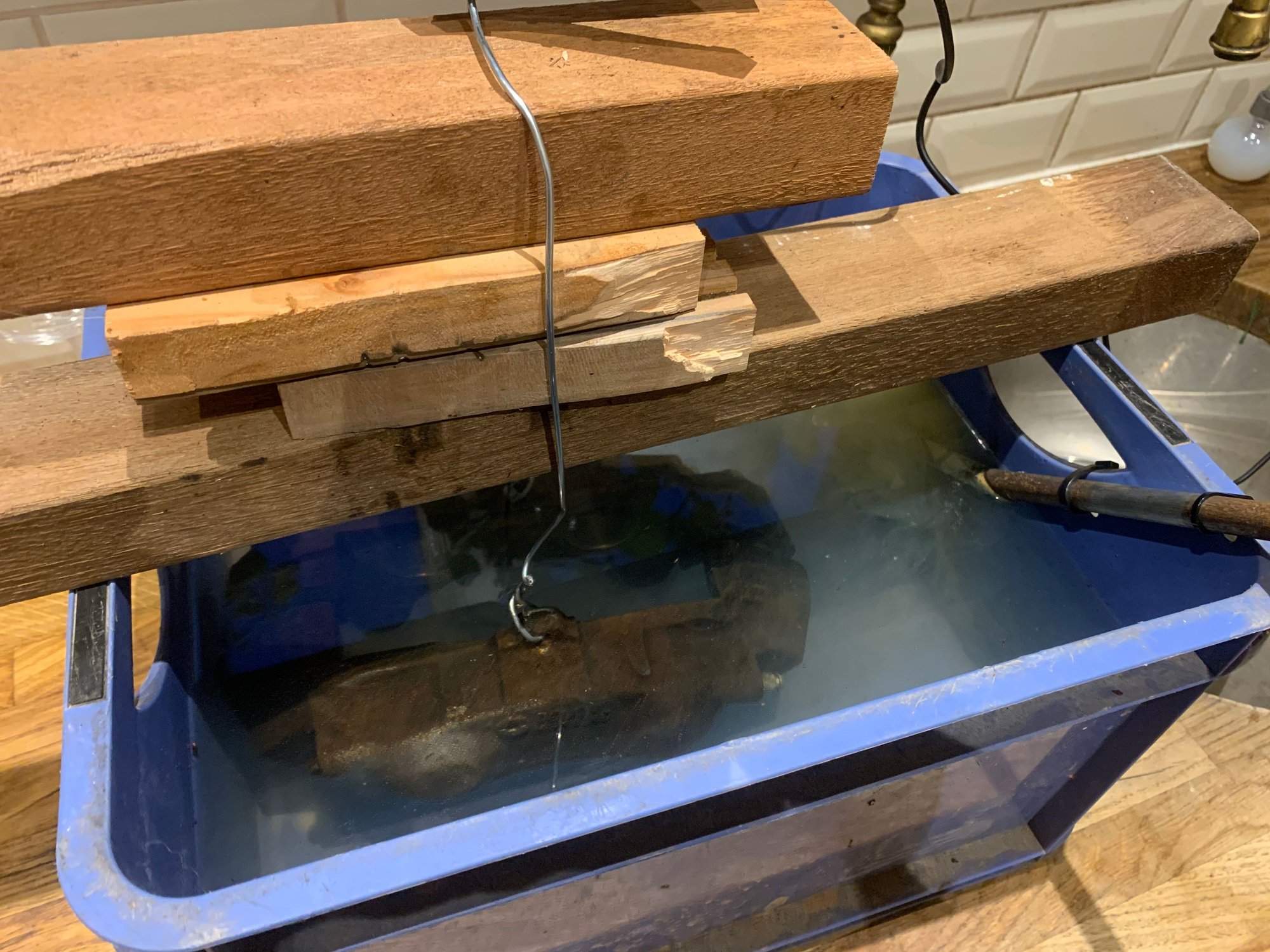

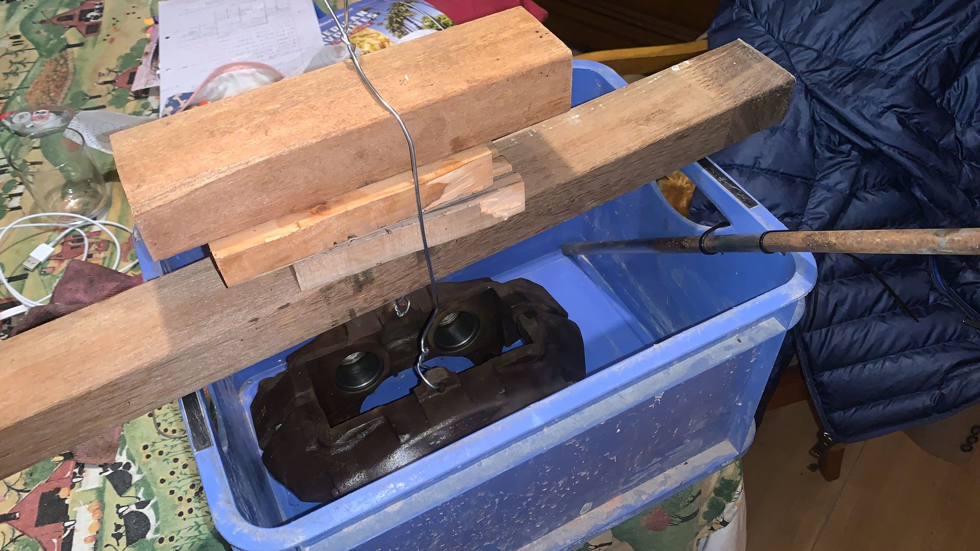

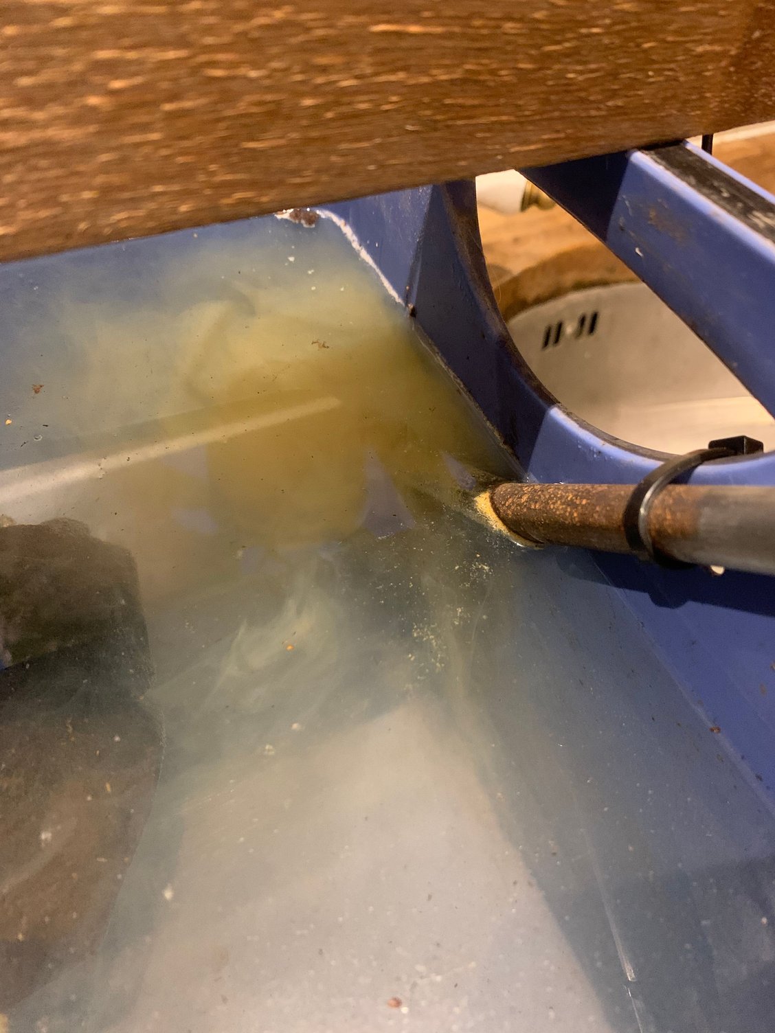

A four hour dip

hmm needs more time

Overnight in dip and then scrubbed a bit.
Testing the blue caliper paint on the trash yoke.

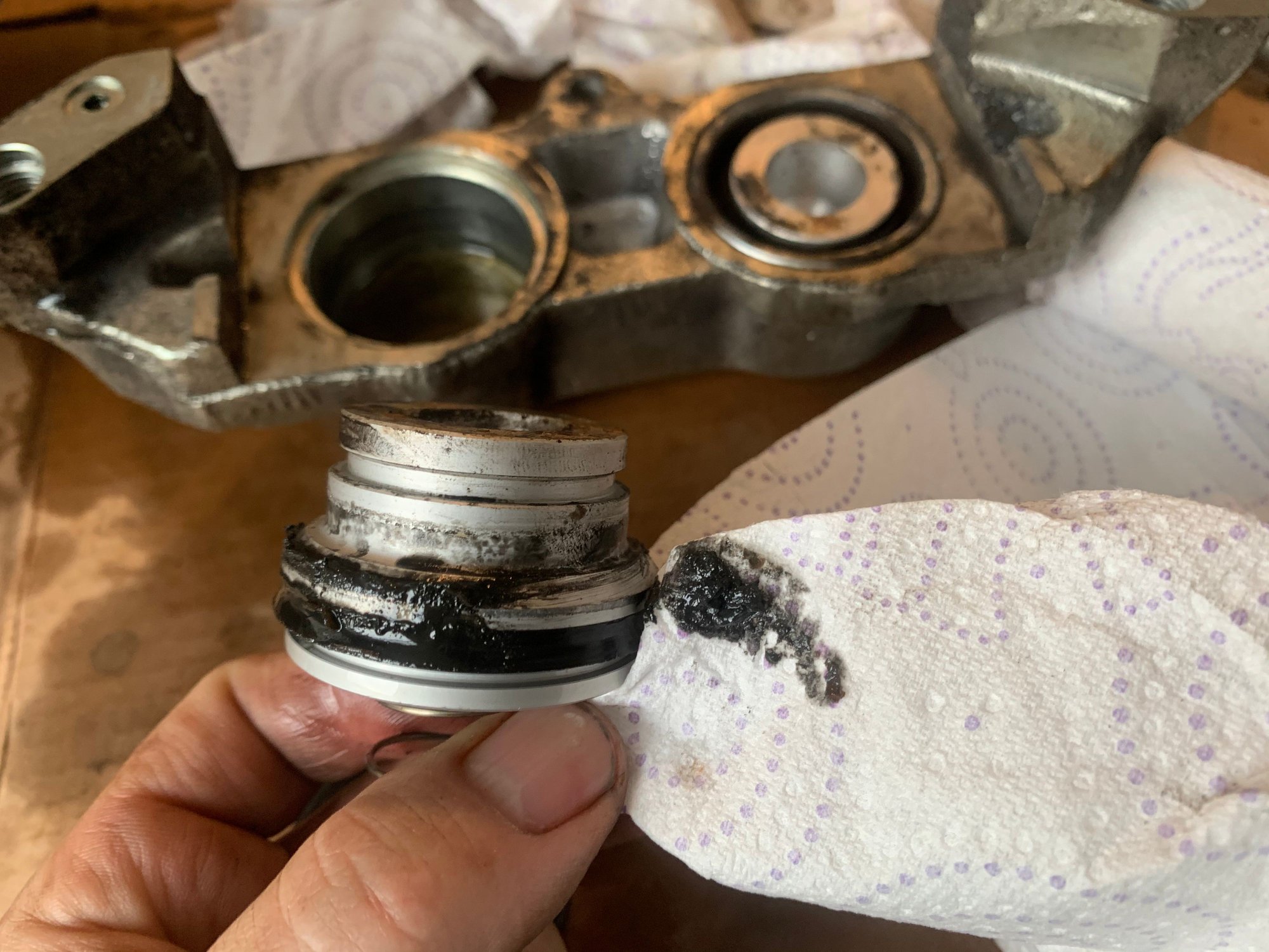

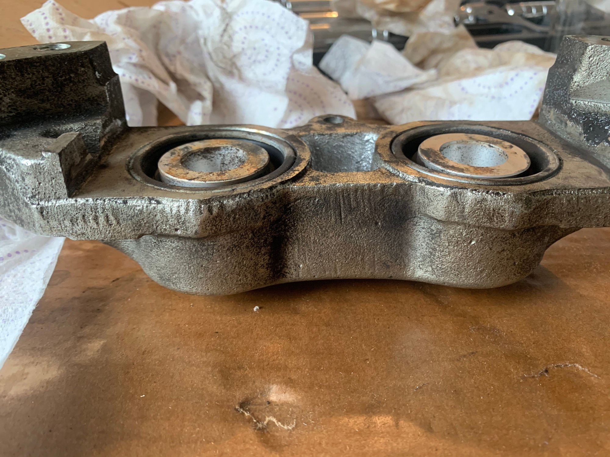

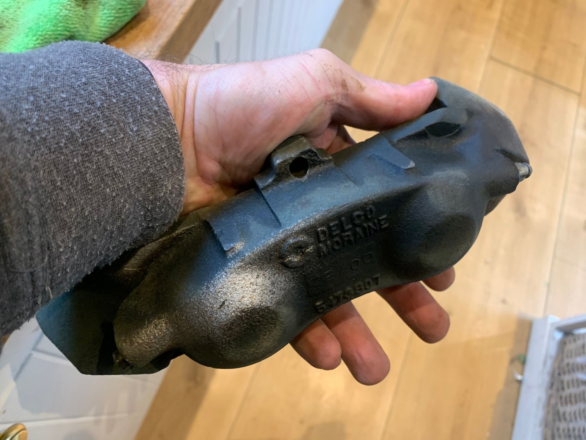

The next caliper also had surface rust... and like the others, the bores were very clean.
The last caliper I was expecting to be a pain... someone had started to paint it silver, then gave up.
The pistons weren’t seized, but neither were the springs pushing them out.
New looking bolt...
Digging deeper...
I think these are steel.

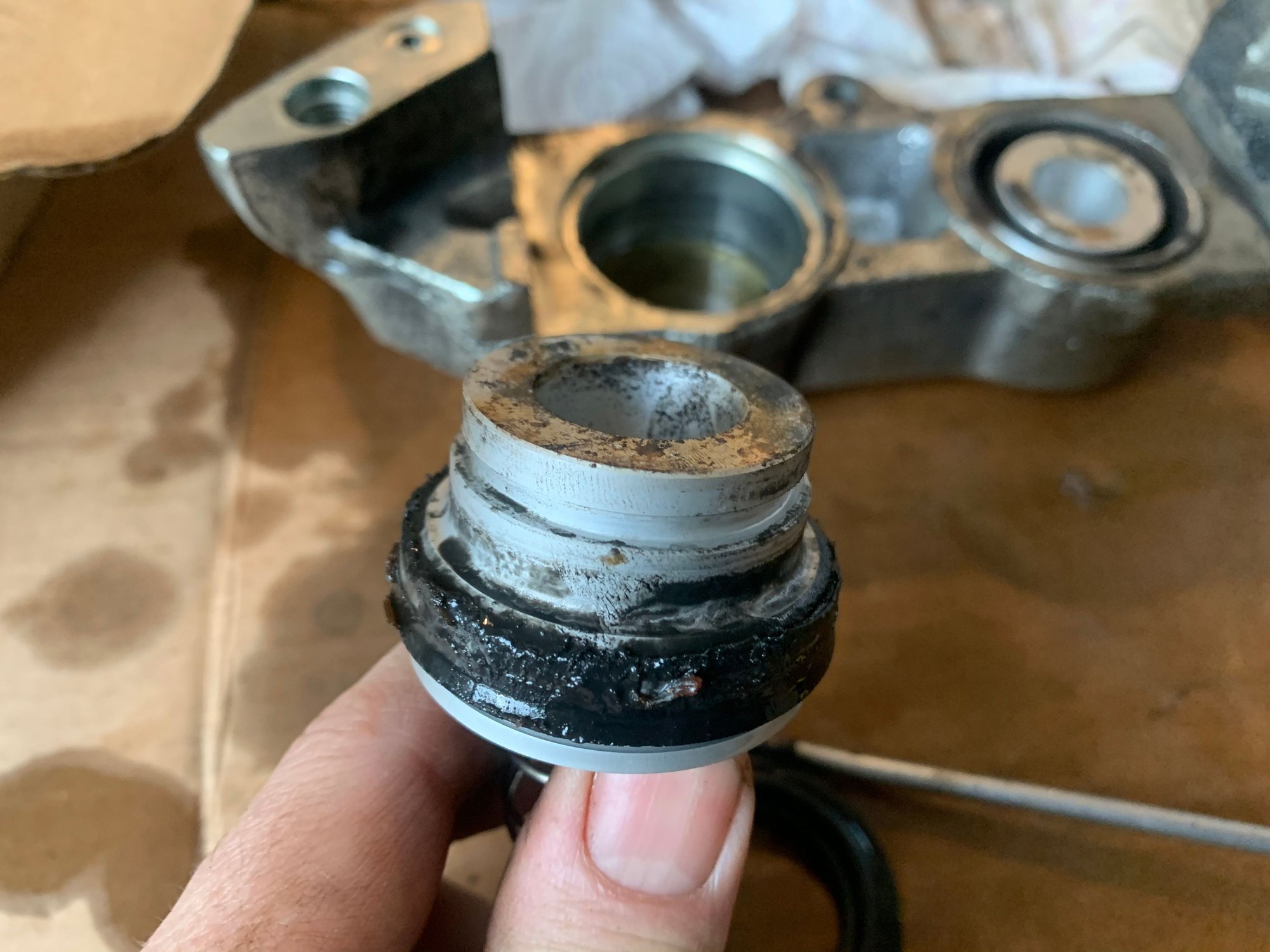

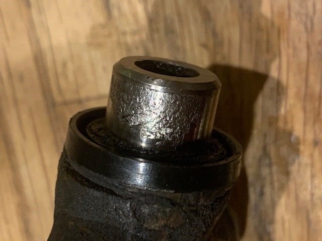

The dust seal rubber seems to have been dissolved by the brake fluid. There was black goo around the pistons
I won’t have to dip these. They have no rust. And they’re stamped something other than Delco Moraine. They were clearly replacing OEM at one point.

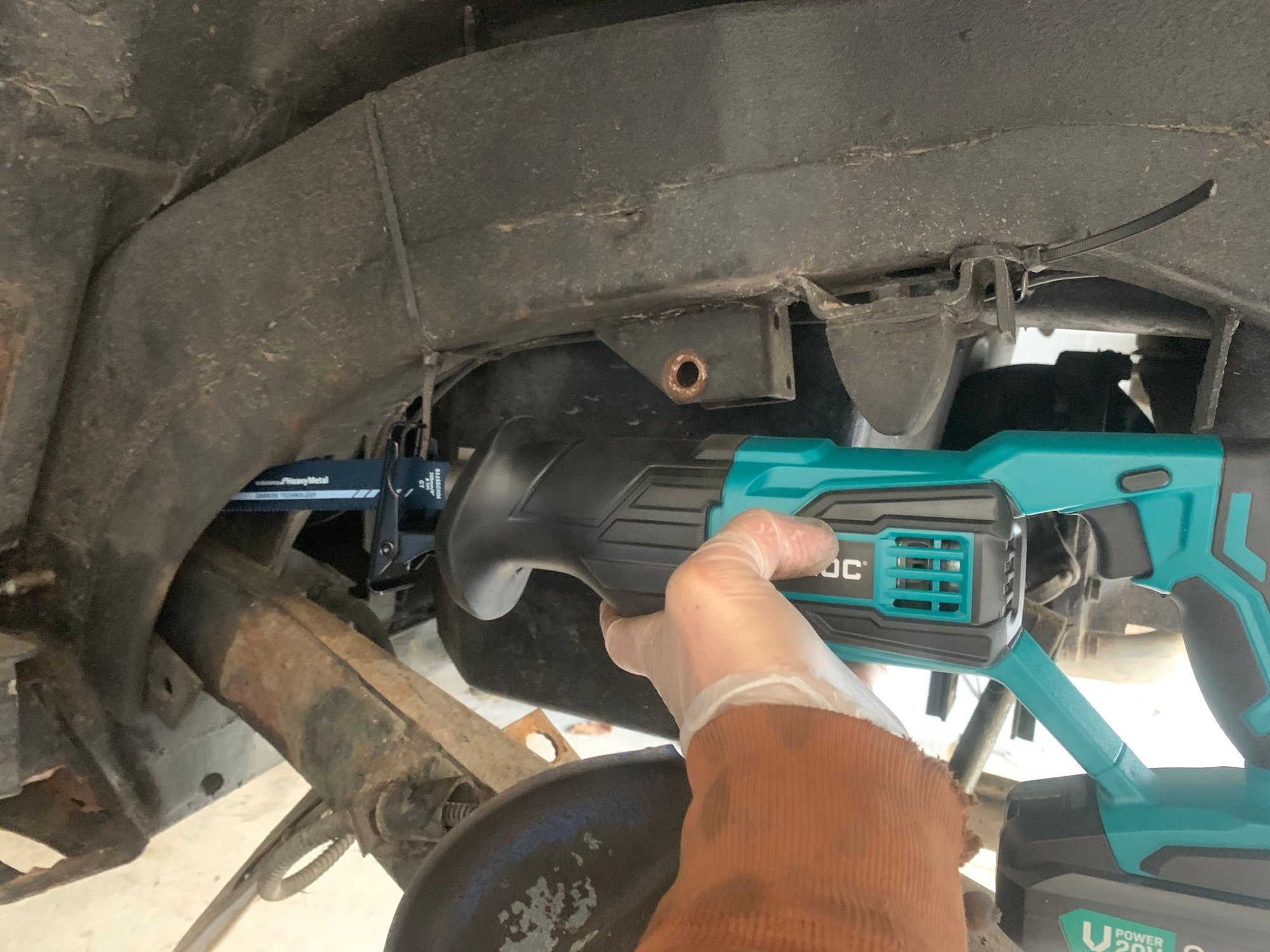

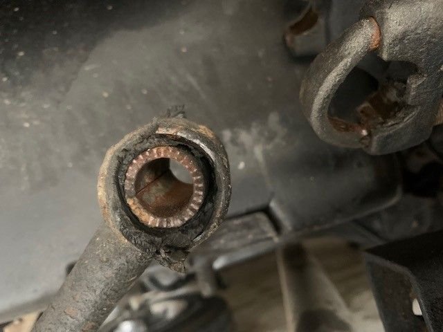

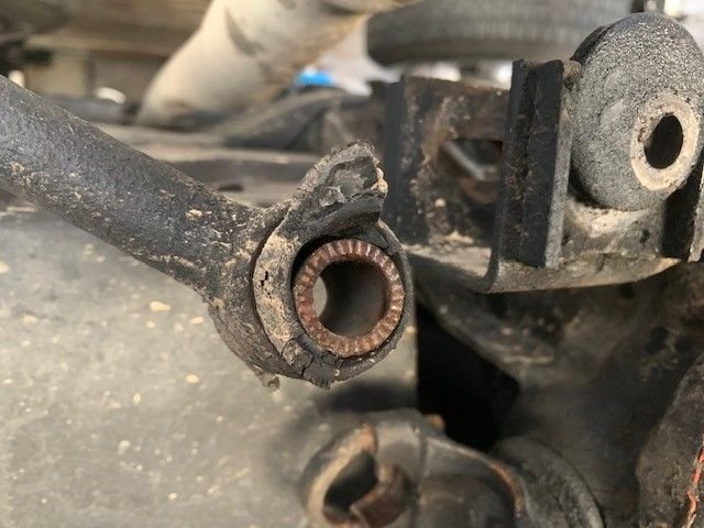

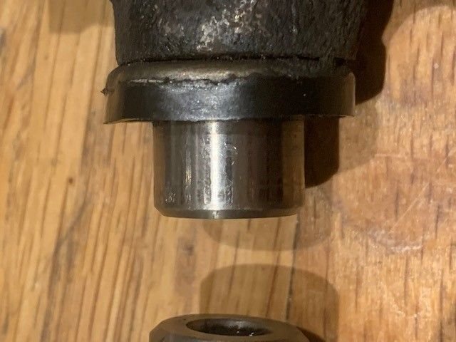

Time to sawzall out the remaining trailing arm. I was not looking forward to this job. I heard it too forever.
I could not afford a deWalt so I got the best compromise. Same goes for the blade, I could not find a Lenox carbide blade here... but I did find a 9-inch Bosch blade. Also carbide. All I could do was patiently hack away.
I started on the inside hoping the bolt might slide out.
I lucked out ! Within a few minutes 4 ??? I was through the bolt. The shims had been modified and unhooked
It was then easy to get the other side of the bolt. I’d be generous saying the entire operation took me more than 15 minutes. That sawzall blade was badass !!! And I got a nice new too out of this.
Burned right through it !!!! For once, something on this car took a fraction of the time I was expecting
If anyone has tips on how to get those bushing out... I’m all eyes
