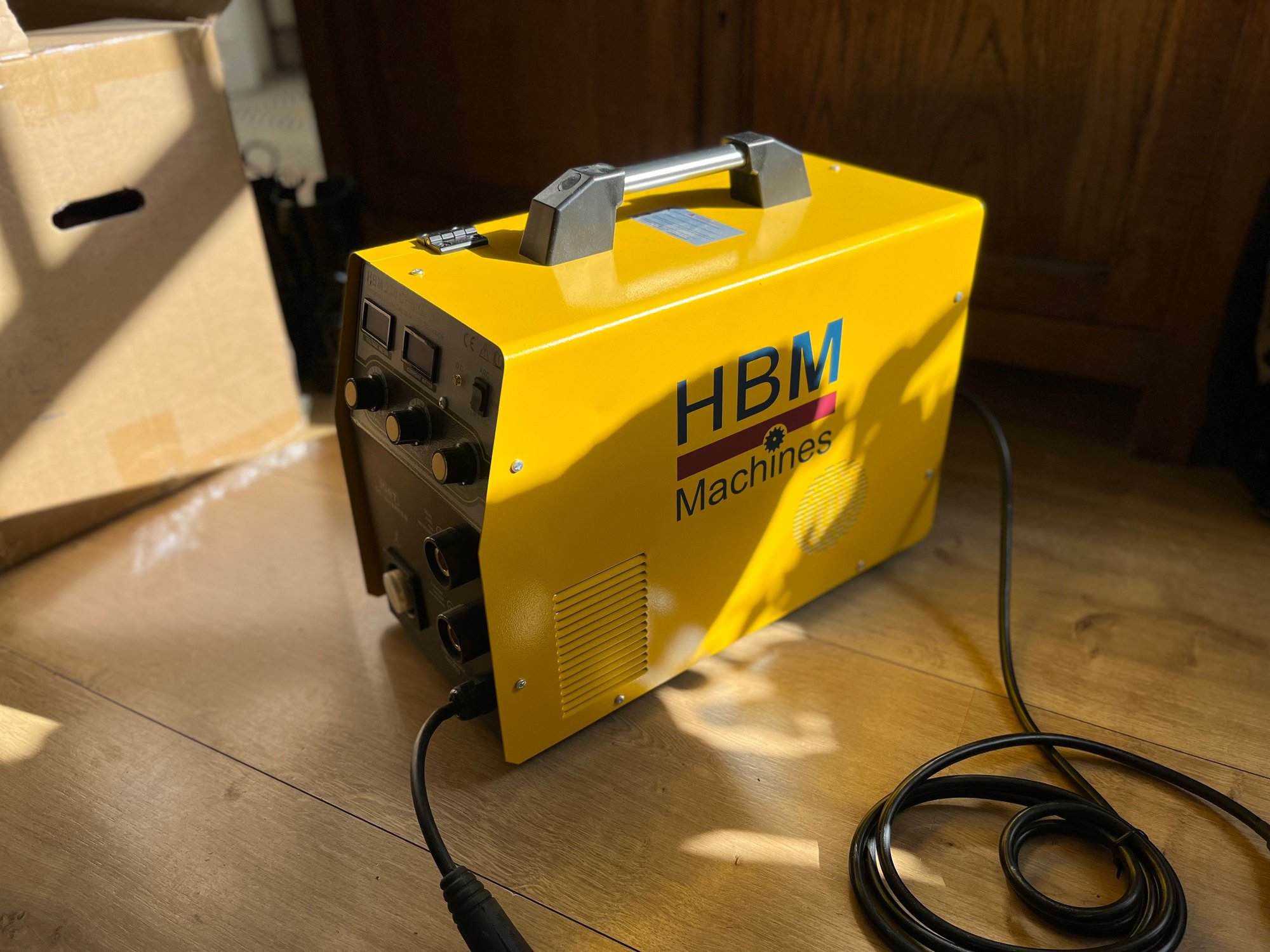

A loaner. It looks very capable. I just need to learn how to use it. Just a few days left till aD-day
Old May 23, 2023 | 09:58 PM
  #565
OldCarBum's Avatar
OldCarBum
Posts: 14,340
Likes: 8,144
From: Napa Valley California
Welder?

@OldCarBum tis, tis. No idea how to work it, but it’s about time that I do.

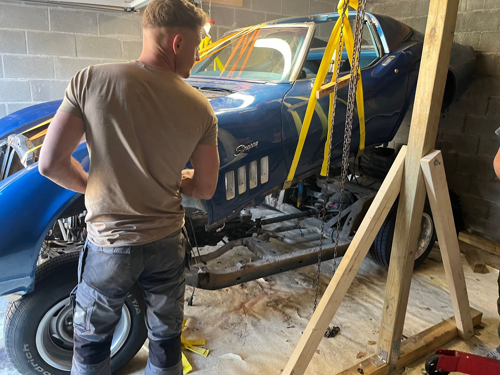

Studying this
Old May 27, 2023 | 05:36 PM
  #574
DorianC3's Avatar
DorianC3
Joined: Nov 2017
Posts: 2,352
Likes: 518
Sydney. A fellow C3 corvette owner and firefighter.
“Something is hanging.”
Lenn another viintagr car aficionado and extremely skilled with a wrench.
Jean-Marc. Professor Dr in molecular biology enjoying something very different. Not at all worried about tetanus.
And yours truly making a silly face.
Old May 27, 2023 | 05:41 PM
  #575
DorianC3's Avatar
DorianC3
Joined: Nov 2017
Posts: 2,352
Likes: 518
Something is still hanging
We got some air.
Up, up !! We needed to change method to get more clearance.

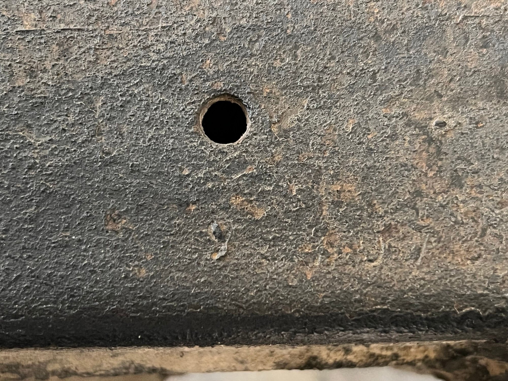

All of the mount locations look great.

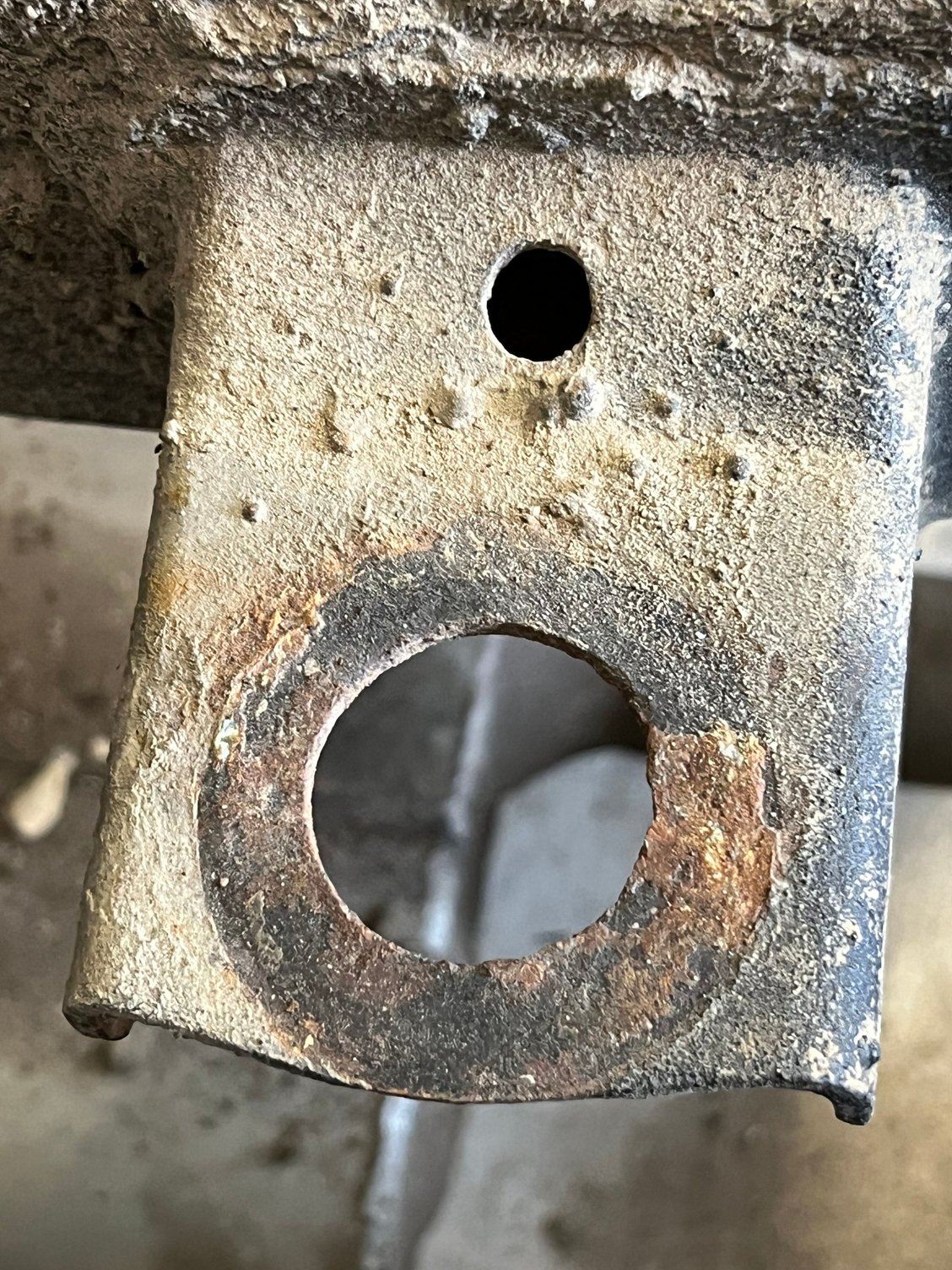

This is where the rust was. This corner. It looks much better than I expected.

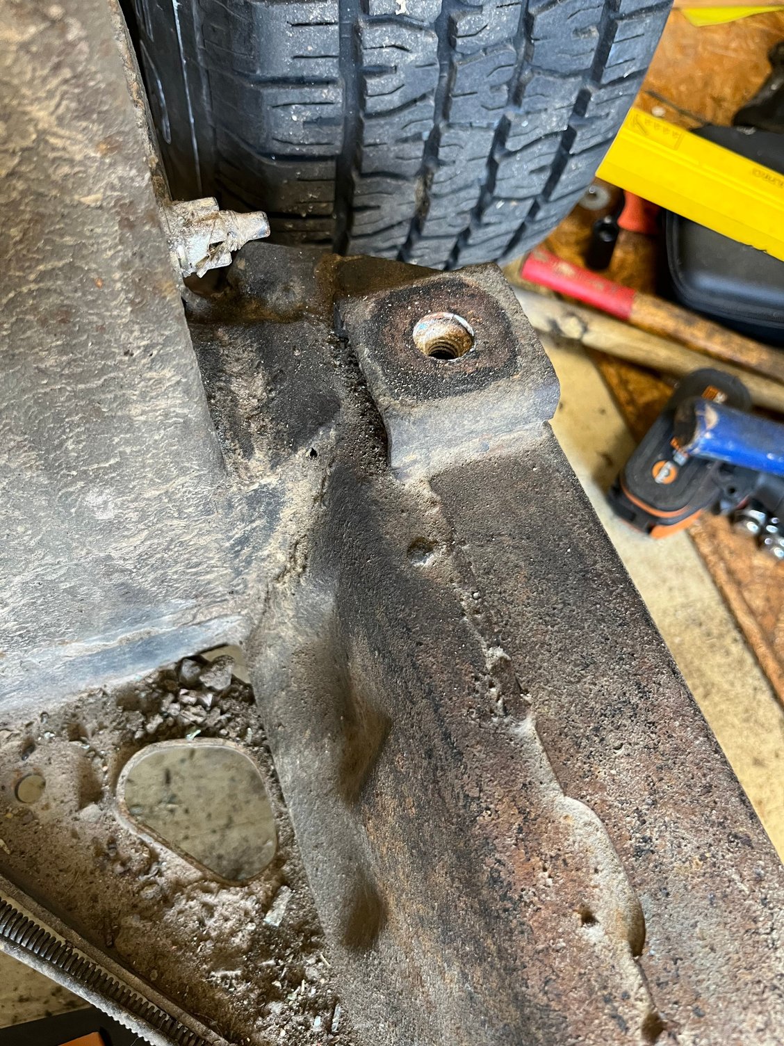

Rust under sill. On cage.
Same one other side. I have no idea how I’m going to fix this either.
