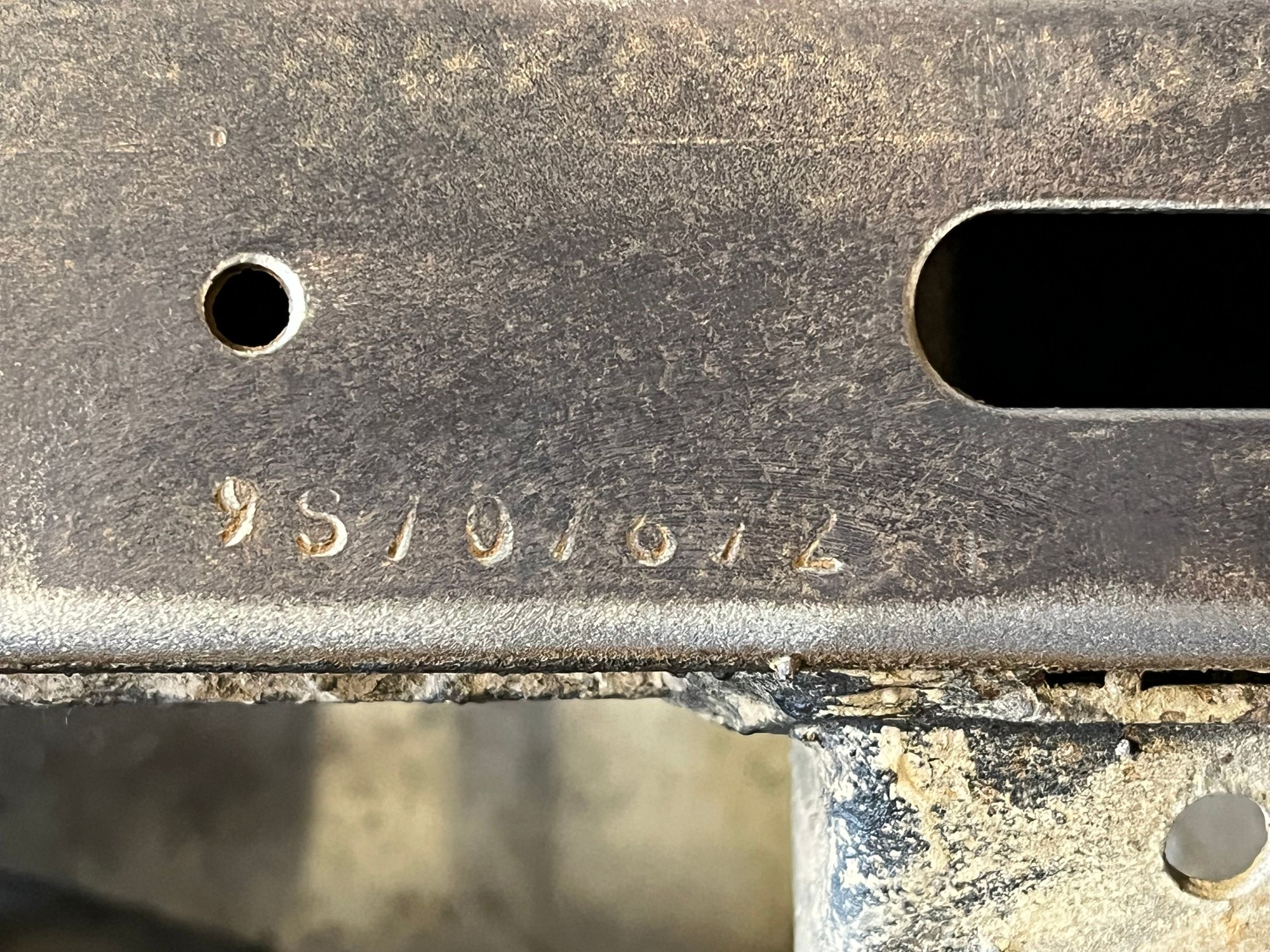

Interesting. The entire VIN is not struck in the frame. The first numbers are missing

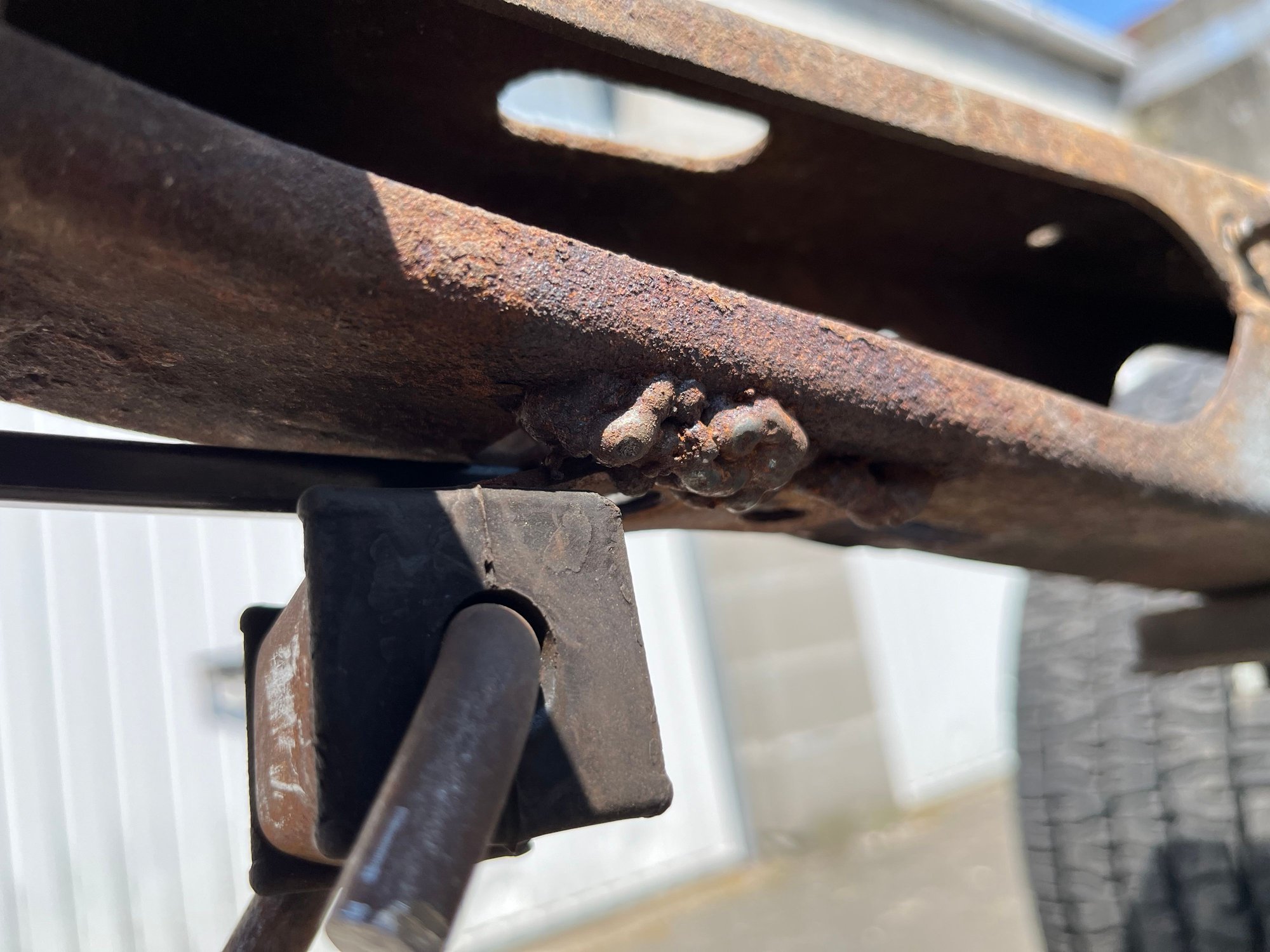

I must say it’s faaaar more relaxing to work on a car with the body off.

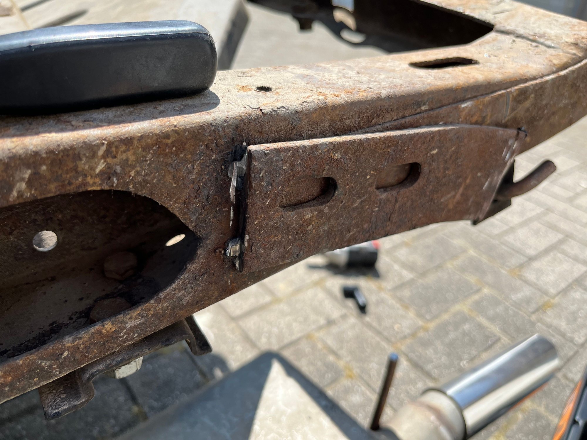

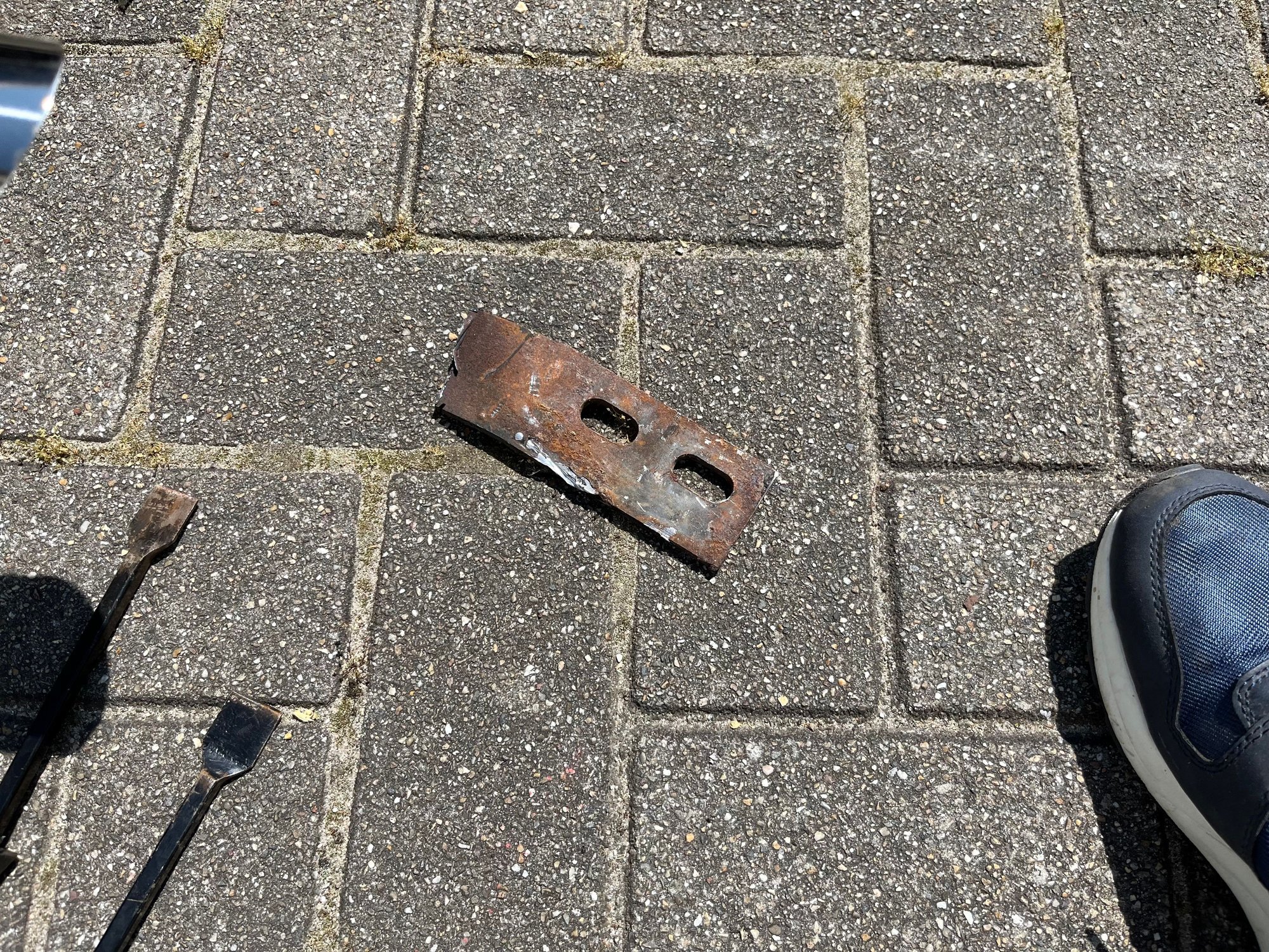

First I need to grind this off. Fortunately, it was poorly tack welded on.
Helpful tool.
Bing !

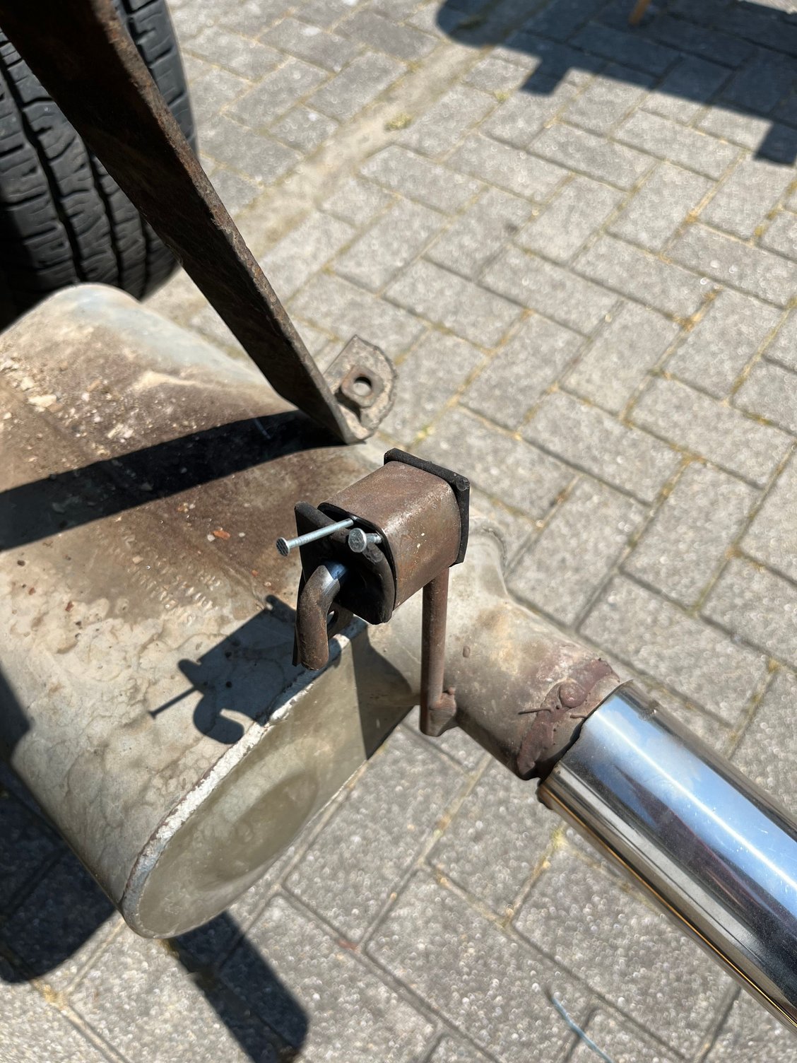

Local mechanic’s solution to my request to stopping an exhaust rattle. Now you see why I like doing most jobs myself.
Seriously?!?!?
Ready for an OEM hanger.

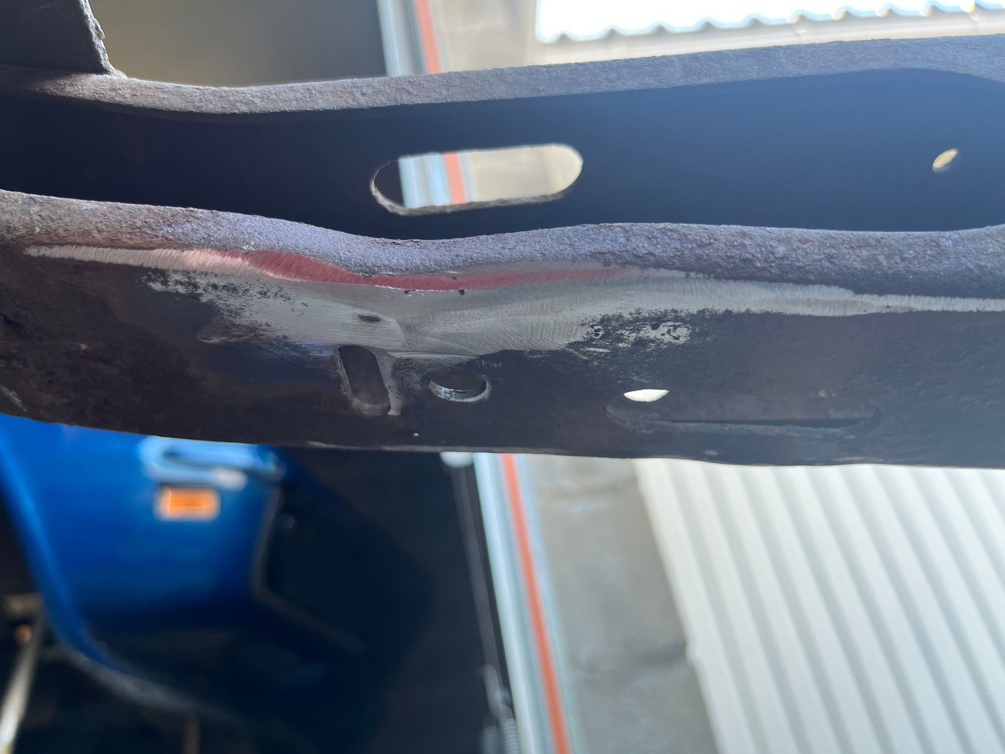

Well that rear crossmember does not look very straight. Clearly got kicked on the butt at some point.

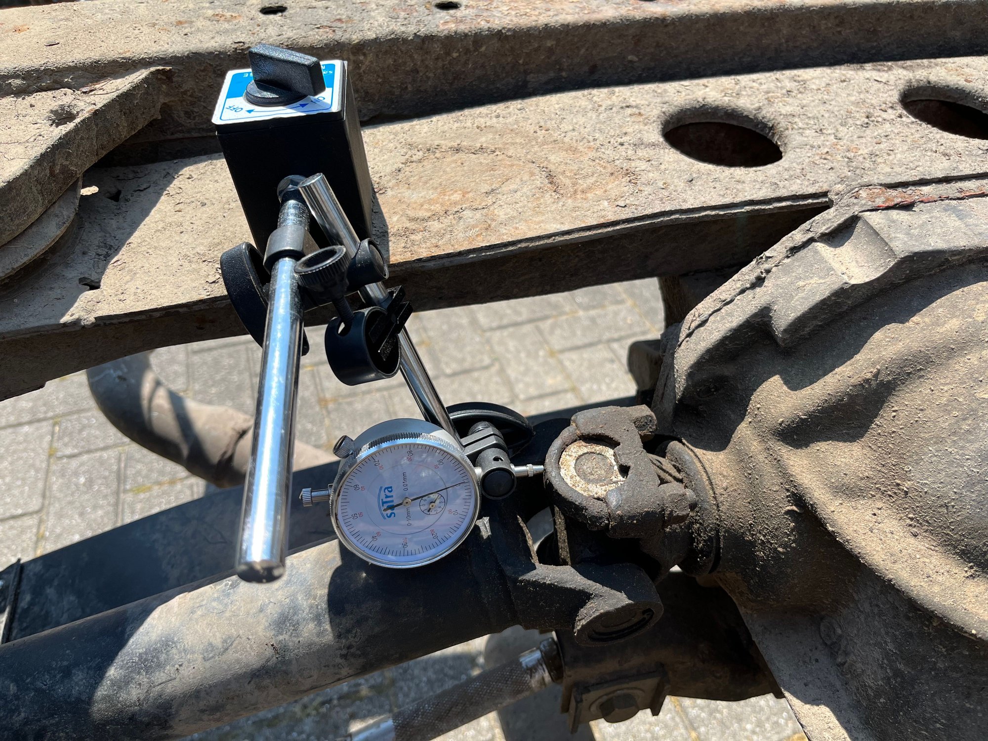

Doesn’t get much easier than this to measure end play. We’re at 0.019 on both sides. It feels like much more, but the measurement is accurate
Lest we forget why we are doing this exercise

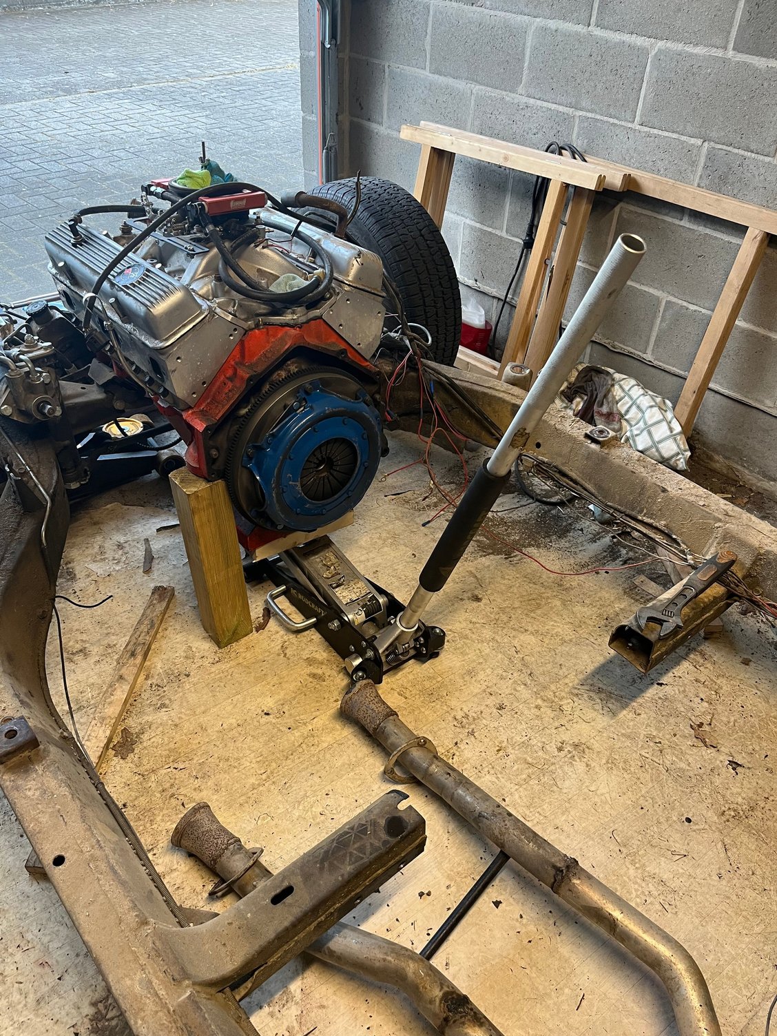

Next step to tear down.
There ! The T5 is dropped and ready sale. You served me briefly but well. Unfortunately, you are the weakest link. Goodbye.
