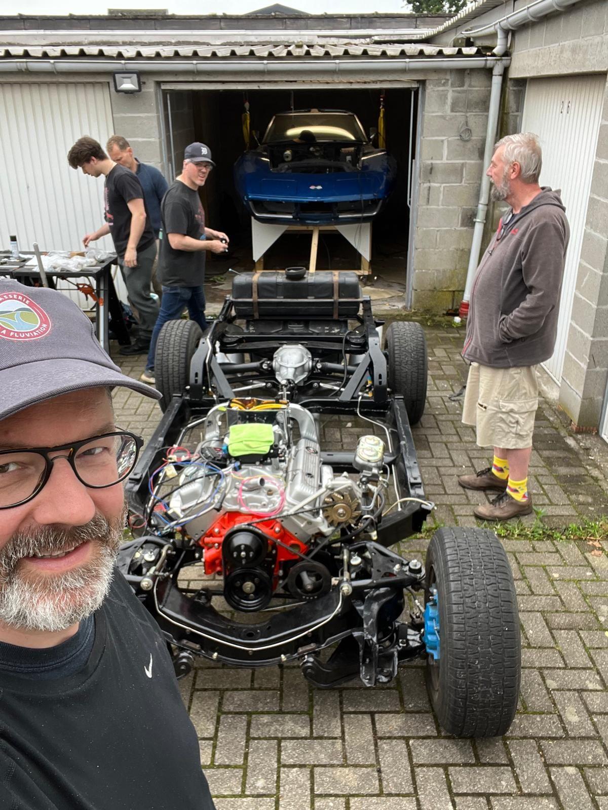

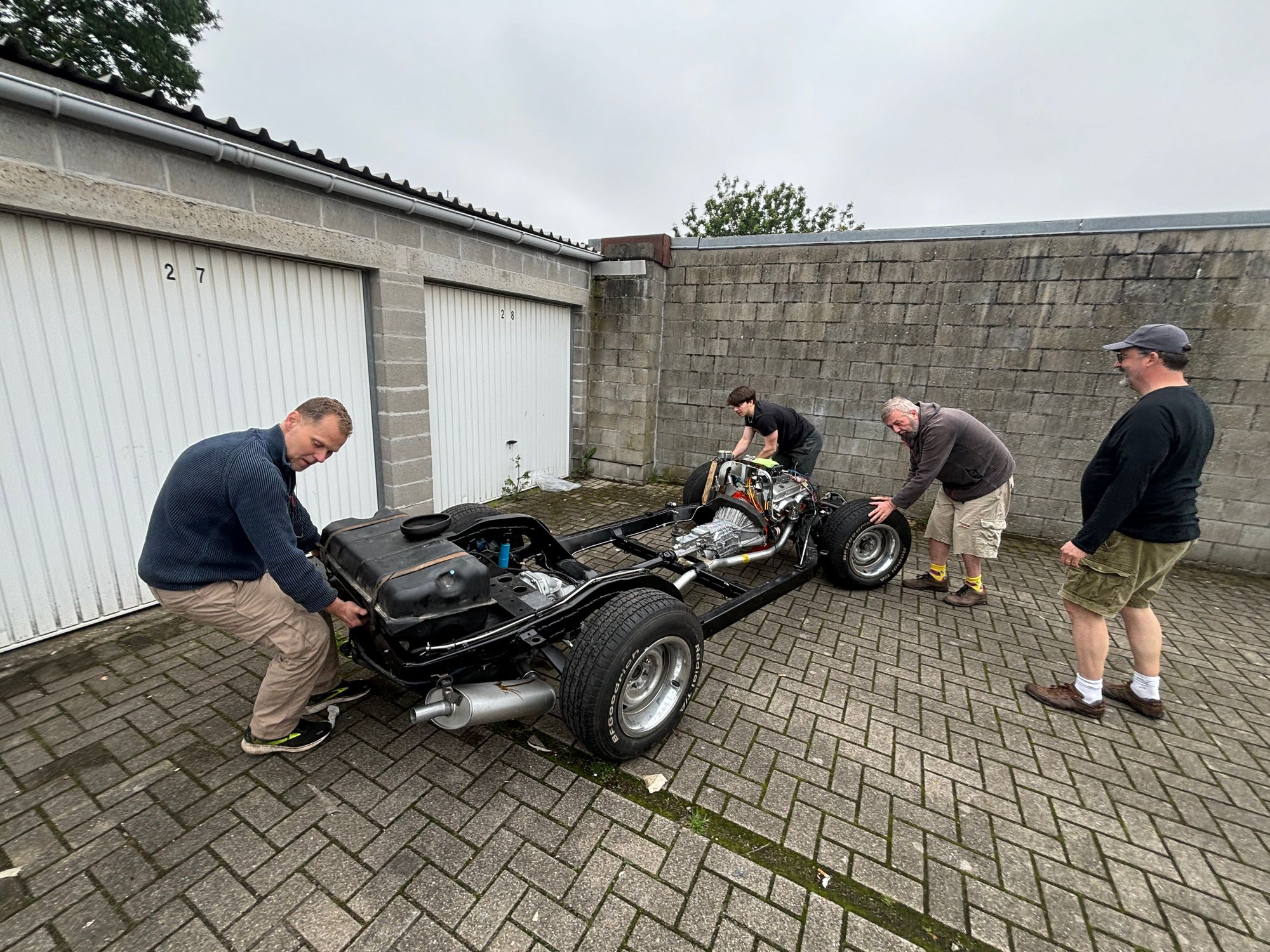

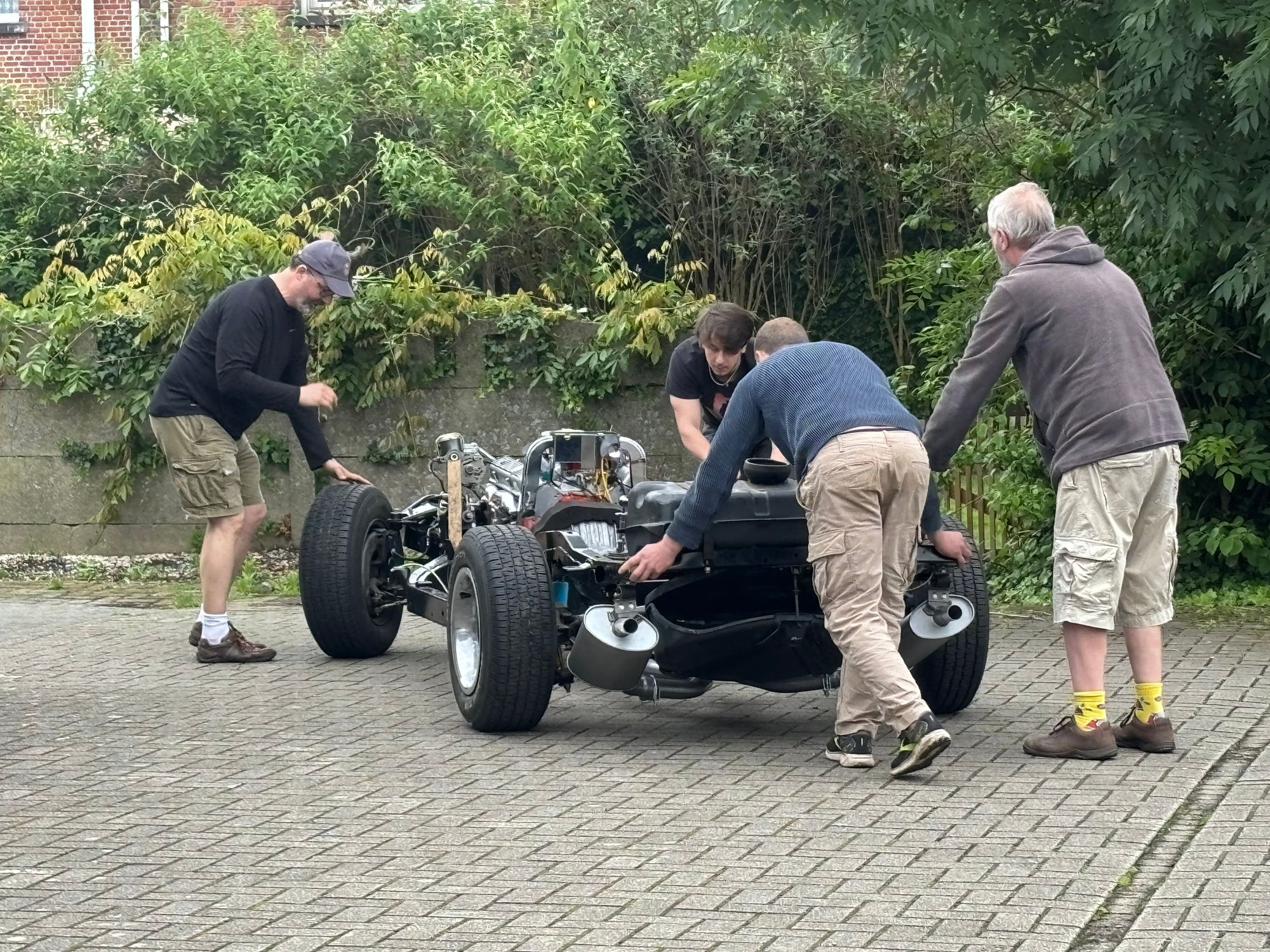

Getting ready for the drop.

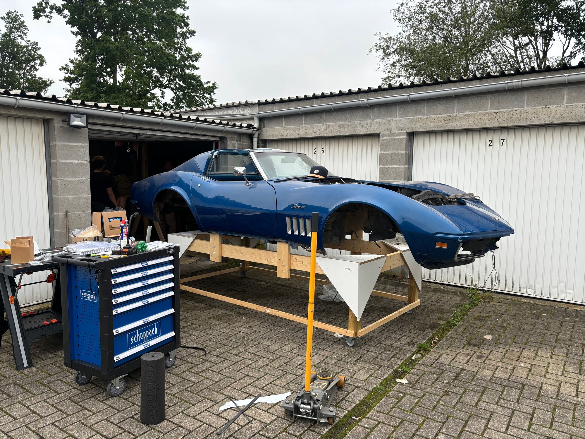

Scooting the frame out so the winches can be mounted.
Murphy’s law. Of course one of the winches failed. A bent power spade. A very minor issue.
Wheeling over the frame.
Closer still

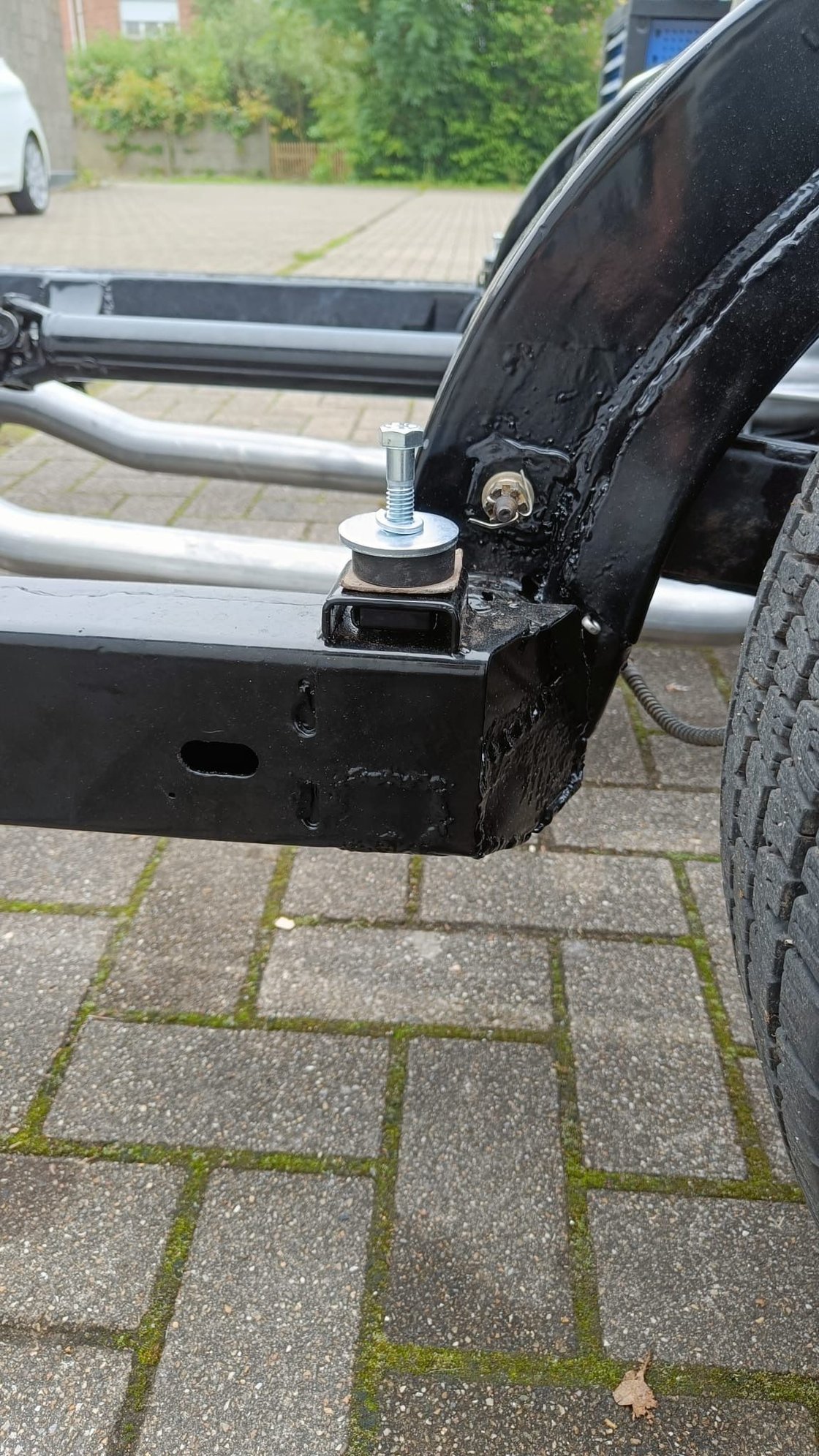

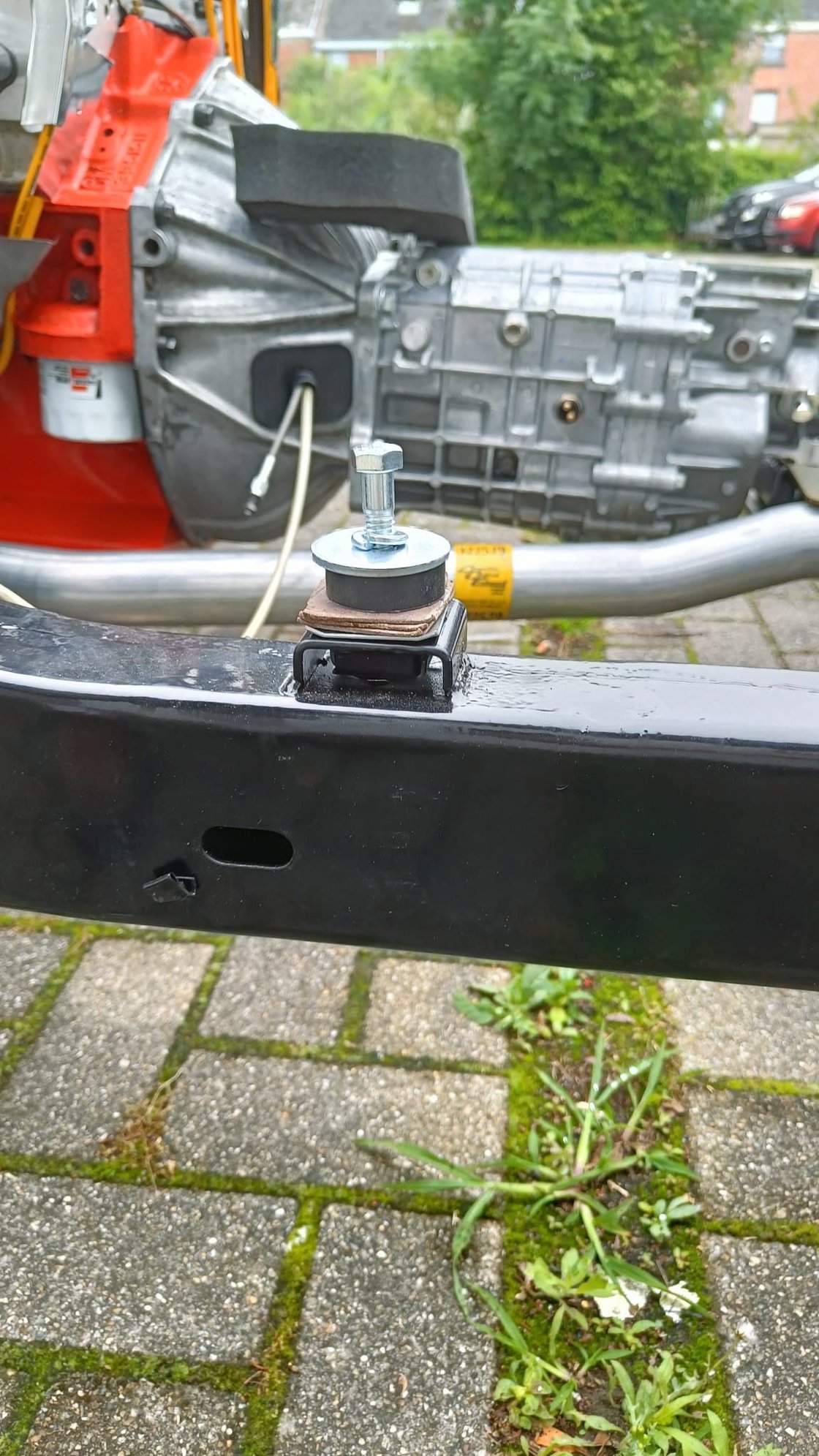

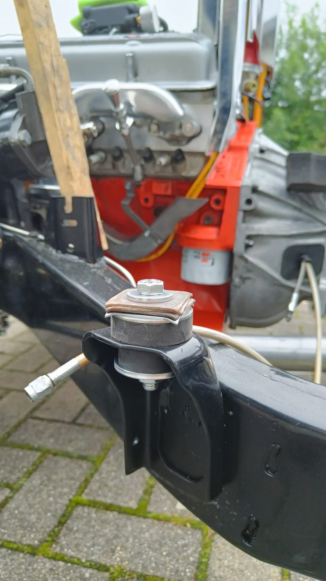

New body mounts are ready.
Another.
Another.

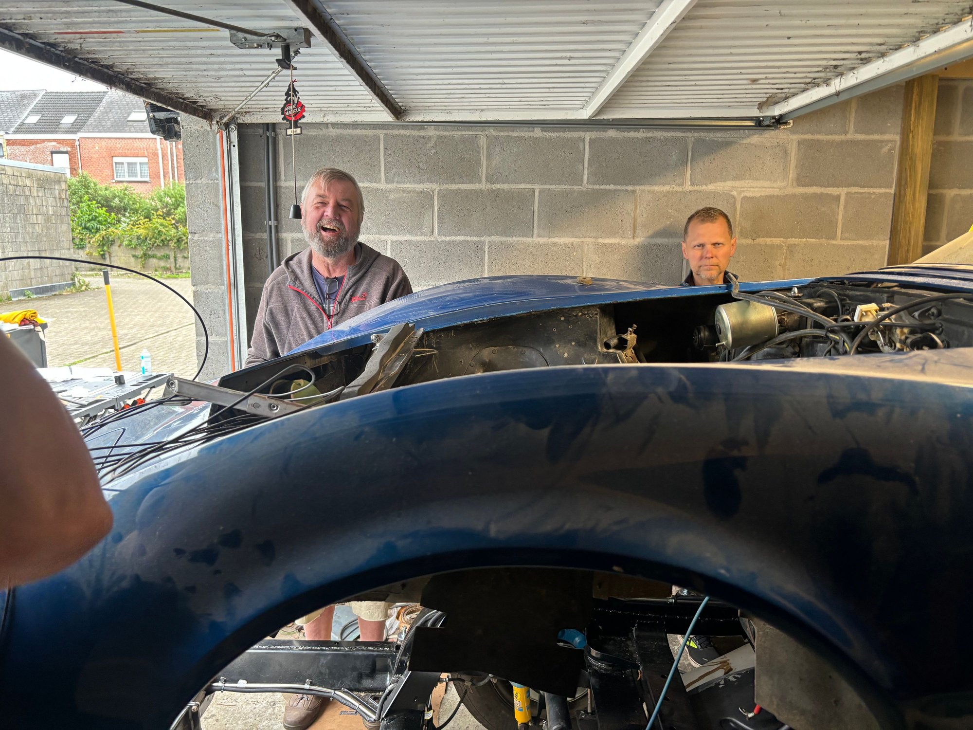

With a little help from my friends.
:o)
Boom! It was relatively straightforward with everything lining up better than I expected.
And to conclude.
BBQ time.
Me in the back there with the Detroit cap.

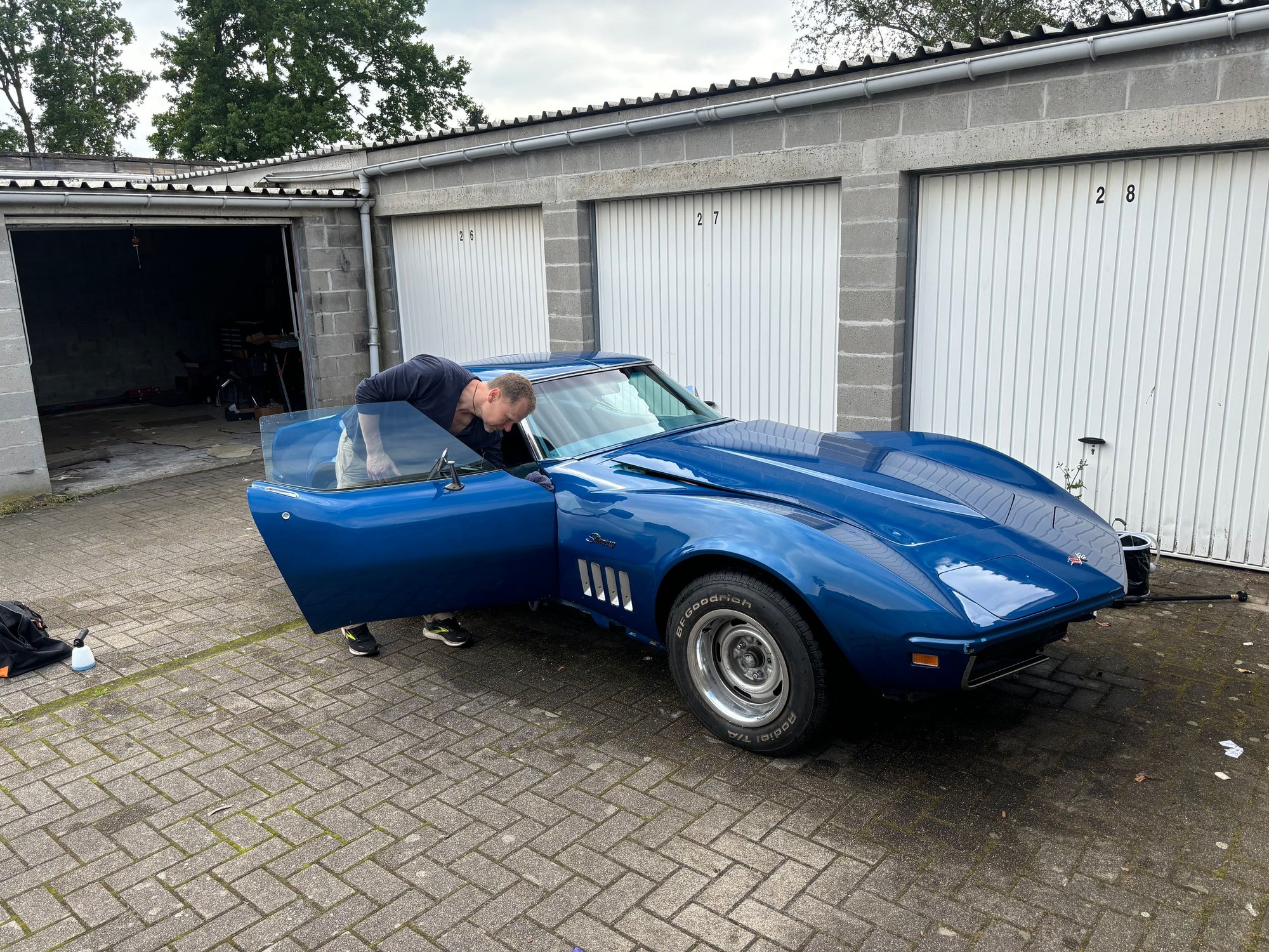

I guess I’m going to wash the car tomorrow.

It is looking like a car again!
That was my first thought.
Car gets a bath for first time in a year.

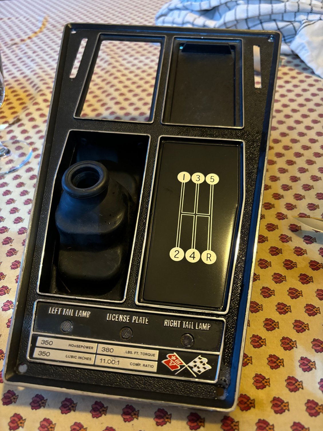

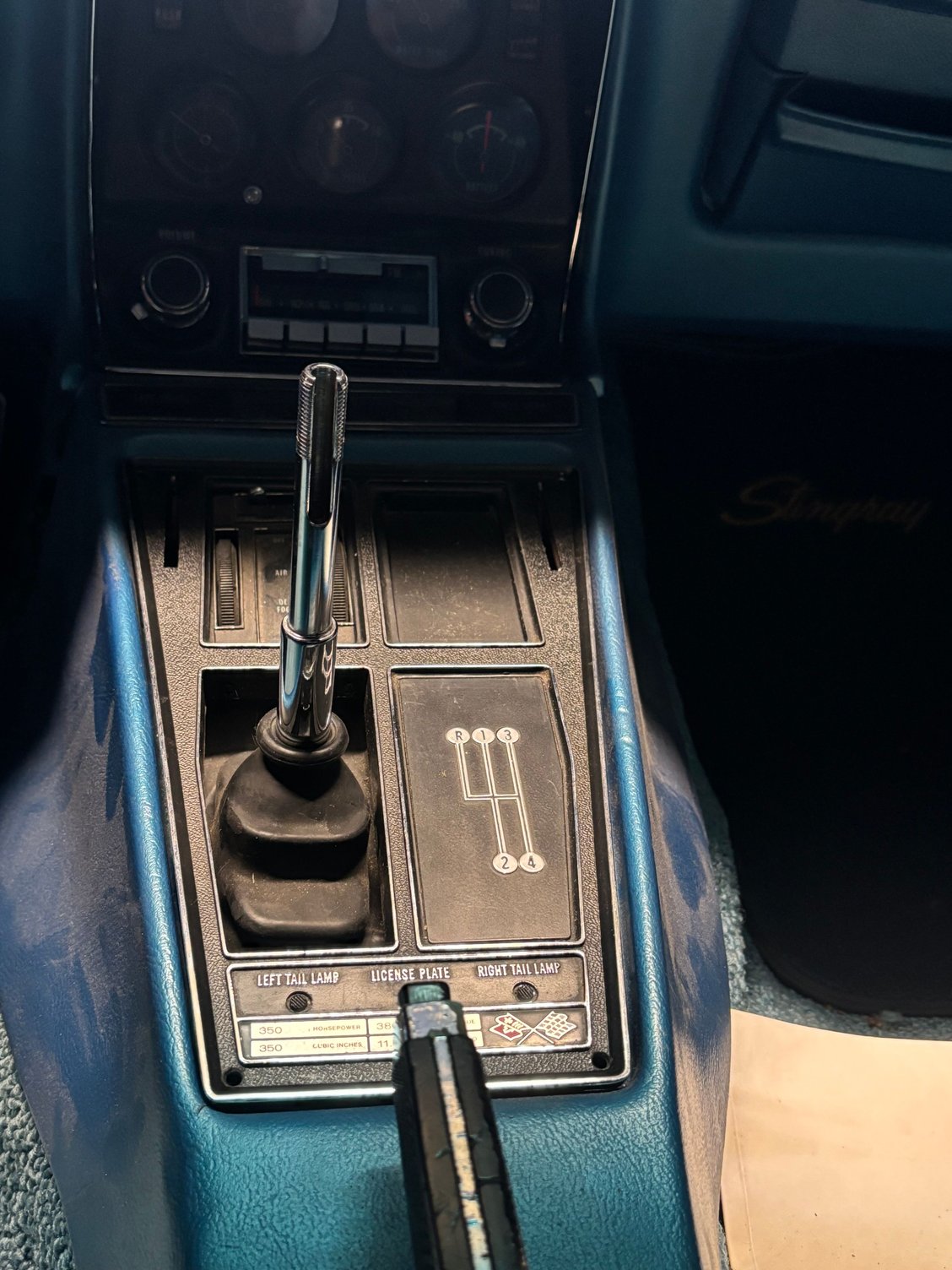

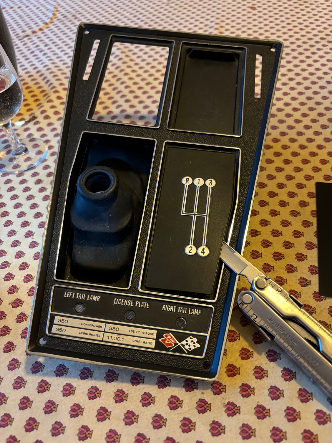

One thing I’m particularly chuffed about is that the TKX shift lever is exactly where it is supposed to be. I must have welded the spare crossmember in exactly the right location. The funny bit was, I woke up at 0300 suddenly wondering if it was in right place. I hadn’t checked yet. I was already thinking about how I was going to fix if it was off - and I was quite sure it was off. All for nothing. This looks perfect.

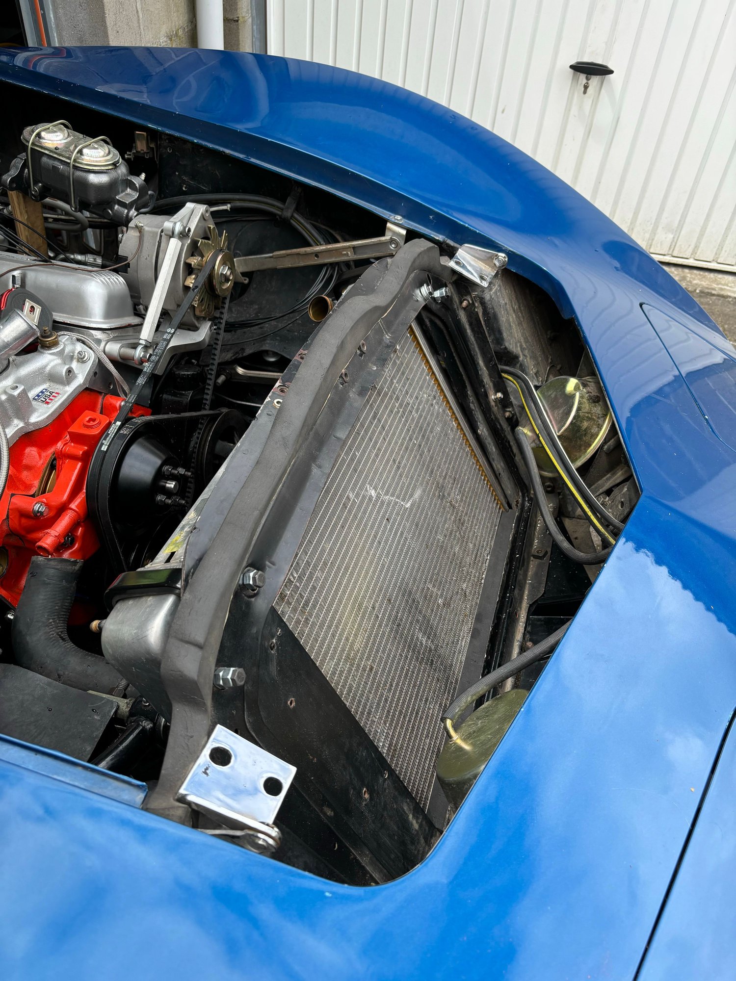

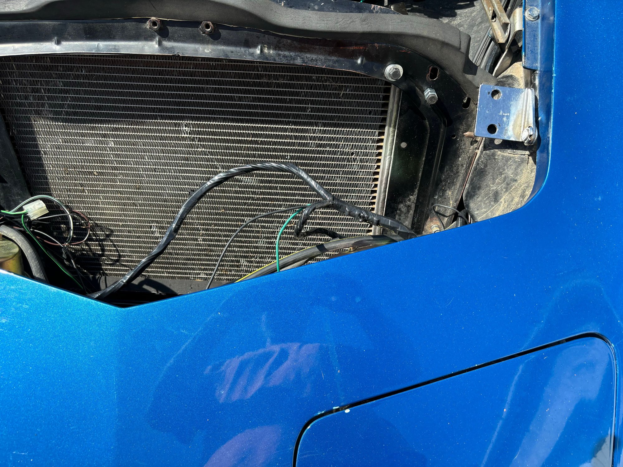

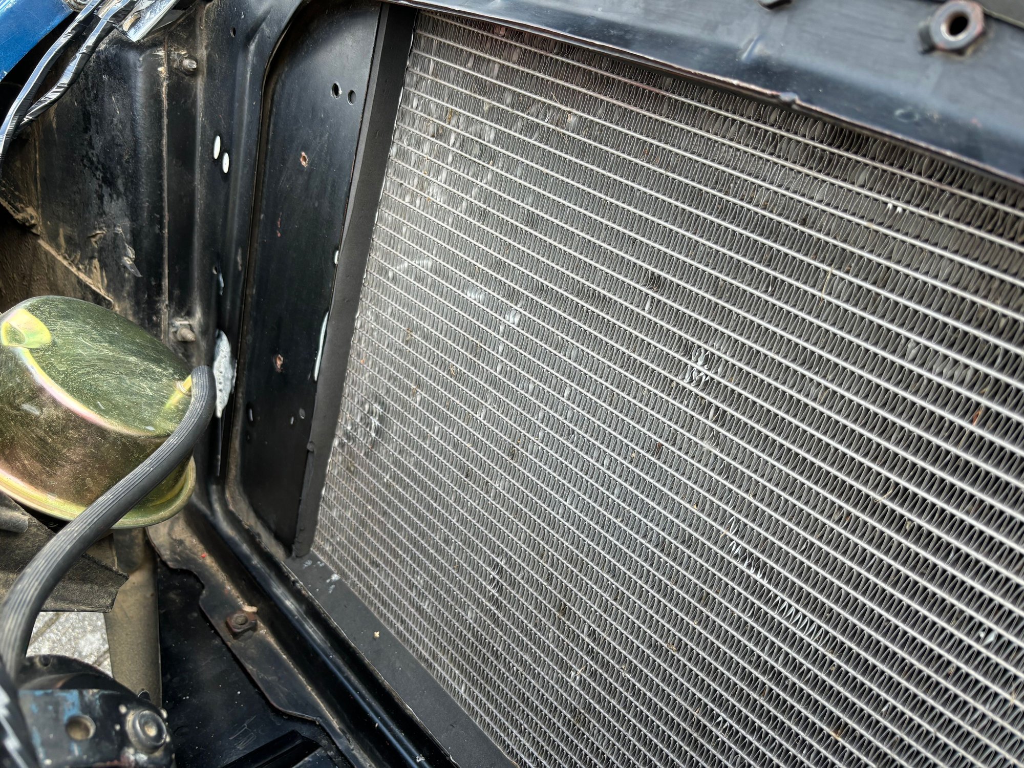

Radiator installed with new brackets. Much netter than what I had before.

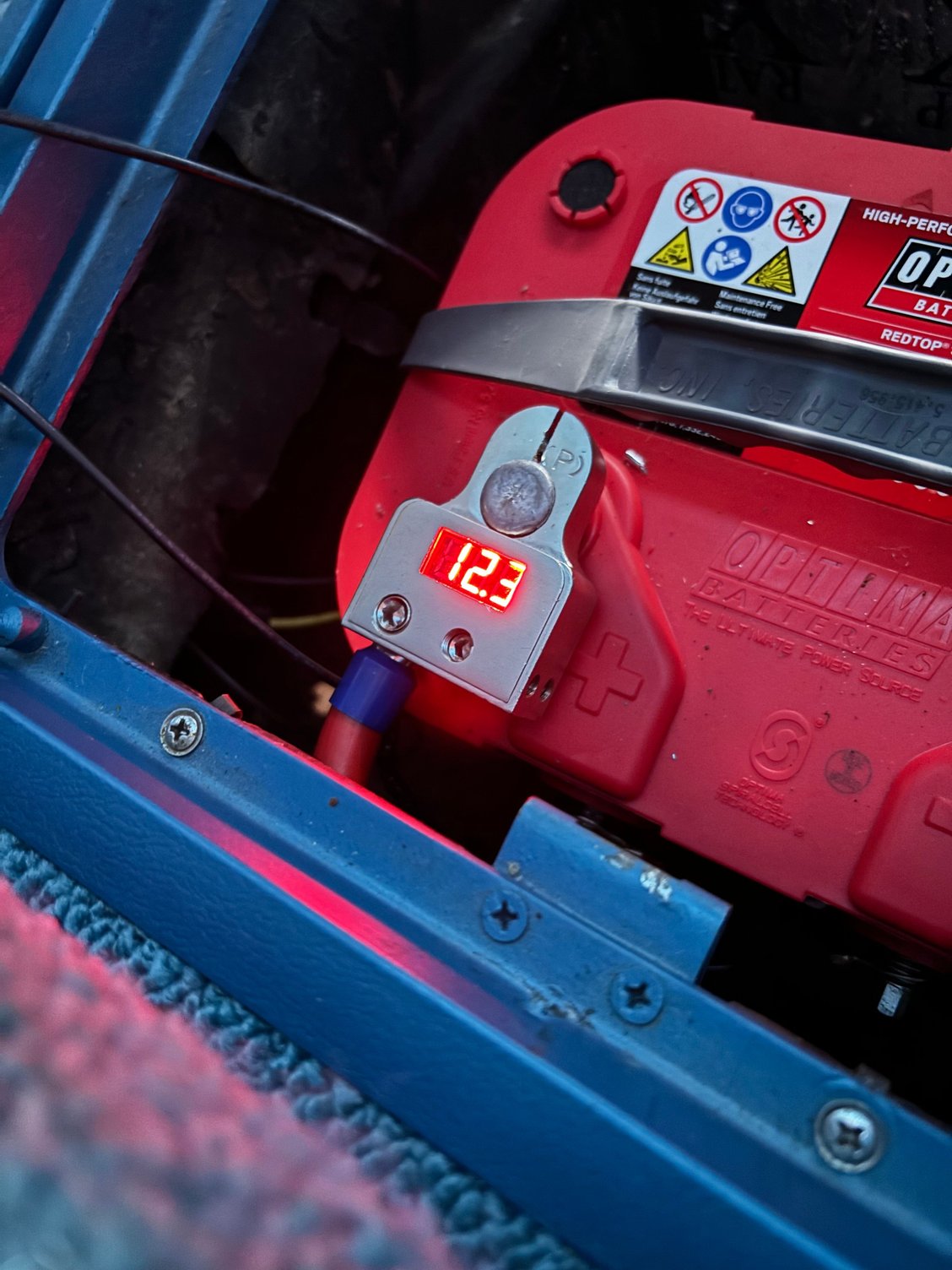

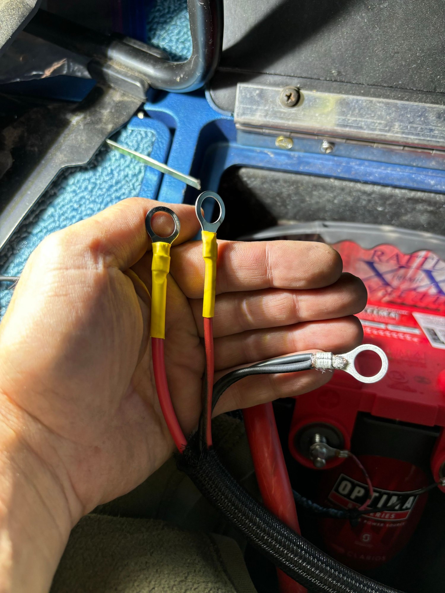

Possibly junk. We shall see. The built-in voltmeter that is. I am sure the Optima battery is fine.

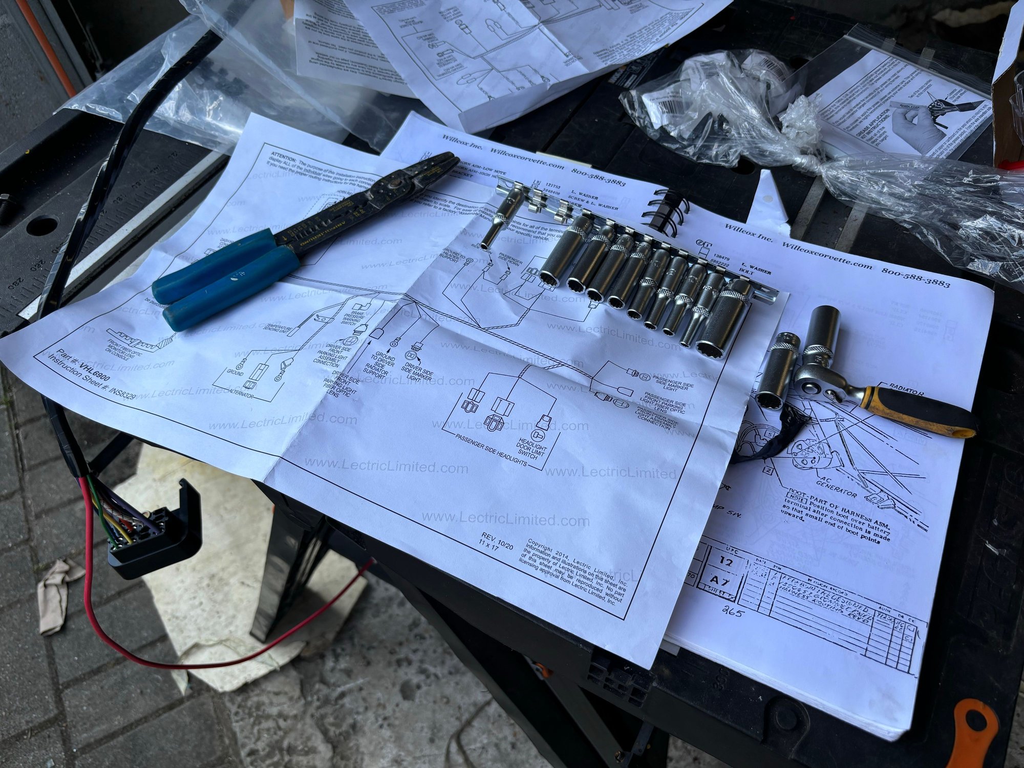

New harness. It was expensive, but the right thing to do.
Horn Relay wired up. The key switch needs to be fixed.

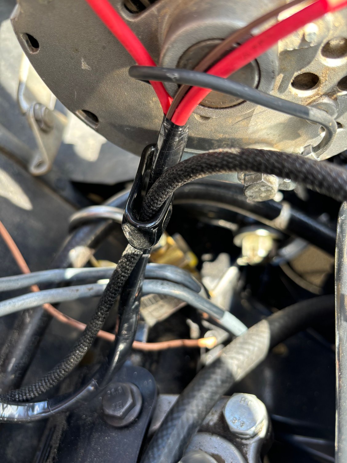

Instructions...
A bracket came supplied and keeps wires away from exhaust manifold. Nice to see that restored.
The old zip-tie trick.

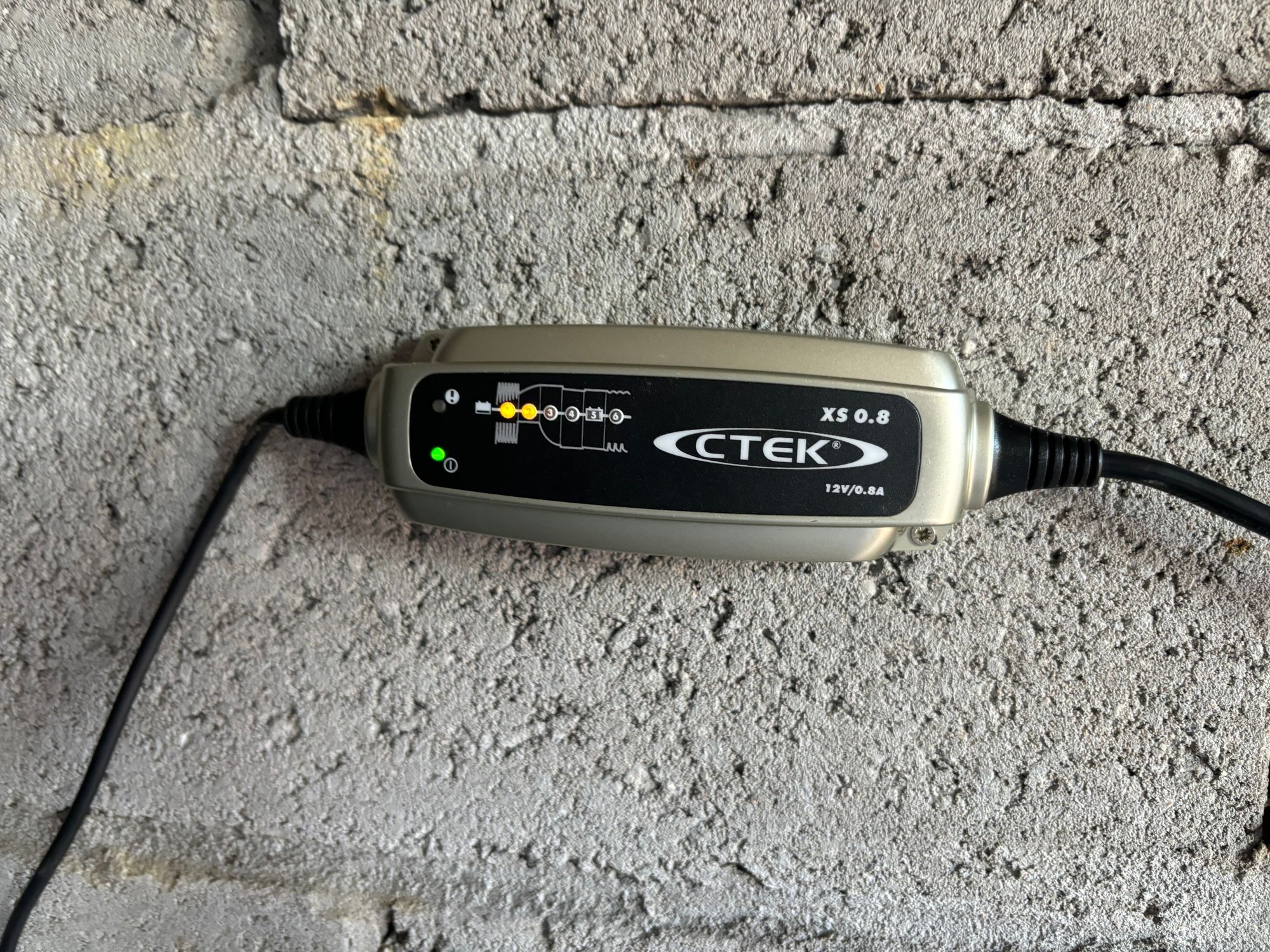

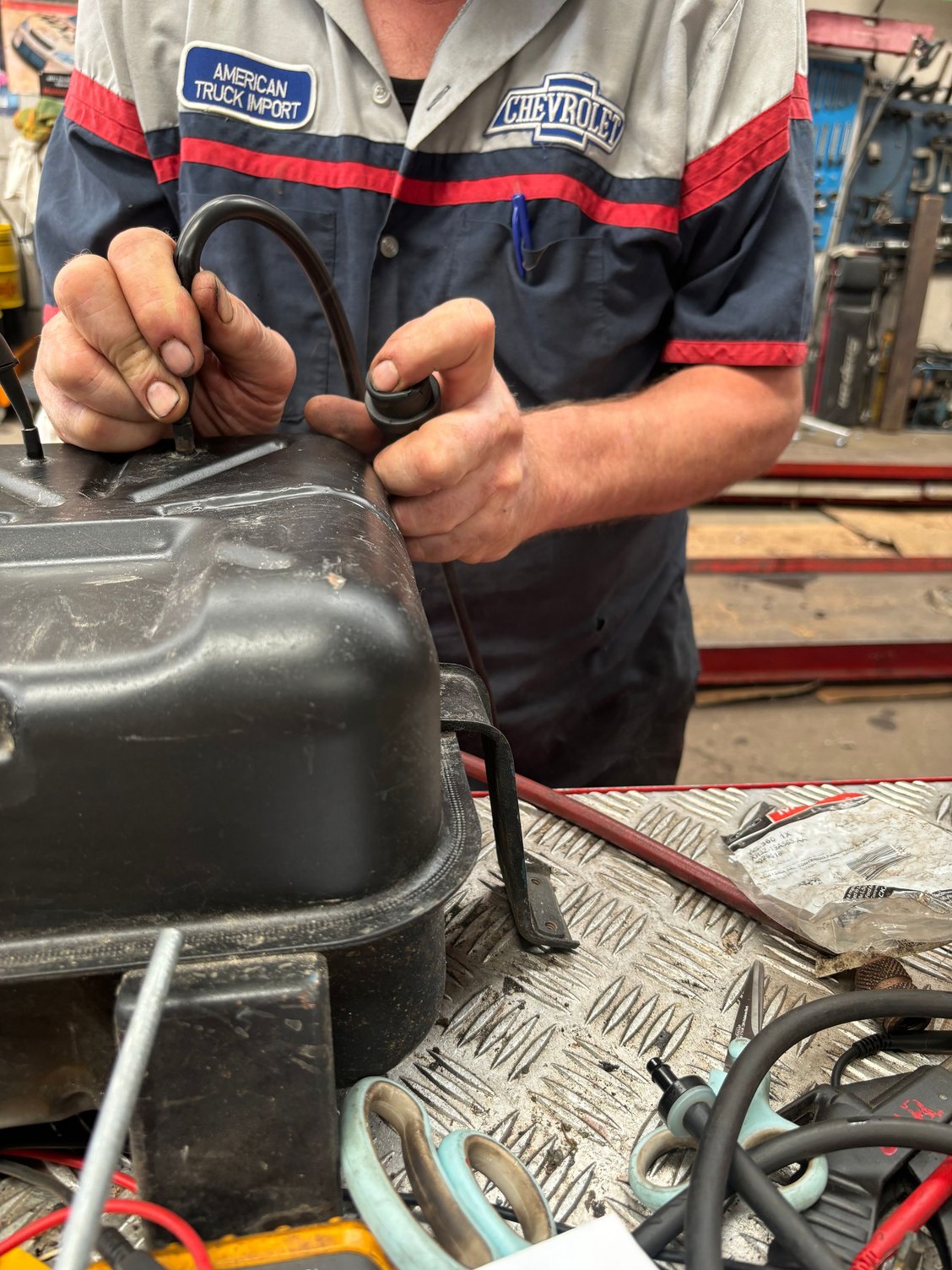

Small update. I installed this Ctek trickle charger on the wall. I’m tired of disconnecting the battery every I park the car. I’d much rather have a wire under the seat to connect.
I want one of these.

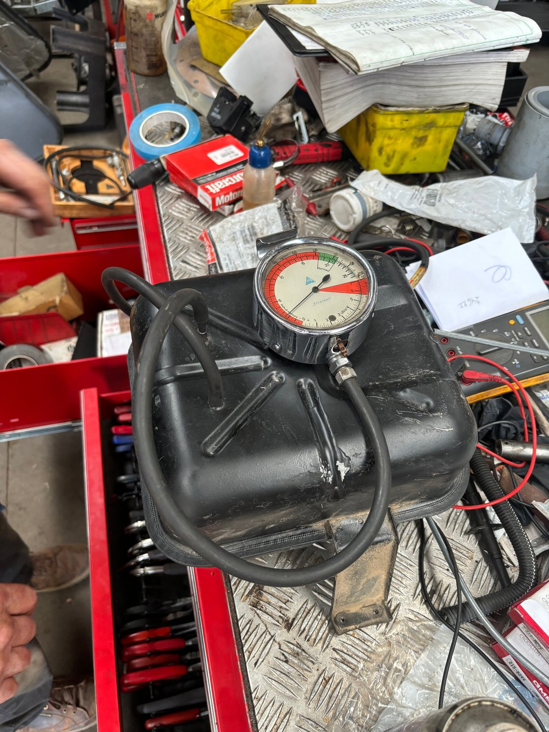

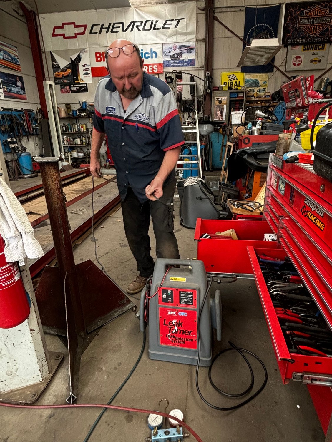

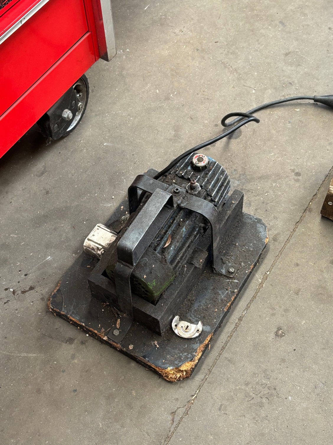

A vacuum pump.
Testing how well it holds vacuum. It leaks down quite quickly.
Then we pumped smoke into it.
Smoke leaking from at least three places.

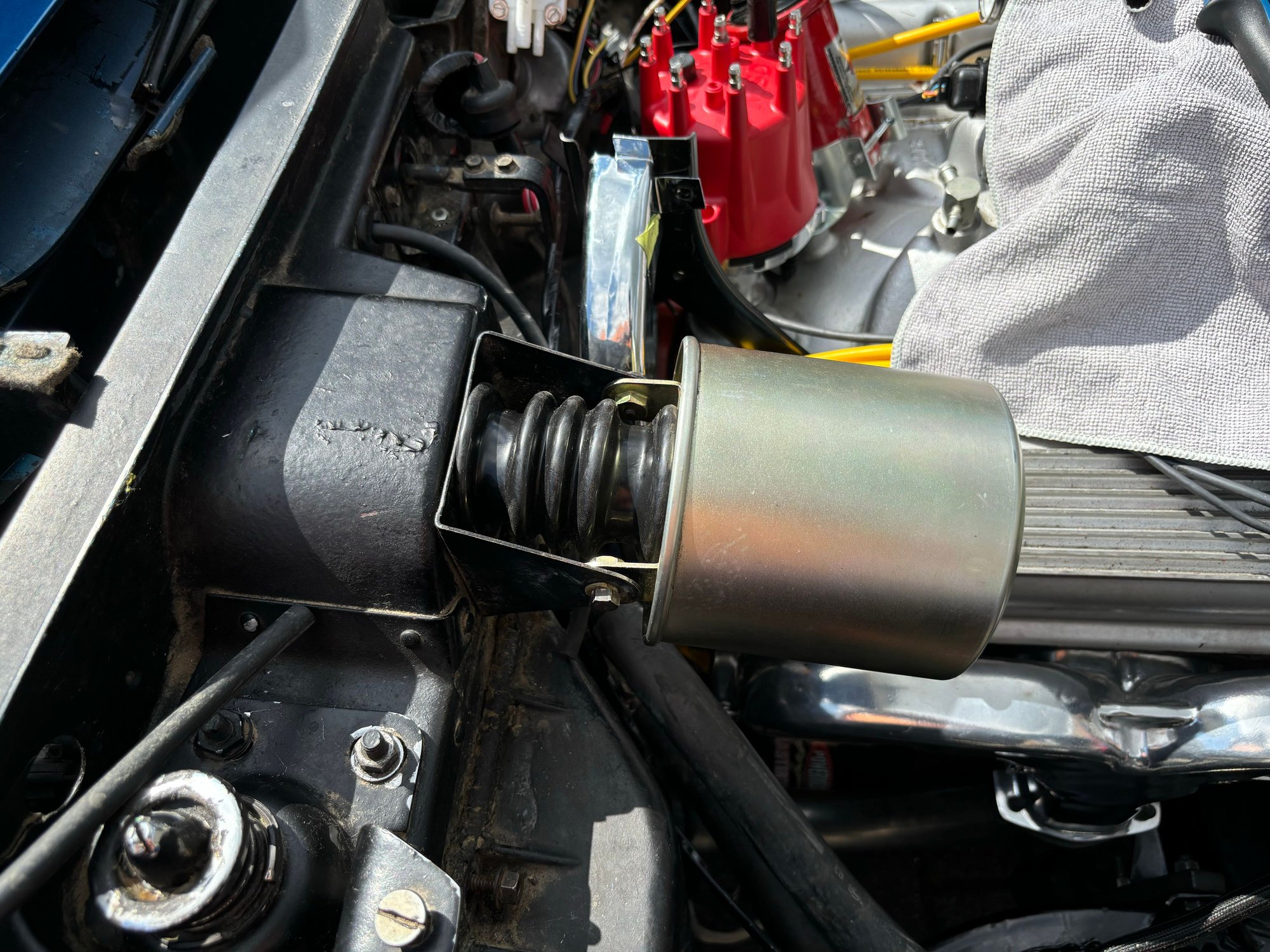

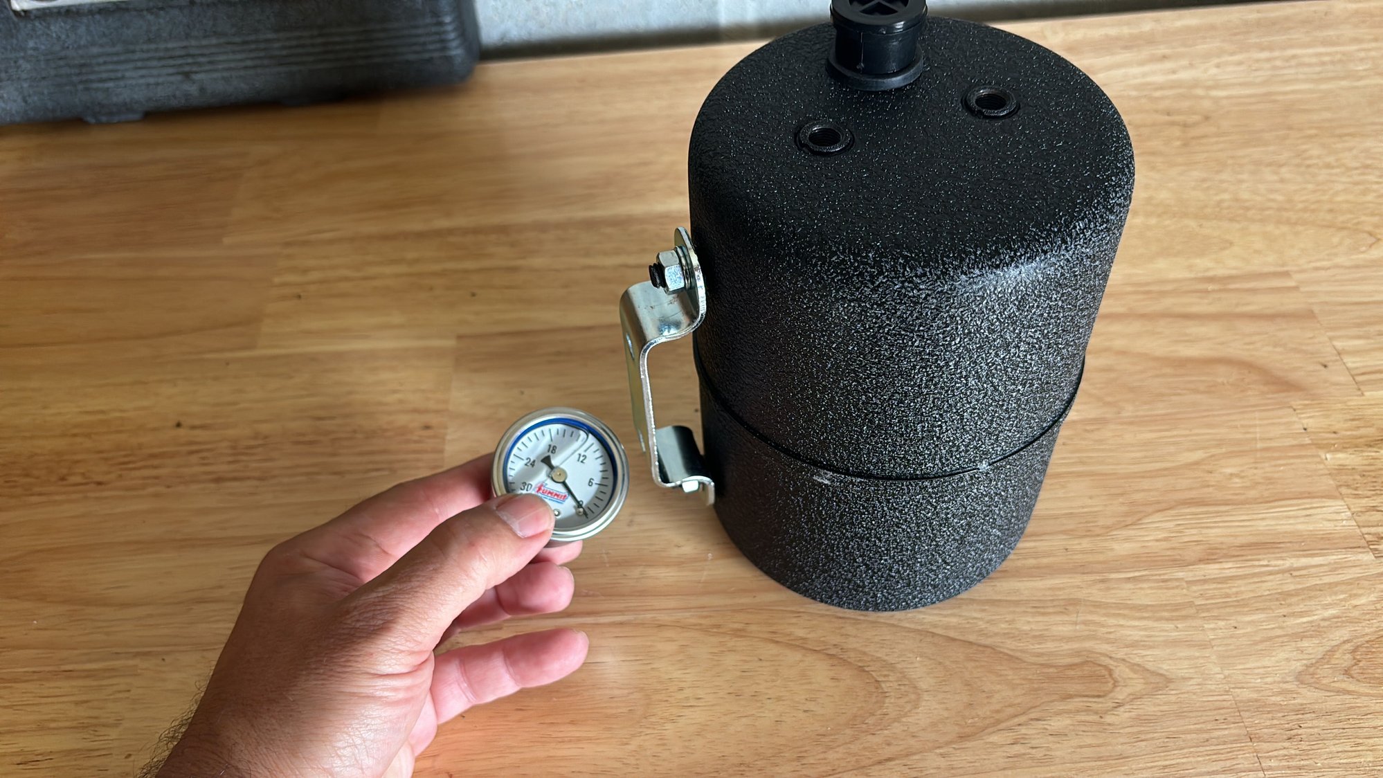

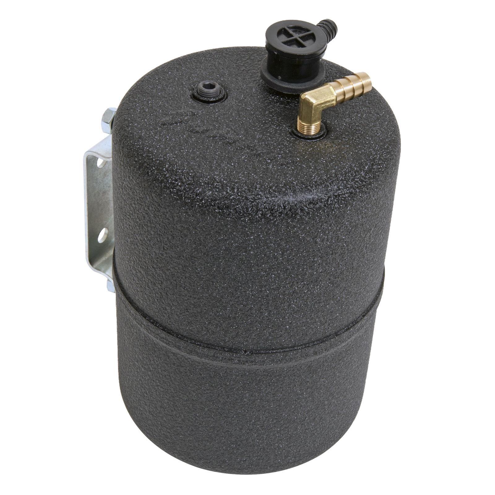

As the car is not matching numbers and I’m not too concerned with original appearance, I decided to spring for this

Just to be clear about my decision to go with an aftermarket vacuum tank. I spent many hours sanding and patching cracks with epoxy getting absolutely nowhere. I suspect no matter what I do this thing will always leak. Looking through other threads I have found that this small tank probably can handle one cycle of either the wiper door or the headlights when the engine is off, and that is fine. Furthermore, the car is not numbers matching, it’s fuel injected, the engine is a 400 with aluminum heads, so there is very little still original on it. I do want it to look nice, a little retro, but it doesn’t need to look original.

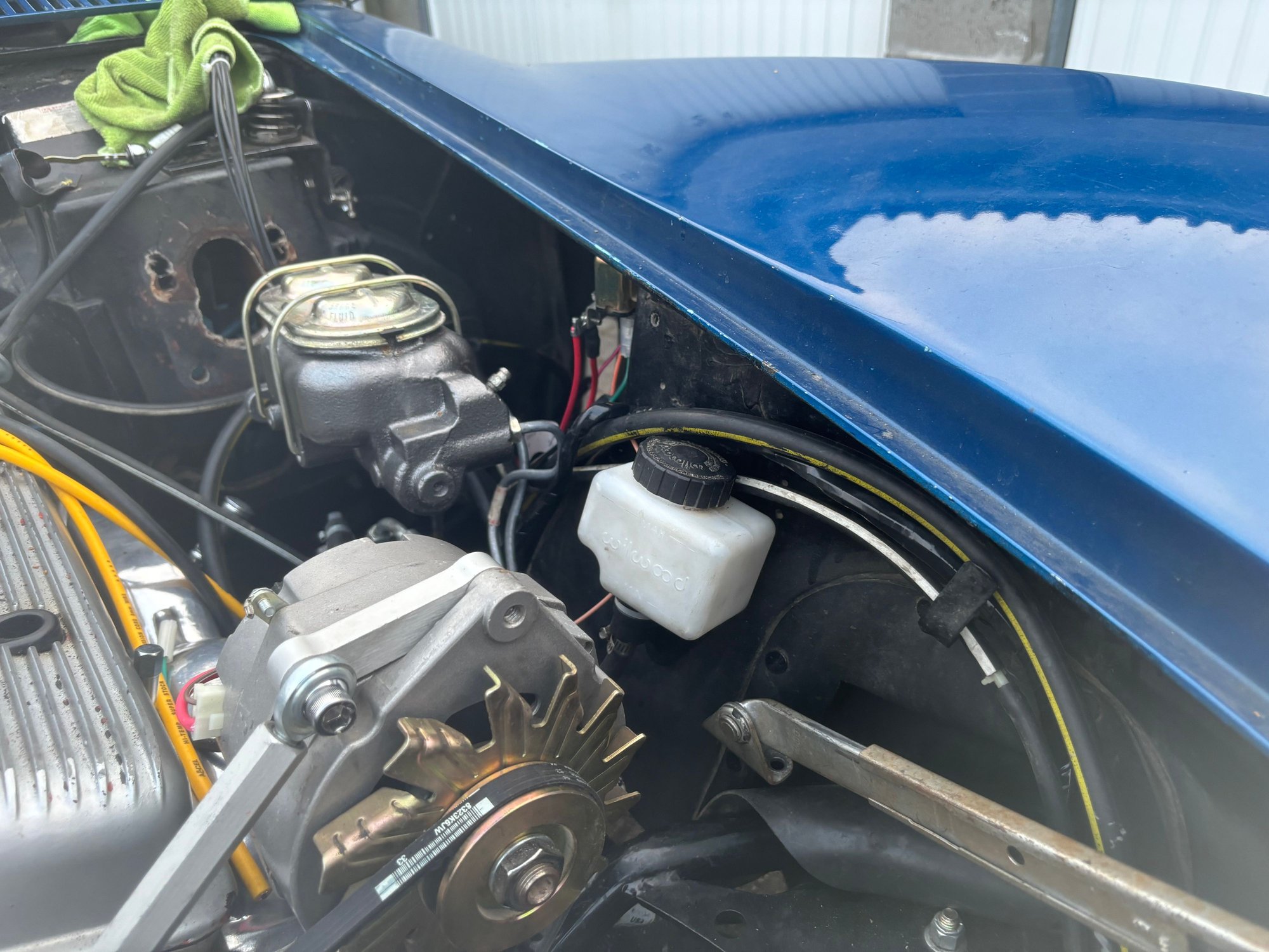

Moved the hydraulic clutch reservoir to a more accessible location. Before it was behind the brake booster and tremendously difficult to check and fill.

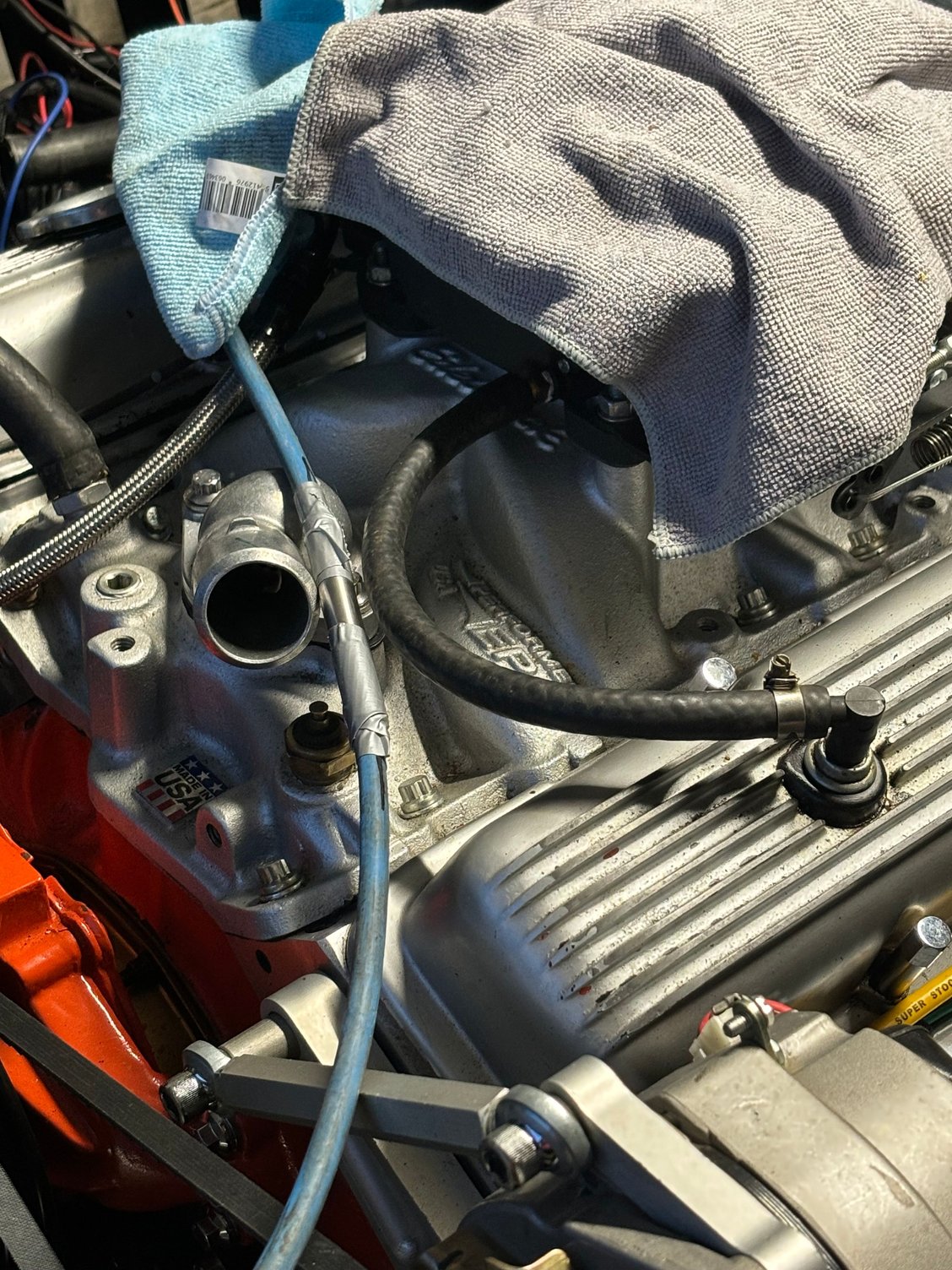

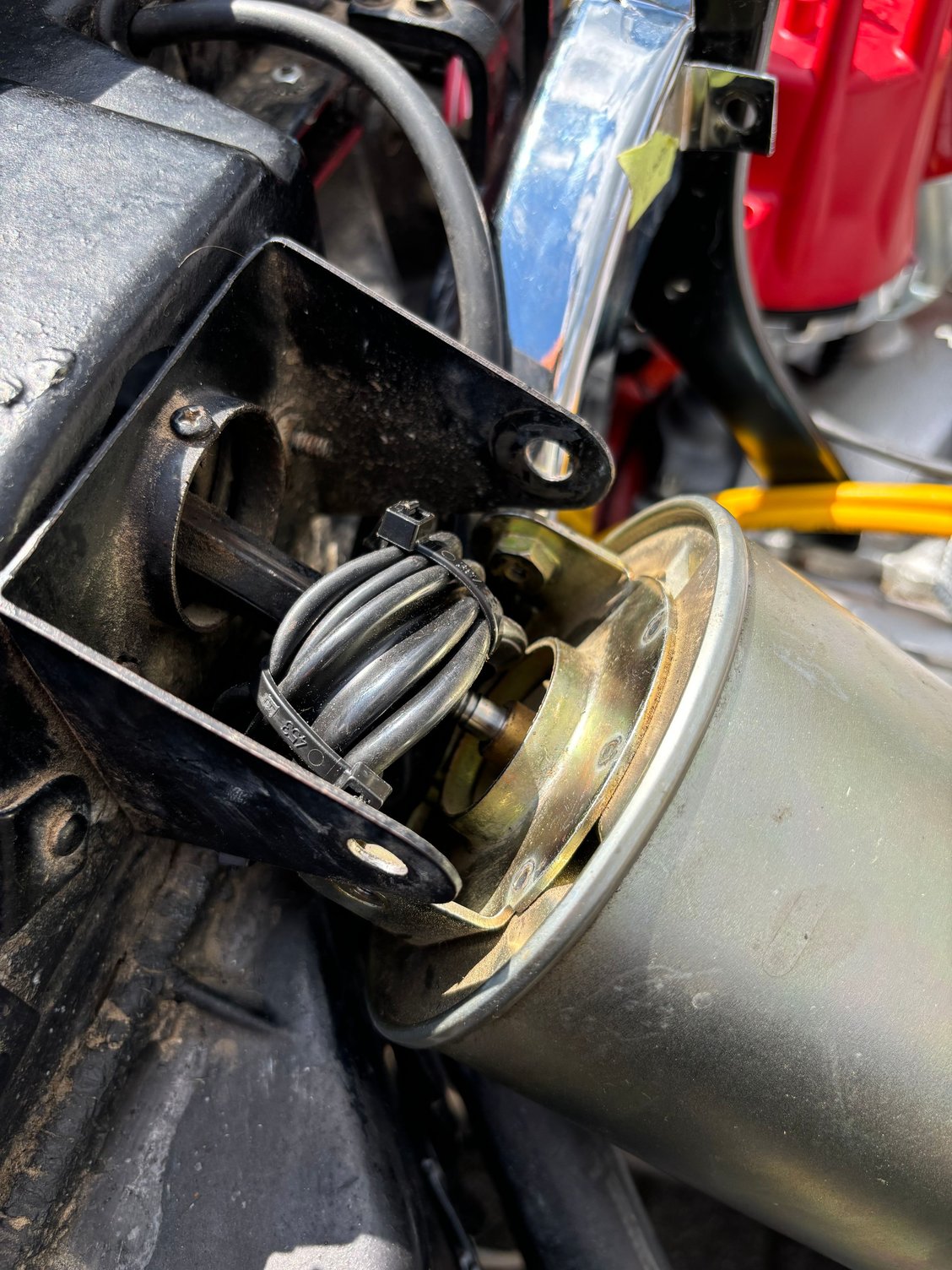

PCV reinstalled. Thankfully, I had an NPT hose barb that fit. And yes, you are seeing a repair to the speedo cable. I don’t know if this will work. I rolled over it while pushing the car back into the garage. A stupid mistake. It separated the sheath. I bought some steel tubing and after greasing, reassembled.

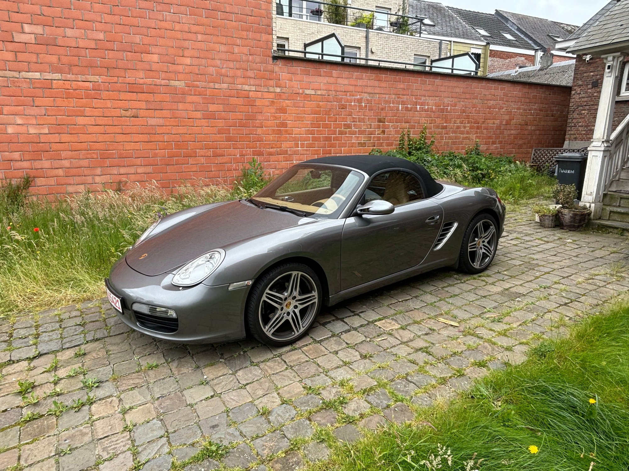

Not a corvette but…

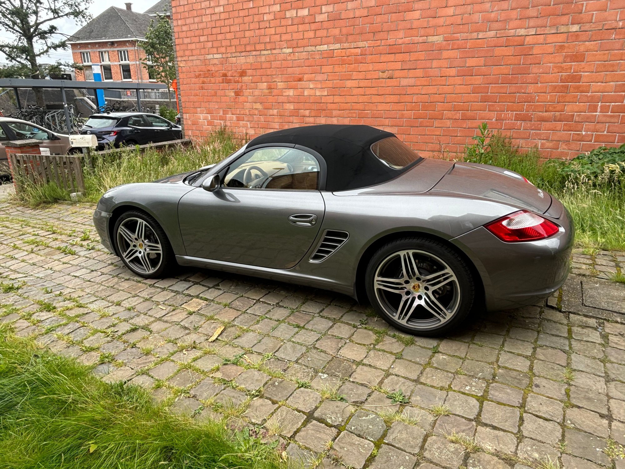

Welcome to your new home. A 2008, Porsche Boxster.
I had been looking at getting one of these for a few years now. An opportunity presented itself a couple of weeks ago and I took a train to Hannover and drove it back.
It looks quite clean and was well priced.
So, assessment: The 250-mile drive home as uneventful in a good way.
Once home, the radio stopped working (no longer could be turned on) after I disconnected the battery and put it on a trickle charge. So did the stability management system. Apparently to reset the latter, all you have to do is drive it a few miles. That being said the head unit is obsolete with only a CD player and a radio - no Bluetooth. So I’ll be replacing it anyway.
The bass speakers don’t work. I presume paper cones are torn.
The power lock works… but not the mechanical key. So, if the battery runs flat, I will be locked out unless this is soon fixed.
Other than that, the shifter (manual) seems to have a little too much slop to my taste.

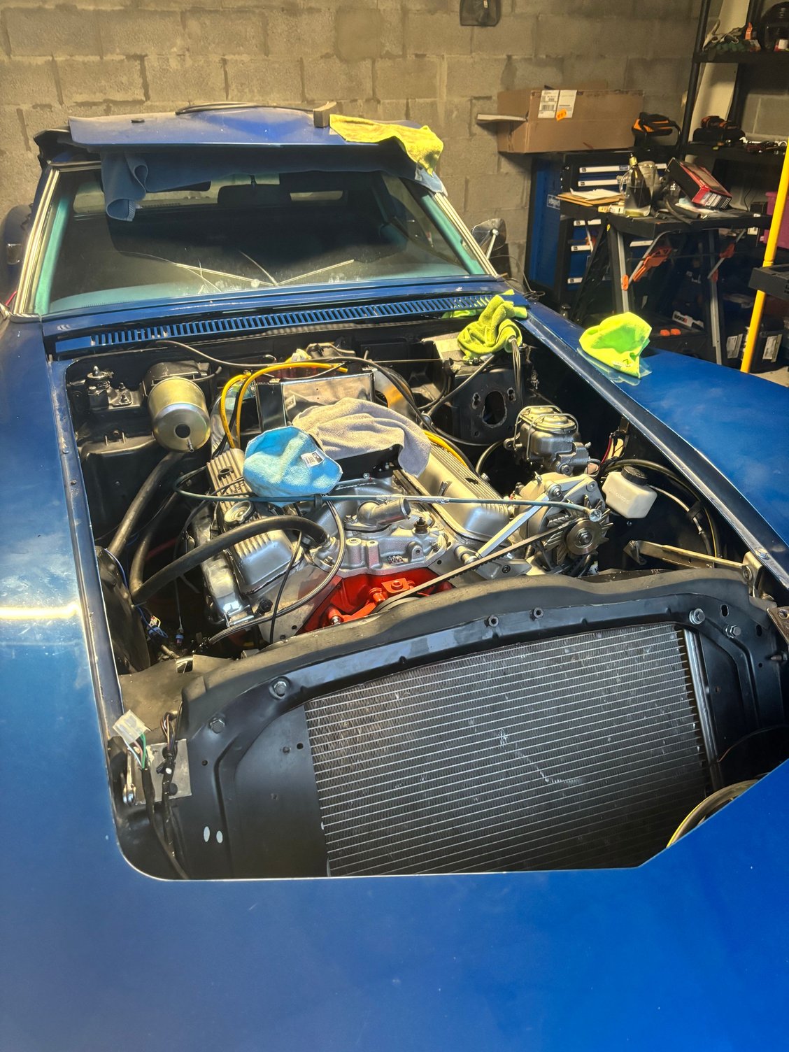

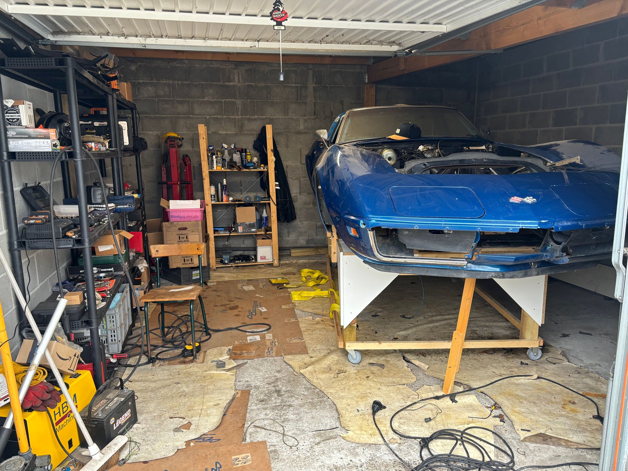

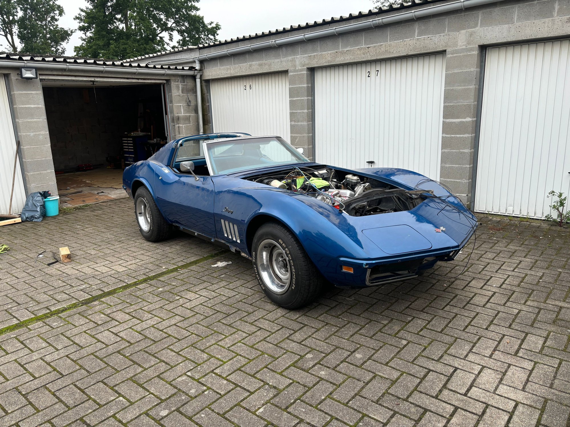

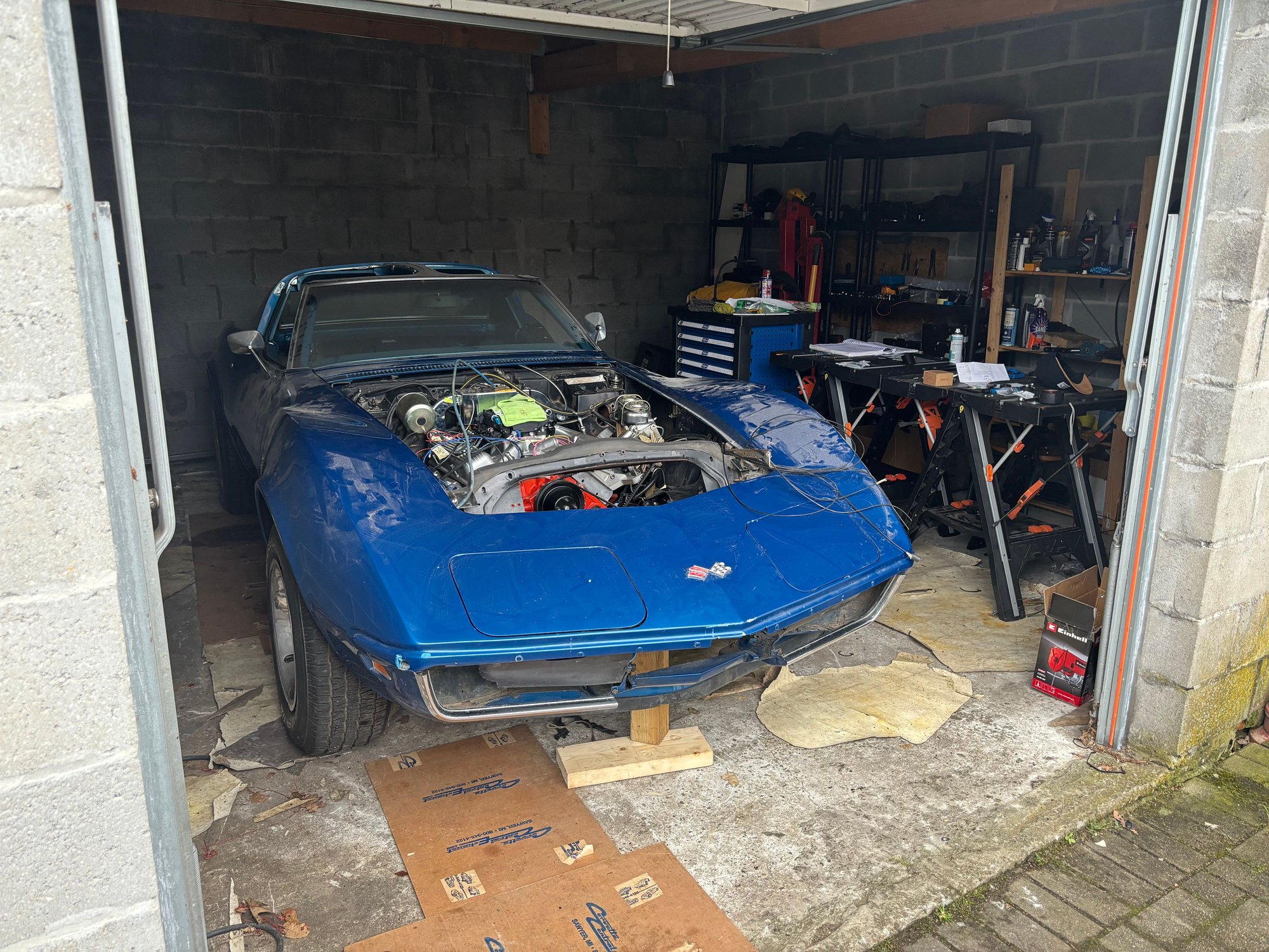

Had some time to work on the Corvette. I was planning to start the engine on Sunday, but some xxxx it the fan and I was not able to fire it up.
I did make some progress, however.

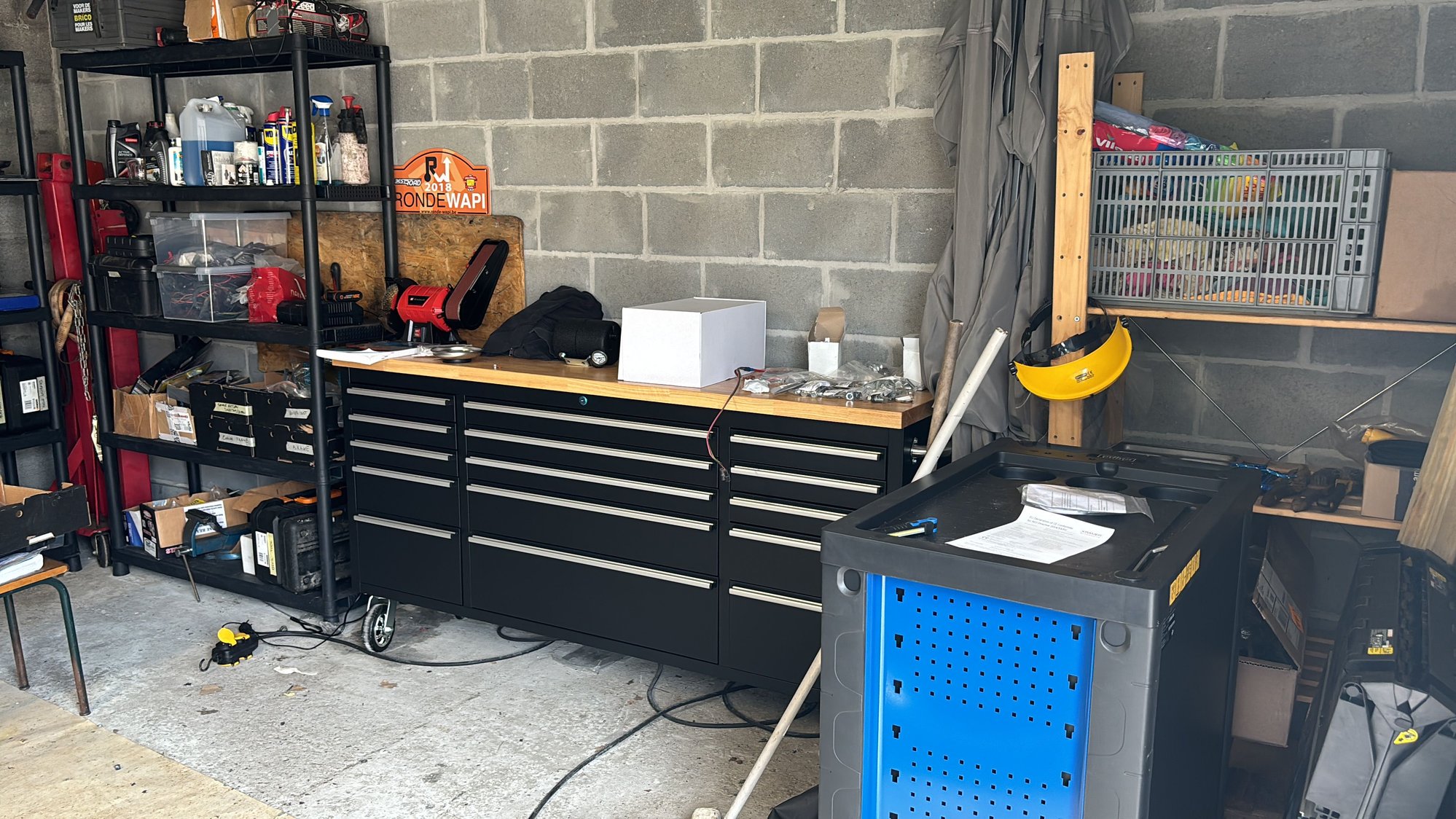

I acquired a new, empty, tool chest and work surface. Muuuuch more pleasant to work in my garage.

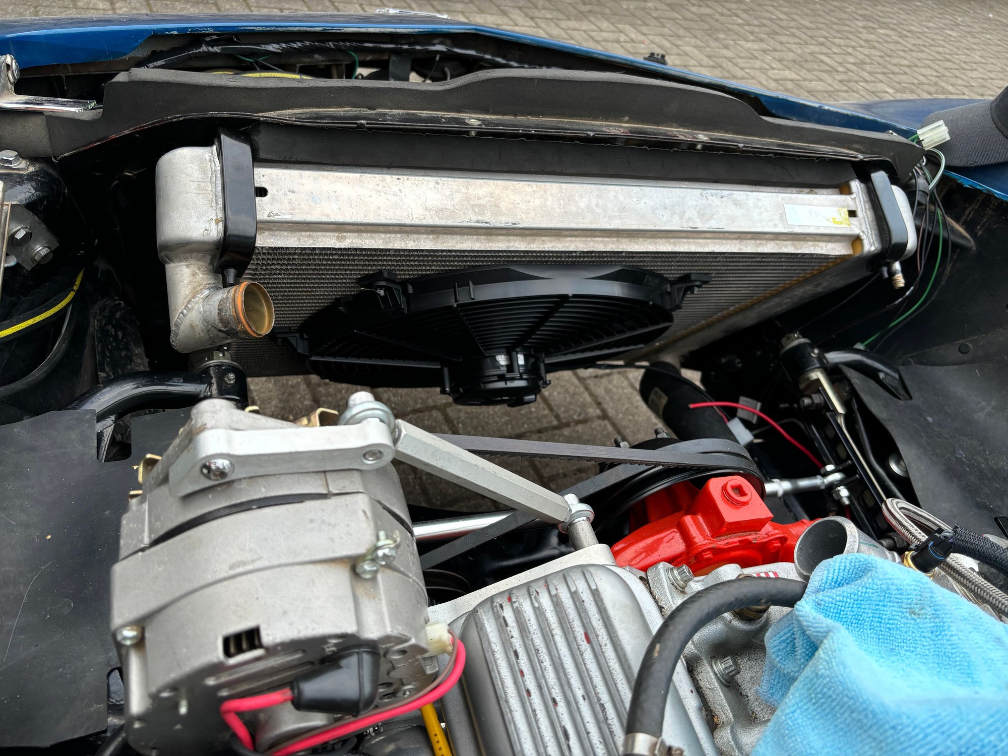

Seals around radiator are installed.
Fan installed. I expect it will be fine. I can’t imagine this will overheat - particularly in Belgium.
This makes things easier later on.

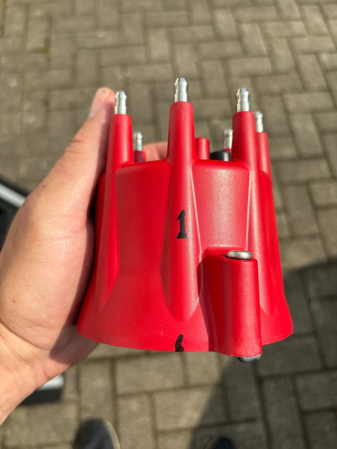

Fuse panel installed. Stacked on MSD.

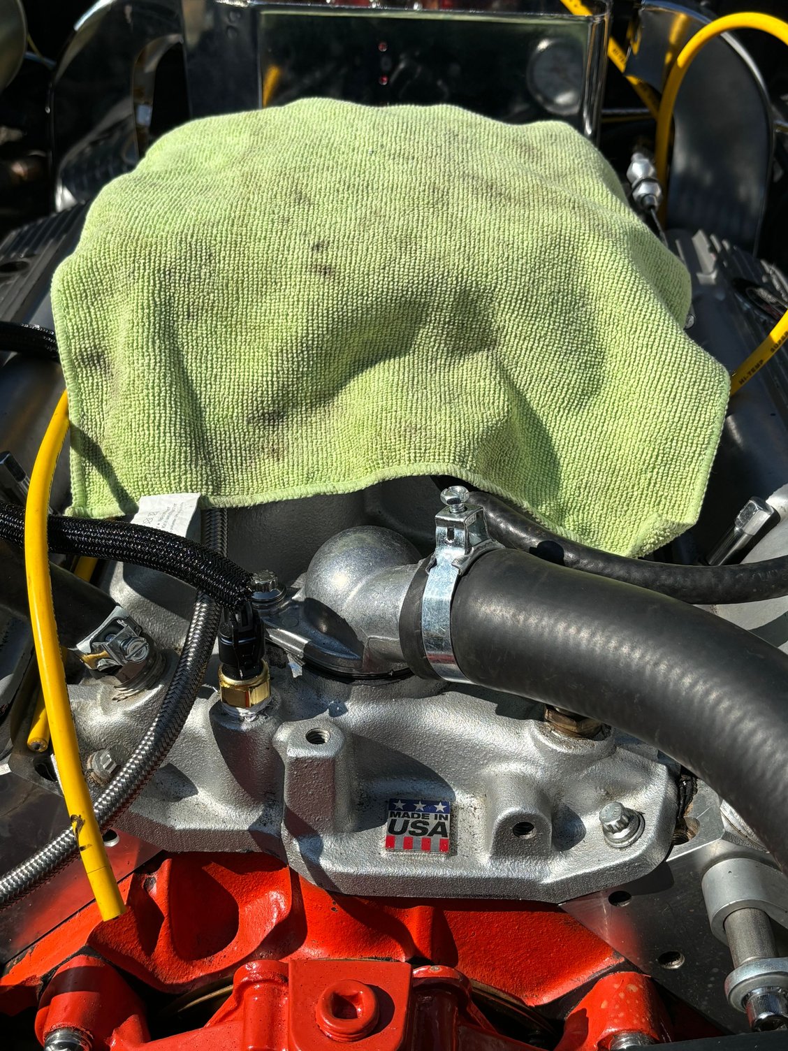

Vacuum tank came in.

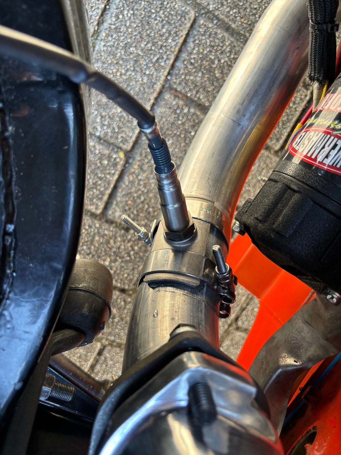

O2 sensor installed.

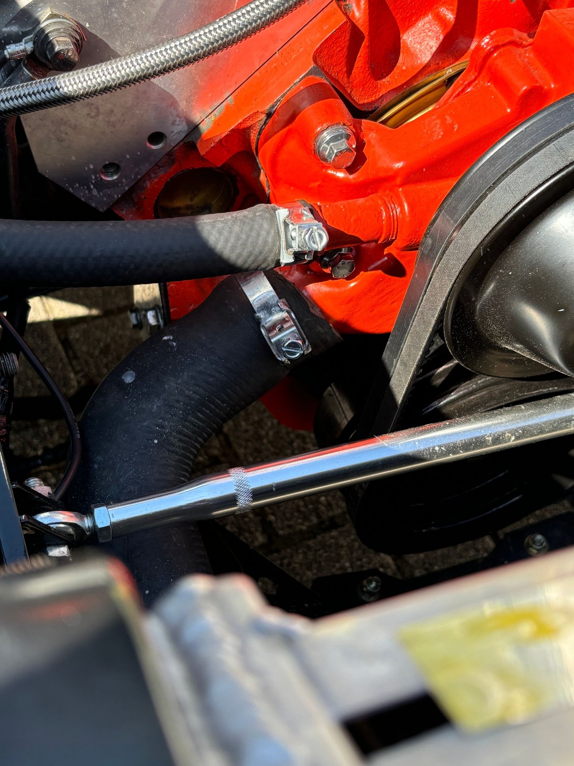

Retro hose clamps installed.
Ditto

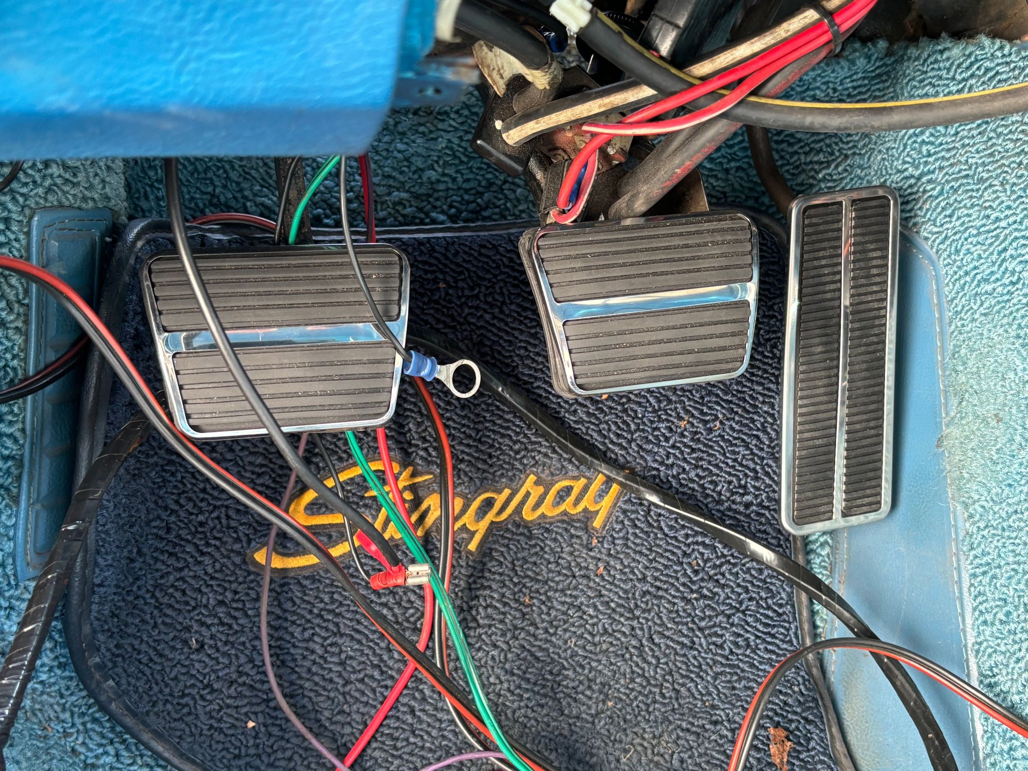

New pads for pedals. Not convinced about the chrome trim.

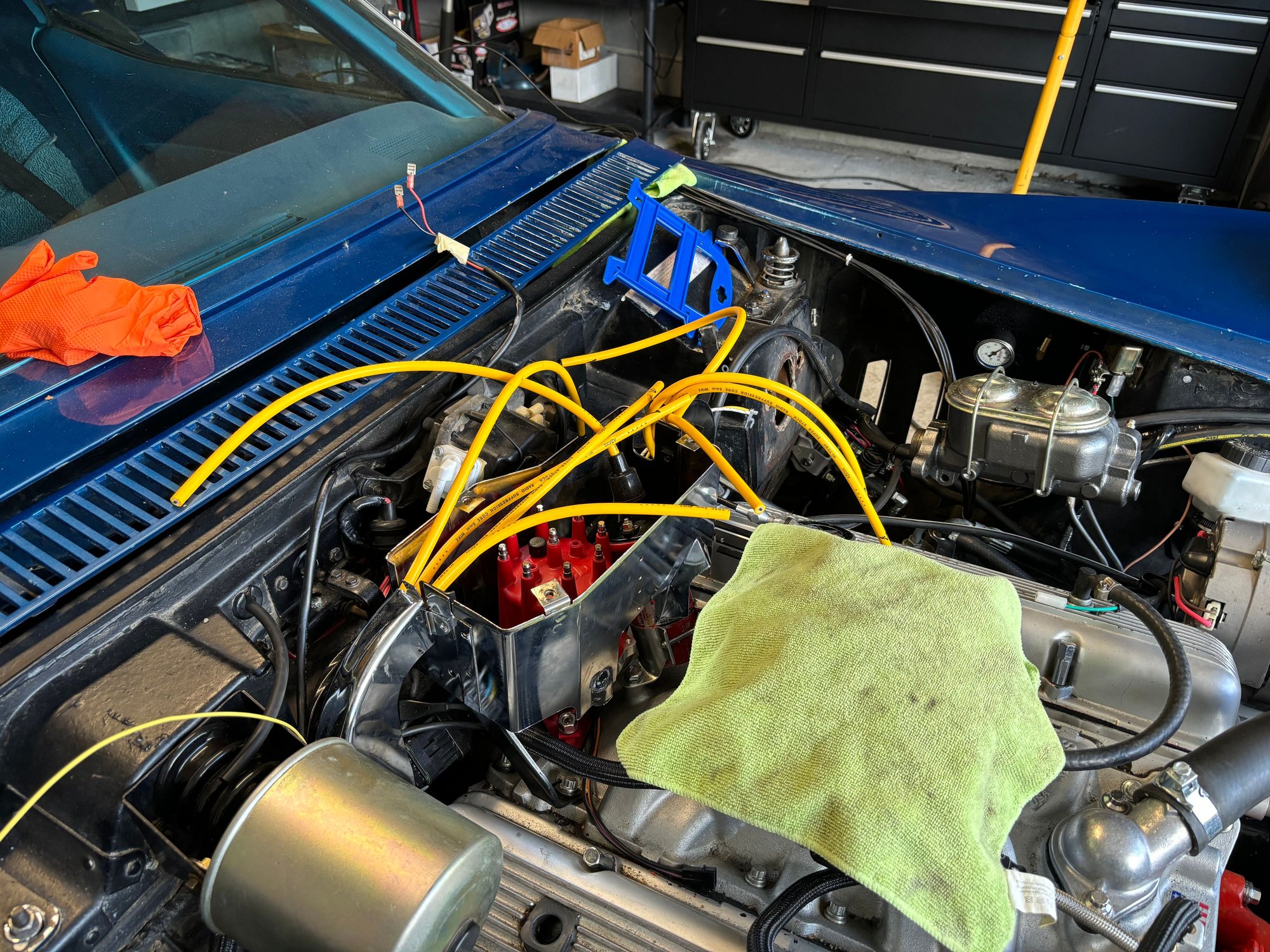

Customs fitting spark plug wires.
