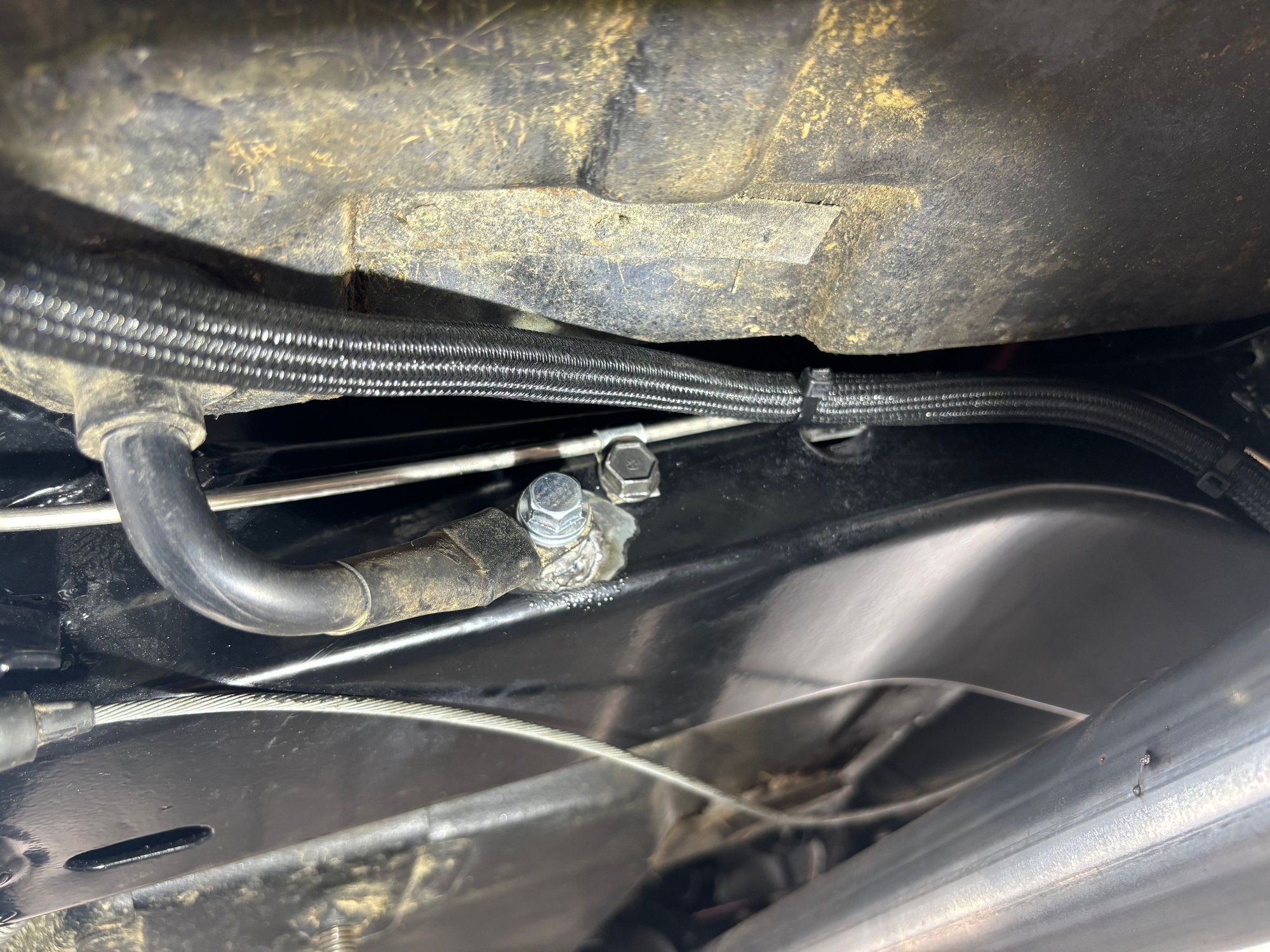

The convertible top transmission gear on the Boxster failed. Took me a few hours to fix that. $150 instead of $1,500 And I upgraded to a brass gear.

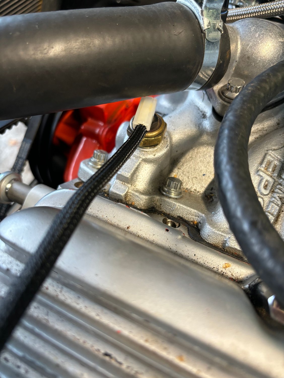

Thanks to a tip from this forum, a much better connection for temp sender
Very tidy
Labeling the wires
Beefy connectors for fan.

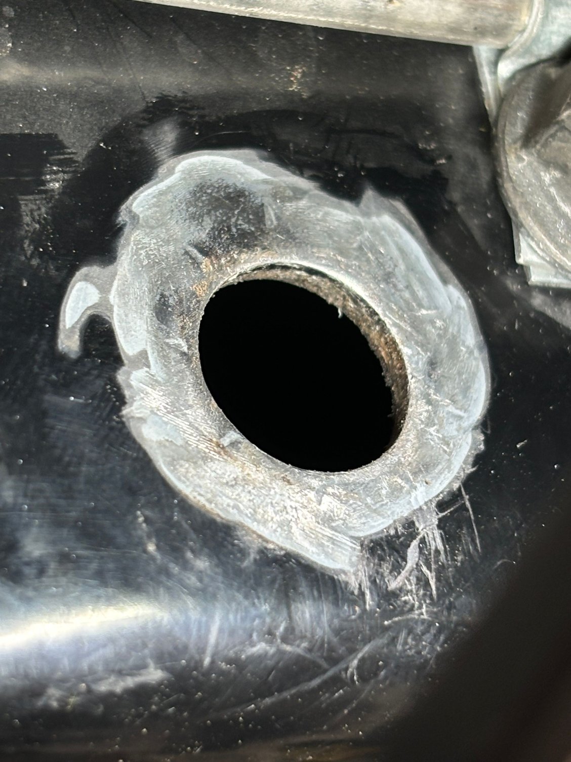

Mini grinders are super helpful.
Clear off the powder coating.
A few tests
Crawl under the car and here goes noting.
Welded a nut onto the frame.
I’m happy with this. Now I’m at needs a lick of paint

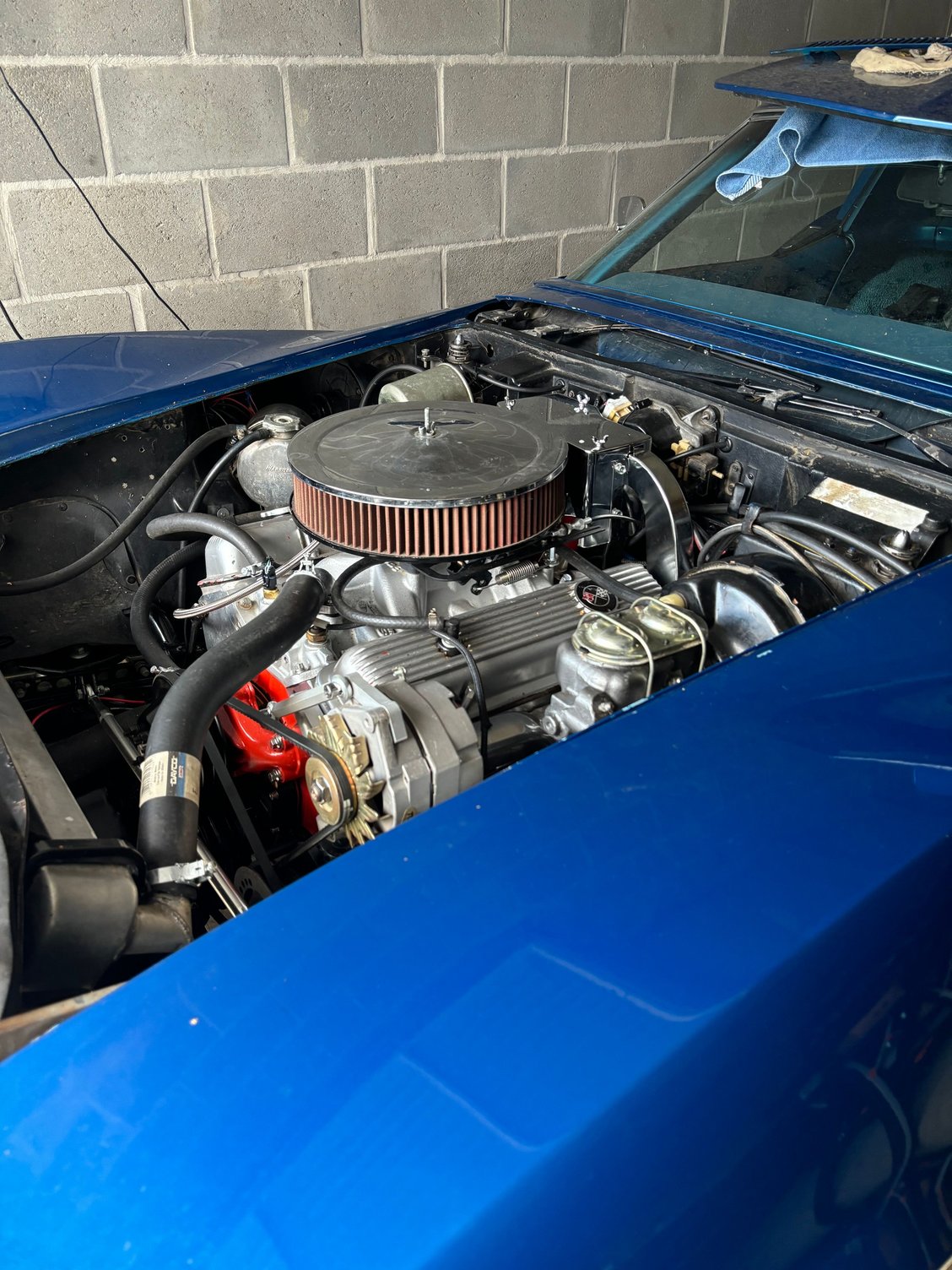

And the milestone was, firing up the engine for the first time in about a year.
Lone wolf 3000, timing light and handheld for the Holley Sniper
Running !!!! Always an awesome feeling.

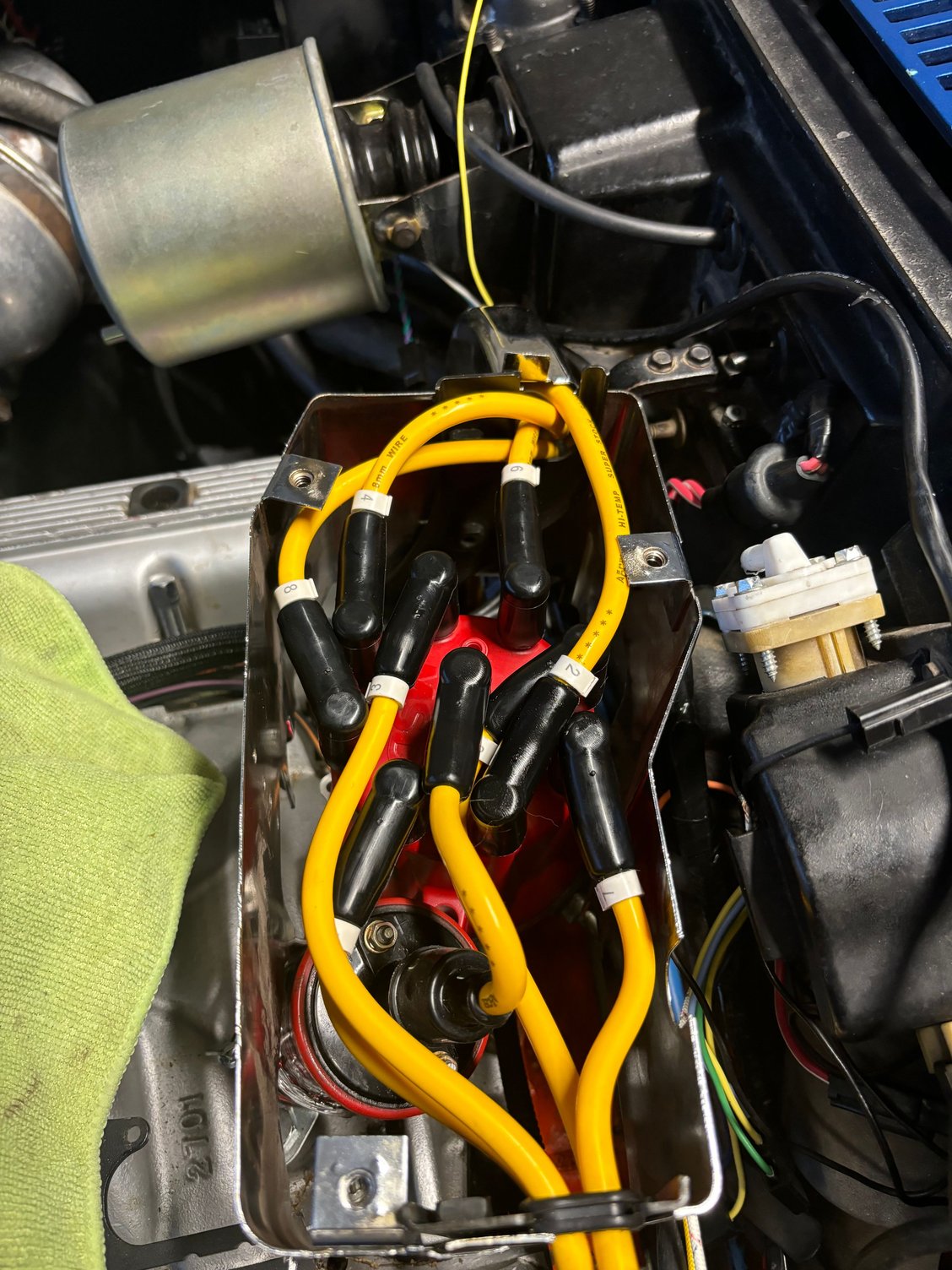

Looking good. Failure of tach. I think the bends were too tight (due to ignition shielding) for the cable. Need to verify it truly is broken.
So far so good.

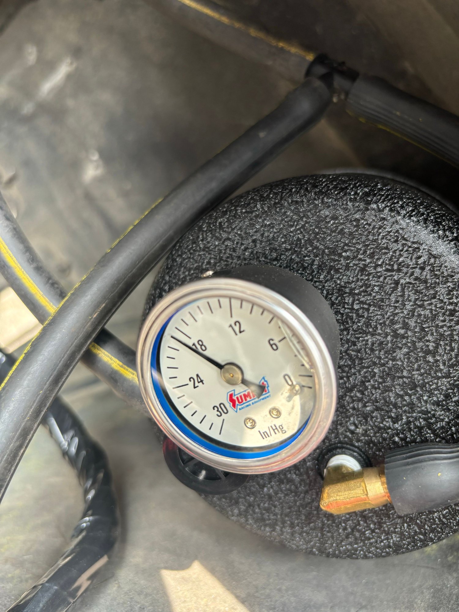

Very pleased with this. Can always see the vacuum. And, if plumbed into headlights and. Wiper door, the vacuum fades quickly. This will be super helpful to locate the leaks
Capping headlights and wiper door, the vacuurm rises by four inches. Hmmmm.
Pushing the car back into the garage led to a major F-up. As my mechanic buddy once said… that’s a mistake you’ll never make again.

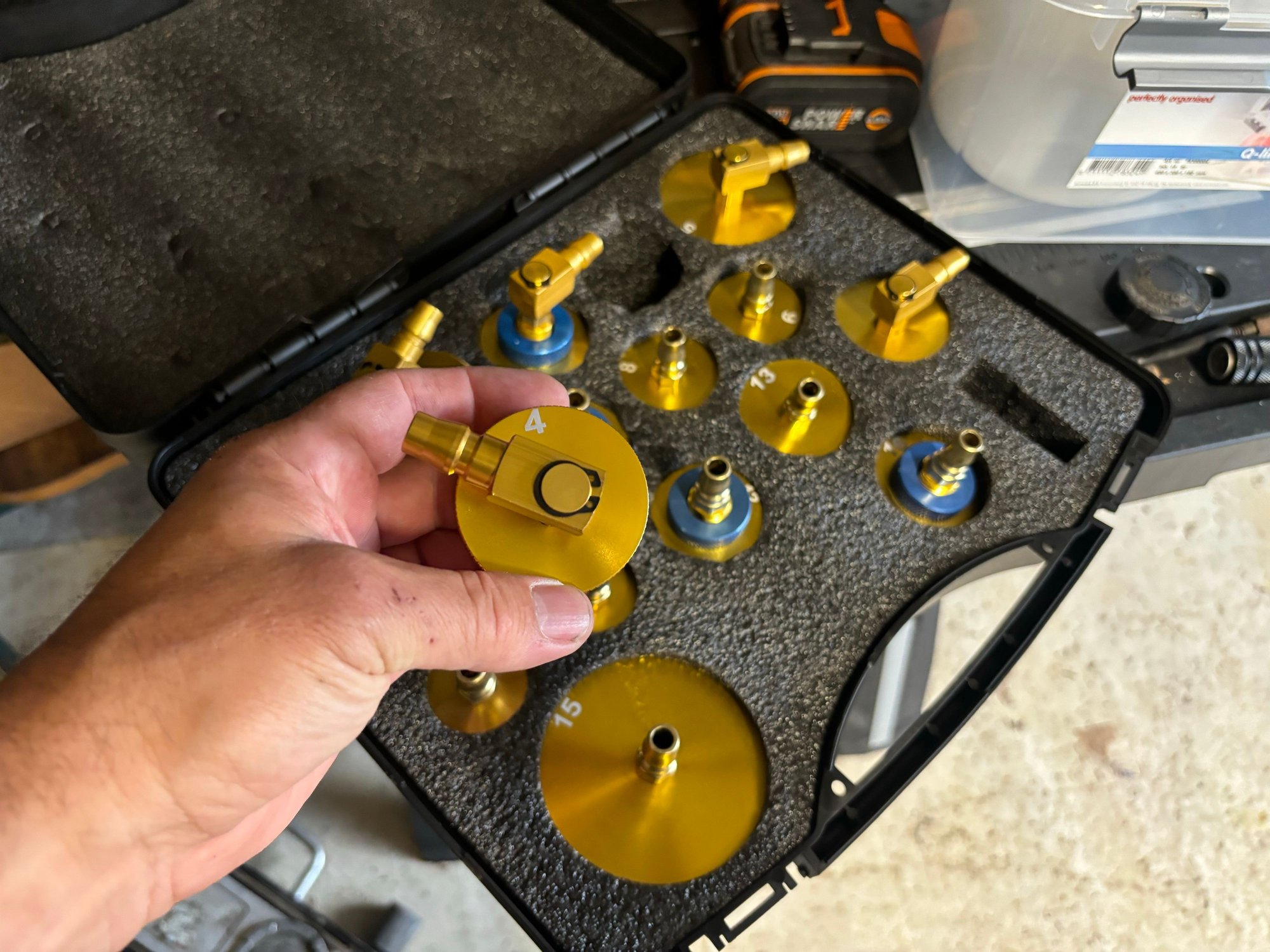

Hmm. I was looking all over for this. Turns out, it was sitting on a trailing arm

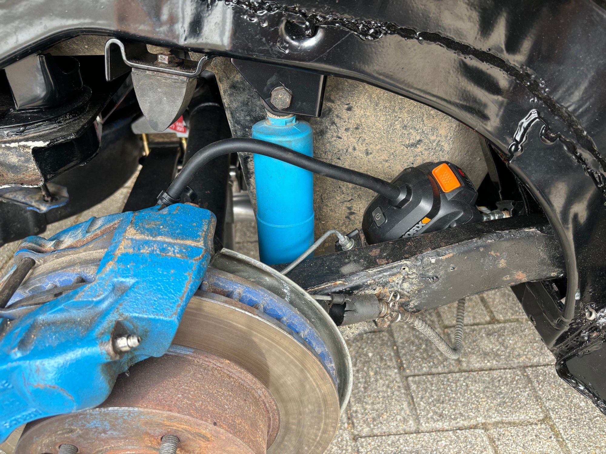

Booster installed.
This tool is absolutely worth every penny. Bleed your brakes perfectly… alone !!!

I bought this set for $140
But I’m betting this will be a huge timesaver bleeding the clutch. Worth it if it does !

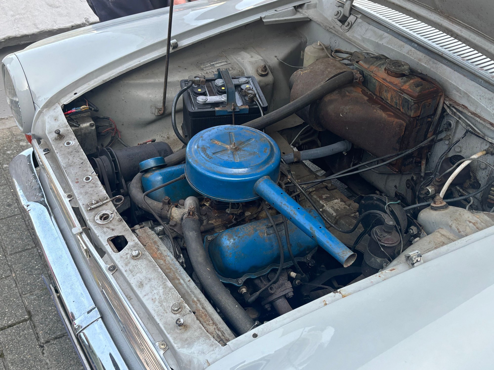

Karmann Ghia. I miss it so. I used to have one.
Well this is Belgium.
One seat to gas tanks

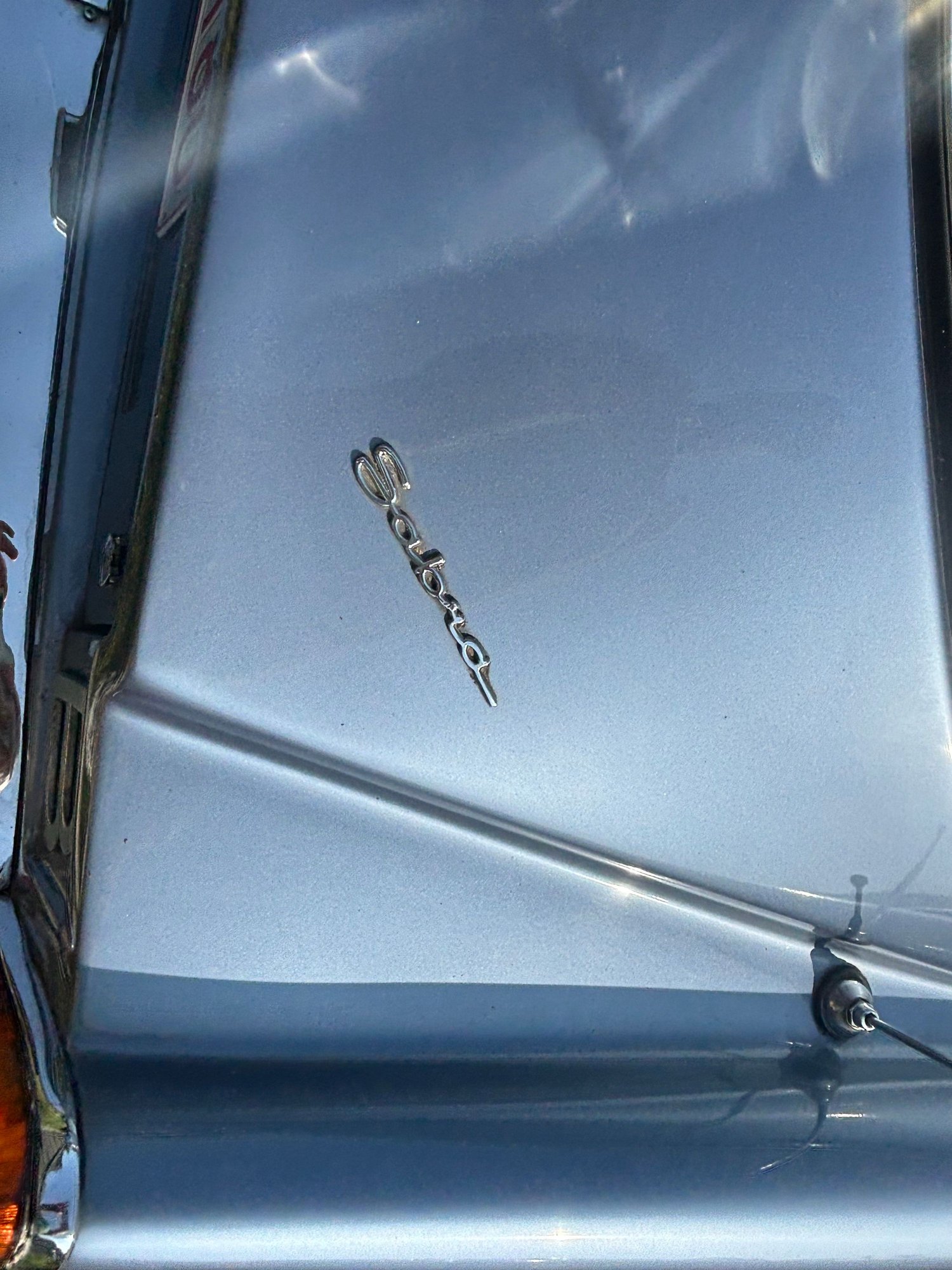

This is a Sabra. Several of them there. Never heard of them before. Reminded me of a Ferrari. Turns out it’s made in Israel with Brit parts.

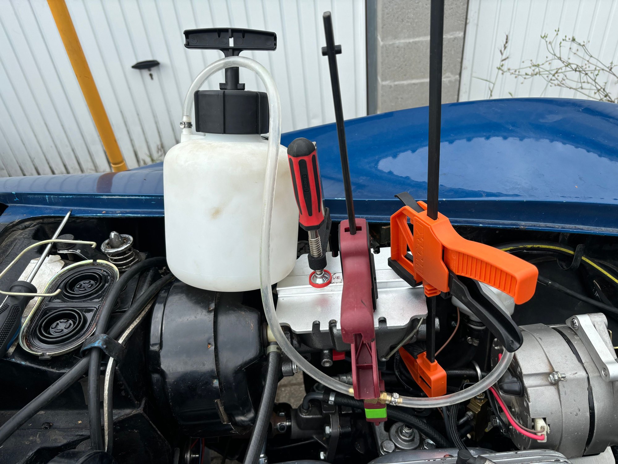

Great tool. BTW, keep an eye on the reservoir. As well as this works, the remote reservoir can blow off spewing brake fluid all over the place. Ask me how I know.
Bleeding clutch.
