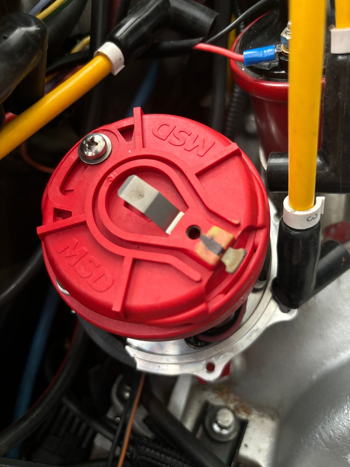

Drilled a hole in a spare distributor cap to make sure phasing was good. It needed a minor tweak.

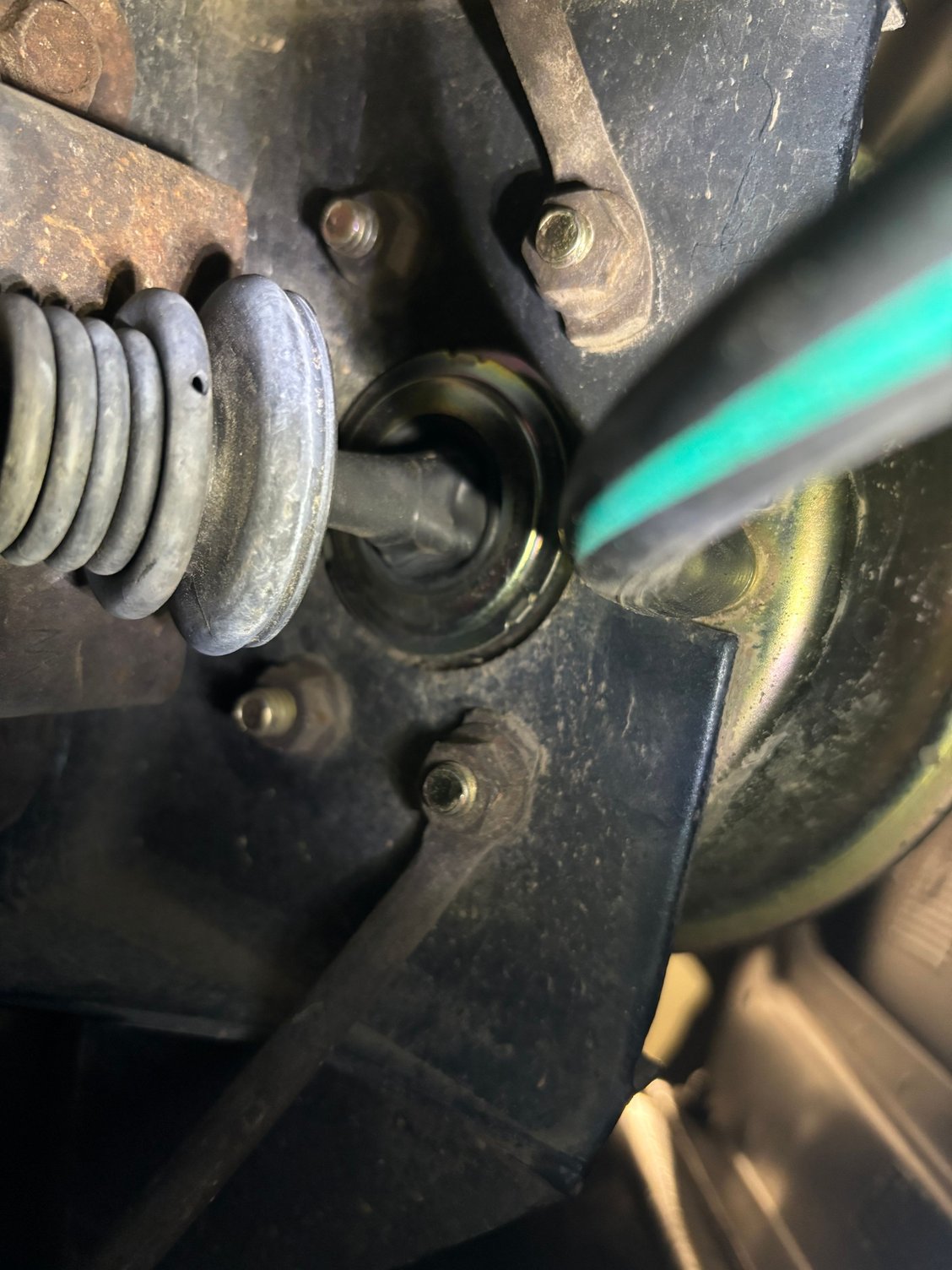

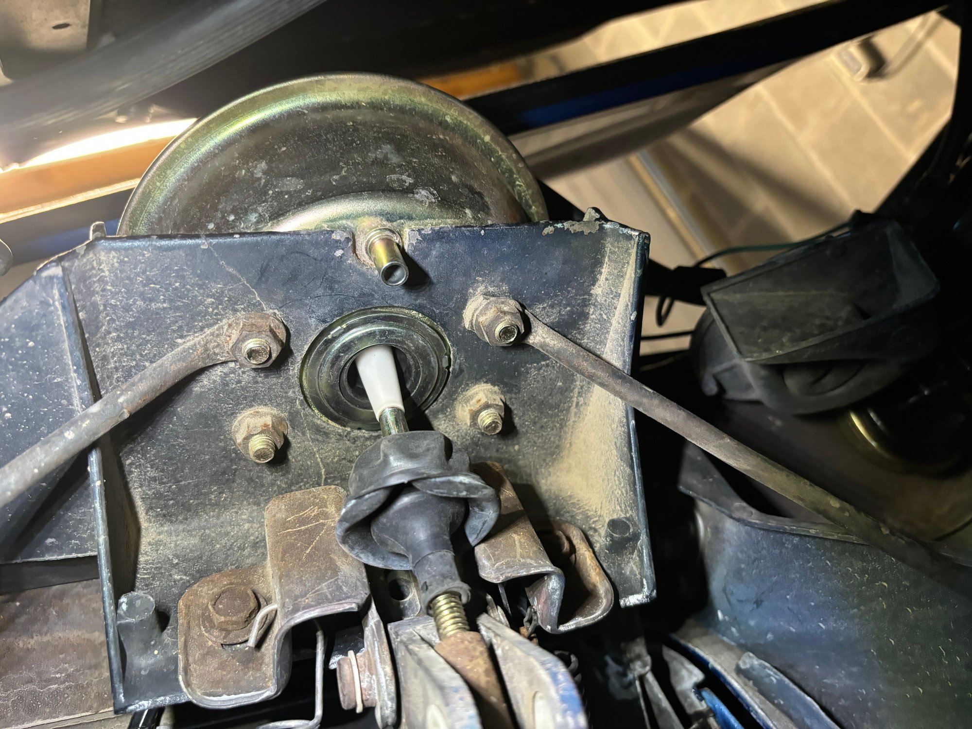

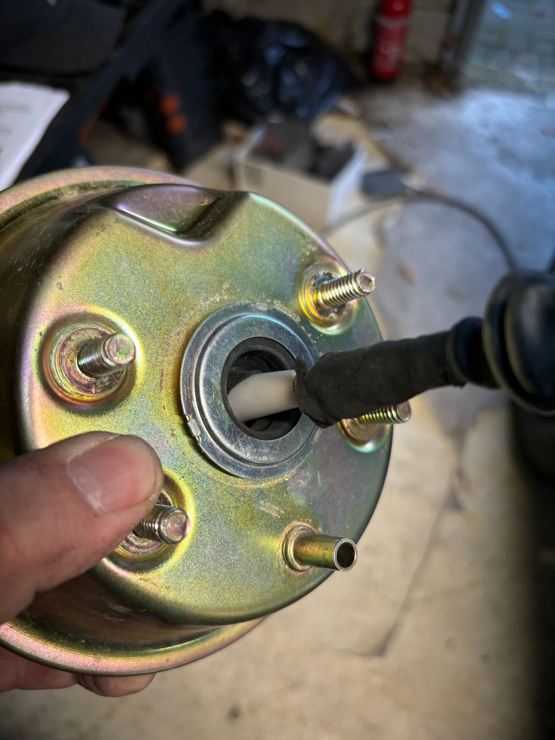

And an interesting failure.
I was having issues with my wiper door and headlights.
One issue was the check valve. I ordered a new one and… it did not work out of the box.
Then under the dust boots…
I think the problem is clear.

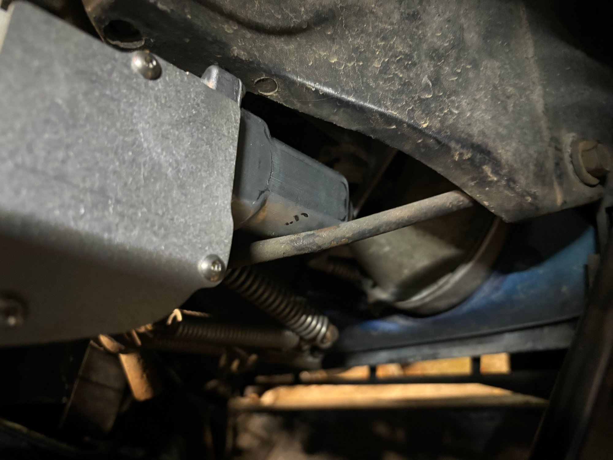

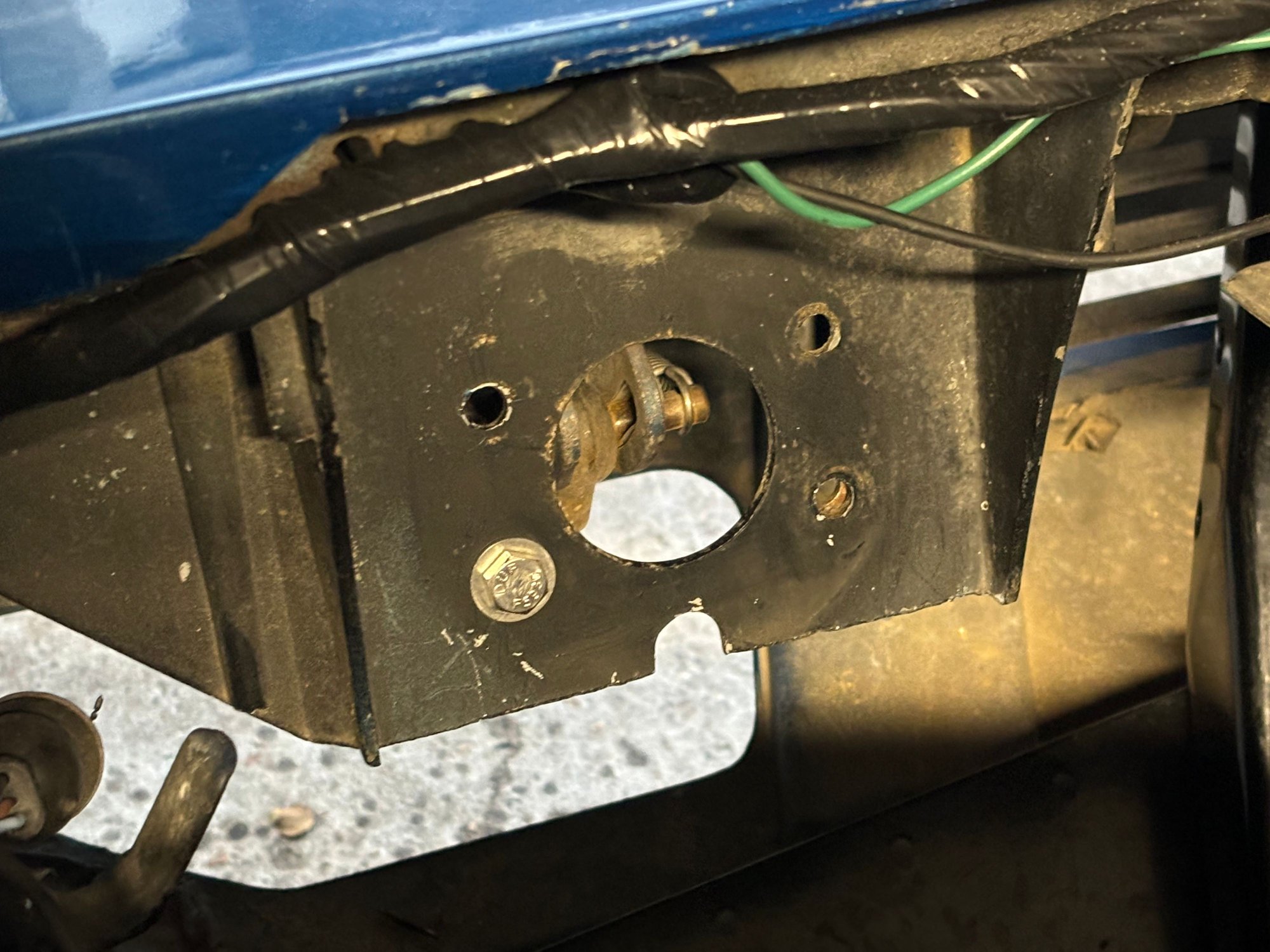

So, we are modifying again… with a fantastic kit created by @Richard454 The attention to detail is impressive.
Really nice instructions.   I decided to go for the headlights and wiper door conversion.

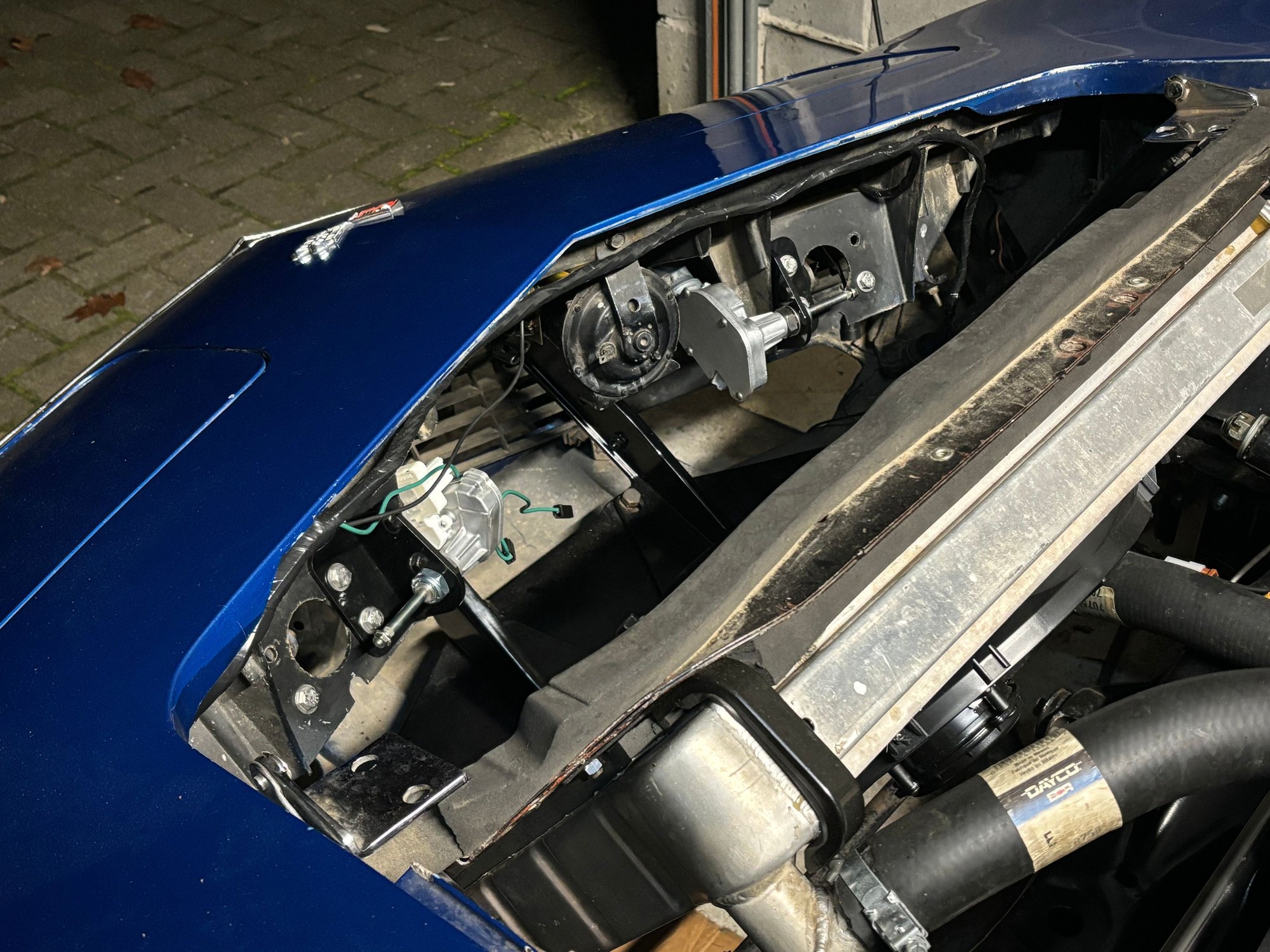

Step one… yank these out.
And here is the failed seal.
Ready to accept the motor.

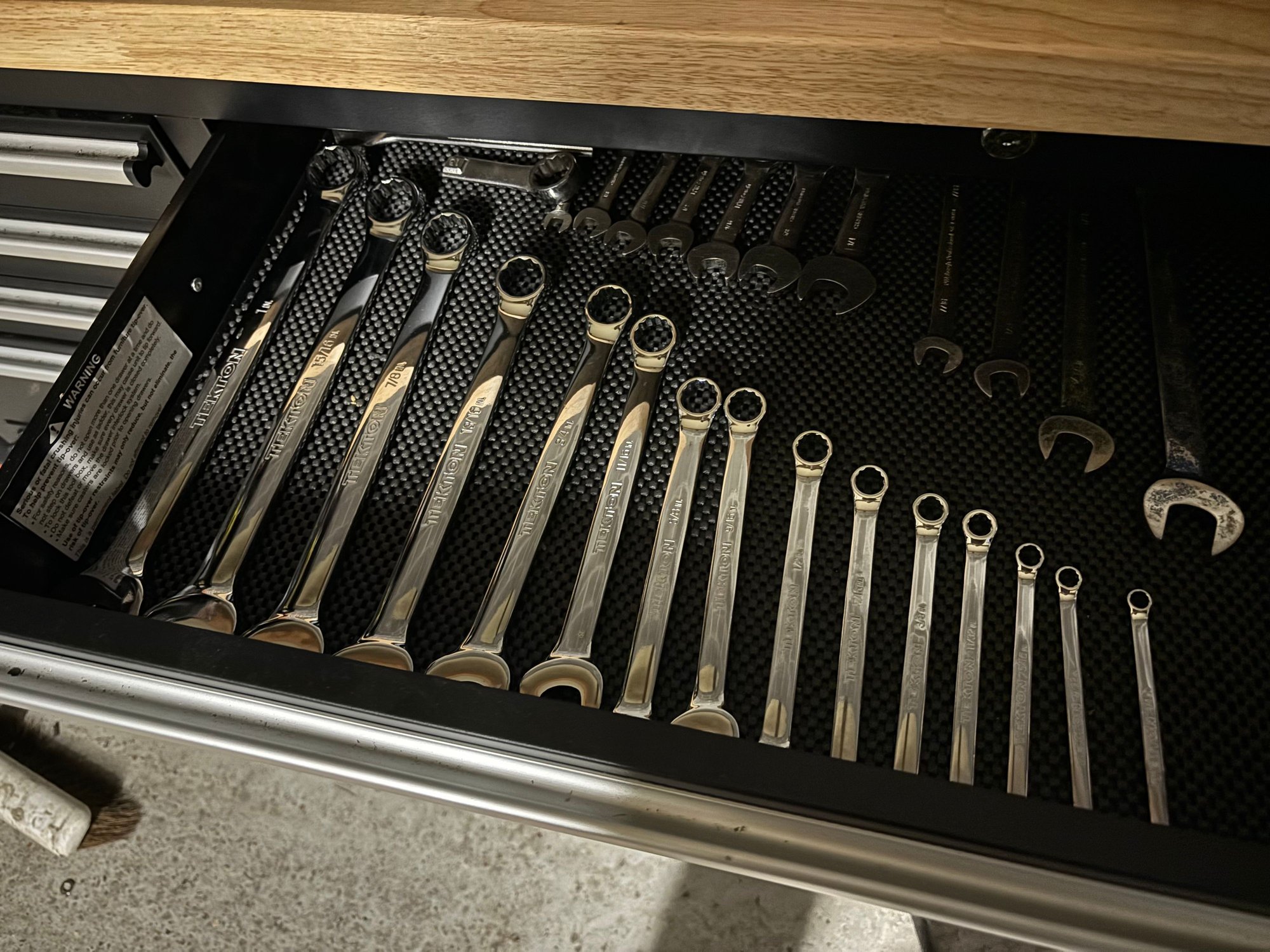

Aside - got myself a new set of wrenches a while back.  This is the first time I use them.  So very pleasant.  My 20-year-old Craftsman set was getting a little ratty.
And of course if you give a guy a shiny new 5/8 wrench, he’s going to go all gorilla-mode and snap off the… whatever this thing is called.
Also a new buy.  Really pleased with this too.

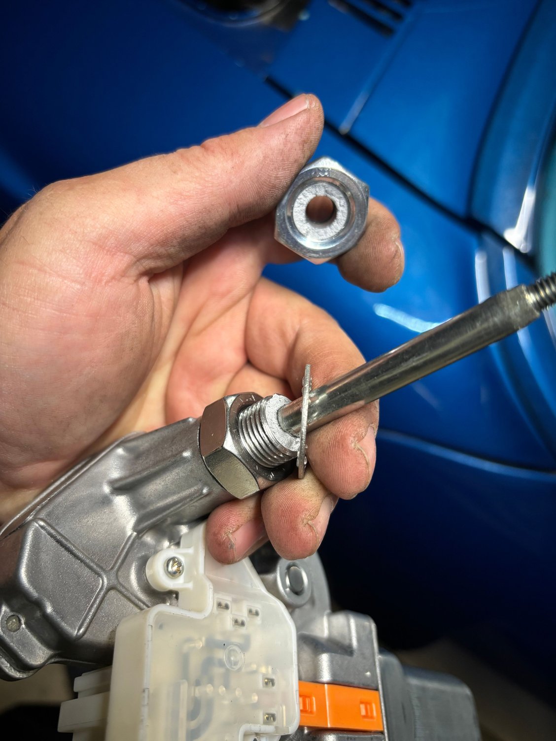

Instructions call for a slight bend if required of a support rod on the driver’s side.  I marked the area with a sharpie and gave it a slight bend… and was very surprised that I was spot on.  It clears the motor beautifully.
Motors installed.  The rest is for another day.  It’s getting late.
Motors installed. The rest is for another day. It’s getting late. It’s always best to quit while things are going well.

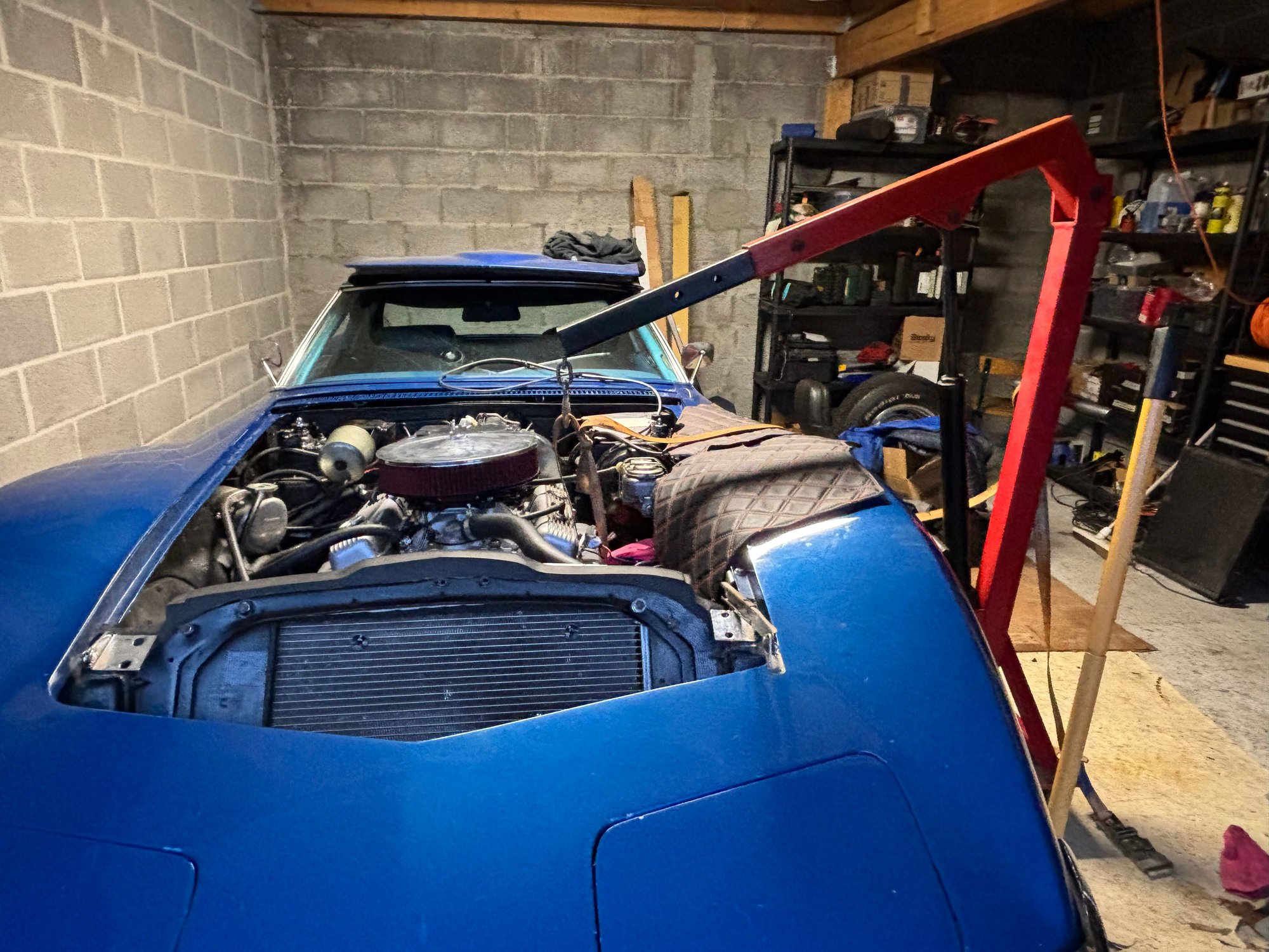

Hood removal is not required but I highly recommend it. It such an easy thing to do - why wouldn’t you? These hoods are so light. I mean the hood on my Chevelle was not a one man job… this I’m quite sure I did it alone anyway. I was much younger then.

There seems to be undue vibration transmitted to the driver - me Possibly due to the solid mount.
Since the hood is off, while I’m at it, (famous last words) might as well replace the solid mount with a rubber sandwich.

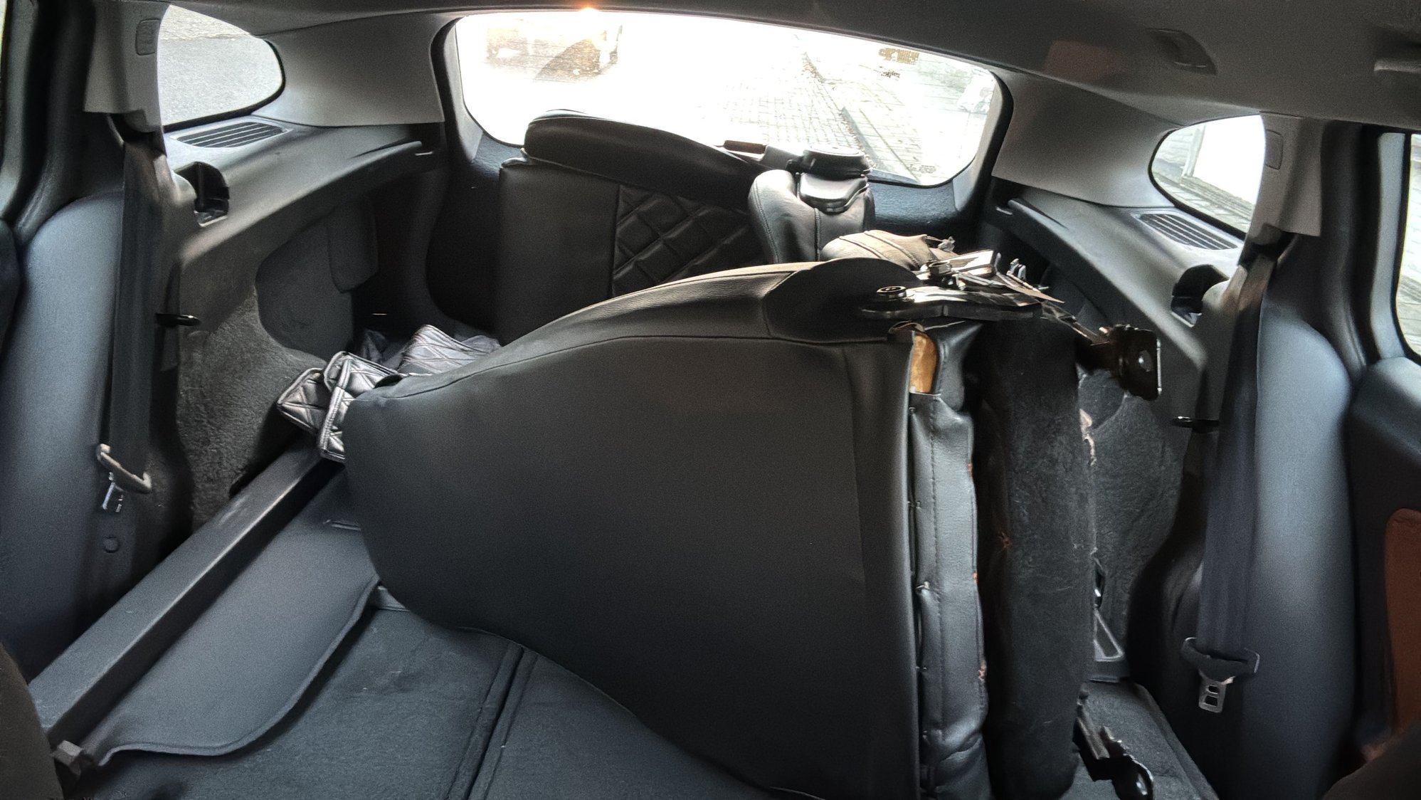

Was it an impulse buy ? I don’t know. I have several projects running. The car is almost down for the season….
To do:
  • replace the PS pump. It's giving inconsistent pressure and leaking from, I think, the cap
  • Replace the solid motor mount with one that has rubber
  • complete the electric pop up headlight conversion
  • Install the rocker molding

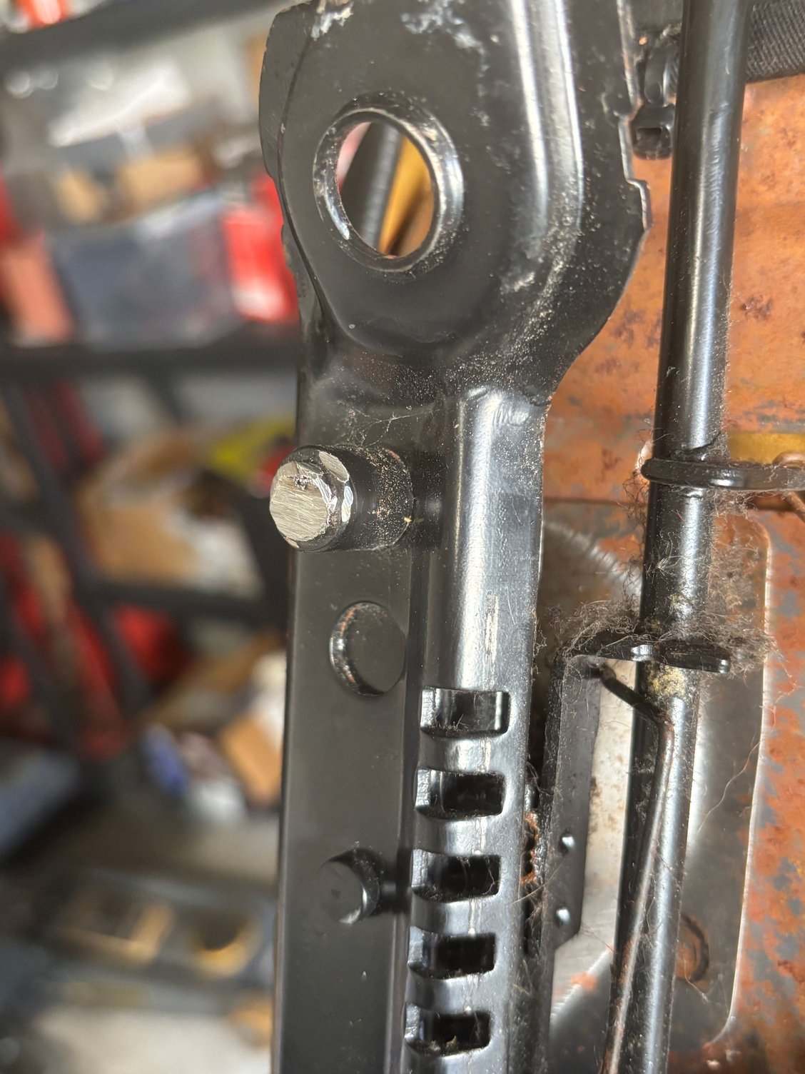

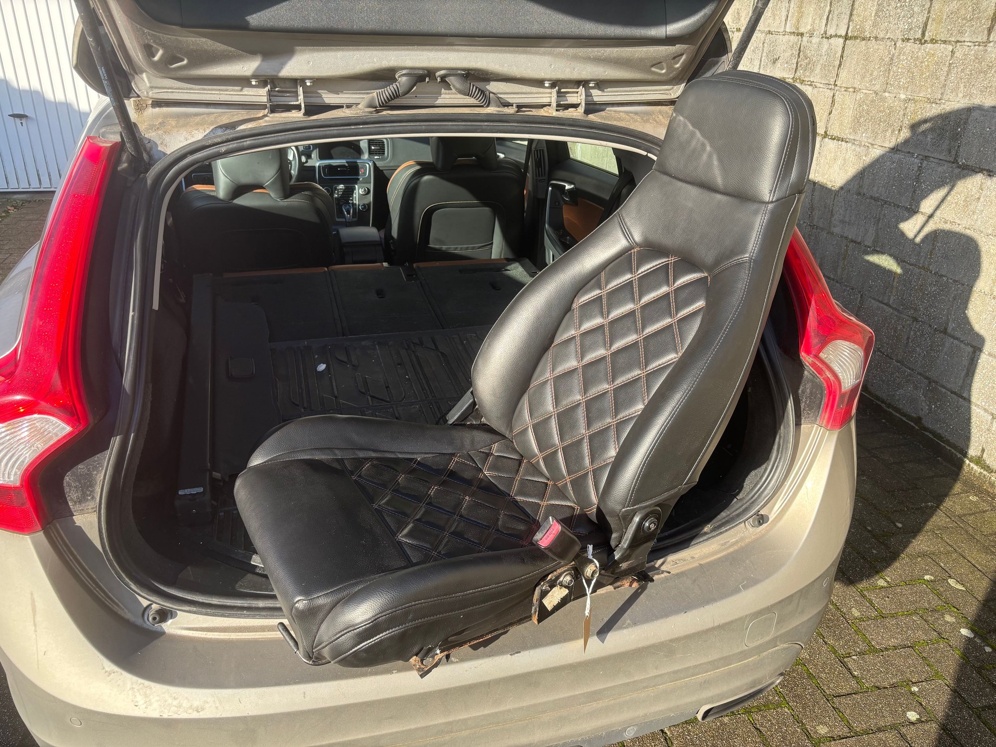

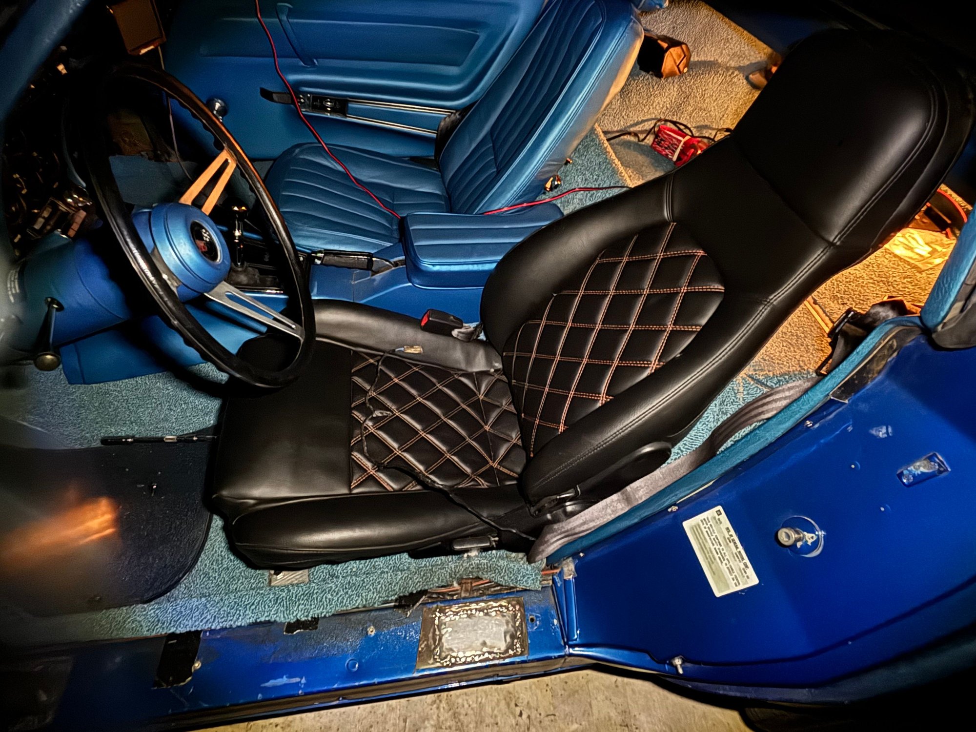

For some reason I started looking into replacing the seats. The Fiero conversion is out of the question here as, well… there are no Fieros here.
A little research suggested that first gen Miata (MX-5 here) seats work well. I found some online and, what the hell, I drove over to the Netherlands and picked up a pair in reasonable condition.
I left at 0600 so I would have a bit of my day left after the four hour round trip.
Score.
Score.
Classic Netherlands
Classic Netherlands
On my way home.
On my way home.
Clearly not original trim
I was surprised to find speakers in the head rest !!! I wonder if this system is any good ?

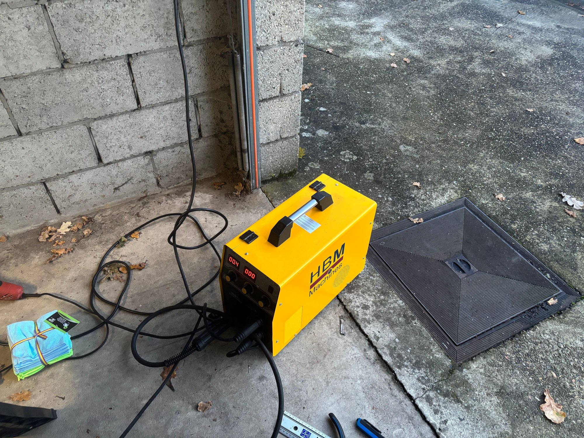

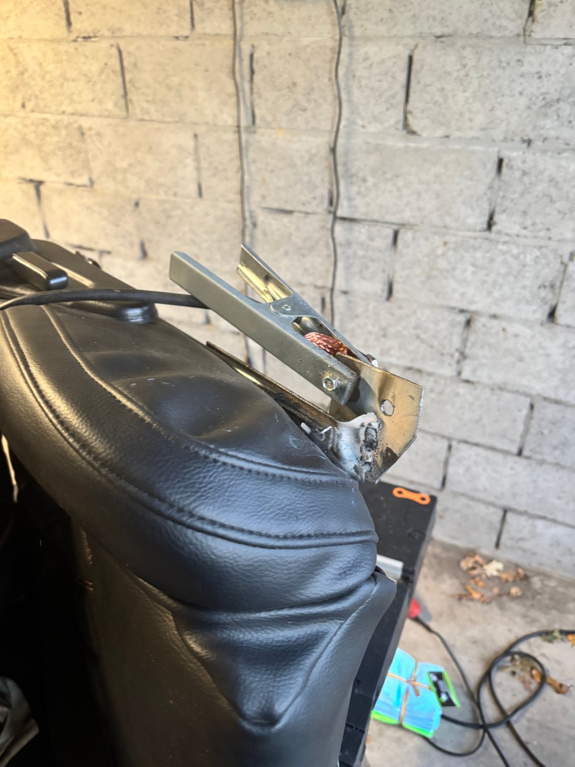

I set immediately to work.

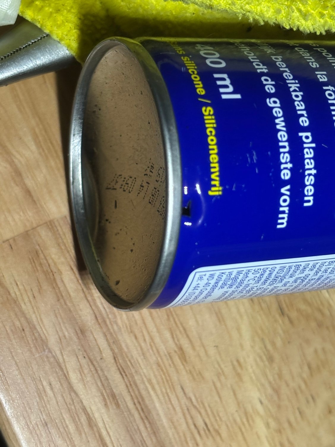

Oooof course as I tried to fab a bracket, when drilling, it shot out and punctured a can of WD-40. It got everywhere

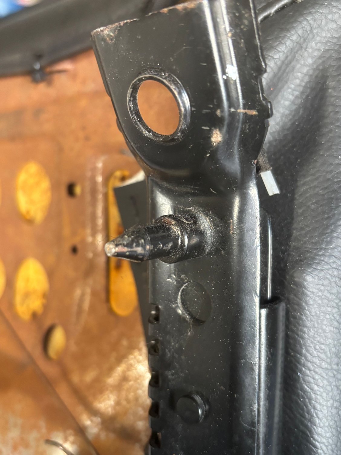

Next step…. Measure, measure, measure before welding. Greatest skill I ever picked up. Learning to weld.
Useful locating spike
Cut it off and use to locate the bracket’s height. Simply fill with wire.
Not too pretty but I’m sure I’ll need to trim anyway.
Bzzzt
Bzzzt
Bzzzt
Bzzzt
Fits !!!
Fits !!!
Too late to test.  Maybe Saturday?
Yes the cover is uuuuugly

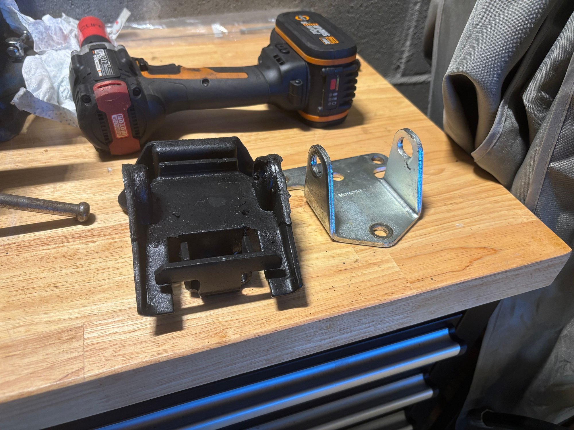

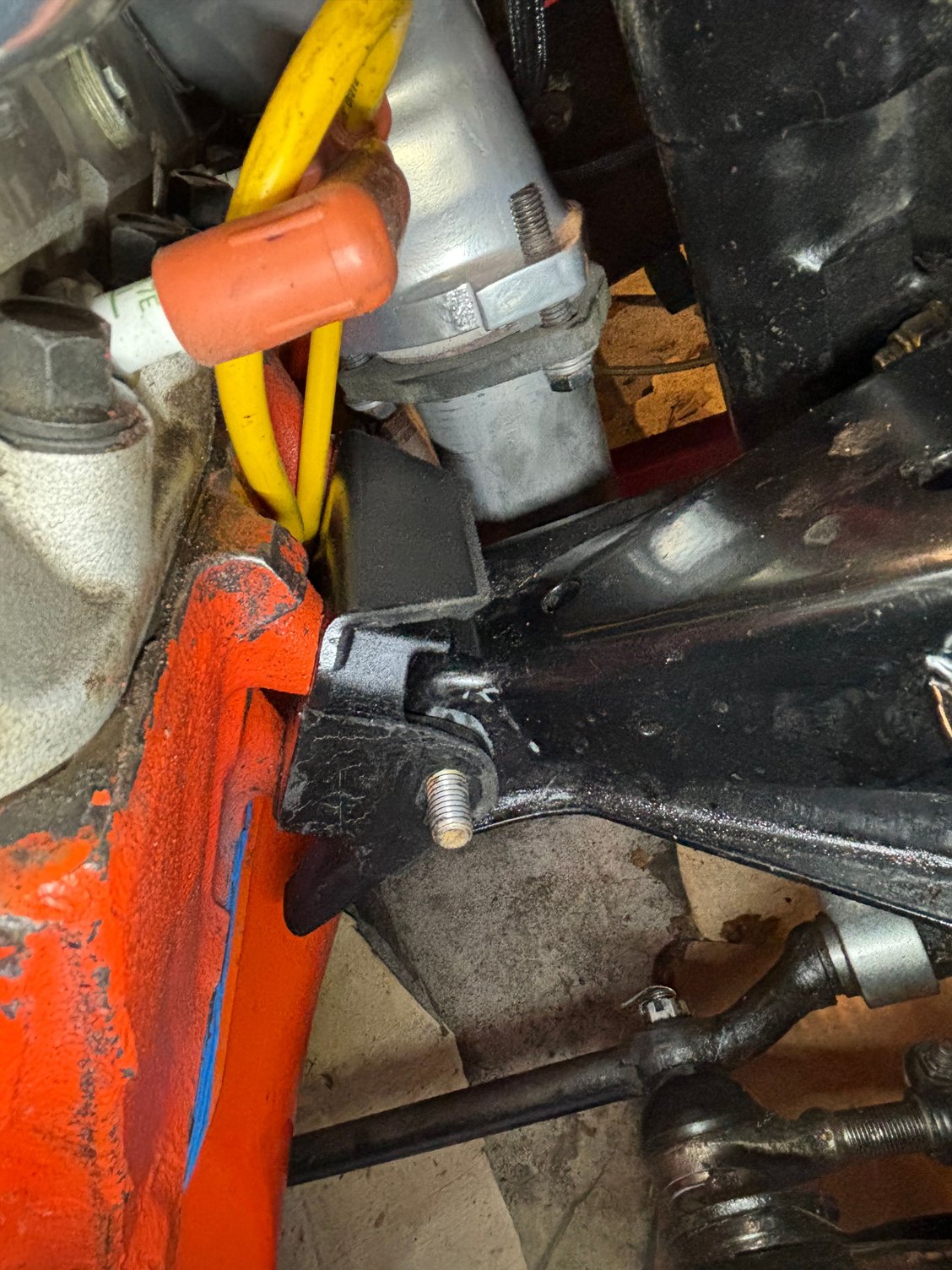

A little more progress.

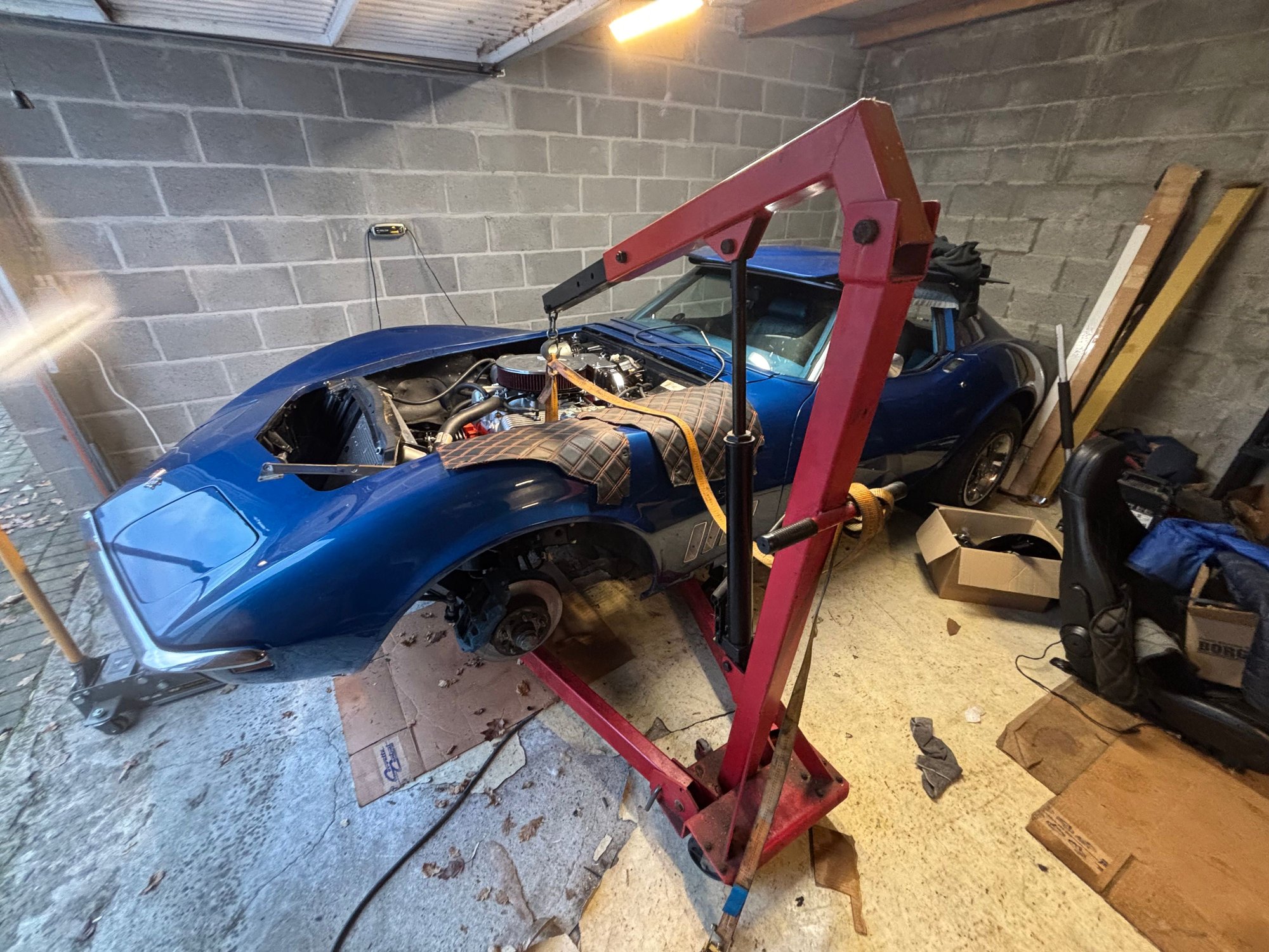

While I have the PS pump bracket off… let’s work on replacing the solid engine mount.  I’m hoping that will reduce cabin vibration.  I’m not at all confident, but it’s worth a shot.
Out was relatively easy.
In was surprisingly easy too….  Except for one bolt that mysteriously would not go in so I replaced it with a stud.
Just enough room to slightly lift engine.
Always quit while you’re ahead
Always quit while you’re ahead.
