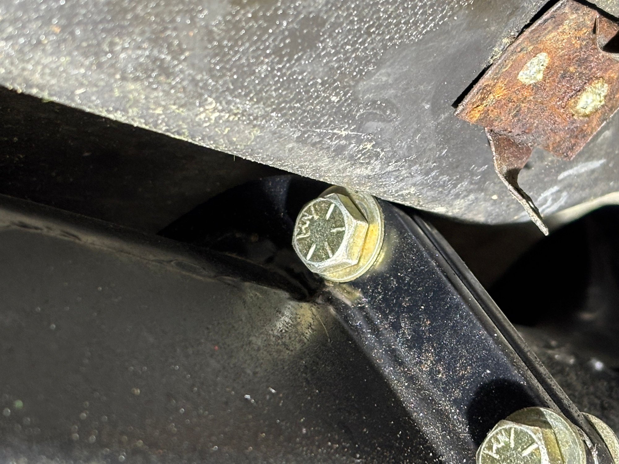

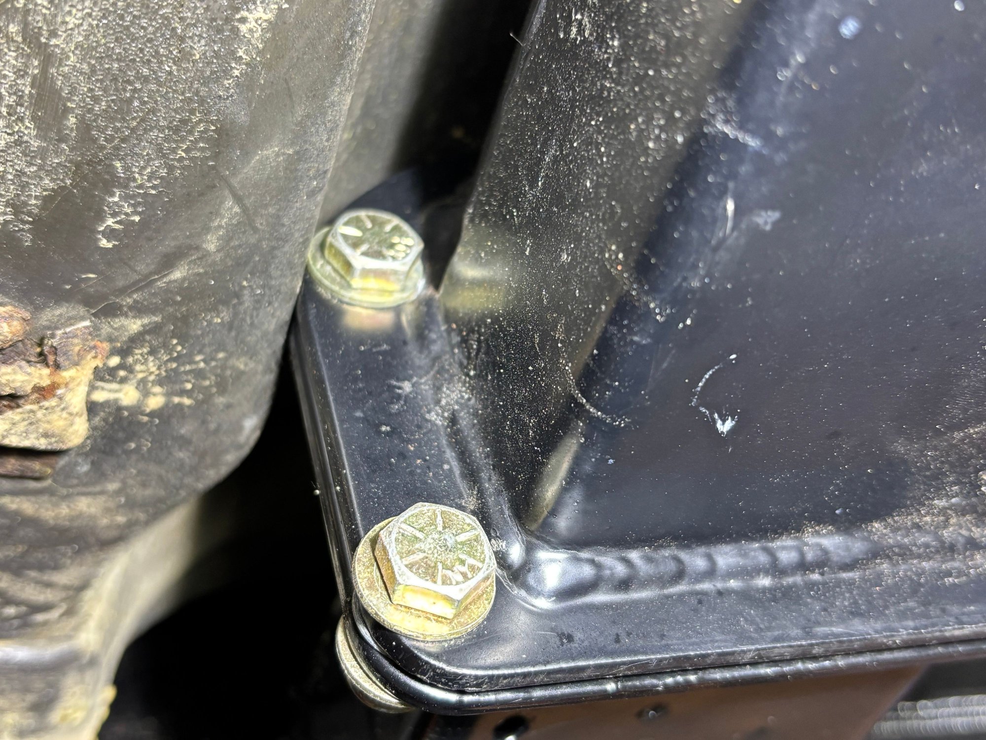

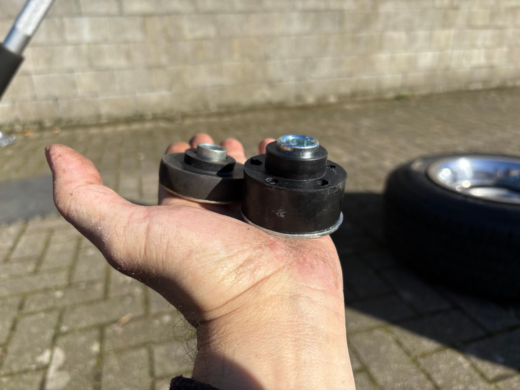

In my quest to control vibrations I decided to replace my 60s body mounts with body mounts from a late C3.
Will drive it a bit (in a few weeks) and see if suspension settles a bit.

So you have gone from the solid aluminium mount to rubber mounts. Should remove some of the road harshness but raise the body a bit. Will be interested in your driving comparisons.

I did drive it a few feet into my garage. It does feel like a detectable difference. A road test will tell tale. But that’s three weeks away at least.
The difference was… transformational. At least for me. No exaggeration. Now the vibration is only transmitting through the steering wheel (my rag joint was replaced by a solid universal joint) and the shift lever. I am super pleased I did this change. I had the car up to 150 and it felt good.

I thought you had used old C2 rubber body mounts right? And then you still changed them to the thicker 73+ style? And that also helped the vibrations?

As for the vibration. The jury is still out but leaning very seriously toward acquittal.
I went from the aluminum pucks to the C2 rubber. The idea was to preserve the body to frame clearance (and avoid problems with steering column geometry). Upon closer inspection I found that the brackets were touching, but also the entire crossmember was contacting the fiberglass bottom. The later C3 body mounts are much taller and made a dramatic difference. As I say, I had the car up to 90 (as high as I dared go on a backroad) and I was struggling to detect anomalous vibrations. I could feel no vibrations other than in the steering wheel and the shift lever. My drives were only a few minutes. More tests to come, but with three outings today… nothing that seemed off.
