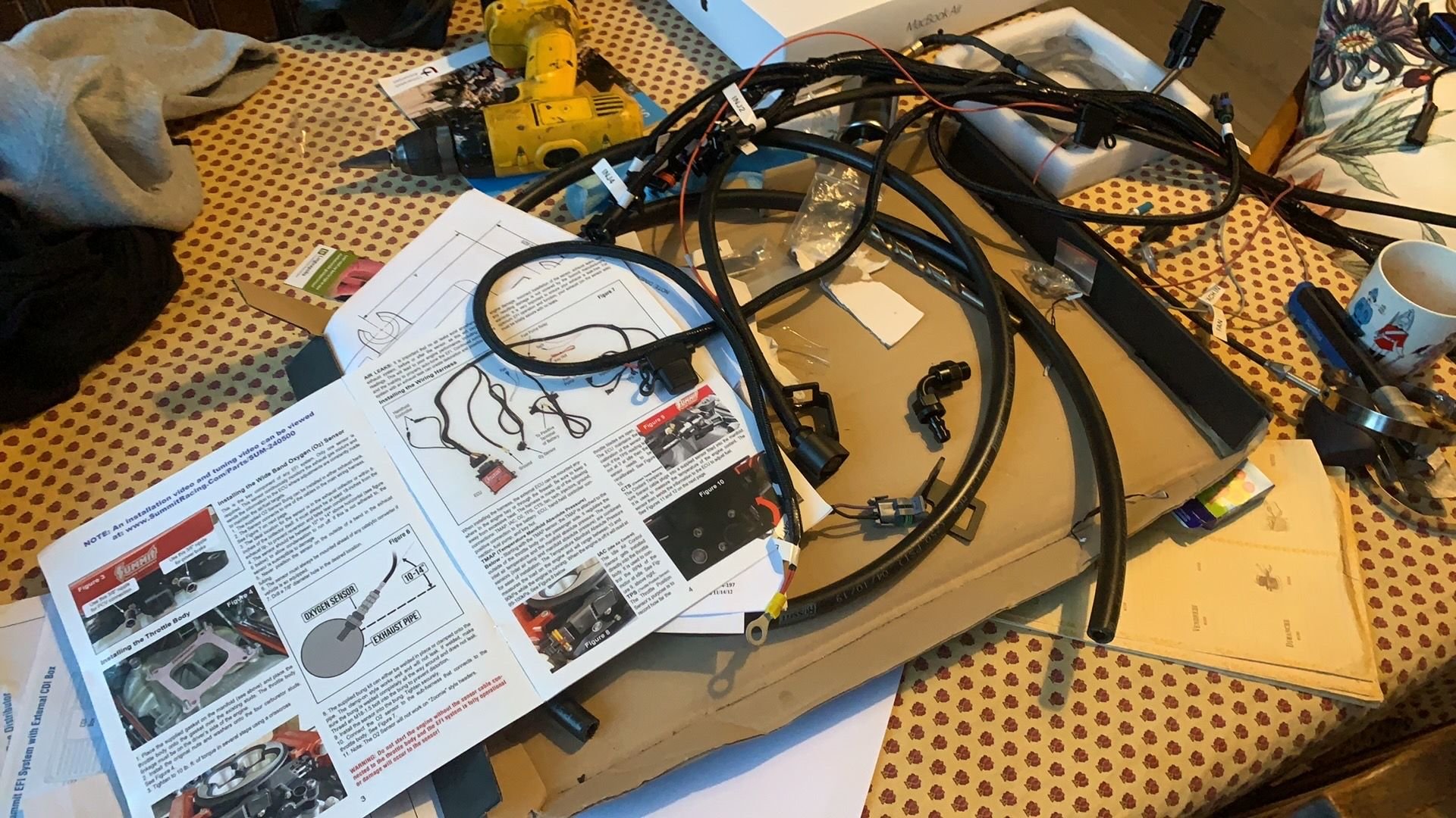

So. Time for the next step: EFI

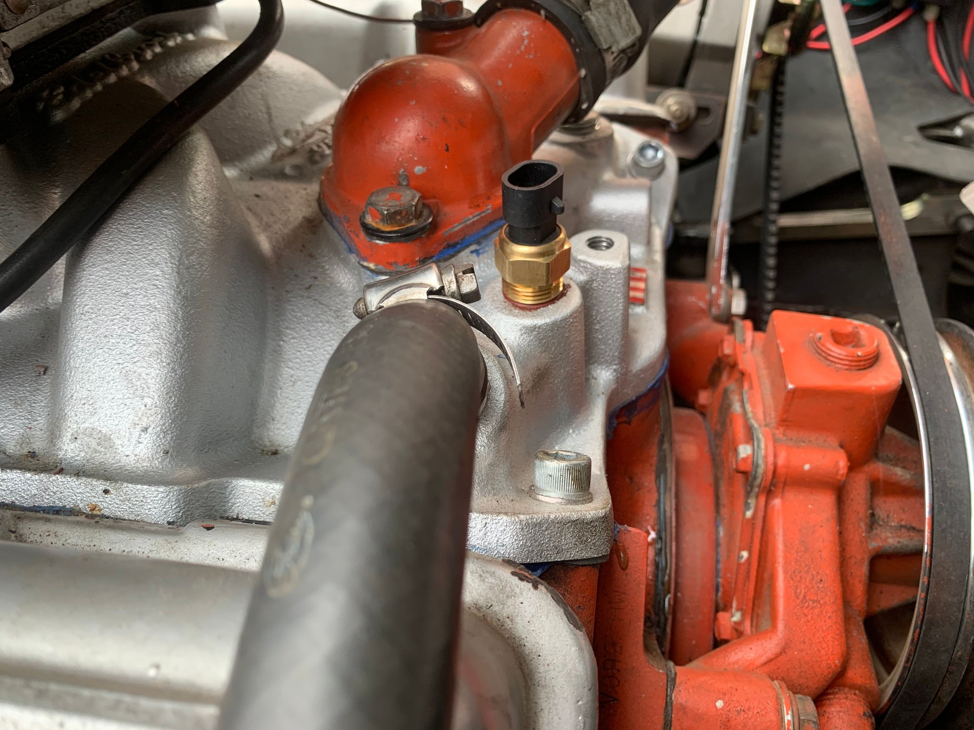

Let’s start with the easiest: the temp sensor

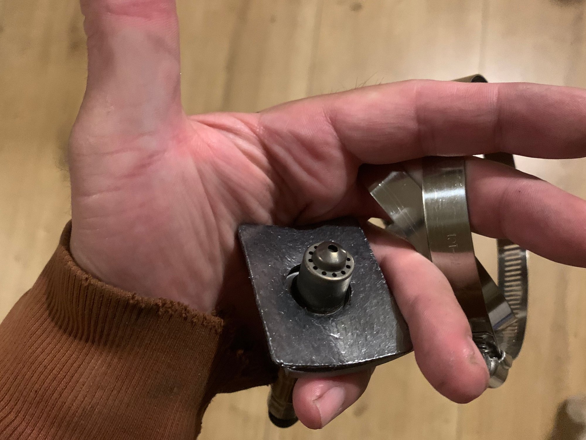

fabricate a bracket for the sump and high pressure fuel pump. I opted for Edelbrock. I had some left over aluminum brackets from a seat install. I won’t paint them yet. First seeing of it works well. It does.
Out with the old.
on with the new. As there is not fuel bowls here, I am not worried about heat screwing up the carb. The floats are in the sump. No need for the insulating spacer.

Hip bone connects to the... but bone.... Which side is up ?
I was expecting drilling this would be a nightmare. It turns out it was super easy !!!!
At around midnight I was finished. Too late to test tho.

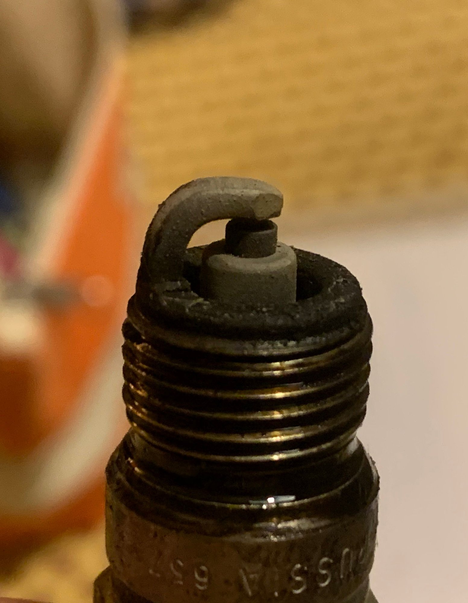

(Full disclosure: I bought my carb used, rebuilt it and did an electric choke conversion on it. Also, on the EFI, I only have about 50 miles of road testing. Some tweaks may be necessary, such as reinstalling a 195C thermostat. Where did I put that thing ?!)
Yet, even at this early stage I am pleased with my EFI.
My carburetor was absolutely running rich at idle. Working around the car was annoying; it reeked. I had tried leaning out the carb IMS, but the idle quality suffered too much. I checked and rechecked the float level - nothing to be done short of drilling out the bleeds. That problem is 100% gone now with EFI.
Overall, my Eddie 750 CFM was running reasonably well and my issues were very mild. It would start up immediately every time; quicker than the EFI, in fact.
The EFI, of course, starts up every time with no throttle input whatsoever. (That is one of the reasons I bought the EFI: to make it -proof for my more civilized half.) Surprisingly, I do have to crank it a bit longer than I am used to with my carb, but no effort whatsoever is required on my part to start it up (other than key the ignition) or keep it going as the engine warms up. Just turn it on and go.
On hard braking and coming to a full stop, with the carb, I sometimes stalled (again, no float work seemed to change that; spring-loading would have been the next step). That is gone.
On deceleration I would get some pops out of the tail pipe. I still get some random pops out of the tail pipes, but they are milder. I will need to go through my ignition and check all my plugs.
Carburetor throttle response was good. WOT, for the turd that my engine is, was reasonable. With the EFI, throttle response and WOT seem about the same, maybe? But the onset of power is muuuuuch smoother ! It used to be I had to be much more careful bringing it up to WOT. Now it comes on smooth, strong and clean. There are no hesitations and power is uninterrupted and sustained.
The IAC can get noisy when cold and, if you accidentally get near stalling, you can hear it struggle a bit to keep the engine running. (Better the ECU than me ) A 195C T-stat might quieten things down a bit.

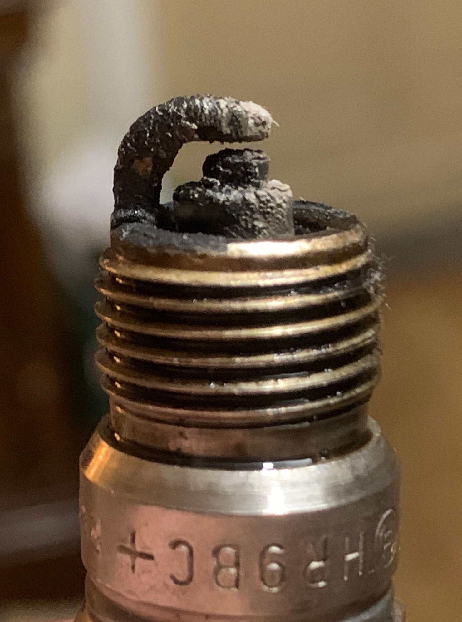

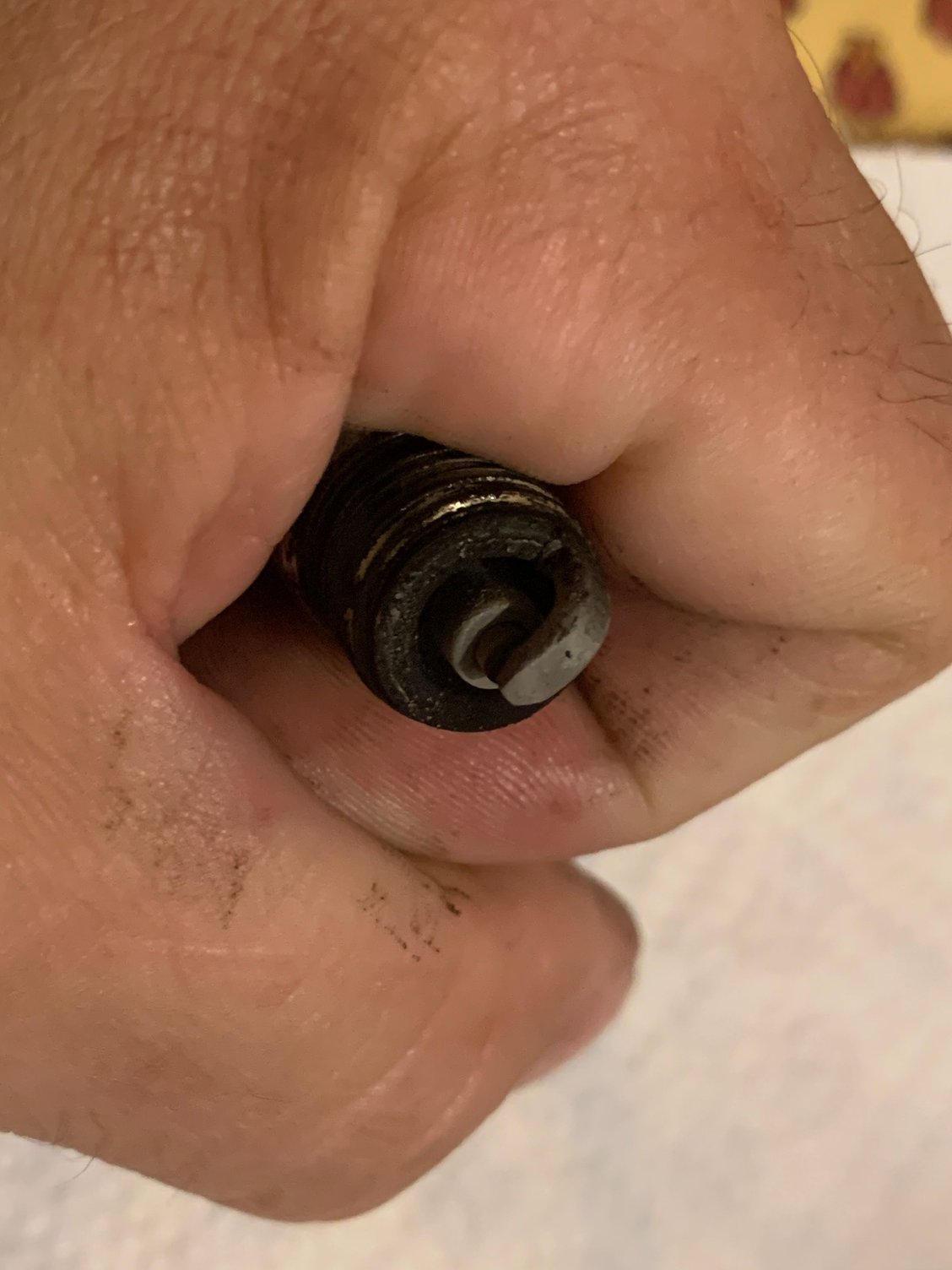

I will yank a couple of plugs today to see what they look like. #curious #anticipation
EDIT: Incidentally, I went cheap and did not replace the plugs when I went over to EFI. I shoulda

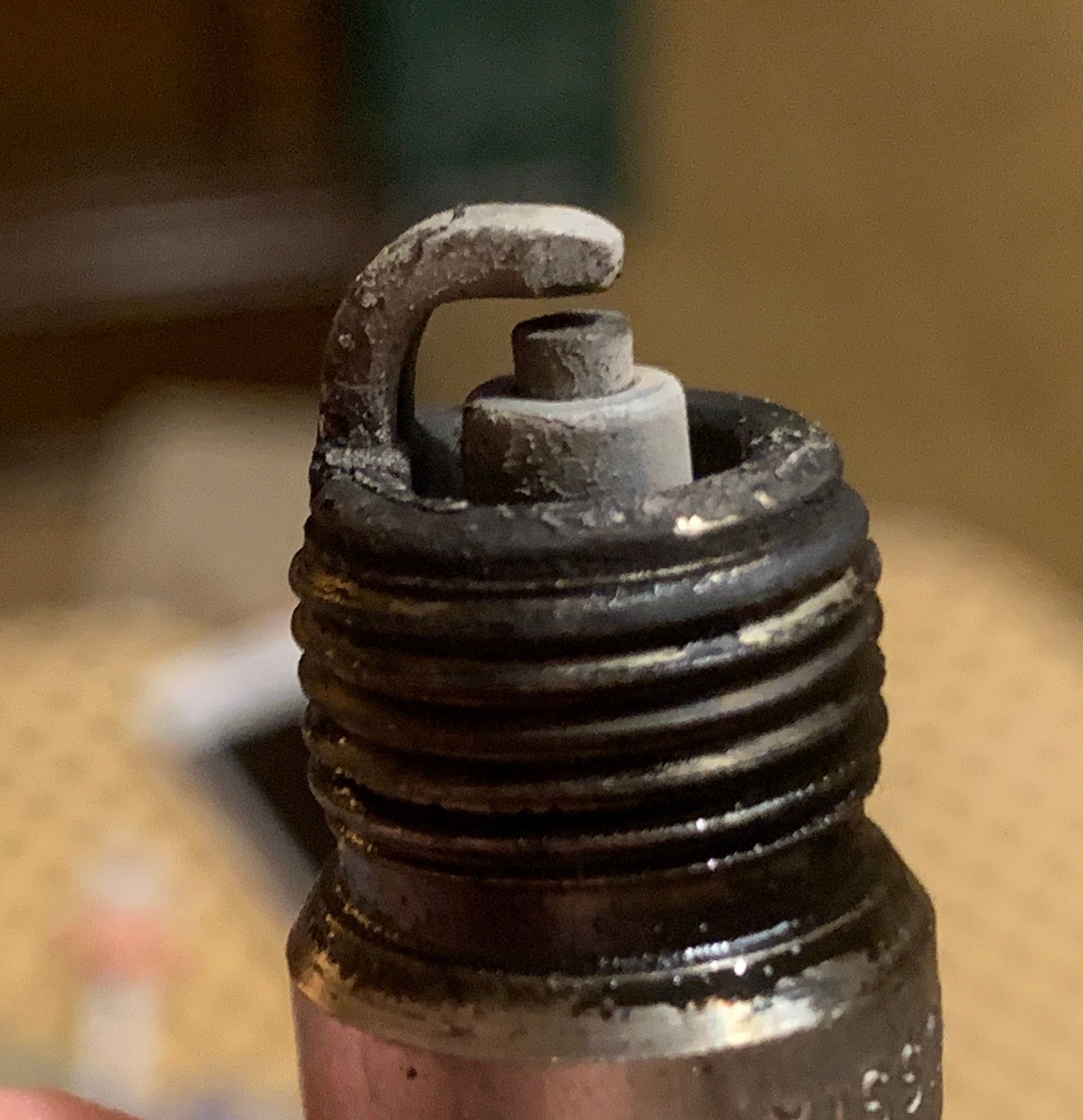

Ok. Well I discovered that my valve covers are leaking and that new plugs would HAVE BEEN a good idea.
