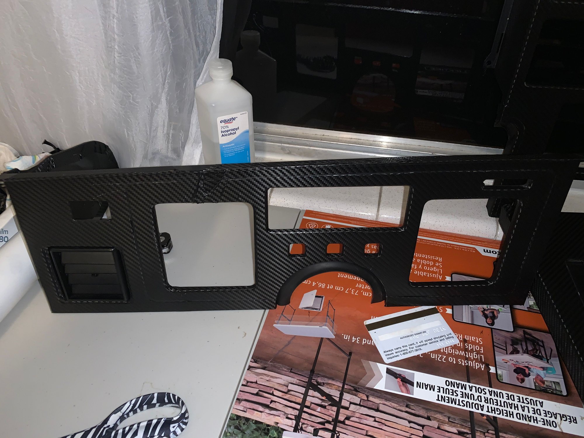

Since I plan on deleting the bread box and fixing the electrical dash issues, I knew I needed to remove all the dash panels and such. So, took the dash pad off, the dash trim, removed the radio to replace, and the breadbox. I continued the theme of carbon fiber wrap in the hard black plastic areas. Definitely will need to redo this one day but it was a first time thing.

Originally Posted by Will Speed
Happy Thanksgiving guys. I have been plugging away at this car as best I can and figured I would give ya an update.
I’m still working on getting the engine running good. At the moment it still hesitates under load but it’s much much less than it was. I ended up building a smoke machine to find all the vacuum leaks and that did a lot. I bought a fuel pressure gauge to get an accurate reading and have it plumbed but just not wired. I haven’t wired it because I already have some electrical issues in the dash and am waiting on the FSM to come in the mail before tackling that and those issues.
While waiting I moved on to some other issues I wanted to address. Most of the interior is in great shape except for the top window rails on the doors. Took the door panels off, they fell apart...gathered all the pieces to epoxy them all back together on reassembly.
My stereo system is shot so it was also a perfect time to remove the door speakers...that was an interesting removal. I was slightly prepared, but nothing ever goes as planned. Nonetheless, I was able to recondition the original vinyl and carpet on the doors. I decided to switch all the interior lights to LED lights and am waiting on them to be delivered to full finish the doors. I also added some carbon fiber vinyl wrap to the hard black plastic throughout the interior of the car.
Hopefully this FSM gets delivered so I can move forward with the next steps.
The carbon Fibre wrap looks great!

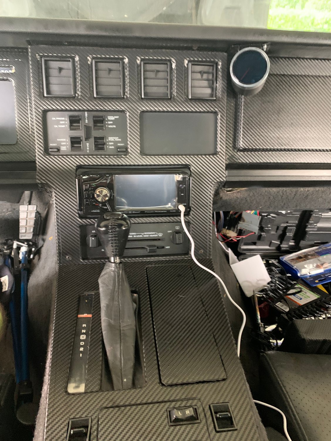

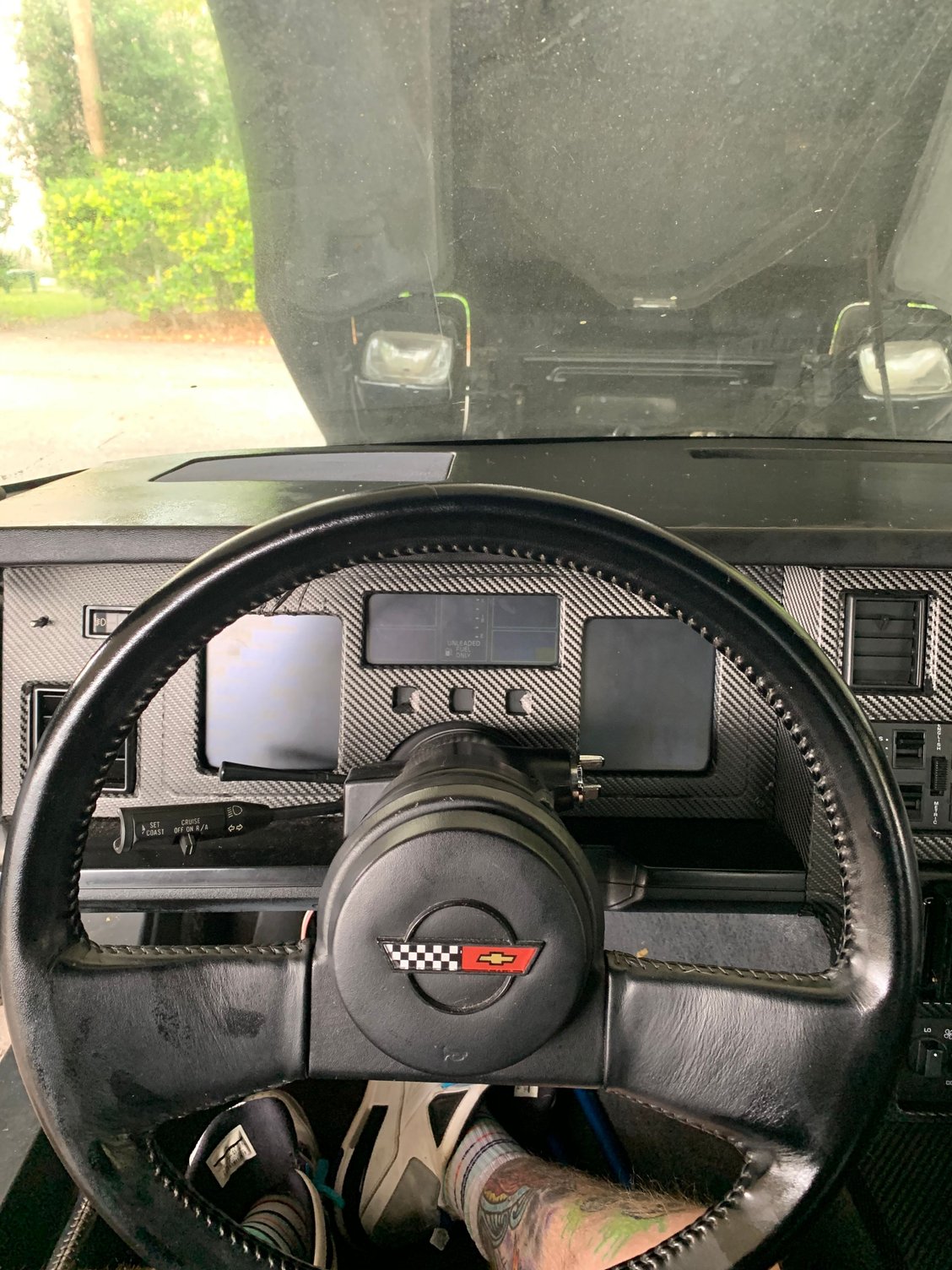

Finished up the dash work today, and man is it looking much better. Figured I would just share some pictures for some attention.

Looks awesome, the CF look goes perfect with the style of the C4 interior. nice work.

Also what type of head unit is that? looks like a perfect fit.
Thanks man! The head unit is a Power Acoustik PD-454B. I found it on Amazon for $100. Single DIN but has a 4.5” touchscreen. It fits really nice! I’m pleased with it, but it’s sad because I already have an upgrade that I want to do. I’d like to install a Nexus 7 in that spot. This way I can get a bunch of extra amenities.

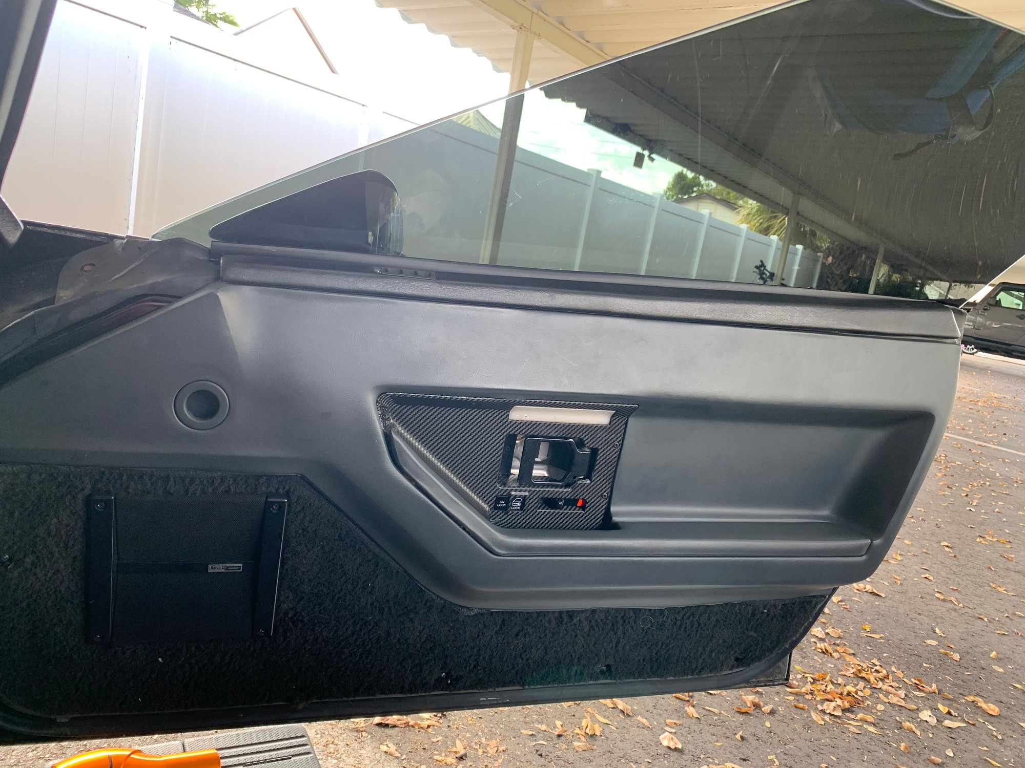

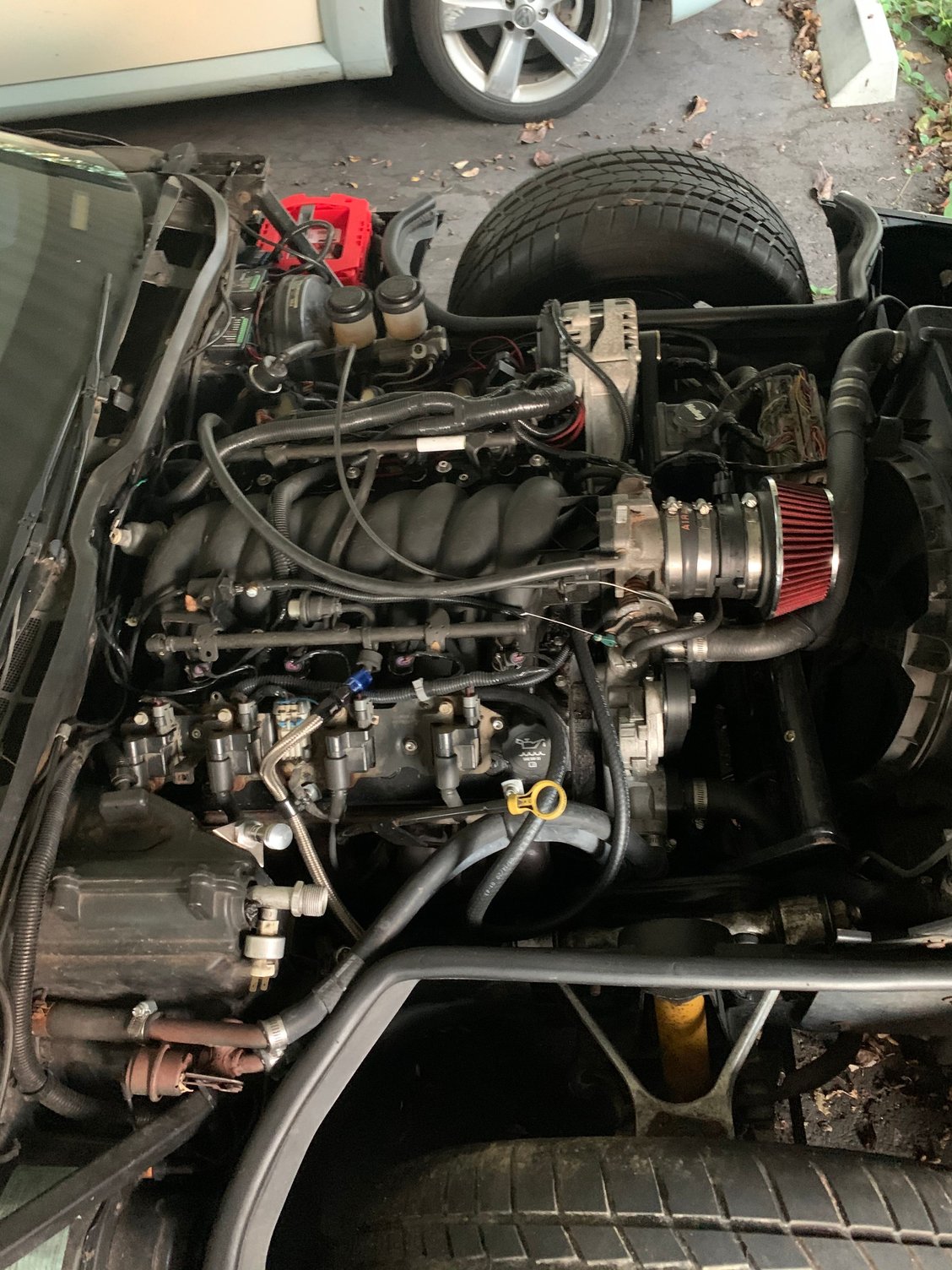

One of the many advantages of moving from PA to FL is the weather! Well, at least the part about not having to deal with freezing temperatures and snow throughout the winter. It has definitely increased my time spent working on this ride. I have gone on a few test drives since doing the swap, maybe 10 miles total, and last night I took BLK_BETTE out to a GM car meet here in Orlando. She is definitely starting to run better, maybe the ECU just needed to sort itself-out through some mileage, Idk 🤷🏼‍♂️.
I couldn’t stand the amount of rattling throughout the vehicle so I went on a bender trying to relieve the noise. I found that the door panels had undone at the window again so I removed them first. I bought some of the Anti-rattle window guides from Eckler’s and installed them. Mine were ok, but better safe than sorry. I also bought some sound deadener sheets from Amazon and installed them on the outside of the door frame, behind the panel.
I used Gorilla Glue epoxy putty to rebuild the door panel window lip. And after installing the door panels back, no more noise!! Thank goodness. Honestly, after looking at everything, I think the rattle was coming from the door lock mechanism that goes through the silver metal panel inside the door. So I made sure to put some deadener around that area.

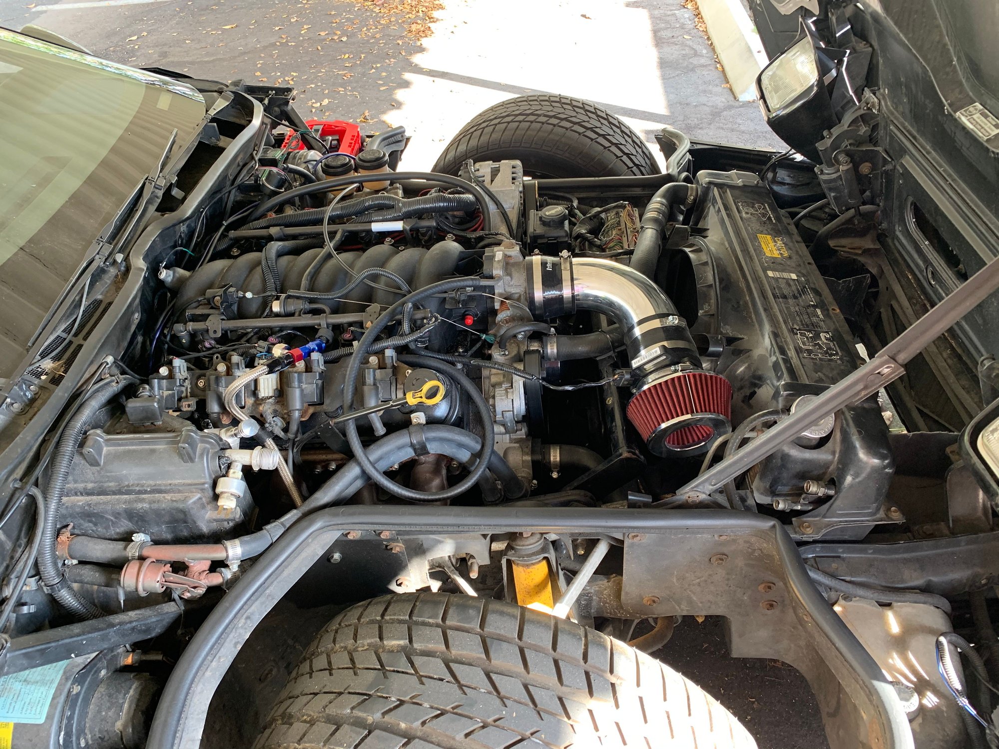

One suggestion I had been given on the LS community was that the MAF sensor was too close to the throttle-body. So I made that adjustment. Honestly, not sure that’s the culprit. I’ve also got a cheap fuel psi gauge that reads 65psi. So who knows. Could be accurate, could be off. I plan on taking the car to a dyno and having it tuned. It’ll be $500 but hopefully all the bugs will be done as far as motor goes.
