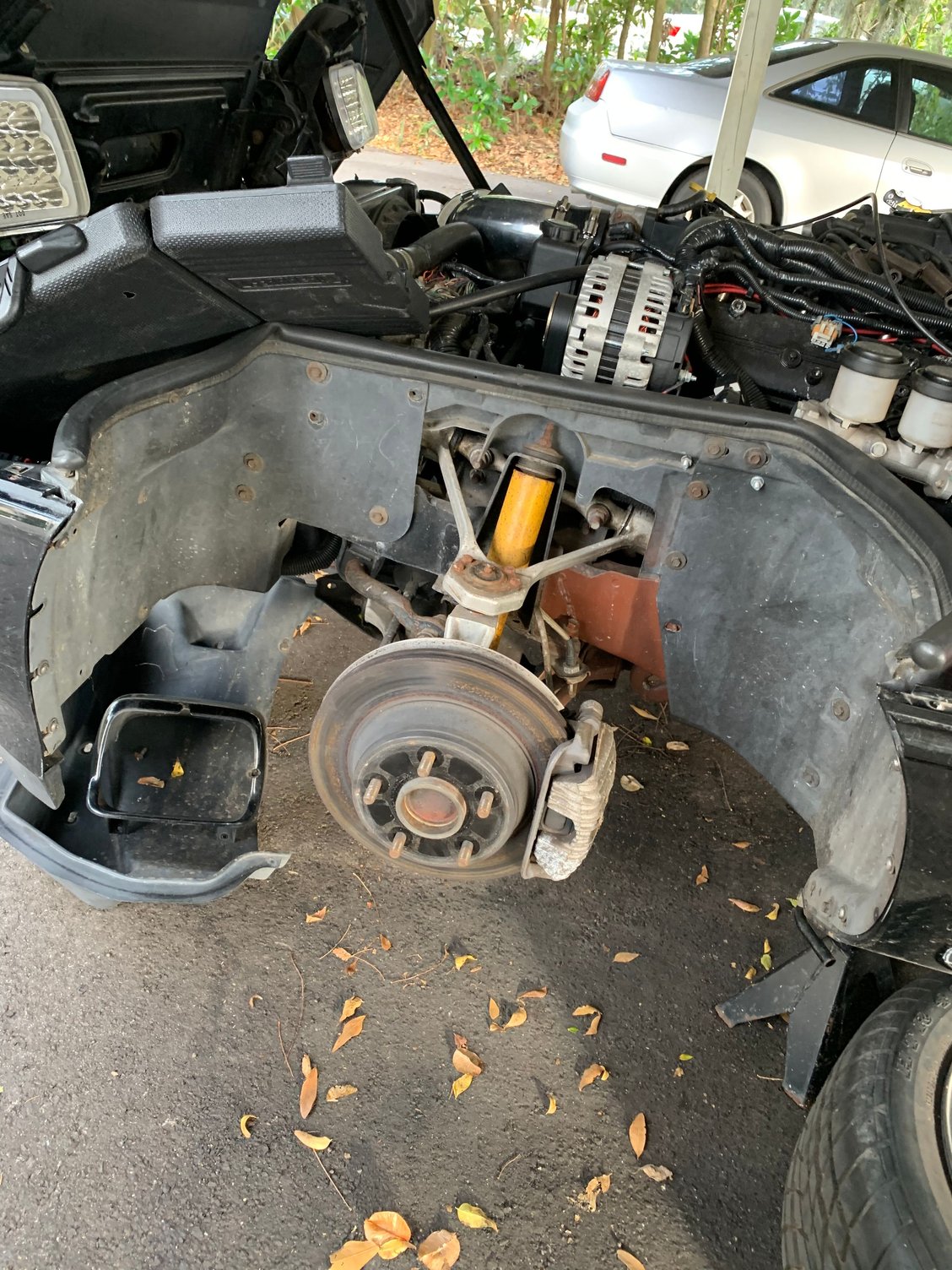

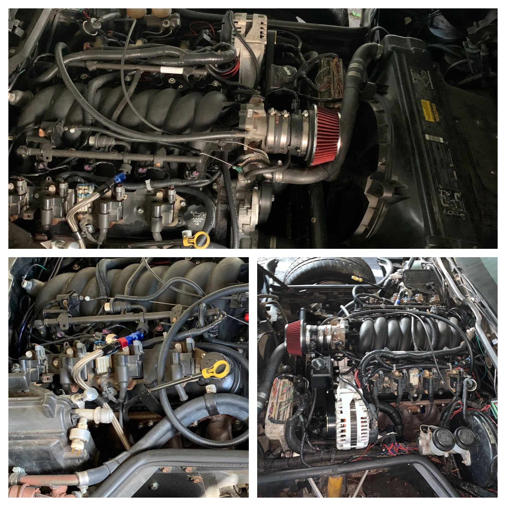

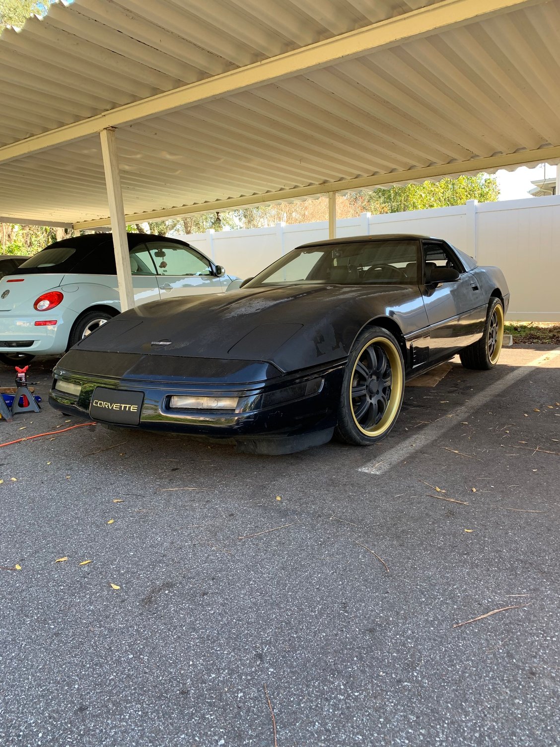

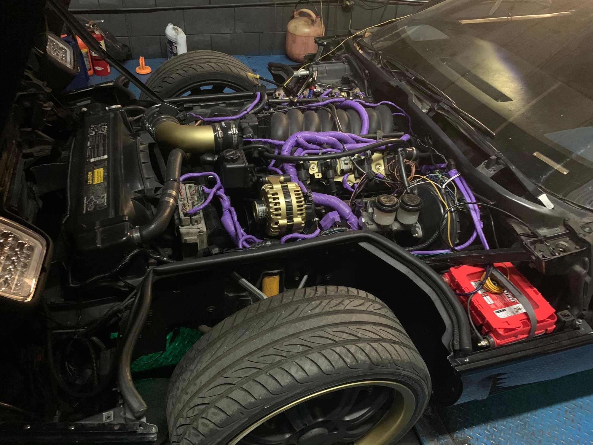

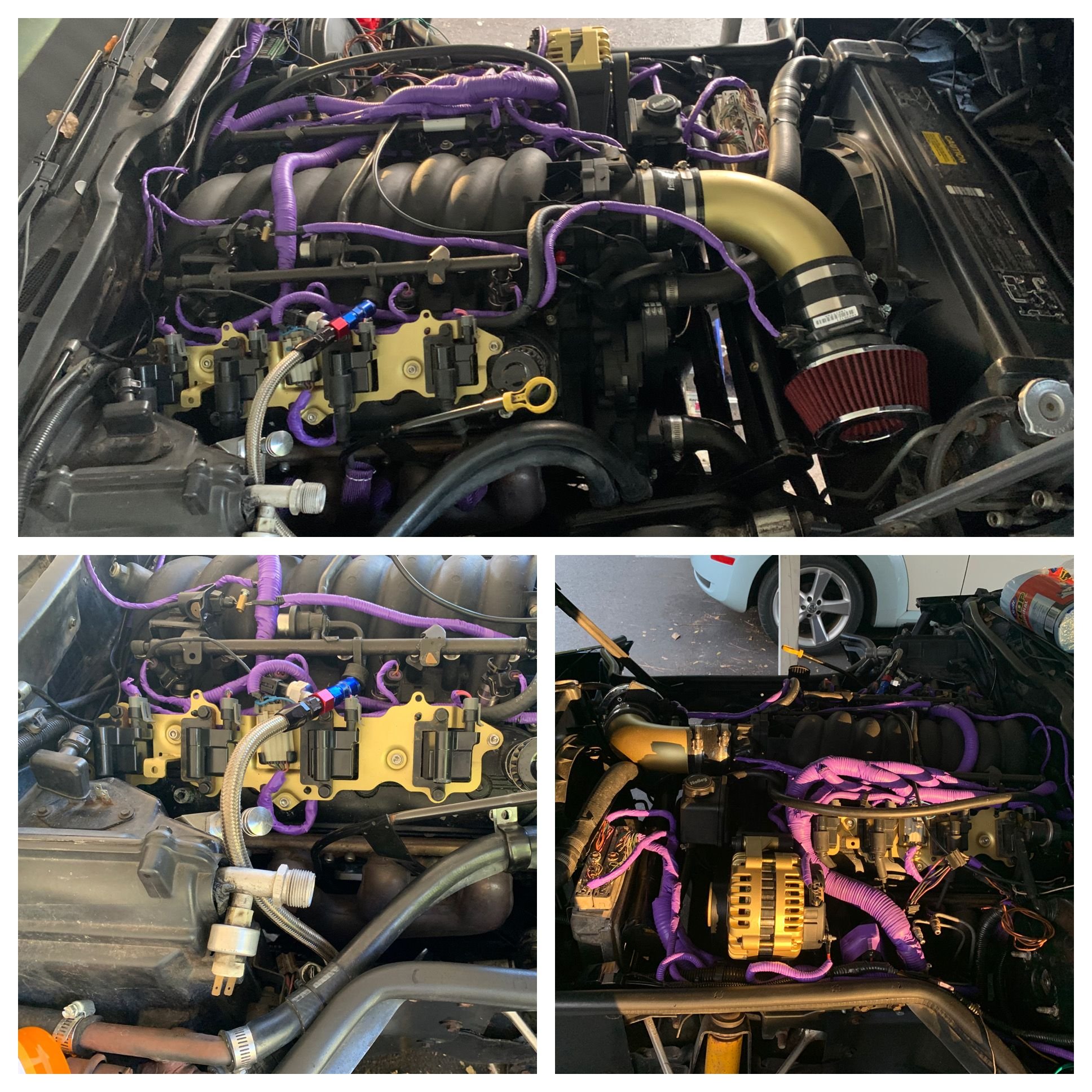

Hey guys, figured it was time for an update. Mainly because I have done some new things to BLK_BETE since the last posting. I want to preface this update with the fact that I had to park her after the Brake warning light came on and the brake pedal started losing pressure randomly...more on that in a later post. But since I had her parked, I figured I would spend sometime doing “little things”....oh those pesky little things.
The 6.0 looks fairly nice sitting in its new home
but, since I had the time, I decided I wanted to clean it up and make it more appealing to my eyes. I had already decided wayyyyy back when that BLK_BETE was going to be one of those “Murdered-Out” cars, or however you want to call it, but basically flat black. However, all black in the engine bay just wasn’t cutting it and so I needed to add some color somewhere. One color combo I have really enjoyed is black and gold with a small touch of purple. So I made a plan and spent a lot of time tidying things up in the engine bay.

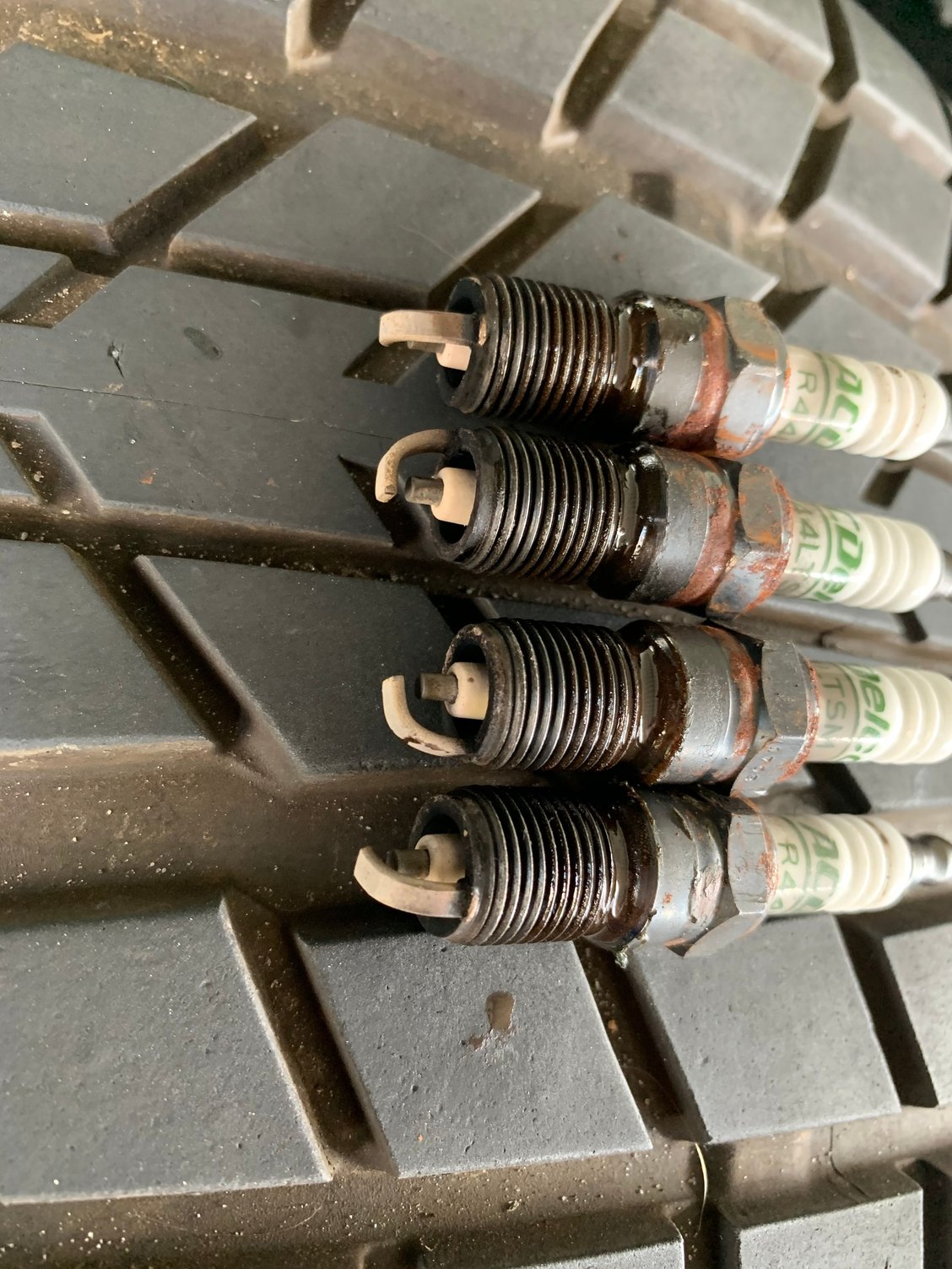

While having all the parts off, I took the opportunity to change the spark plus and wires and decided to install some heat shields on the plug wires. Sure enough, they had them in purple.
The plugs looked a little lean so good thing I changed them and I went ahead and got some Iridium NGK plugs.

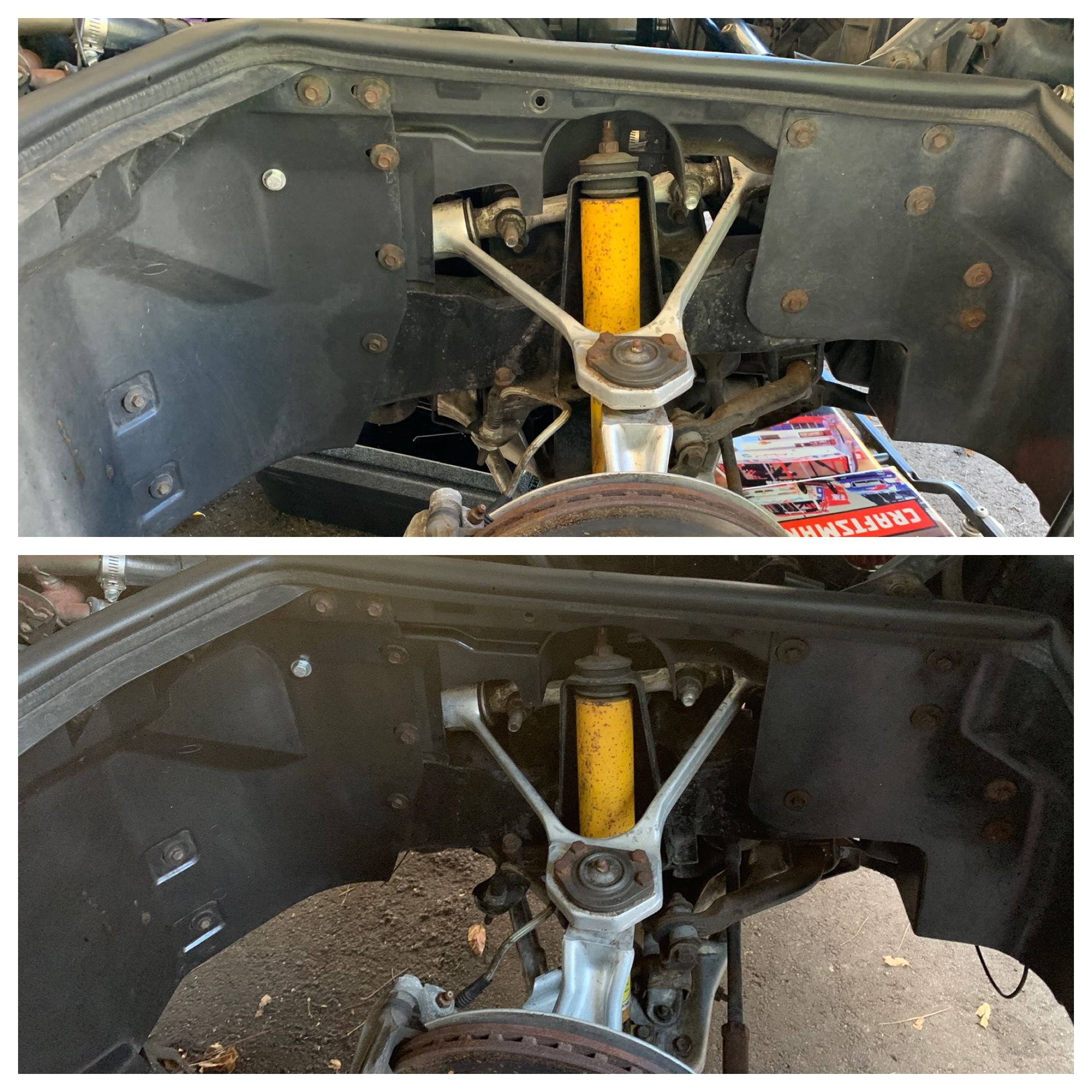

The wheel wells were fairy dirty and the black plastic was fading. So I cleaned them with Purple Power and used some Black Magic to restore the black plastic.
Santa was nice enough to drop off some cool LED lights to add to BLK_BETE’s unique personality. So I took my dash apart for the fifteen thousandth time and installed 4 illuminated rocker switches that I had wired into the console plastic. The 4 switches will control a dashcam (for those crazy Florida drivers), LED halo headlight ring, LED Dream-Chaser Interior lights, and LED Dream-Chaser underbody lighting.
This wiring did not work. Had to rewrite in car

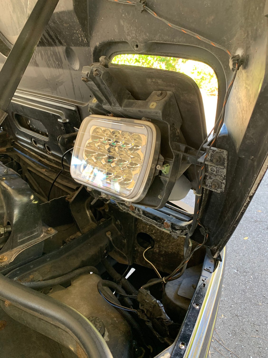

And of course I had to install the LED headlights with the halo ring.
A quick screenshot of the outside lights
And one of the inside passenger side

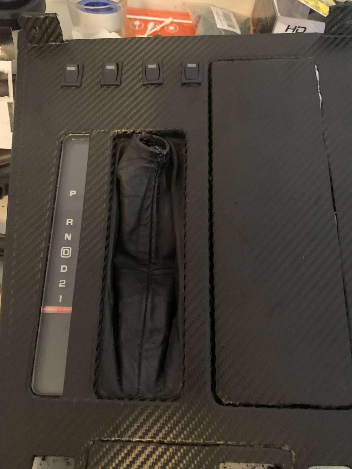

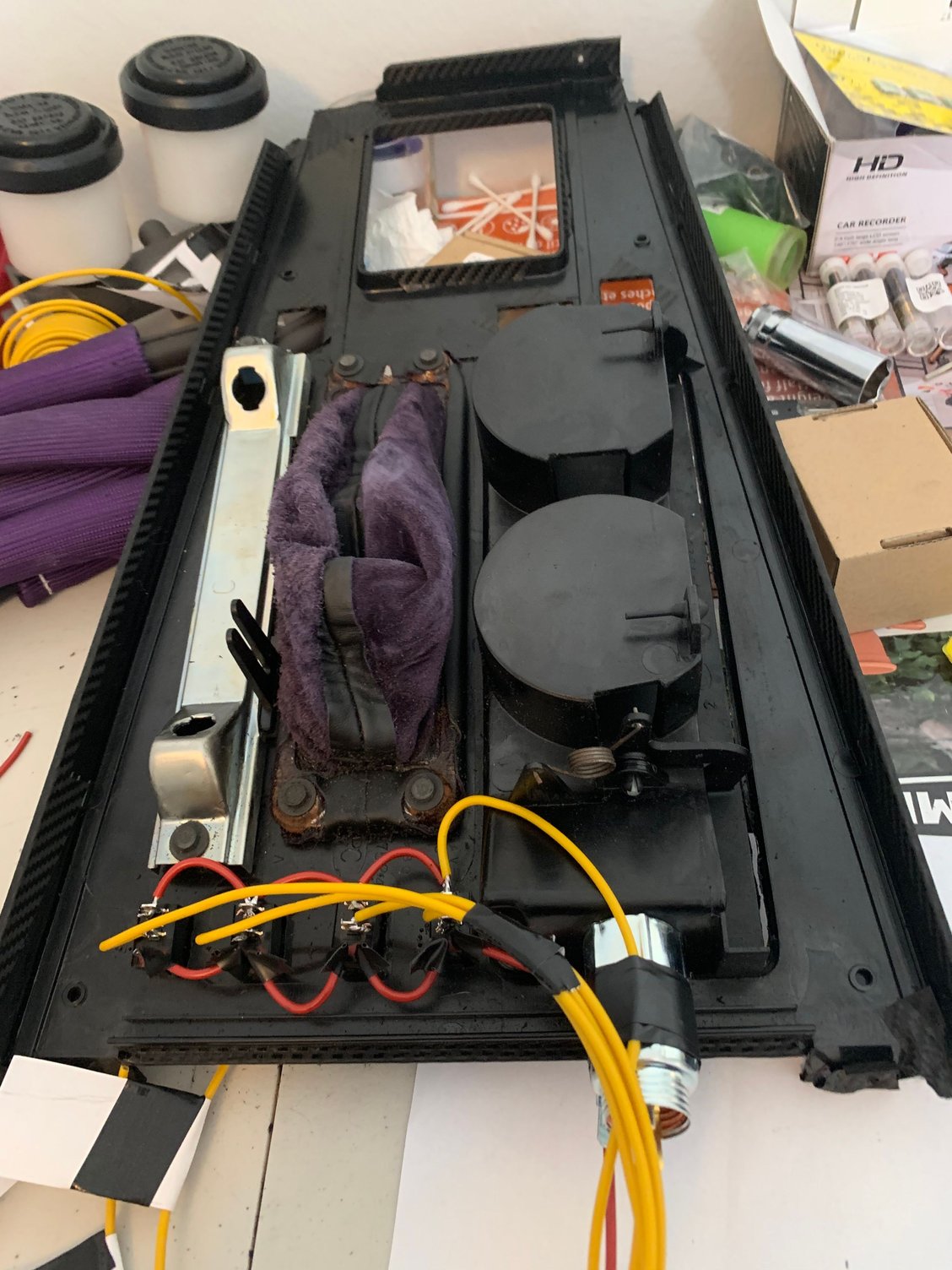

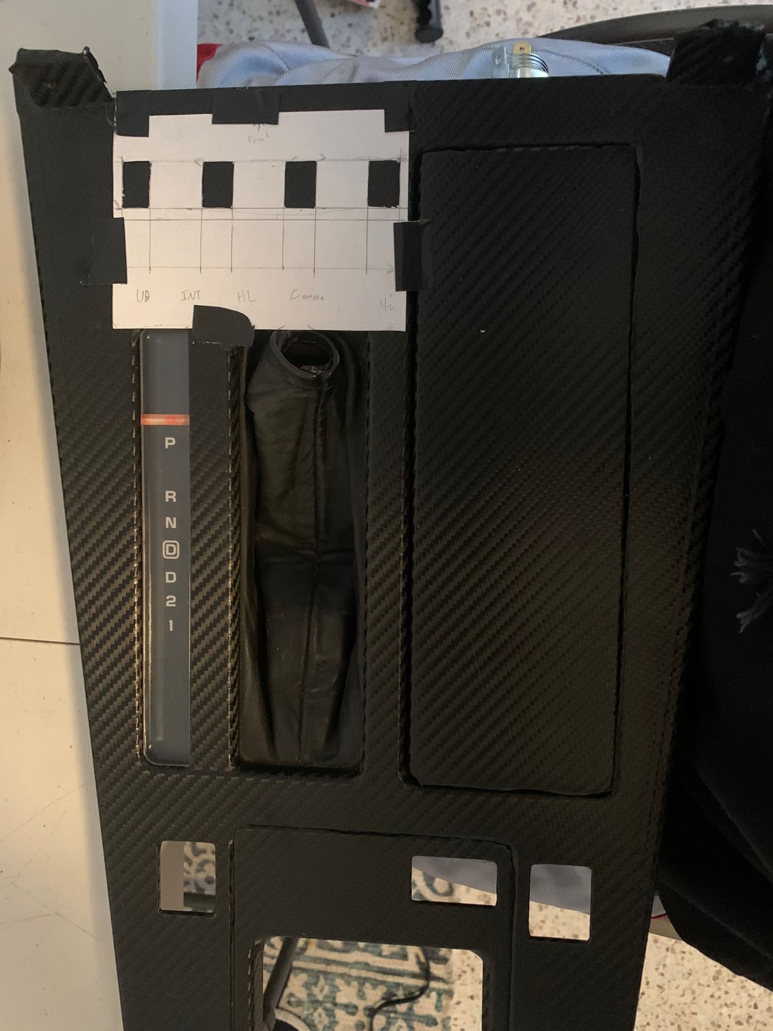

One of the things I love about the early model C4 is the dash. To me, the 80s digital dash reminds me of KnightRider and being a kid again. So it was imperative that my swap keep these gauges operative. I chased the wires down and have gotten the temp sensors wired in (still working on the oil psi).
The LS series engine ECU uses the ECU and some relays to turn on the coolant fans so you have to keep the forward drivers side coolant sensor in the vehicle. It is a two wire plug for the ECU wires. So this means either running a separate sensor for the DIC to function properly, or....you can use a 1997 corvette 3 wire sensor and pigtail. This allows you to wire the 2 ECU wires and the single DIC together into a 3 wire plug and sensor. And as I found out, it works perfectly. The oil temp and oil psi sensors were installed down on the oil pan above the filter with an ICTbillet adapter.

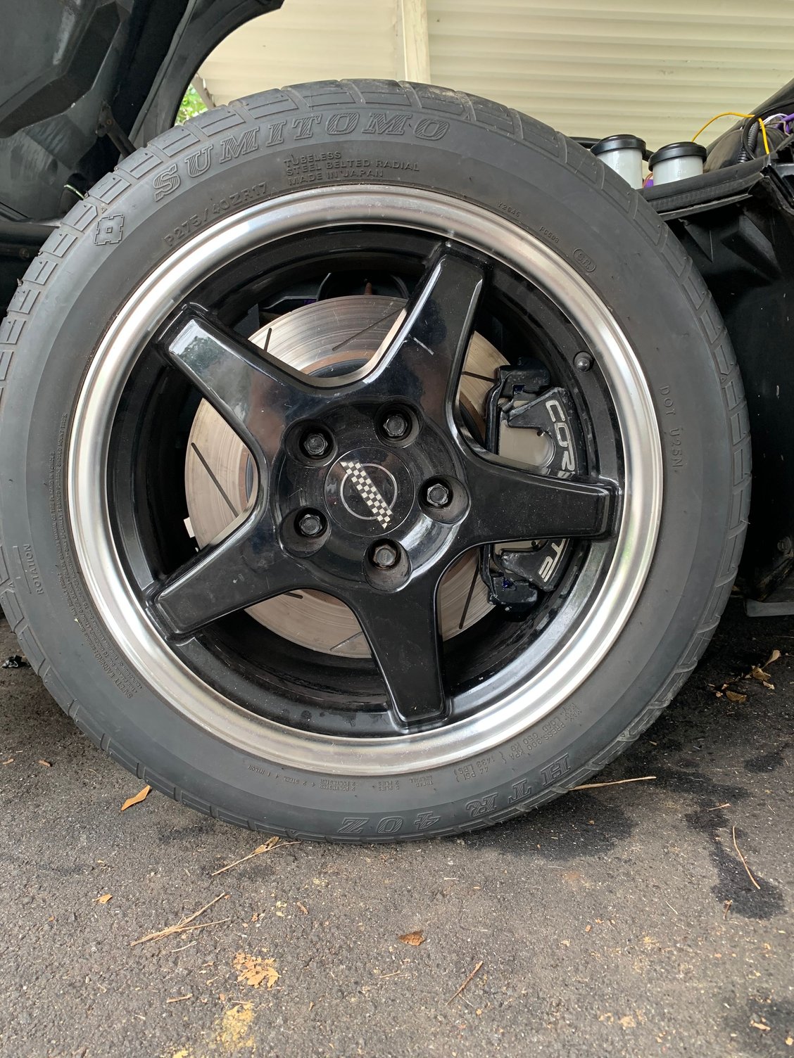

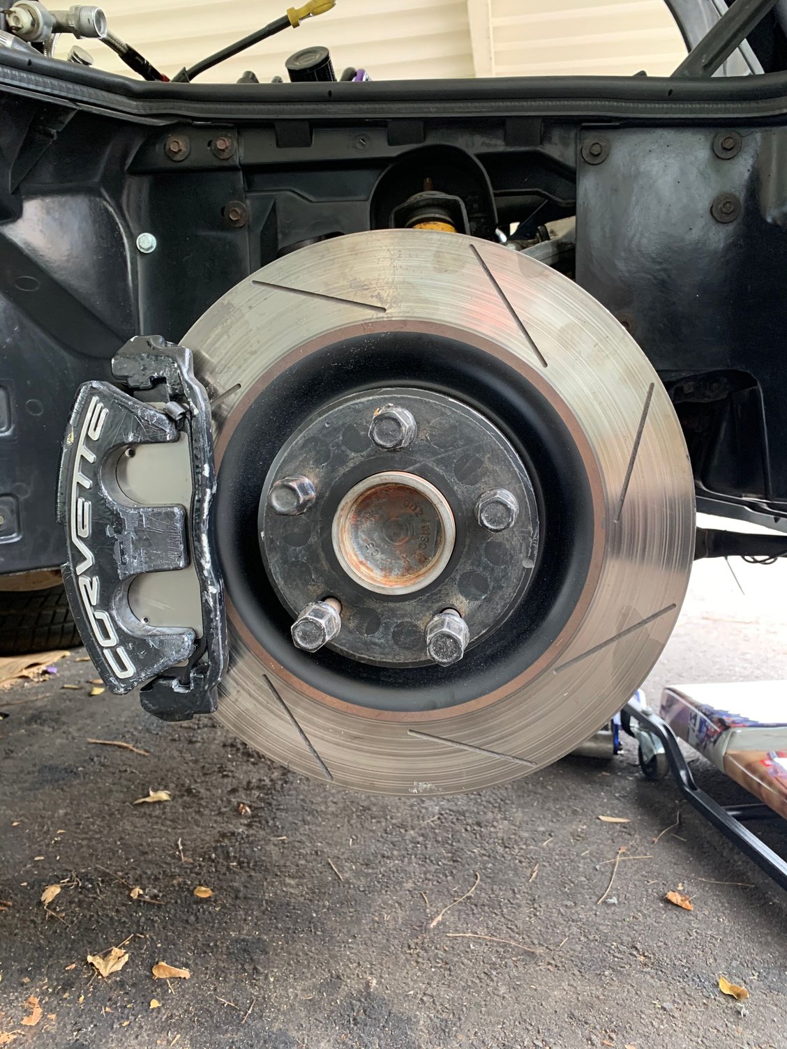

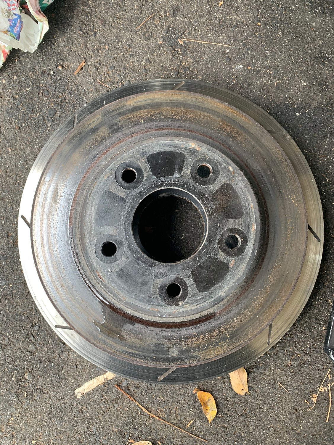

Well, I had an issue with my Master Cylinder and needed to replace it. And since I was going to put air into the system, I figured I might as well upgrade the system. Our fellow LS swapper, DMITTZ hooked me up with his “old and used” setup of C6z51 front brakes. This included slotted rotors, Performance pads, calipers, brackets, and the adapter brackets. Unfortunately his car is an 88 and mine is an 84, so I had to buy adapter brackets for my year car. No big deal. The swap took me a couple hours to change and was probably one of the easier mods on this car.
A little bit of rubbing, but not enough to be concerned about.
Man these things are huge
I’d say it’s an upgrade.

The Brakes look great on your car, they match your black wheels perfectly. I think you'll be very happy with them.
Old Jan 19, 2021 | 05:39 PM
  #69
Will Speed's Avatar
Will Speed
Joined: Jul 2017
Posts: 205
Likes: 40
From: Orlando, FL

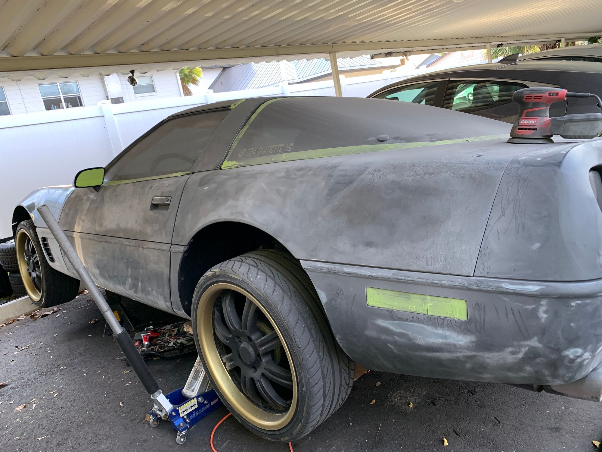

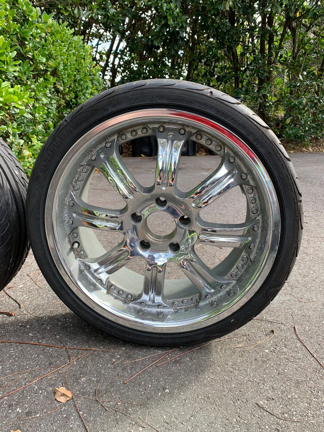

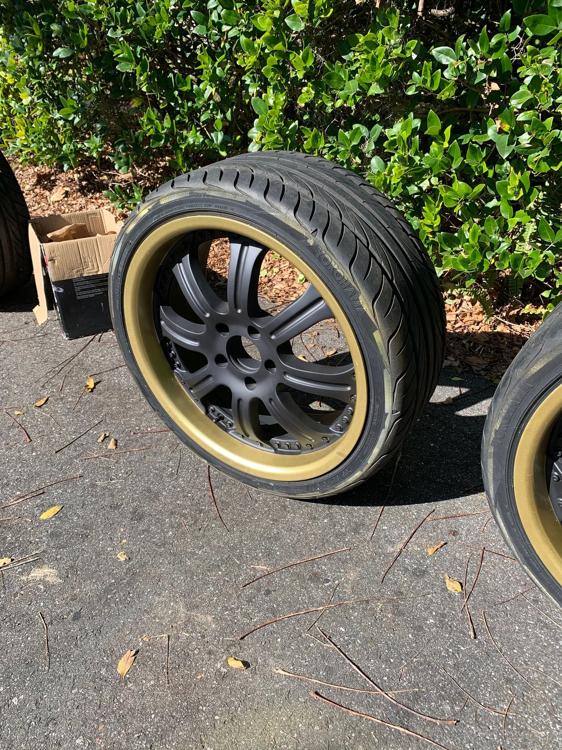

Thanks D!! Sadly, as you know, I was not able to clear the 17” wheels with that setup. But I was able to get my hands on one ugly set of chrome 19” 8spoke wheels with tires. I hate chrome, so I spent a little time adjusting them. Some will dislike my color schemes but I love the fact that my car is just screaming 80s! So here are some pics of the wheels, the process, and the results.

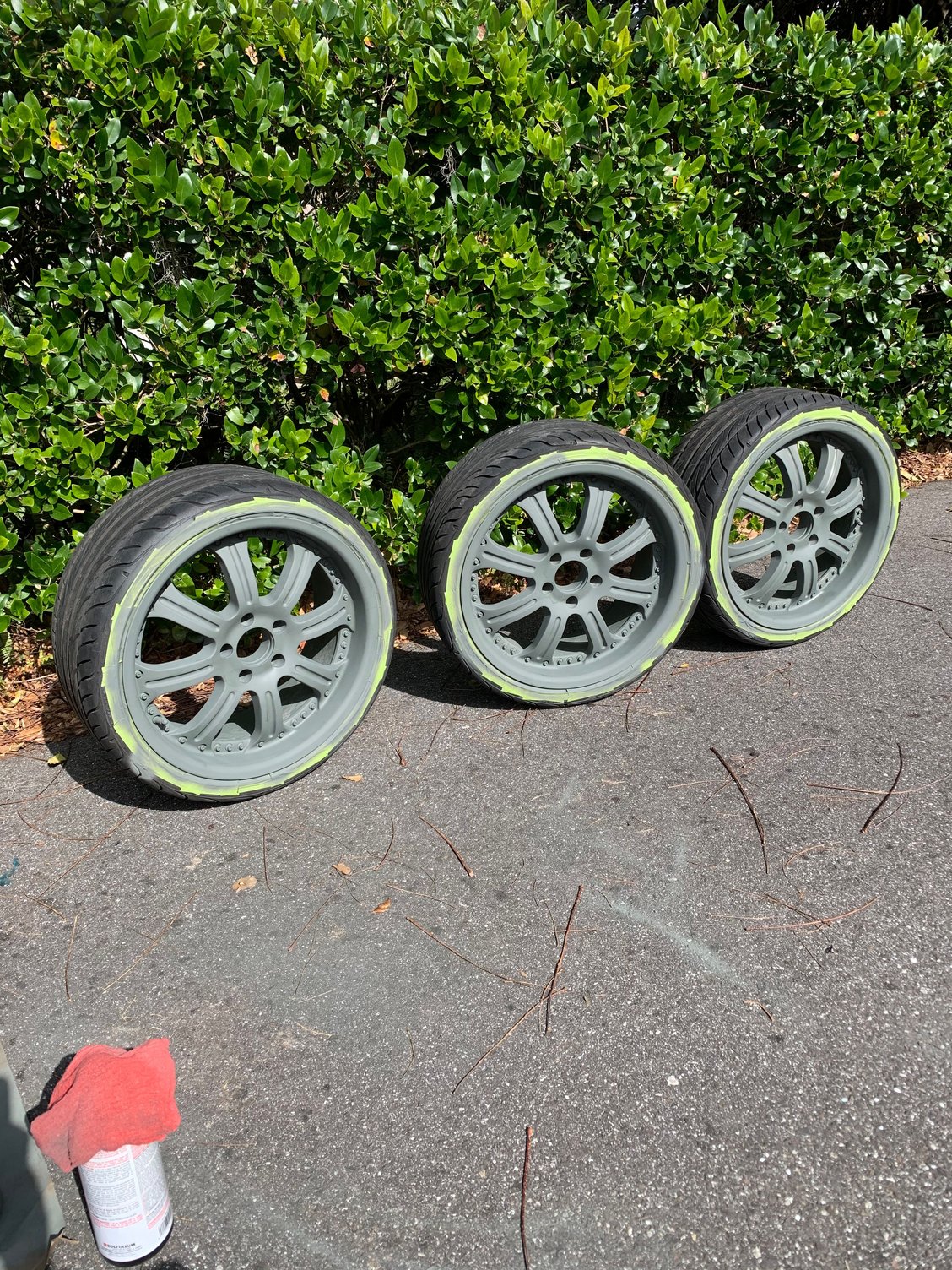

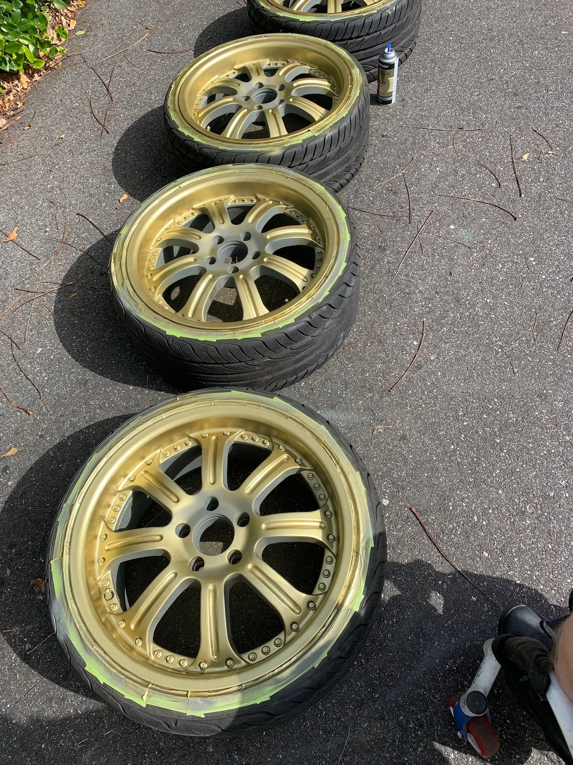

I saw these on FB marketplace for $300

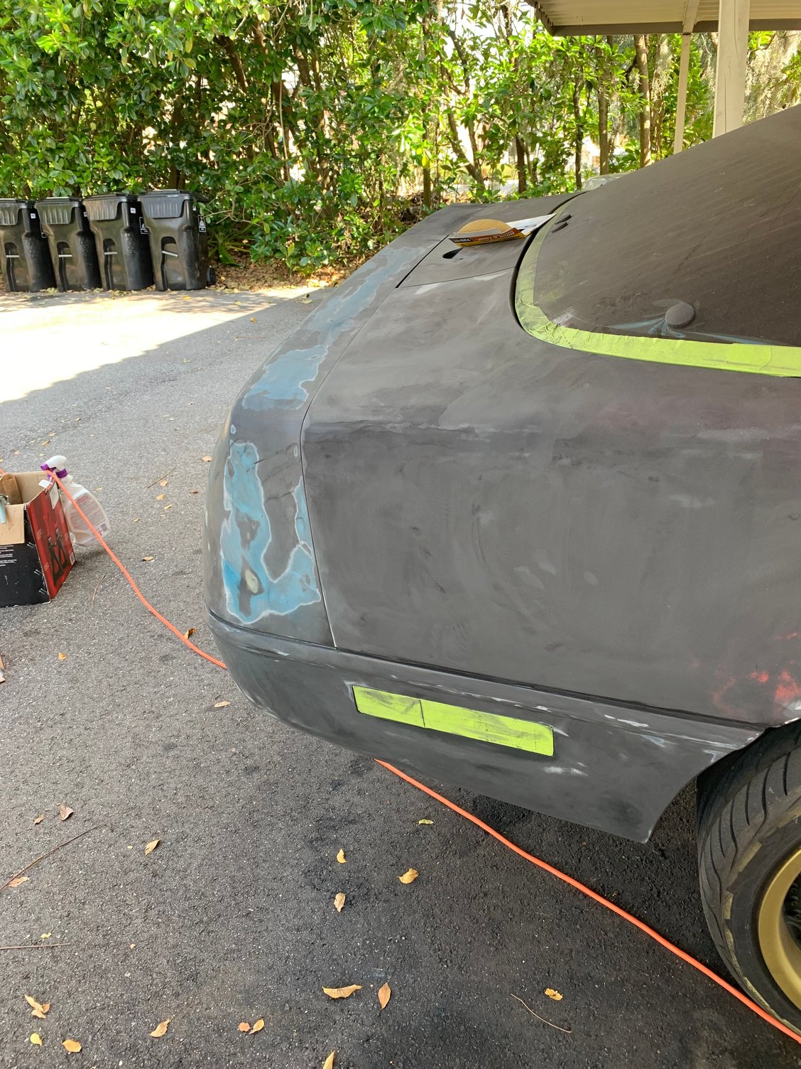

Some chrome was rusting so I sanded and prepared for paint.
Self-etching primer
Base coat of Metallic Gold to be taped off for the next stage.
After the Flat Black was applied and the taping removed...yeah, I got overspray on some areas.
I also hand painted the letters gold
Final product
Also tested my hand painting on the front LP cover. Will probably buy the actual gold lettering when I apply new Flat Black paint to the whole car.

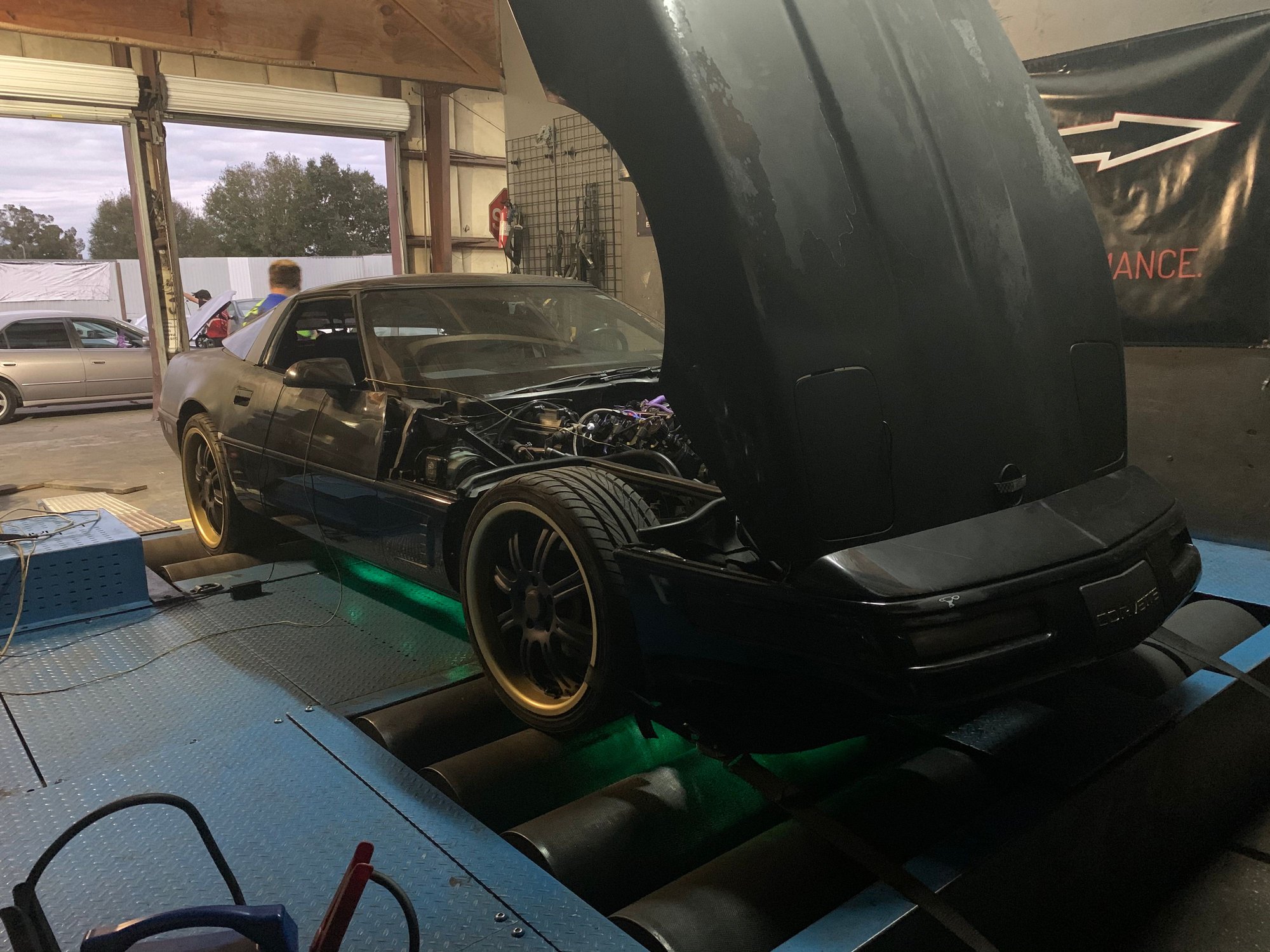

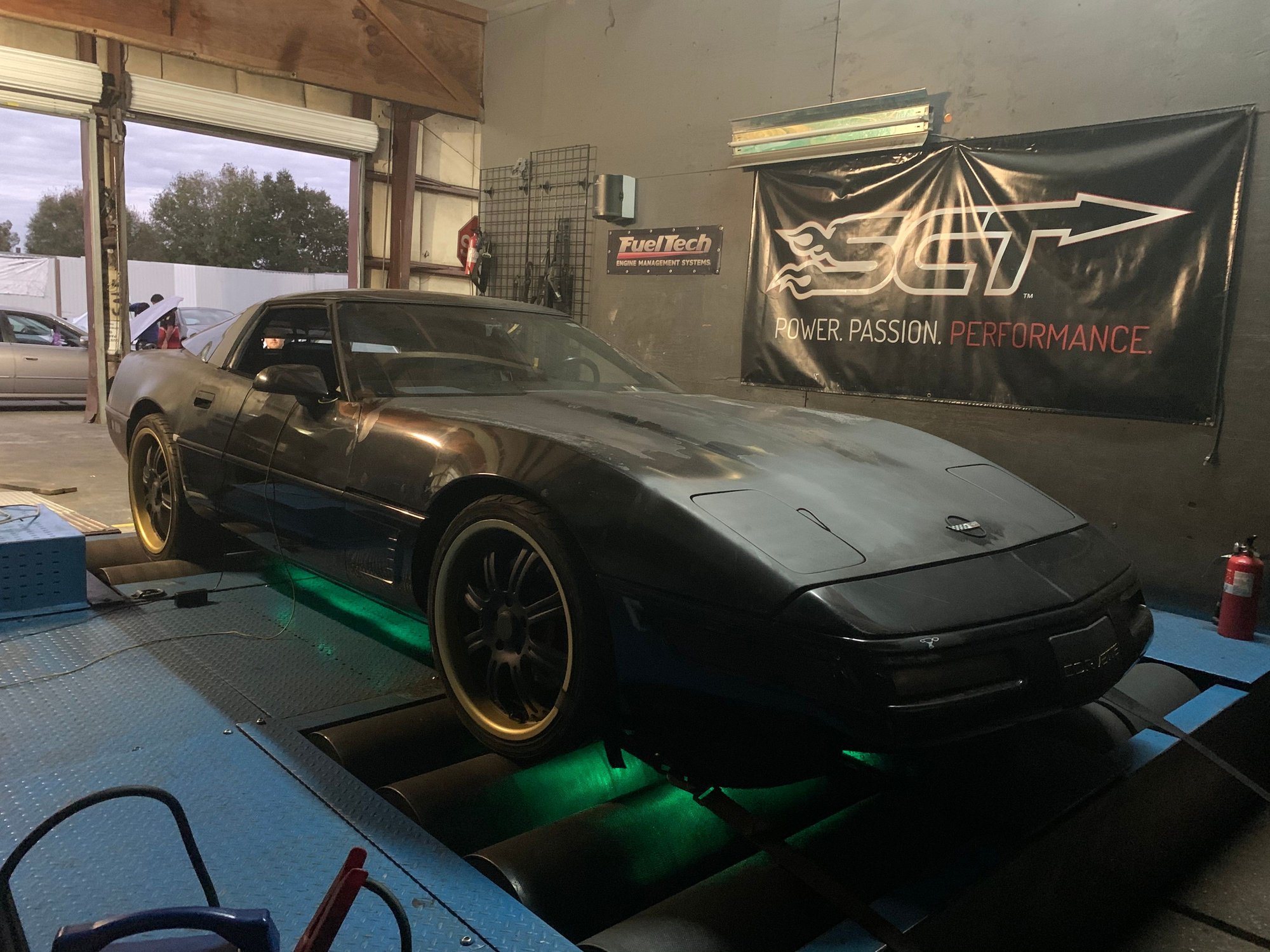

Well guys, the most recent update on BLK BETTE is an advanced tune and dyno sessions. I decided to spend a little extra money to get the stock lq4 dialed in as best it can be. I found a dyno (Mustang Dyno) here in Orlando and a tuner who seemed passionate about my project. So I spent 4 hours on Friday night getting this baby right. Wow, thank goodness I did. The AFR was wayyyy off. I was running catastrophically lean, glad I never punched the throttle. I had the wrong injectors programmed into the ECU. We did 3 test tunes/runs to get the mapping perfect. This gave me a pull of 230hp at the wheels. Next, we decided to start advancing the timing. We got to 24 degrees before the knock sensors started acting up. In order to go anymore I will need to remove my catalytic converter, which I plan on doing next. So we ended the day at 24 degrees with 250hp and 269 torque. Remember, this is bone stock. This is a great starting point in my opinion. And the next step is learning which Addams will help and how much they’ll help.
One thing we discussed is what is limiting the motor as it sits and as we advance the setup. I’m using stock c5 manifolds which he believes is restricting the motor. The other issue is the intake air temperature. On the dyno we were sitting at 200 degrees with the hood open and under some stress, it was about 70 degrees outside air temp. So I still need to figure out a way to get cold air into the motor. And being an 84 is making it difficult to be something simple.

1. never use knock sensors to tell you what the timing should be, unreliable and dangerous
2. LS engines do not use alot of timing, 24* is about maximum you should ever use WOT in performance daily.
3. The iat is prob heat soaking, Doubt IAT is really near 200*F. I recommend relocating the IAT sensor to the cold pipe (after the air filter). And getting rid of MAF if you are using it.
Other things
A. The OEM manifolds are a restriction but they are also very beefy, solid thick cast construction so they retain heat (well insulated) which is IDEAL.
So, if you DO decide to install headers, make sure you wrap them and/or ceramic coat them. Everything in the exhaust system should be very well insulated to keep the heat out of the engine bay and trapped in the exhaust system. Add heat shields and blankets as necessary. Insulation is key to performance, hot exhaust flows with higher velocity and takes up more space, it will shoot to the tail-exit faster when it is warmer.
B. Yes remove the cat converter as a restriction
C. Keep a full length exhaust with 1 muffler and 1 resonator (or similar) Don't try to shorten the system and exit out the side or something, keep it going to the rear of the car
Once you get the exhaust and underhood heat sorted, and any basic external mods, the engine is crying for a cam/spring upgrade if you didn't do it yet.
In an old, re-used Truck engine, I will renew: lifters/pushrods/cam/spring/timing chain/oilpump/barbell/seals/gaskets
Obviously, never take apart the bottom end (crank/rods/pistons/etc...) leave those alone! You knew that....
This way the only thing that can really fail inside the engine is a cam bearing, or if you got a bad new part (a bad lifter or something right out of the box new)
Old Jan 24, 2021 | 03:57 PM

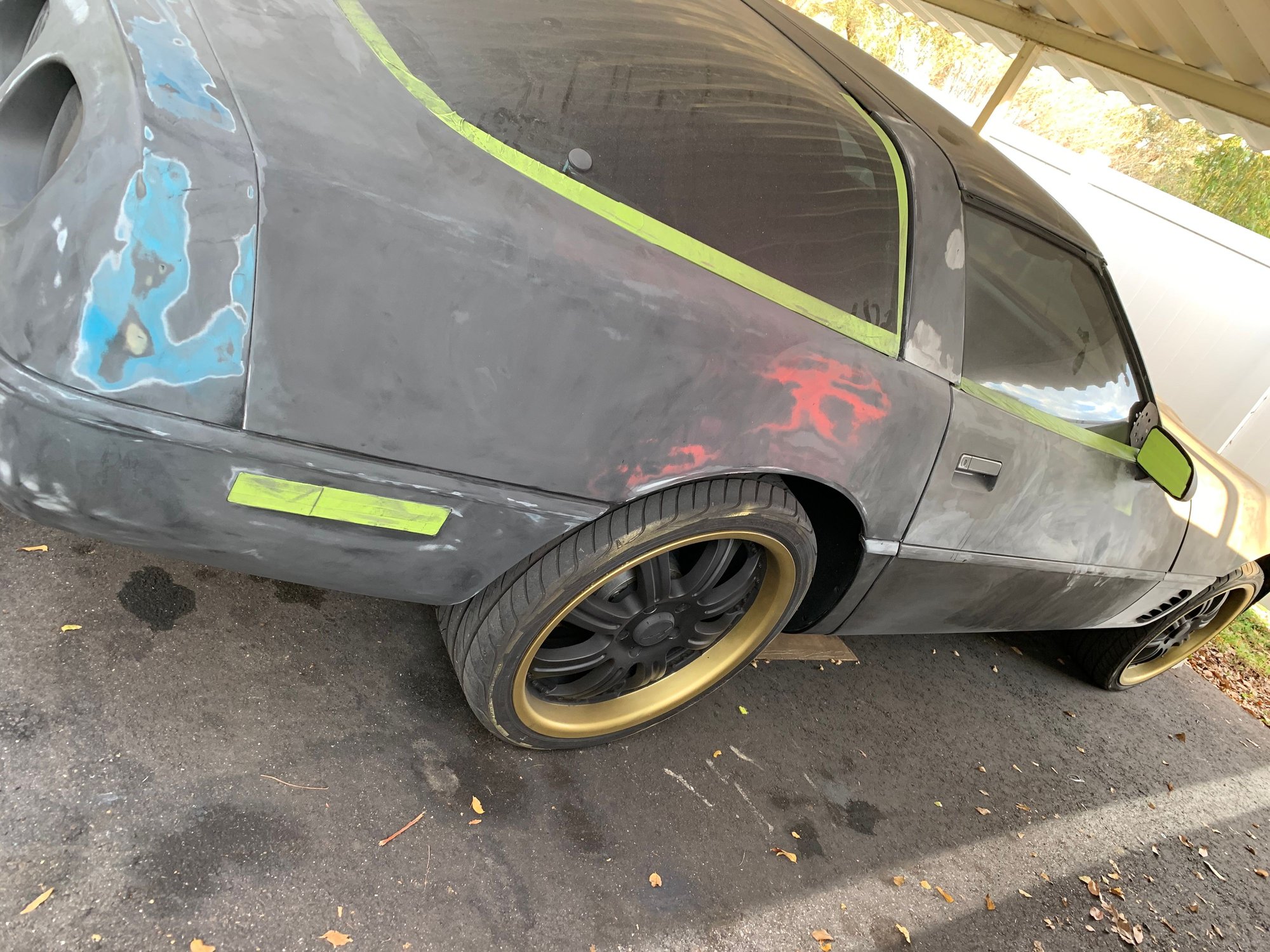

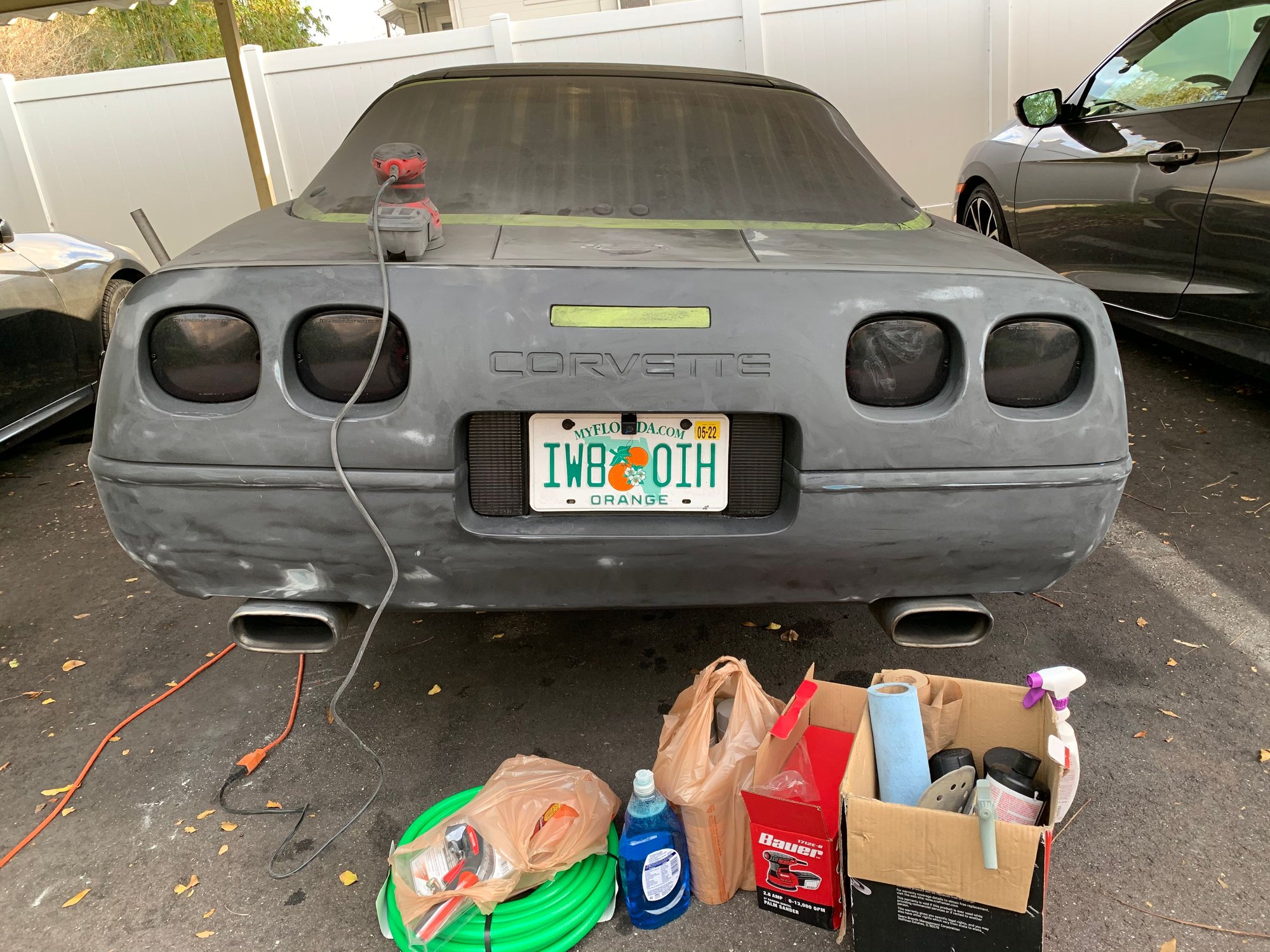

First, thanks for all the suggestions on performance addons! I will keep all the information gathered and use it down the road. I definitely want to get some miles on her first.
as for the next project...paint.
Wow! What a task. The car is like 50 shades of black right now. Clear peeling off everywhere, cracks in the bumpers, in need of some serious help. I drove around Orlando getting quotes for a paint job and my stomach dropped. Cheapest paint job was $4k, or $1k from Maaco. Lol. I seriously considered the Maaco paint job since this is no show quality car, it’s a beater. But after some thought I decided to try doing what I can myself. I have some friends who are painters and are willing to spray it for me for a few beers. I will just need to do all the other stuff and have the paint ready for them. So I spent 4 hours with a DA today sanding the car. I didn’t get very far. Had to take a break and go get some more sanding discs and wash off the massive amount of black dust on me.
I am sanding the car with 220 to cut all the clear off and get down to a workable surface. I will then sand again to 320 and once again with 400.
I am going to use rattle cans for the primer and then sand again with 400 before calling it ready for paint. Here is today’s mayhem...
I knew the car had different bumpers on it. The previous owner liked the later C4 body style. But I wasn’t prepared for a red fender...
Who wants to guess why there is a red fender on a black car? My guess...it’s been involved in a collision 💥 FML
