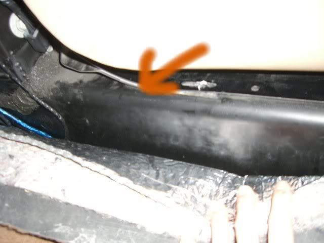

Ok Bill, I have a question on my leakage issue. I have a wet passenger footwell each time we get a heavy rain. I pulled and dried the carpet and had my buddy soak the outside passenger hood/door junction. Here are the pics of the location where the water is coming in:
The arrow shows the location of the leak:

Now, I noticed pooling of water between the two bottom rubber seals of the door. It seems to me that the innermost rubber seal on the bottom of the door is what is incompetent rather than not having the top door hinge sealed. I looked at my friend's C5 and his upper hinges aren't sealed either which I believe it is not supposed to be. Looks like the water can pass right through the hinge area then out the bottom and then if the inner door seal is intact, no water should come in.
My question is, should I replace my weather strip on my door (which looks ok to my eye) or just do your putty/RTV mod on the hinge area? I'm not confident that the putty will really do anything as water still will come in at the hood door junction and get between the 2 rubber door seals anyway. I suppose another cheap fix might be just to silcone up the seals real good 1st which I can do easily.
Thanks for your input!

BerryJ
I had the exact same issue. I sealed the door hinge with BLACK RTV. Just tape up any colored body stuff and fill in the voids until its flush with the tape and smooth with your finger. That area has been a problem in other C5's and sooner or later maybe yours. The RTV or PUTTY treatment is FREE and wont hurt.
You need to see if you can see where the water runs in from. You may need to remove the inner door panel to help find the location.
In the mean time there is a fool proof workaround. I have a ZO6 and my leak is beacuse of a bad drip rail/windshield header/roof panel seal. Its a BITCH and TIME CONSUMING to fix. I decided to just eliminate the water into the foot well using RTV to create a small dam on the door sill. Just run a thick TALL bead of RTV on the door sill and then install the door sill cover while its tackey, ( I put vasline on the door sill cover bottom side to prevent the RTV from sticking to it. ) It made a perfect dam and the water runs OUTSIDE instead of inside.
Hope this helps.
BC

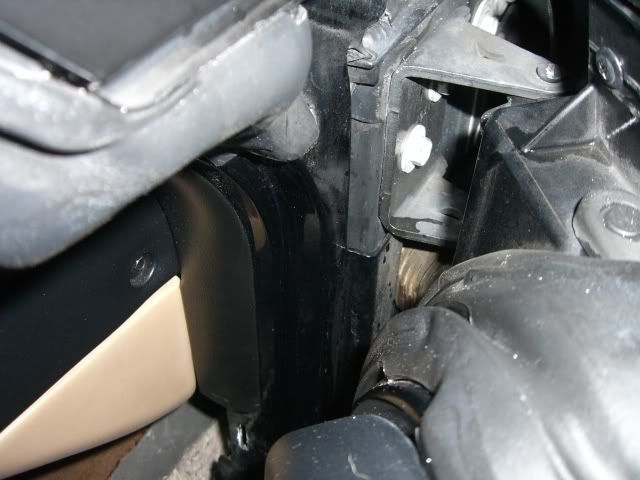

Is the air box drain a hard or soft tube? I just can't seem to reach it. Can the wiring be pulled away from the fire wall to get at the tube?
Old Sep 4, 2008 | 08:19 PM
  #75
Bill Curlee's Avatar
Bill Curlee
Joined: Dec 1999
Posts: 32,910
Likes: 2,402
From: Anthony TX
CI 6,7,8,9,11 Vet
St. Jude Donor '08
The HVAC drain tube that comes off the air box and sticks through the fire wall is hard plastic:
Theres a soft rubber 90 deg fitting that slips over top that plastic fitting:
The end of the fitting is crimped. Thats what normaly plugs up. I trimmed mine off.
You can reemove and install the fitting from the top. I have done it but you will leave DNA behind! If you DONT have headers, it's a snap to reach it from under the car.
From Below::
BC

Thanks Bill, No kidding on the DNA. It looks like a CSI crime scene. I wonder if I will lose points for blood under the hood. I will try to get it from underneath.

It was a lot easier getting the tube off from underneath. Of course it is now dry so I can't tell if it was clogged up. I haven't been able to get it back on yet. Either Big Larry needs taller ramps or lose some weight. It sure was easier crawling under cars when I was a skinny kid.
