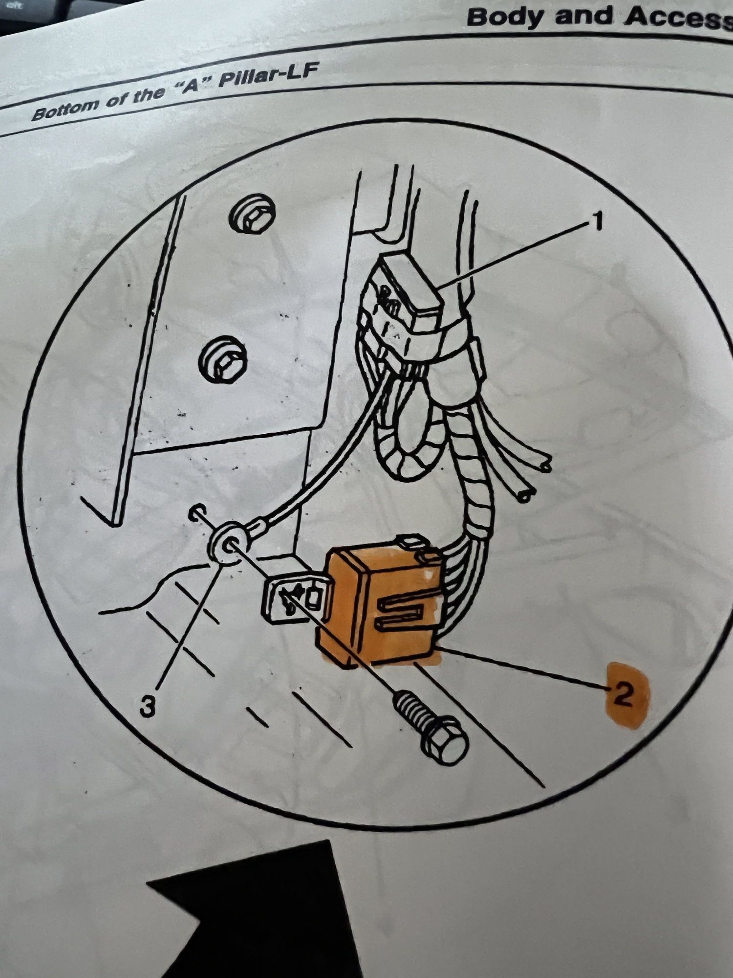

I can't find the grounding points on the drivers and passenger side footwell areas. Anybody got any photos of those?
Pictured is left side...right side similar !!
