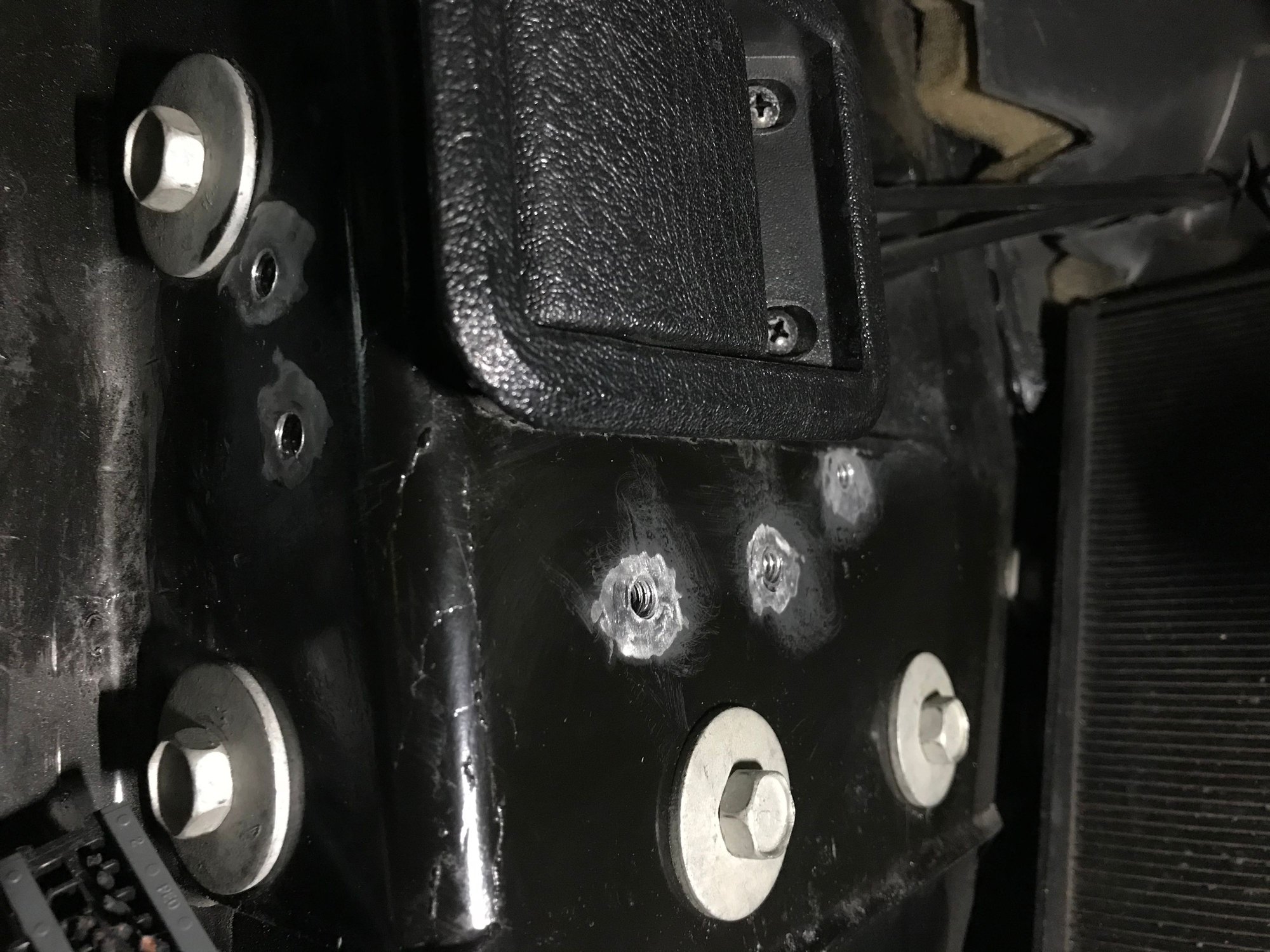

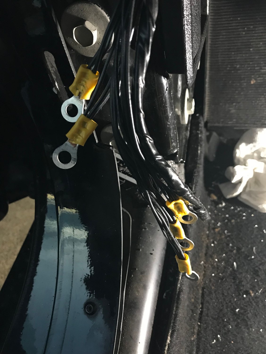

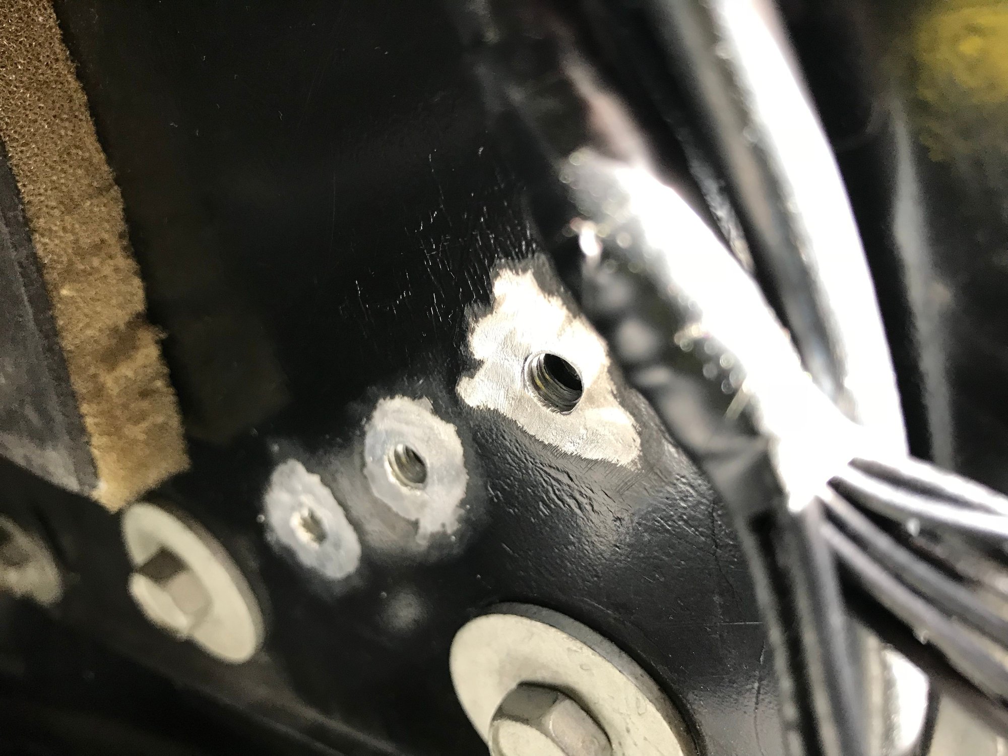

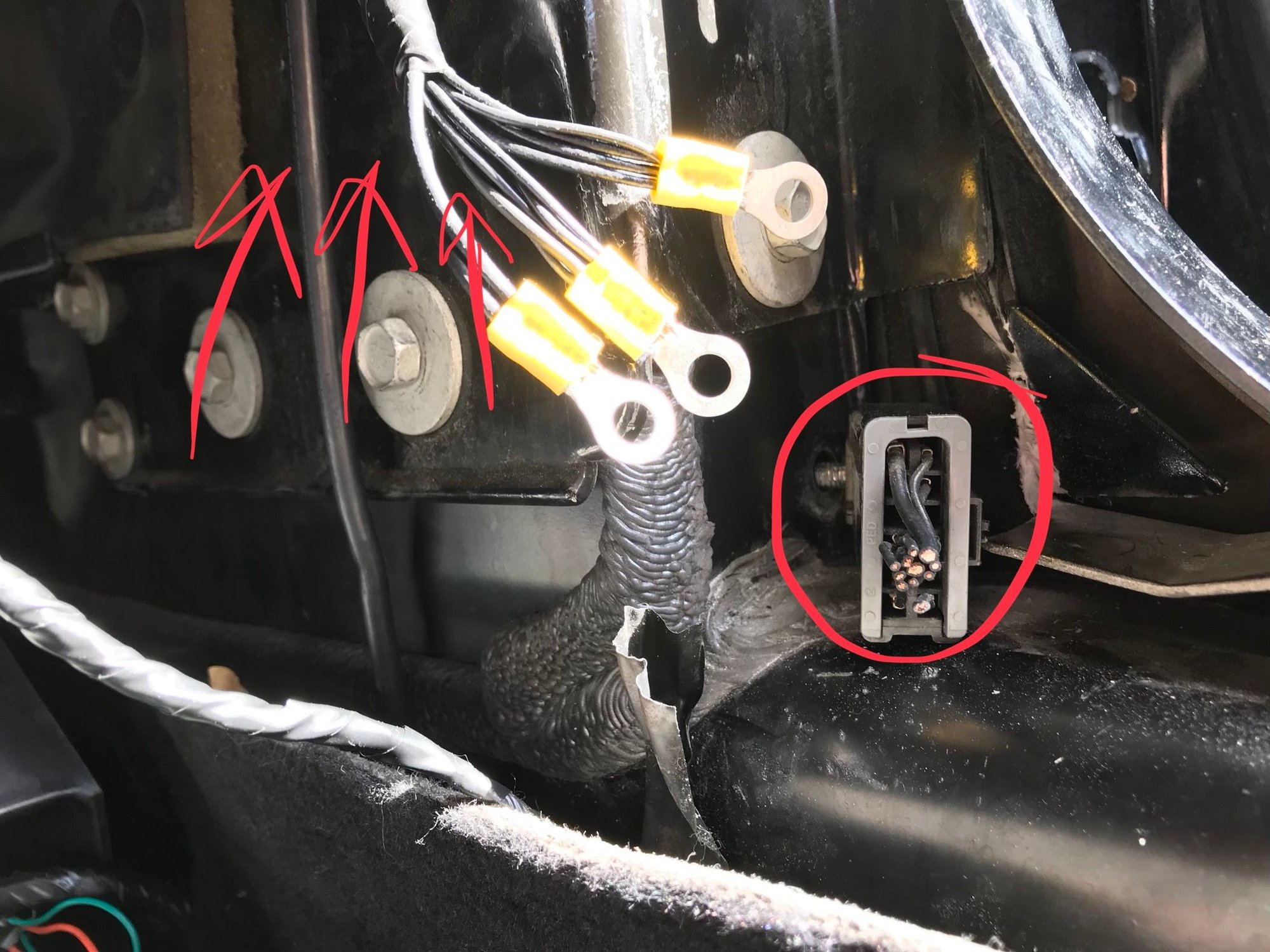

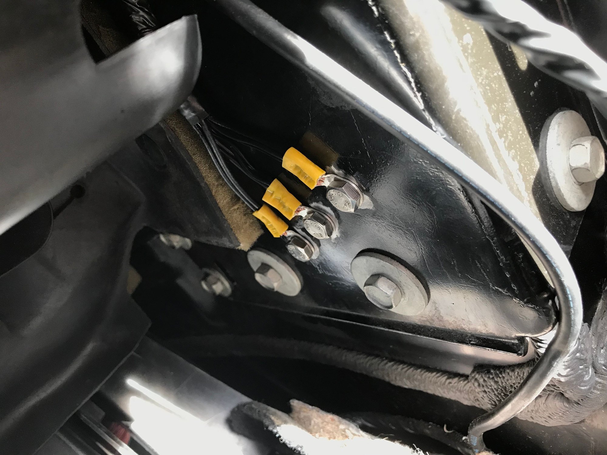

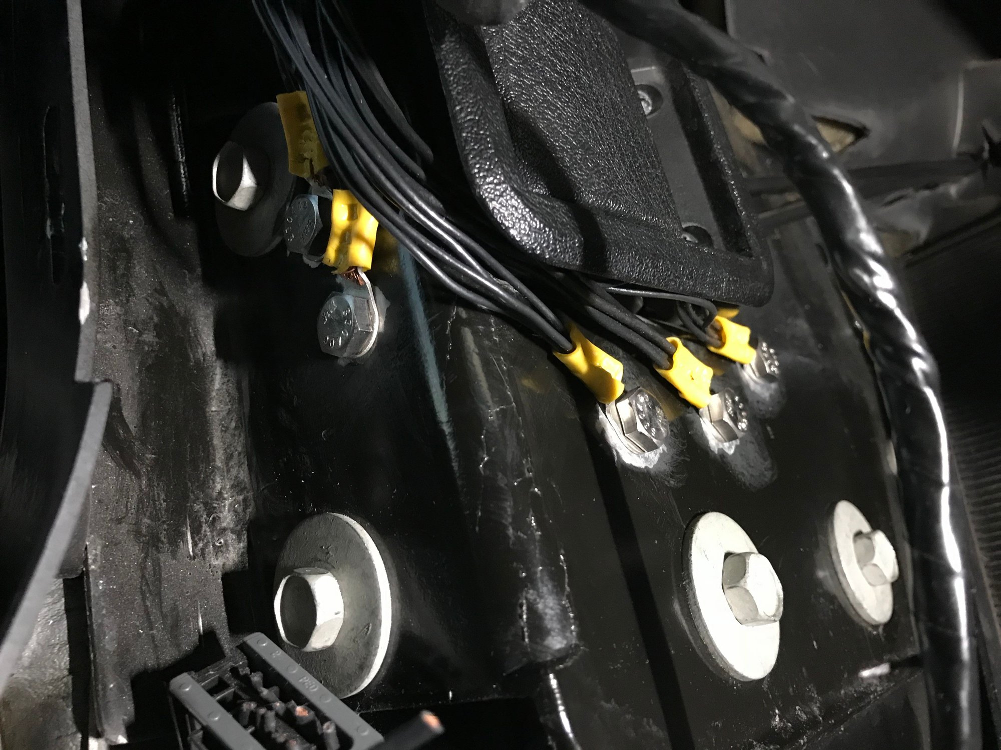

I spent the weekend finally going through and cleaning grounds. I’ve had a few persistent electrical issues with my stereo and bcm. Anyway I had a particularly hard time with G202, I broke the stud loose while trying to remove it. Bill’s comment regarding a GM tech who recommended cutting off the connector packs in favor of a terminal lug seemed reasonable so I cut the whole thing off, cleaned and organized the wires, drilled and tapped holes on another local metal surface and it seems to be working just fine. I did the same thing to G201 after as it looked like the previous owner hacked it up and I found a fried ground in there I had to cut back. Anyway, hope this helps someone who may have an issue getting G201 and G202 off, I can confirm this sufficiently worked for me
Nice job. Particularly the multiple holes, and that you went beyond just a self-tapping screw/bolt. Only thing I may have done different is to get copper ring connectors.
Thanks for posting all those pictures as well.

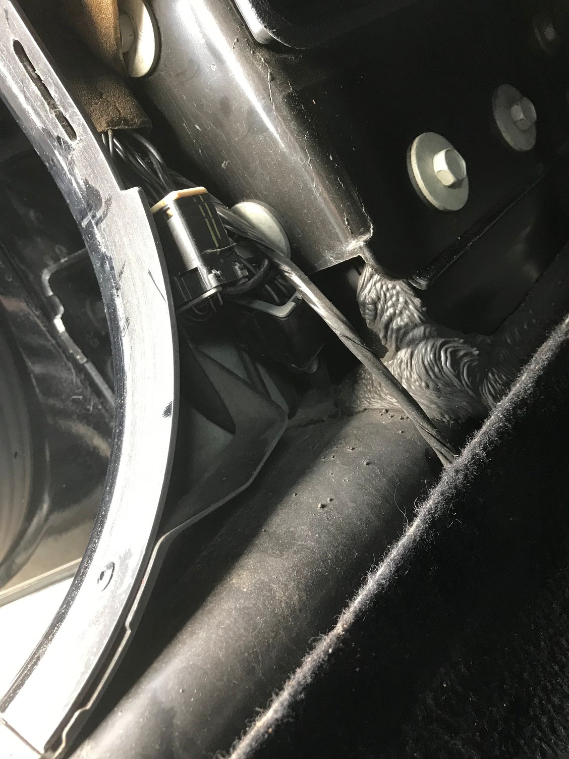

Originally Posted by Jacob Dobbs
Electrical issue and looking for any tips. Owned the car (99 FRC) just a few months and previous owner garaged it, I do not. I have a water leak that drips onto my foot on the dead pedal that I can only assume is coming from the windshield. In this leak just starting, the windshield wipers will sometimes operate at the low speed when switched off, and will increase speed with switch selection. Or, they just don't swipe, yet do not "lay down" into the holders as if they are off. Any tips or known issues with this? TIA.
You should start your OWN THREAD but,,, Your drain udders are CLOGGED!!! It will soon destroy the wiper computer/motor!!
The live under the wiper motor module on the drivers side windshield cowl well.
You can reach in and pop them out of the cowl well and clean them out:
Here is what usually comes out:

If there is enough water in the well, the water can leak into the cab through the wiring harness groment for the wiper motor/module in the well.
There have been a couple of cases where the body seam sealant seperated and allowed water in. I would pull the cowl cover and inspect that well and all that is in there that keeps the water OUT..
BC
lol @ bill, welcome to the forum. I discovered leaks the day after I got my c5 similar to yours. My advice: sit in the car while someone hoses around the windows and doors and see if you can observe where it’s coming from. Check for leaks along the weather strip that seals drivers side inner window glass surface along the A & B pillars-- water flows down from there into the footwell area or back behind the seat. You will find evidence of water trails when you get your head down in there and really look & feel around where water is collecting. There are several great threads here on solving water leaks look for the one guy with a torch red z06 and lots of pix, some can be fixed with little more than your time, goo gone, a blow dryer and some adhesive sealant. Good luck!! This forum can be difficult to quickly find the info we need-- the best we can do is keep threads and forums organized for ease of reference. Chances are though the info you are looking for is in here somewhere-- and if you find that it's not then start a thread and post some pics!
Thanks-- I'm proud of it. I had to make due with what I had in stock. It's my only car and I had already taken two Lyfts to replace hardware that I dropped under the battery tray replacing G104... and the auto parts store had nothing that would work either not even a weather pack connector that I could modify to function like the OEM ground packs
Anyway, I would have loved to use copper terminal lugs.. I may go back in there and cover the area with a silicone adhesive/sealant or dielectric to protect against corrosion because my car gets humid inside during the winter, the next few months will a good test of these grounds

You have a ZO6..
That makes the LEAK path isoltion X10 more difficult. Pull out the seat, carprt and plastic trim around the doors and get out that HOSE!! Pack a lunch and get in the car. Have someone start LOW and work the water flow UP.. Give the water time to flow where it needs to to get in before the hose guy move the flow UP.
You will soon fine the leak path. I PRAY it isnt the roof gutter/windshield/roof joint seal. What a pain in the *** to fix/ reseal!
Bill

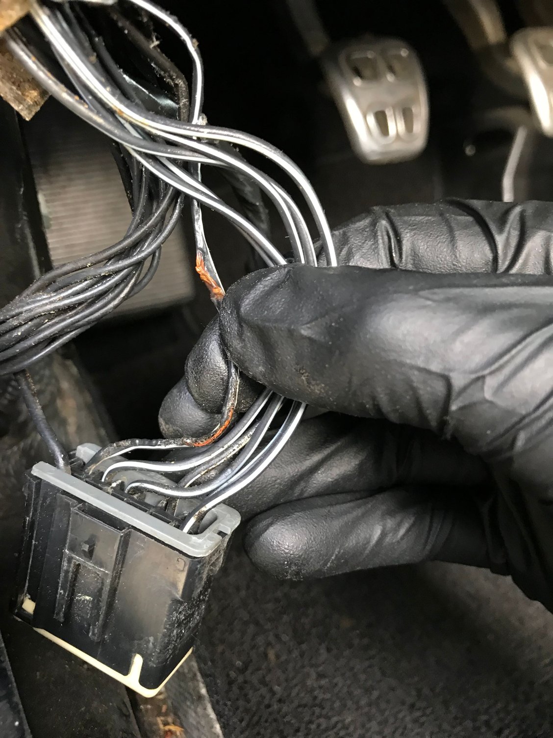

Thanks for the reminder Bill. I remember reading about the door connector somewhere in the last 90+ pages of this thread.
My driver door does not always respond with the fob to unlock so that connector is next on my list to inspect.
