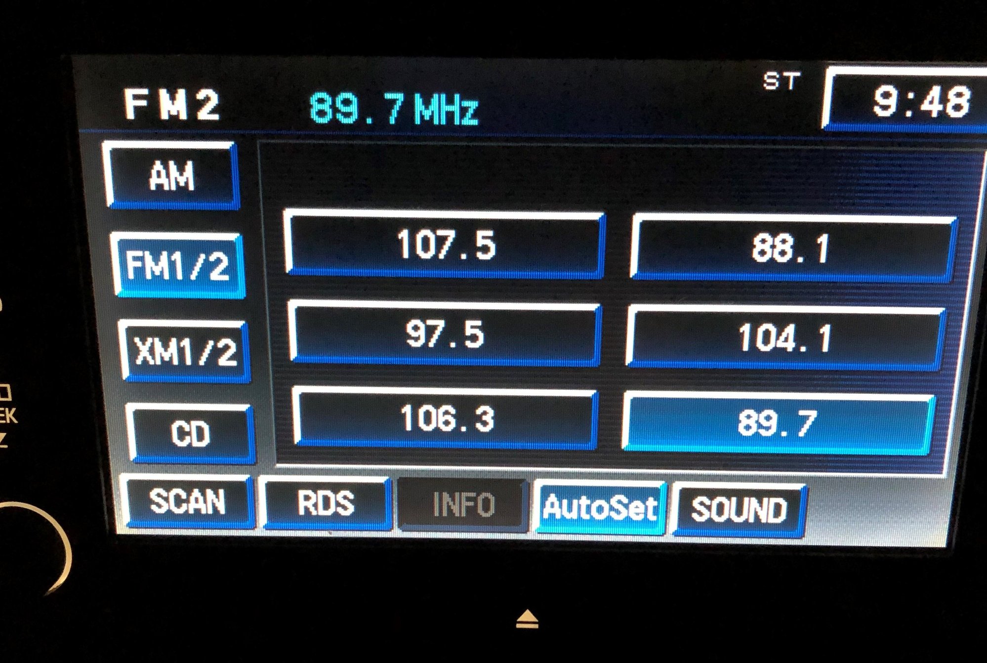

I just did it and it works perfectly. My 2008's battery wouldn't start the car last week and again this week so I got a new Yellow top. I pulled the battery earlier and went to get the new one. I did this as I was on here yesterday checking battery options and happened to see the title of this post. I did not read it then and thought it was already tried and true, read it today and decided to go for it and as I said it worked perfectly.
Step 3.5
One thing not in the instructions is that when you insert the software update disc, close the screen back up and then the screen says "Not a map DVD" just ignore it and it will do it's thing.

The Windows 10 issue is REAL! I've been using computers since 1981 - a Radio Shack TRS 80 that I programmed every time I used it with a cassette deck. I was beginning to think that I had lost my mind.
I thought I had the disc burned using Windows 10 three times. I even checked the disc and the file showed that it had burned. I kept getting the same error message that Kenny had been getting. I had all but given up until I scrolled down this page to see if anyone else had this problem and saw 4SUMERZ's post.
I downloaded Nero Express. I then followed 4SUMERZ's instructions to the letter. The disc burned, confirmed that it had burned, and I took the disc back out to my car (for the 4th time). I pulled the Map disc out, inserted the CD-R, and presto - worked like a charm. I now have my clock back. Thanks 4SUMERZ!!!

Worked for me! I used my Windows 10 laptop and Windows Explorer to extract the zip file and to burn the CD-R. I burned at 10x speed (the slowest one). It feels like it's still 2007!
Thank you to all who made this happen.
