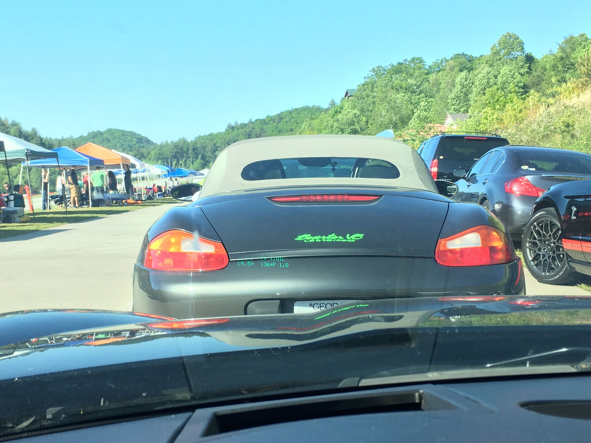

Anyone know how to ad a degree symbol after IAT and knock retard values?

* symbol (shift+8)
Have to do advanced config or whatever it's called, not the basic/easy one

Yeah, I tried several ways.
KNR {1001}° no good
KNR {1001}* no go
KNR {1001°} not

I'll look at mine when I get home--I thought that's how I did it but maybe it didn't work and I just didn't notice?

Yeah, that works on mine. * though not the ° symbol.
You can barely see it in the HUD in this picture after 19.5 and 136. Not sure if DIC is the same. I doubt the real degree symbol works.

I entered this: Spk{13}* IAT{15}* no go.
Then I entered this: Spk {13}* IAT{15}* It worked .
Thanks for the reply. I'm good to go.

Control Config. Utility.
I discovered if I left 1 space before the text, I got no error message.
If I started the text at the left boarder, I got the error.
All is good now.
