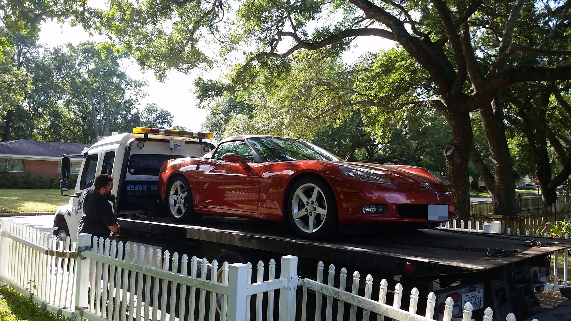

Got Corvette back, parked in driveway, opened garage door, now the gear selector moves but I AIN'T GOT NO GEARS! Shift cable, which they said was "just fine", apparently "just broke". Sending flatbed to pick it up now. Crap.

The latest: Flat-bedded the C6 back to shop at closing time, off-loaded directly into a Corvette bay for first attack this AM, then got a ride home with my service rep and BOTH of us forgot about leaving the fob at shop. Oy! Shuttle driver came back to get it this AM so the tech could get back into it and diagnose. Well, as Gomer would say, "Surprise, surprise, surprise!" Yep, shifter cable was broken. $500 job. They knew I was unhappy, so service rep (who drove me home last night since the shuttle driver had already left for the day) said, "We'll do it for $211 to address your time and headaches", which I thought was appropriate, "...and of course we will pay for the towing from your house back to shop." That's a DUH to me, but welcomed.
When I first climbed in to drive it home the first time yesterday, I could tell it also had a new shift ****, because the button in it had been a tiny bit loose and would occasionally rattle annoyingly, which I usually fixed temporarily with a toothpick or small cardboard piece. There is a separate piece from a number of yrs ago on forum about how to remove the button and stretch the spring a little to remediate that, but it's feels solid with the new one and I like that.
In retrospect, I would be about $1000 richer if I had had the cojones to attempt the DIY fix you guys have described so well above, but I am not that confident in my ability to not break something else along the way, lol, which is what often happens when I think "Oh, I can surely do -that-."
So right now I am waiting for the call that it is finished and ready to pick up. But I think since this issue may well pop up again, I am going to ask my brother-in-law if can help me go the DIY route when I visit him soon. He's a retired nuke engineer and former prez of NCRS, pretty much a mech genius around cars.
Thanks everyone for the help and communication, and yes, the General should fix the stupid problem with NEW materials and components, but...
