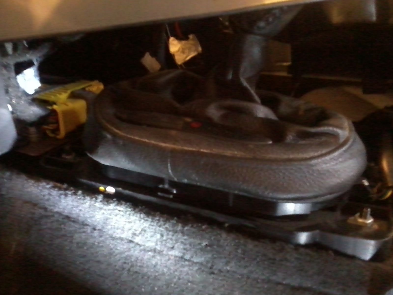

Sorry for the questions, I just do not want to brake anything. I have the console lifted. How does the plastic ring lift that holds has the boot attached. I went back to the original pictures that were posted. But I can not tell if it snaps off, or do I have to take off the bolts?
If you are asking how the leather boot lifts upward, the boot uses an integral elastic band at the very bottom. Gently pry it outward and upward. But be careful of the plastic shift indicator panel on top of the left side of the boot. A circular orange plastic male tab inserts into the bottom side of the indicator panel underneath the boot. Once the boot is loosened all the way around the shifter module, carefully rotate the left side of the boot bottom upward to disengage the male tab from the female hole underneath the indicator panel mechanism which is lighted as you will remember. It can be carelessly broken.
If I remember correctly, the plastic ring underneath the boot simply has a press tab on each end (front and rear) to disengage to lift the plastic ring itself. I lifted the leather boot separately from the plastic ring when I did my own fix. With the boot rotated upward out of the way, the plastic tabs are more easily spotted and unclipped.
If you look at my post (#18 on this thread)
I explain with pictures how to release the shift boot clips.
From my post:
there are (2 prong) release clips located on the shifter boot housing (one towards the dash side and the other towards the center console side). To release these clips, you need to pinch the tabs together while pulling up on the shift boot at the same time.

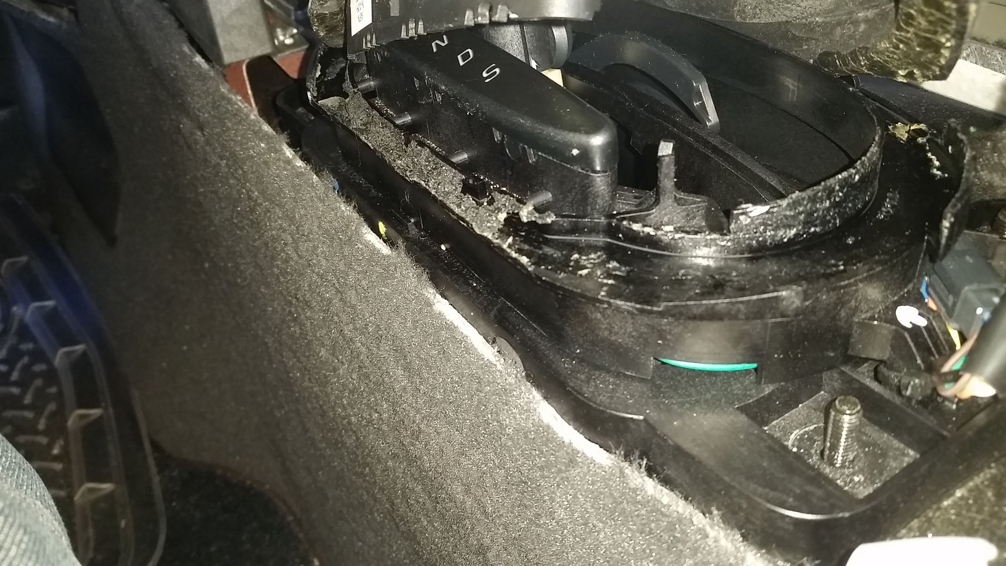

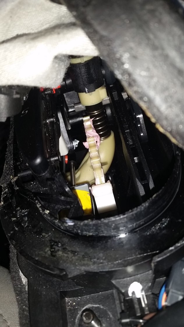

After working on this for 4 hours, I got everything apart except for the actual shifter. I have a 2009 auto and took the console out partially like in the post. I removed the boot around the shifter but could not get close to the part that locks the shifter in park. I could reach it with my finger but did not look anything like your pictures that were posted here. I will try to add the pics of what I had apart. Now I have put it all back and need a new battery.

Originally Posted by Badda Bing
After working on this for 4 hours, I got everything apart except for the actual shifter. I have a 2009 auto and took the console out partially like in the post. I removed the boot around the shifter but could not get close to the part that locks the shifter in park. I could reach it with my finger but did not look anything like your pictures that were posted here. I will try to add the pics of what I had apart. Now I have put it all back and need a new battery.Attachment 48018950
Attachment 48018951
Attachment 48018952
Attachment 48018953
Your links don't work for me.
