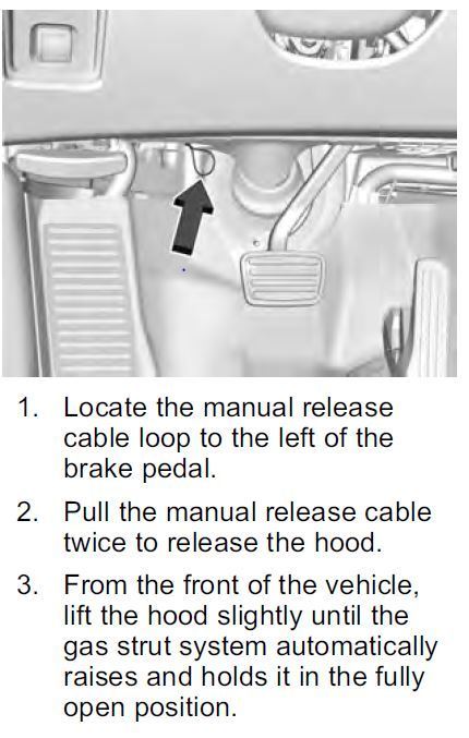

The emergency hood release button inside the front trunk only requires a push to open the front hood, so I am guessing the secondary mechanical release was left off because if there was an occupant locked in the front trunk the occupant would still be locked inside unless they knew how to release the secondary latch.
GM could install a secondary safety latch and program the emergency hood release button to release that as well, but if there is an electrical glitch somewhere (similar to what is happening to the poster above) you are still in the same situation....hood in windshield or flying off.
cwmobley, although remote, any chance you snagged the manual release for the front trunk release under the dash?

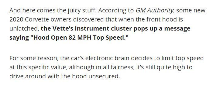

Assuming this is true, why the heck would you pick a max speed of 82 MPH???

Houston, we have a problem....
https://gmauthority.com/blog/2020/05...-is-unlatched/
Because they are engineers and the smartest ones. Maybe if they set it to 5mph it would have been better and forced action, but what do ordinary people know.
