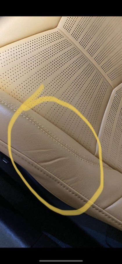

I agree, Something is Wrong with the seat
My thoughts,,
Bottom Seat Cushion Foam on the Leading Lower Vertical Edge,,,, installed improperly, Foam damaged or not placed properly, plus the Cushion appears to loose,, IE Hog Rings and Draw String issue.
The Wrinkles in the Seat Cushion appears to be a very poor section of Leather and the Seam Stitching leaves this section leather appear loose.
I've completed the Sloppy Seat Track Fix in a few C5's, mine was the first at 25k miles. Installing the UHMW washers, $2 at the hardware store, in the Worm Gear assembly. In the process of disassembly one has to untie and release the Draw String for the Bottom Seat Cushion, plus remove all of the Hog Rings so the Seat Cushion can be lifted up and off. It's PITA. Expect getting your hands all scratched up. But One does need to make sure that when replacing the bottom seat cushion that the Cushion Foam on the front edge is placed properly. More importunate is getting the Hog Rings installed so the cushion fits well and Draw String tight so the front of the seat cushion is in tension. My C5 Convert has 44k miles now, my sons' ZO6 25k miles, neither has issues with the lower seat cushion in this area. And the C5 seats are know to be no where near the quality of the C6 seats.. Getting the front edge to fit correctly on my first repair was difficult.
Still minor repairs considering the C8 is a complete redesign and now a mid engine, finally. Considering the Union Strike and start up, I'd say GM did quite well.

The seat wear is an ISSUE and not a problem,

The seats are shipped with the back folded forward. The torso bolster rubs in this location. I would just drive the car and let your butt fix it.
