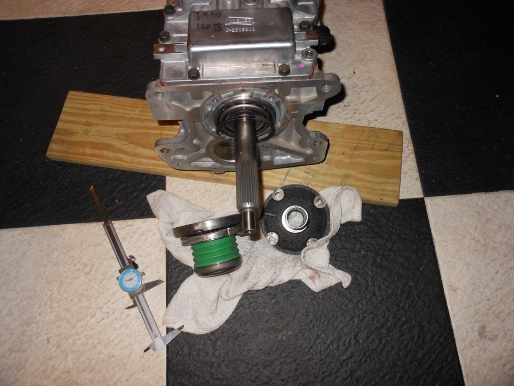

Thanks guys-
My first swap was when my brother and I put a Buick 215 ci Aluminum V8 in a Triumph TR7...Then I put one (Buick aluminum V8) in my BMW 78 320i...
Anyway- back to the build--
The Hyd Throw out was an old Keisler piece a buddy gave when he couldn't get it to work on his 66vette.
I measured and measured..and have come to the conclusion I will have to make a spacer right at a ½"- so I won't run out of throw to disengage the clutch.
I just happen to have a spare nose-input retainer from a Tremec and will just mill it down.
Next have to figure out and make up a hardline to the throwout bearing...Then it's time for the engine to go back in....

I researched all types of throwout bearings. The Mclead-Tilton-Quartermaster and others are shimmed -to give a 125-.200" air-gap between the bearing face and the clutch fingers.
There in lies the problem- as the clutch disc wears the fingers move out- or toward the bearing- and then could possible be in constant contact w/ the clutch fingers-wearing the bearing out as it is not designed for this. To correct requires transmission removal and re-shimming.
The other issue w/ the type of Hyd Throwout bearings is over extension resulting leaking- if not set up properly. Most of them do not have a stop on them- supposedly the new Mclead has one now- just google "McLeod Hydraulic Throwout Bearing Trouble" and you will see pages of forum talk about it. Or just ask the guys a Summit about the returns on them!!!
The Keisler piece is just like the OEM designs- is spring loaded and is designed for constant contact w/ the clutch fingers. Set up properly will never need adjustment- even as the disc wears.
The only issue w/ the Keisler design was bleeding- but I have redesigned/replaced the ss rubber line w/ a hardline like was used on later models and hopefully solve any issues.
I will test BEFORE I drop the engine and trans back in the car.
I stopped by my buddy's machine shop today and milled down the nose to make a spacer. Measured several times and it looks like it is the right size.
Richard

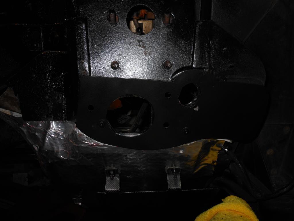

I beefed up the firewall for the Hyd Clutch set up-
