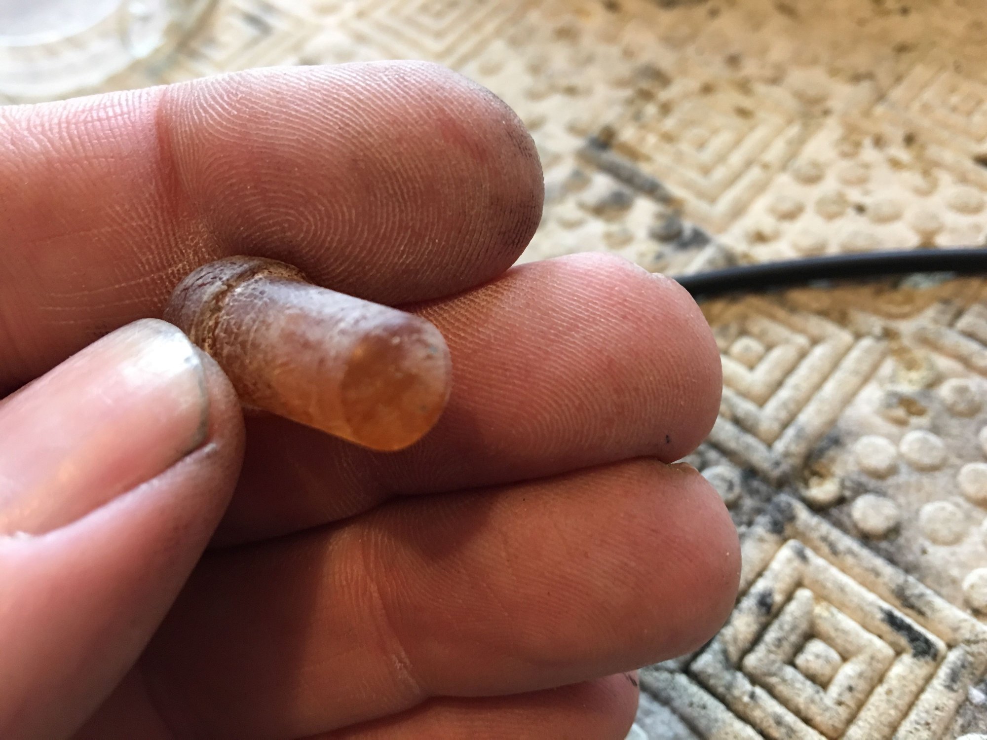

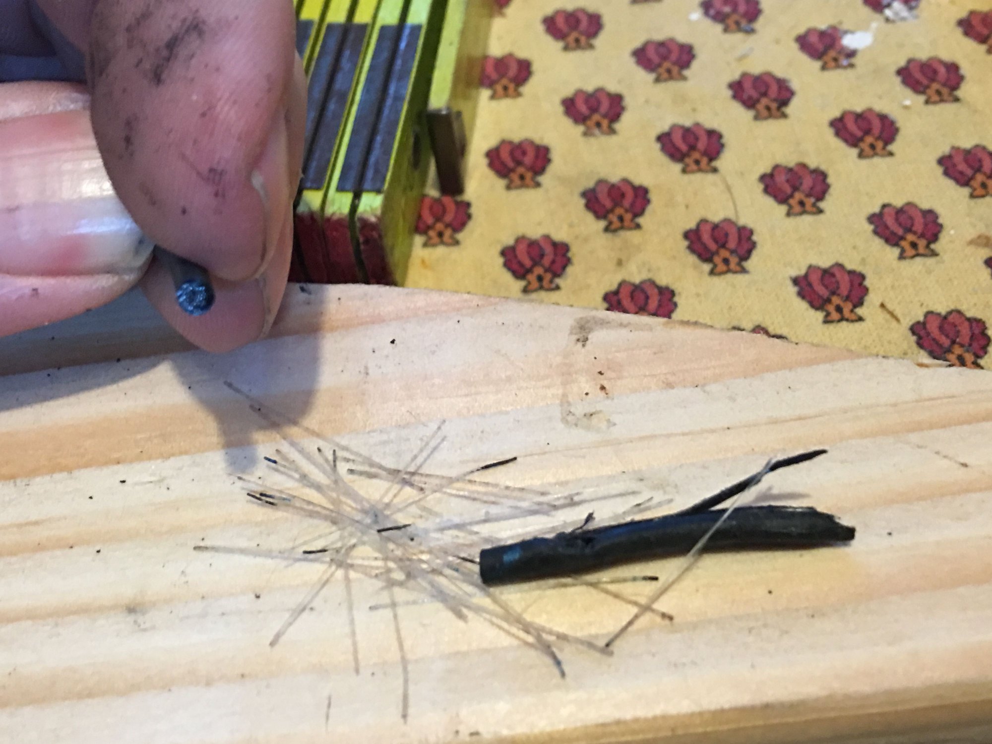

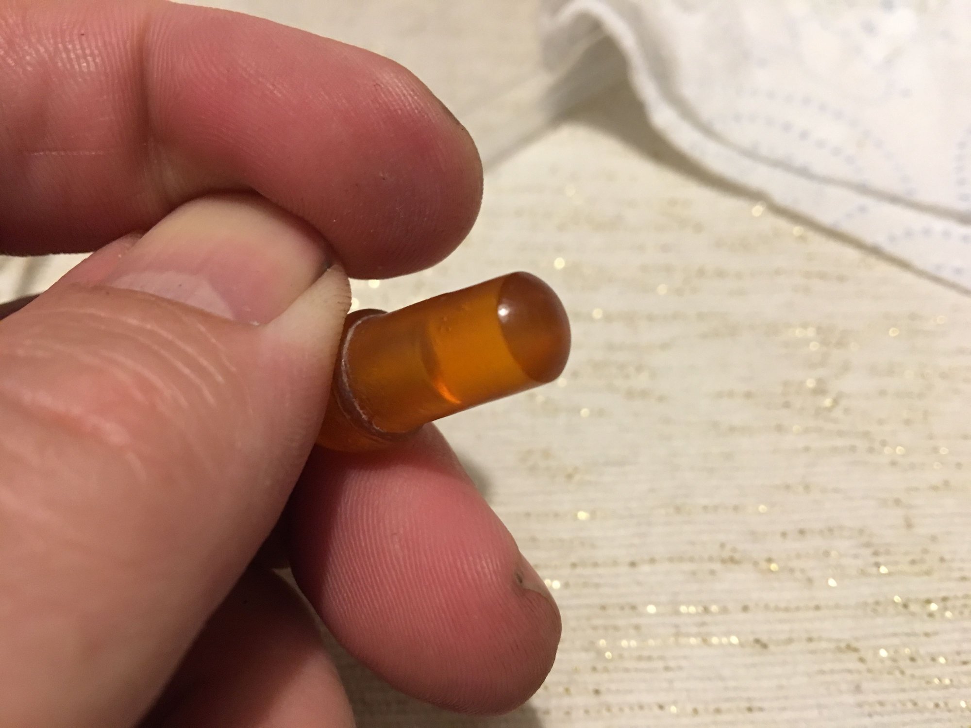

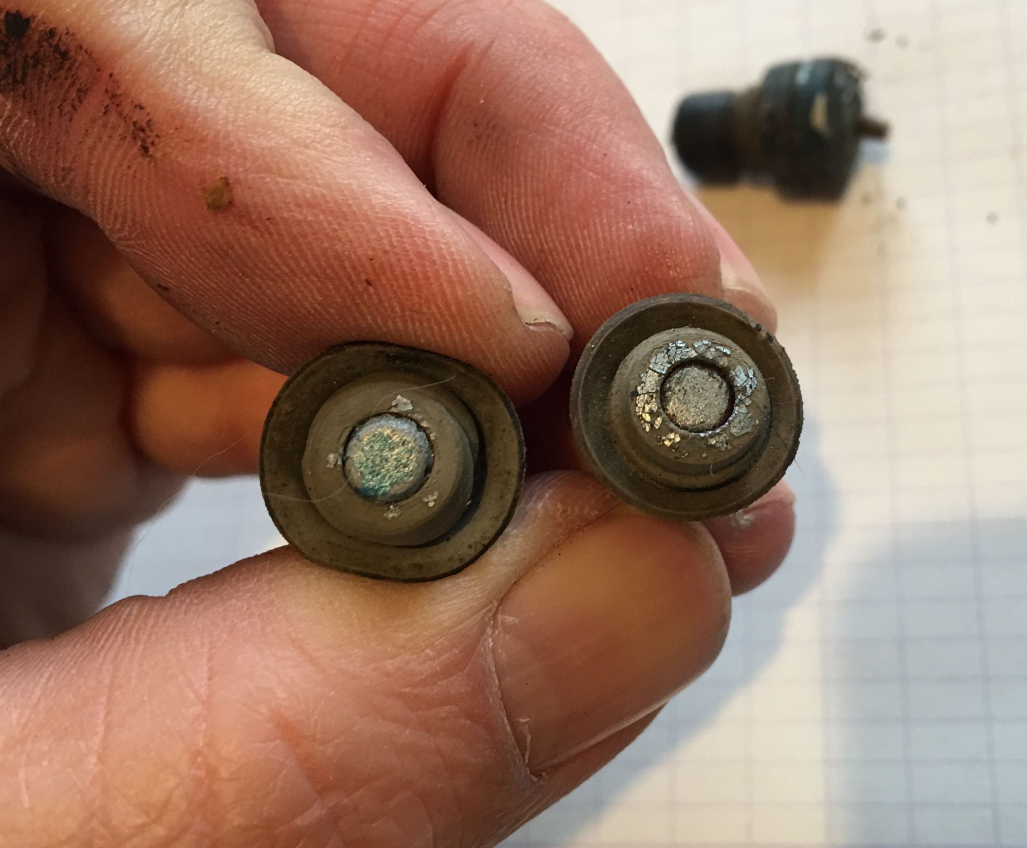

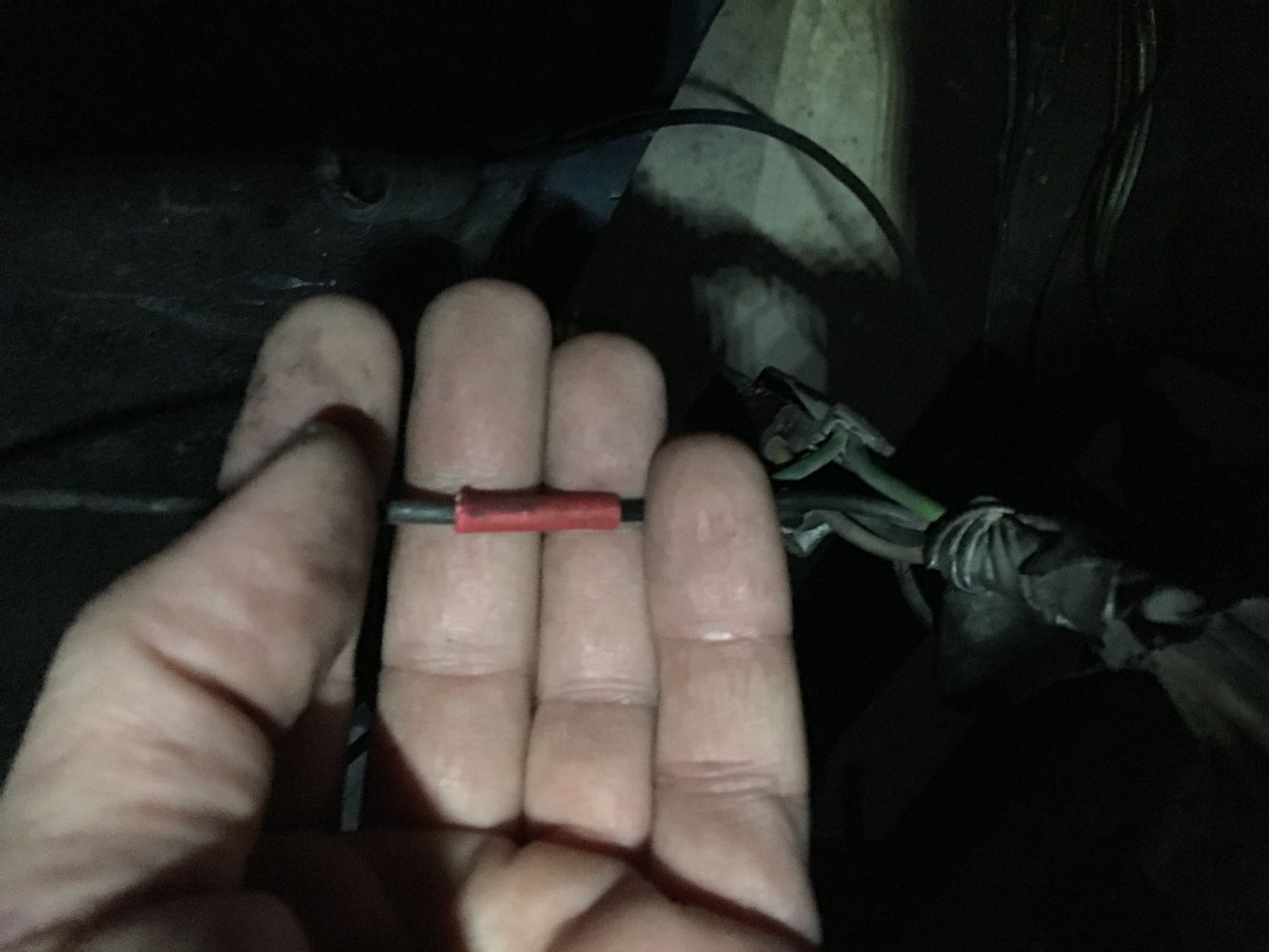

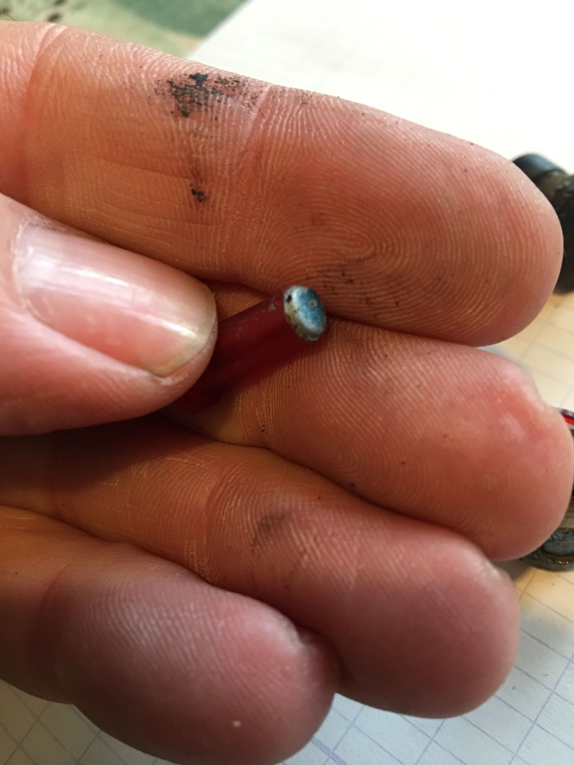

So I went through the fiber optics. Cleaned the ends and shined a light trough them. The front ones all seemed to work except for one.
It turns out, concealed under some electric tape again, the fiber optic was pinched.
I read somewhere that a fellow here would fix these things on the assembly line in 1970 with some wire sheath with copper removed. So I tried that out... I hollowed our the thickest wire I had in my parts bin. I cut the ends square and moistened (use your imagination) and joined in the hollowed our sheath. It worked very well. Thank problem now is that it’s somewhat brighter than the others

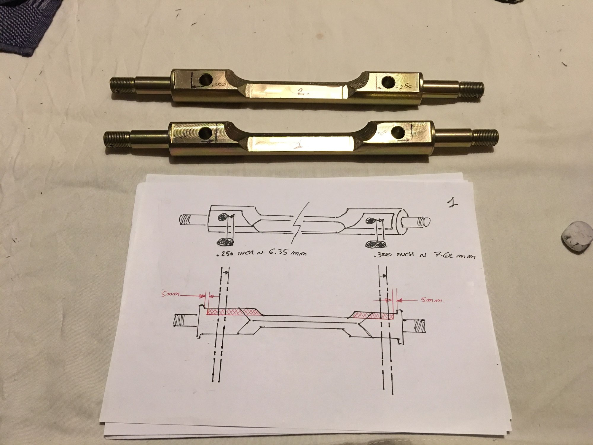

Cross shafts to be sent to the machine shop tomorrow to be “slotted” in pursuit of increased caster.

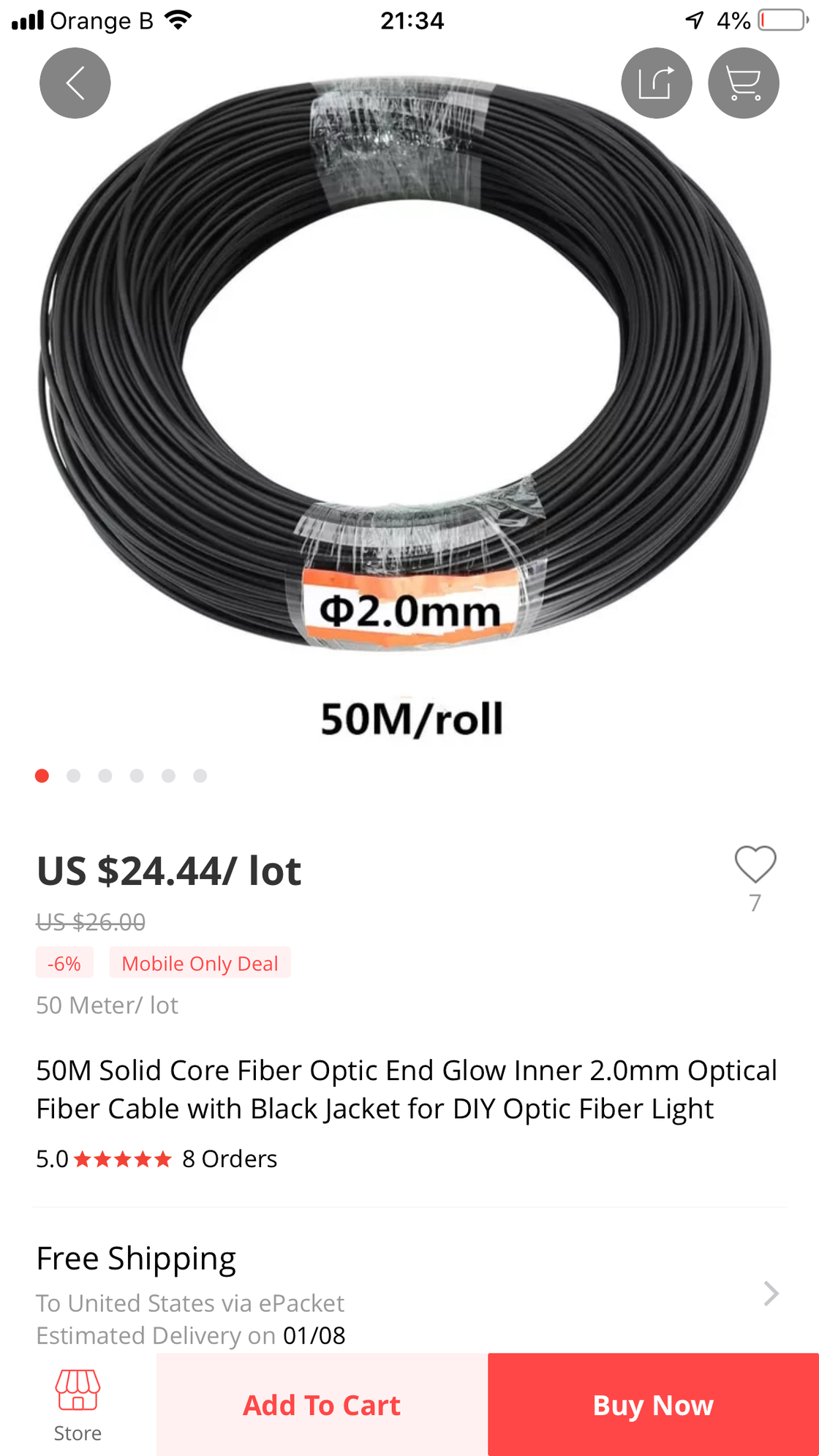

And my first ever Alibaba order. Solid core end glow fiber optic cable. This is a bit of a Hail Mary, but at $26 for 50 meters, it seems like a good gamble.

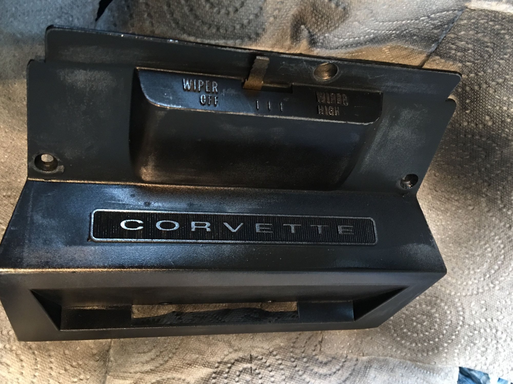

Still stripping the paint off of the interior panels on my quest to right a terrible dye job. For memory: the dye is on way too thick filling in the grain and flaking off in some spots. It’s also way too dark.
I’m refining the process of stripping off the paint. I ruined so far only the parking brake console. The vinyl is holding up all right to the stripper. The parking brake console is the only panel so far not to have vinyl covering.

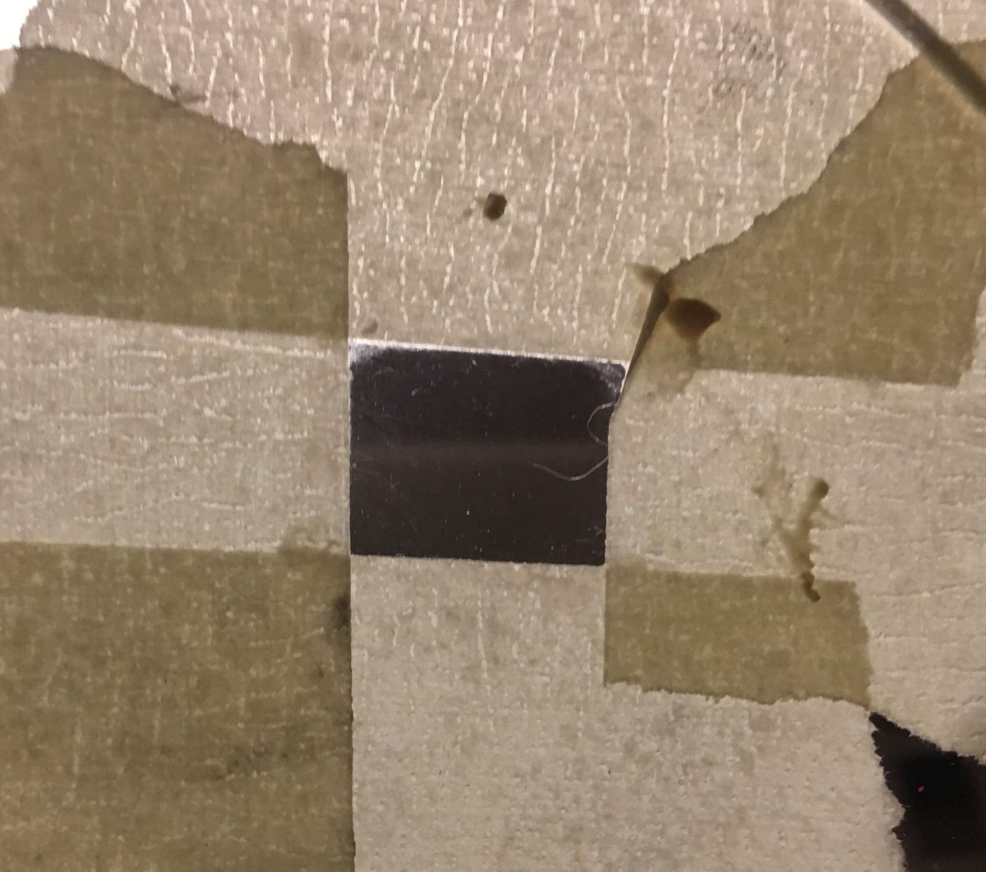

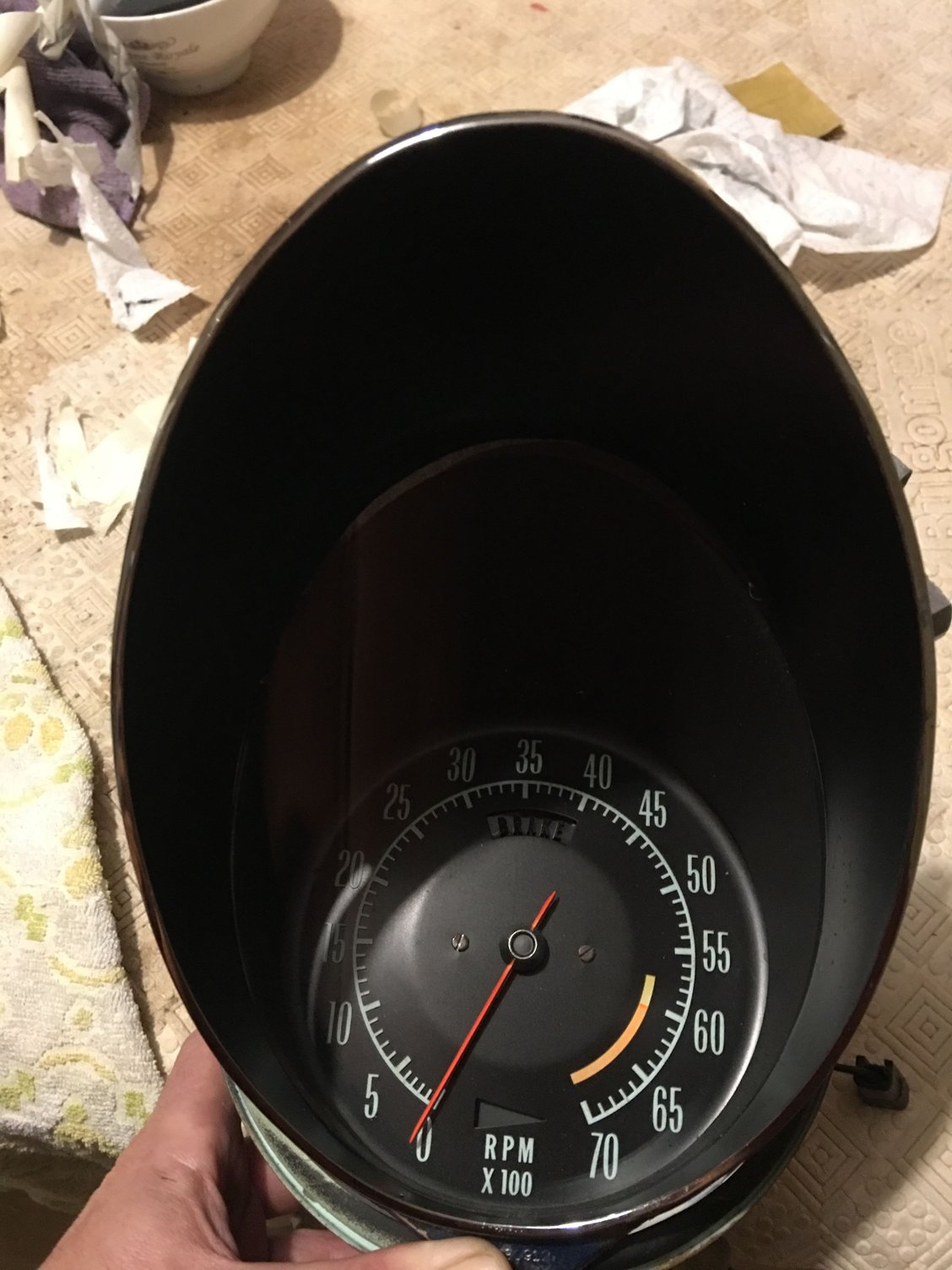

Today I took on my speedo/tacho rash. Carefully sanding, masking and painting.
Wet sanded with 180 and 220.
Masking tape peeled off but still some razor tidying to be done. #pleased

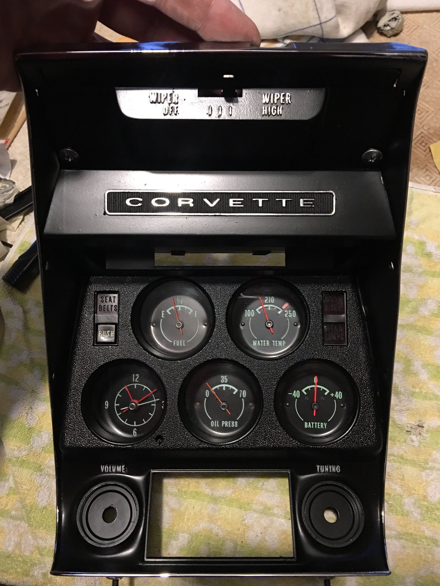

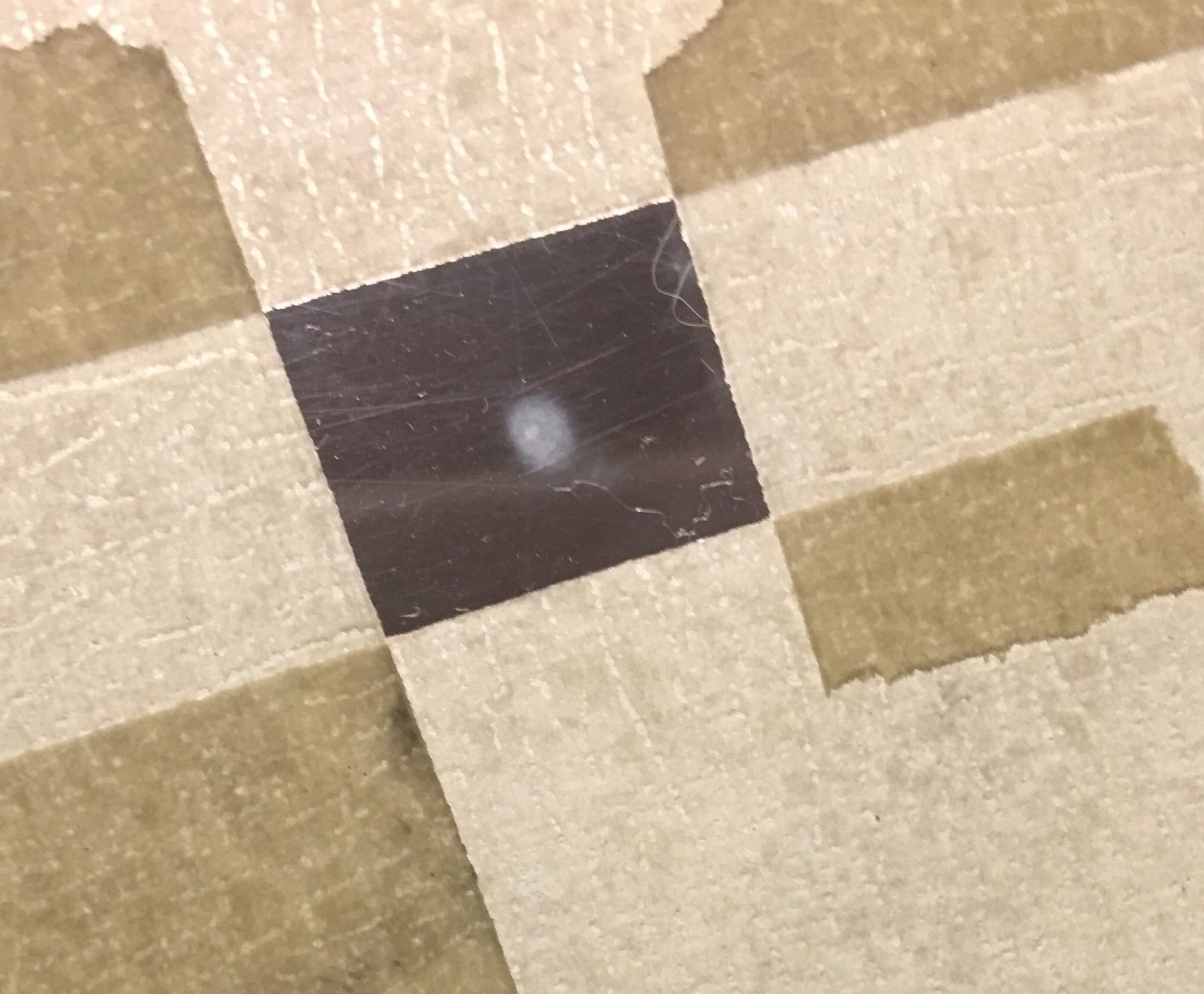

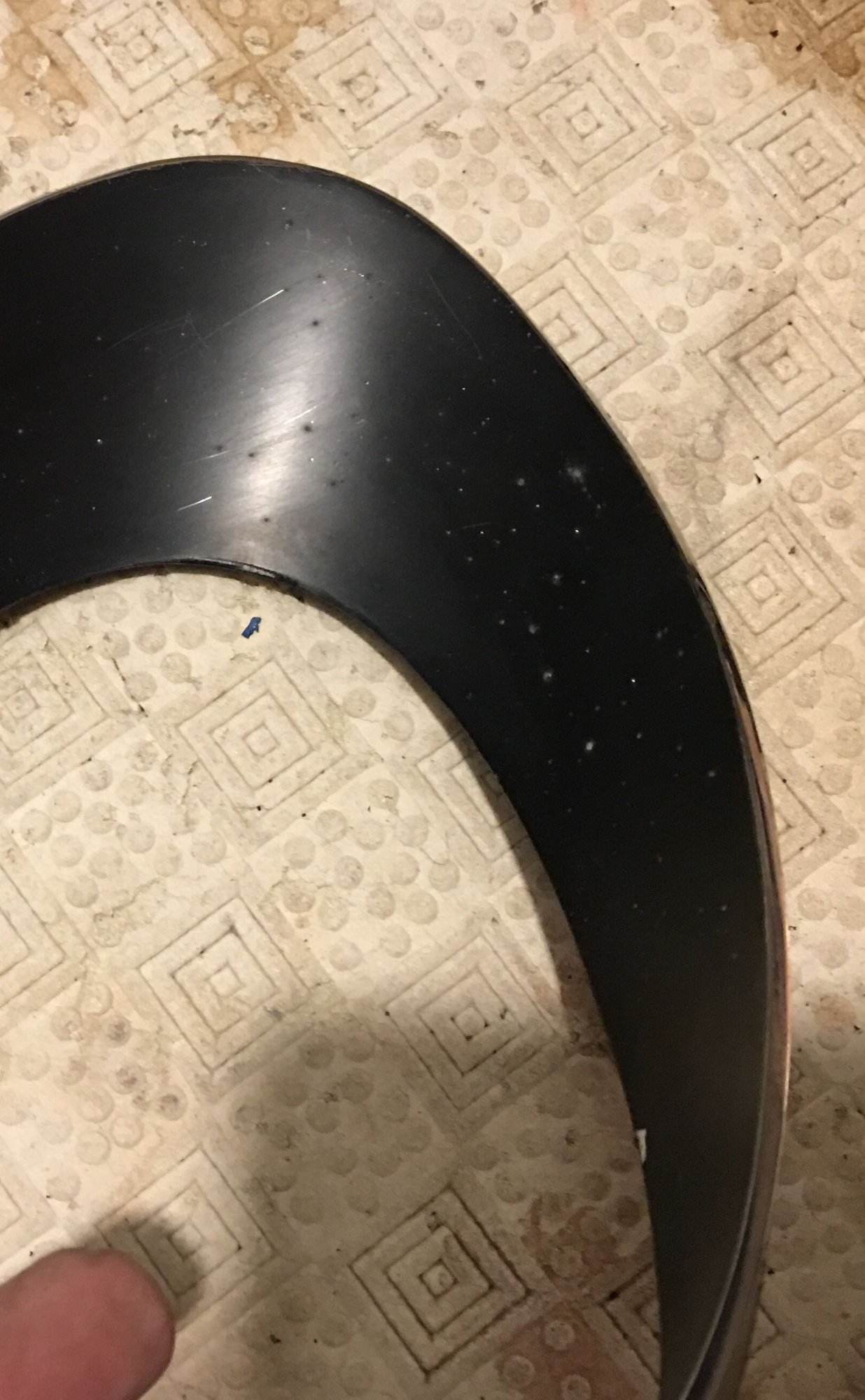

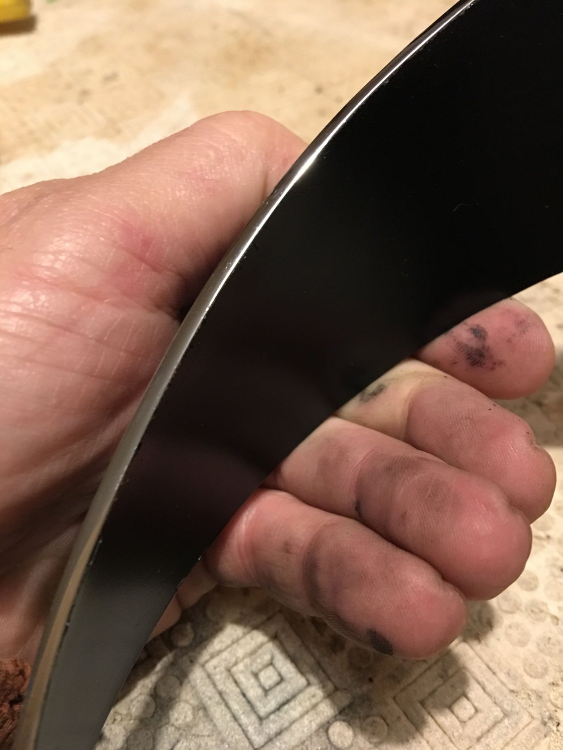

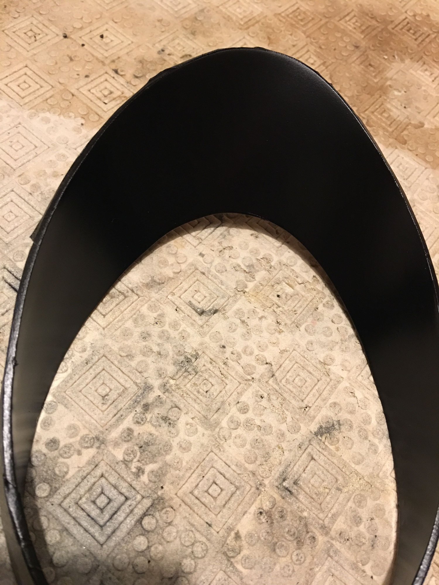

Let’s get a closer look at that lens. It almost looks like there is some mold on it. Let’s narrow in a bit on a spot and see if Meguiar’s Scratch X and a terry cloth will improve things or ruin...
It seems safe enough to work... let’s try polishing the entire lens. The other lens even seems to have some overspray on it.
45 min later...
#PleasedAgain

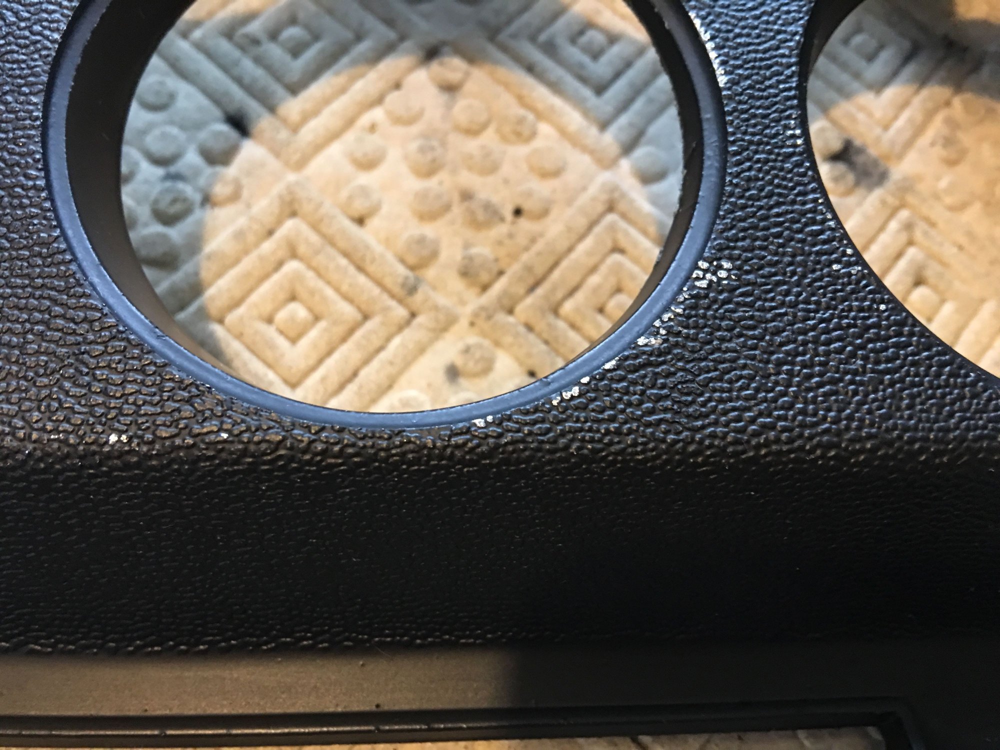

Still stripping paint. Sometimes I wonder if it was dyed dark blue, black... or if it’s that and gunk.
This is the dash pad. It looks caked on... whatever “it” is.

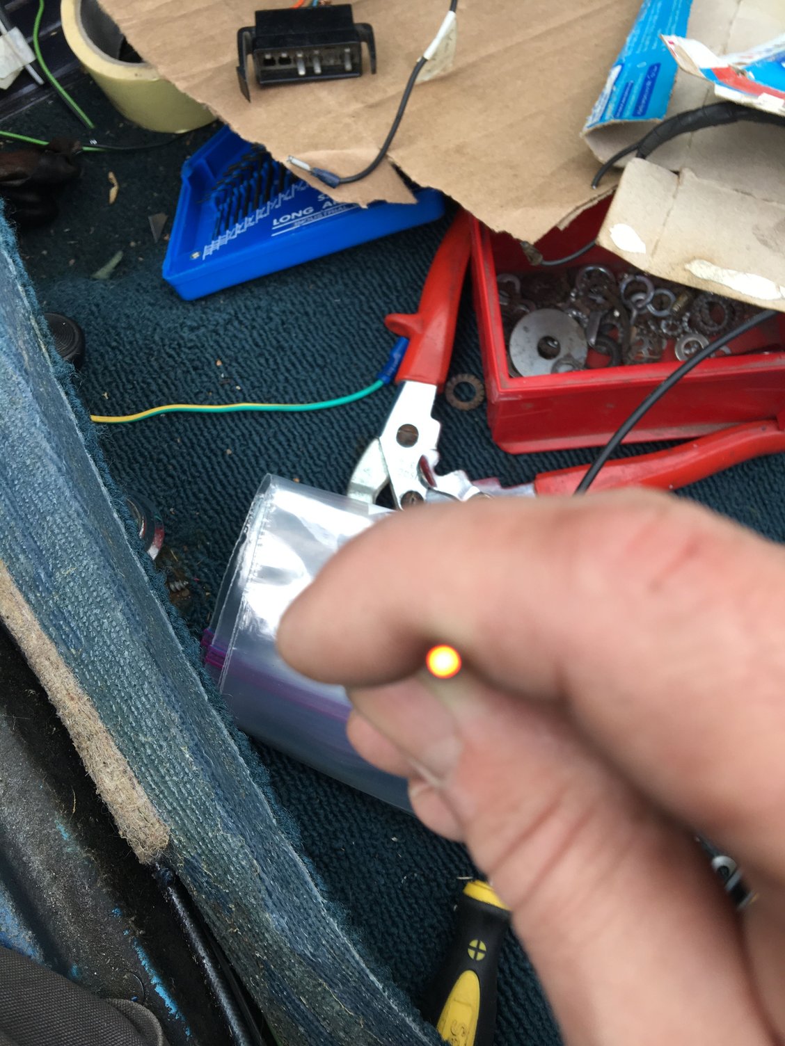

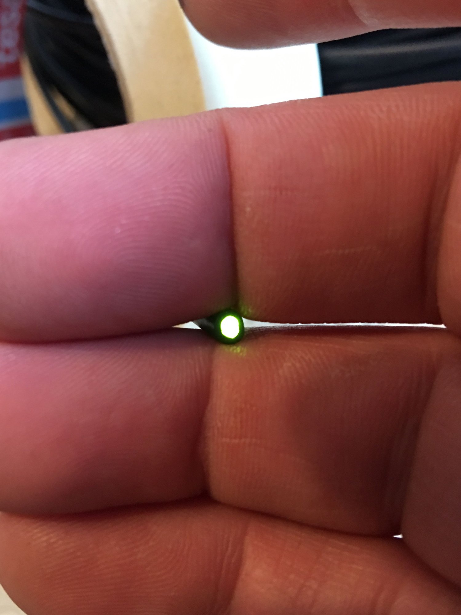

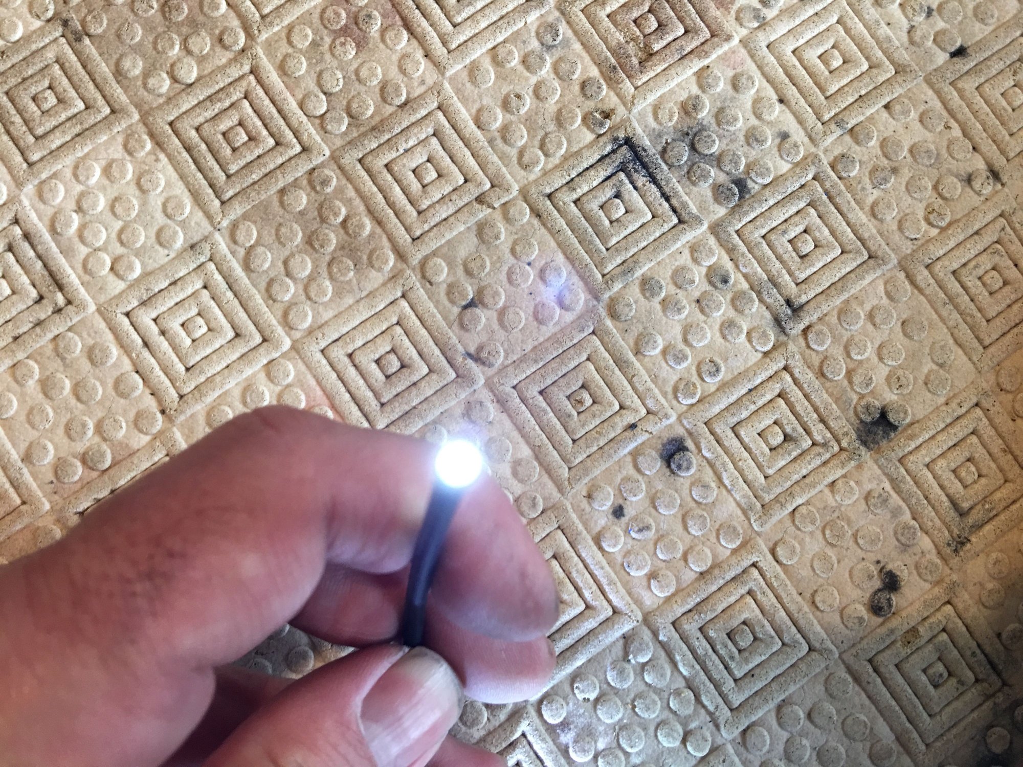

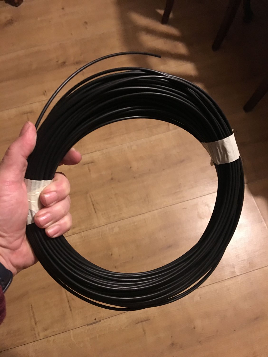

Yay. The fiber optic line (2mm core, 3mm OD, end glow, 50 meters) came in and it seems promising. This is my first order from Alibaba, China.
I shined some light through one end and it came out the other brightly if green. Over 50 meters, that has got to be some kind of attenuation.
Over a shorter distance it’s brighter and as white as the LED source.
Old Dec 31, 2018 | 03:49 PM

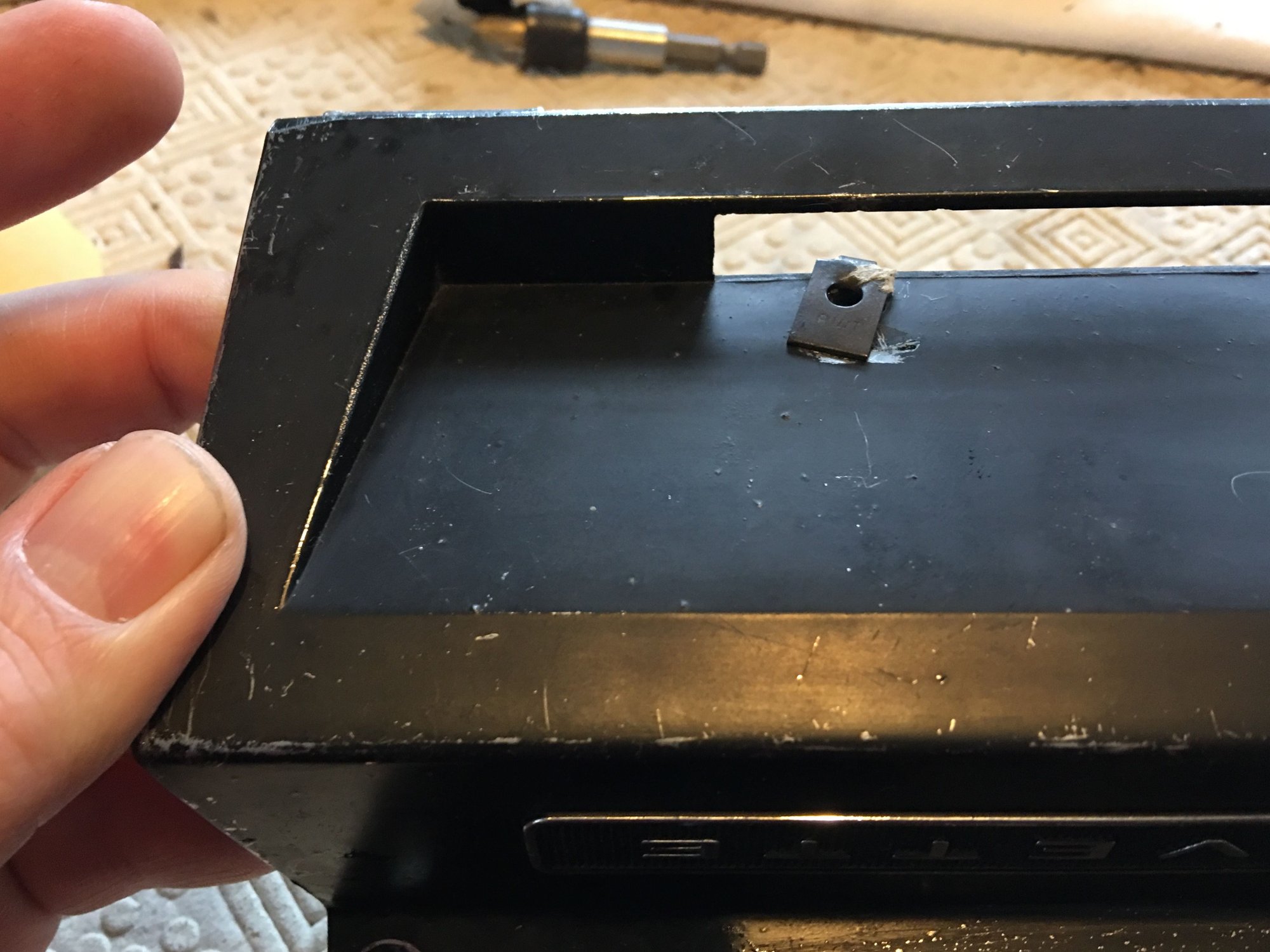

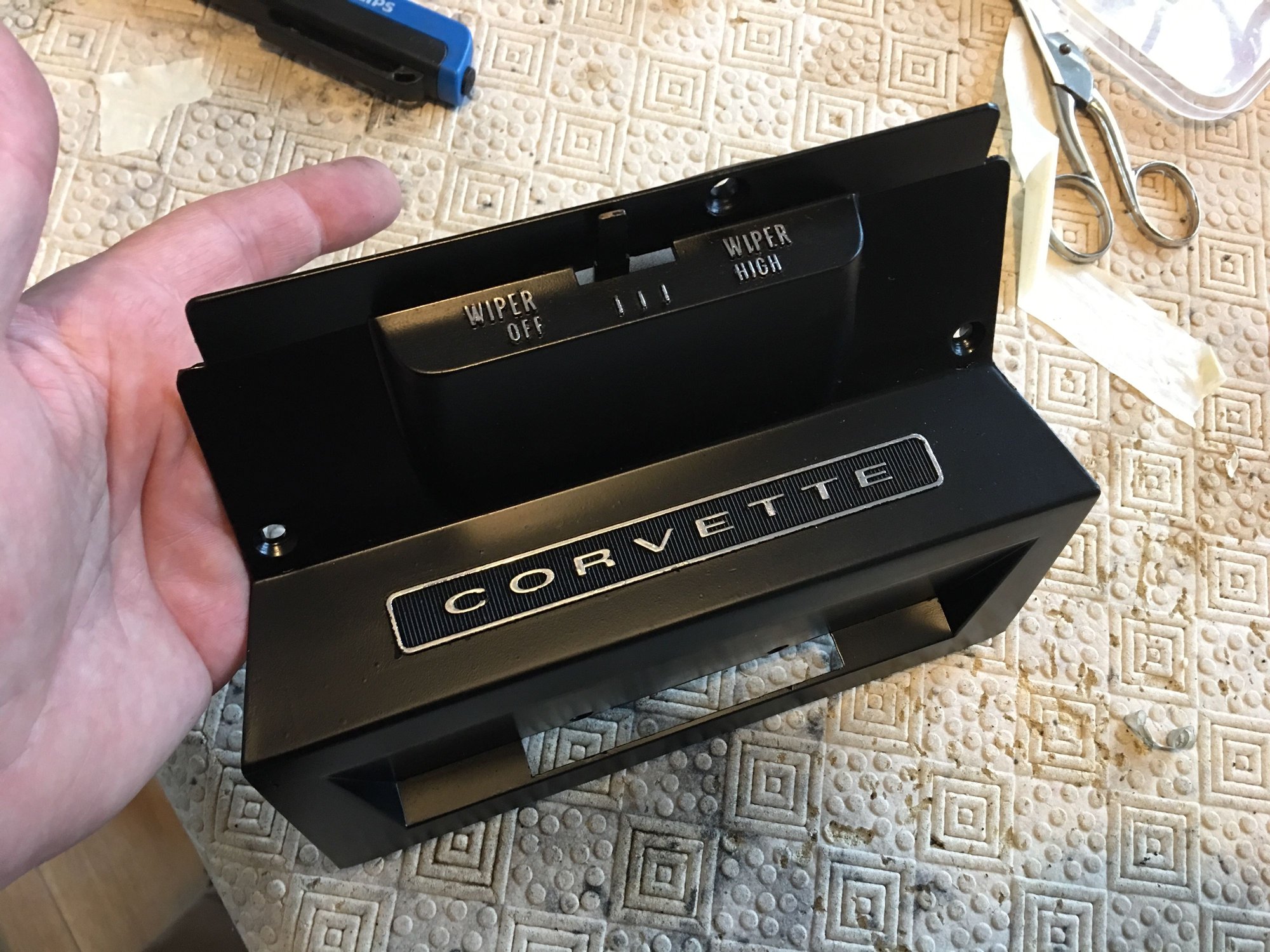

Renewing the center gauge cluster.
Sanding again...
Old Dec 31, 2018 | 04:02 PM
  #195
DorianC3's Avatar
DorianC3
Joined: Nov 2017
Posts: 2,369
Likes: 520
Ready.

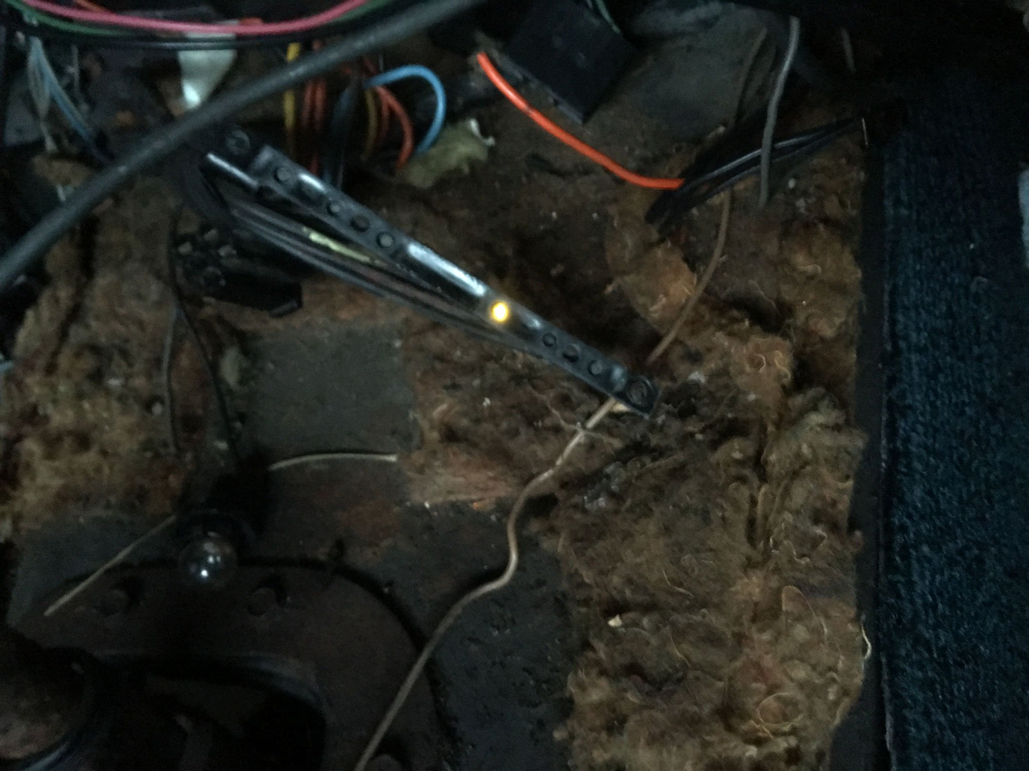

The solid core fiber optic seems to work well. Bright. The light comes through more red than it appears on the picture.
To The Force Awakens...

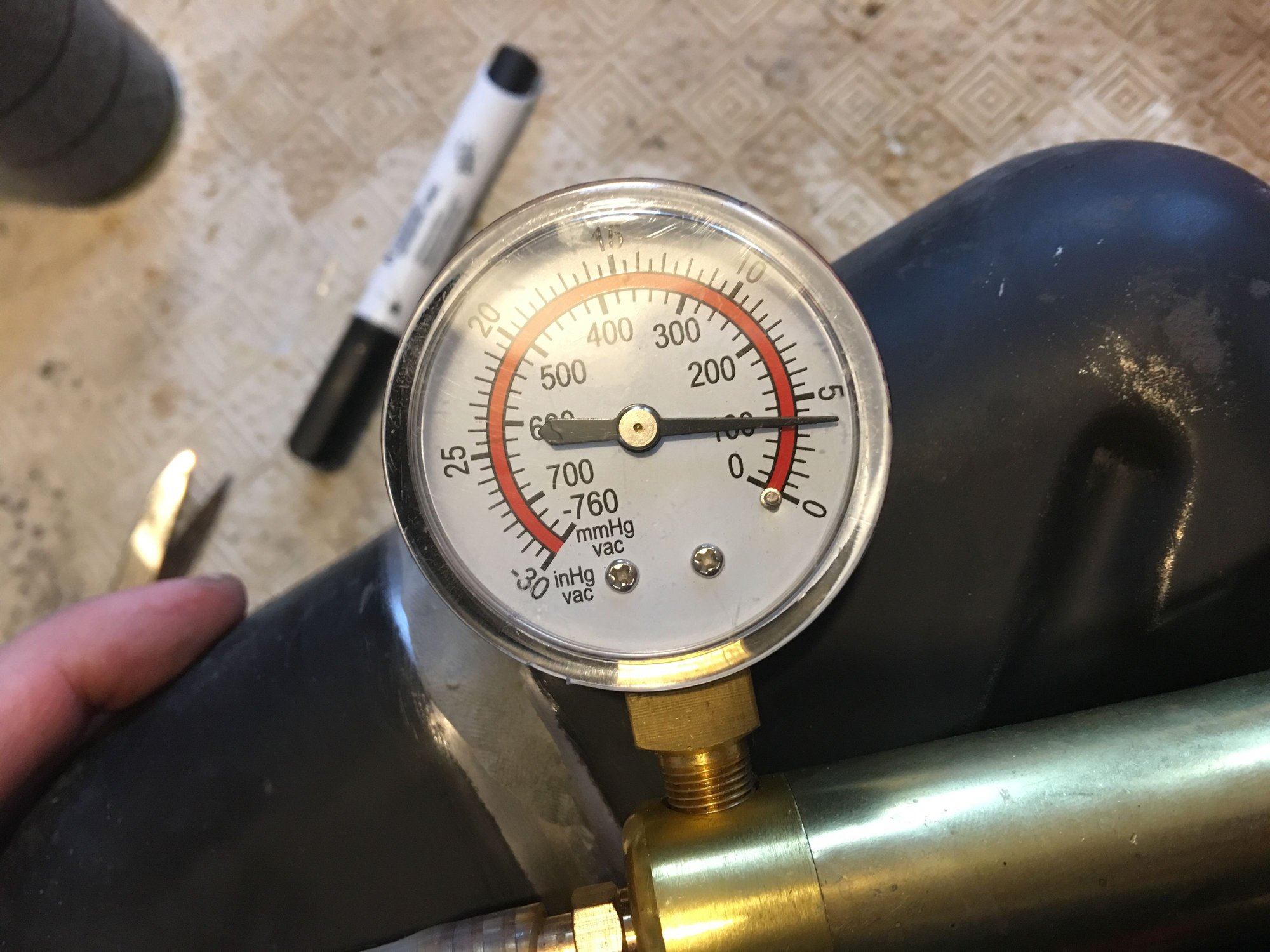

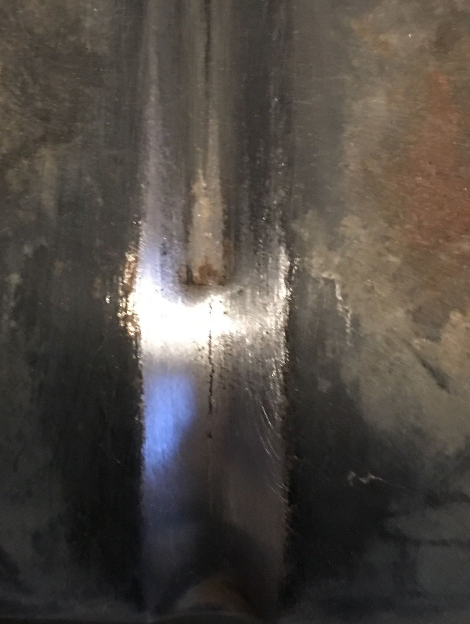

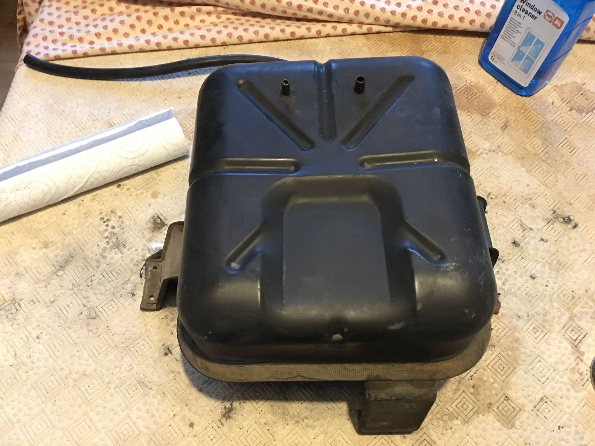

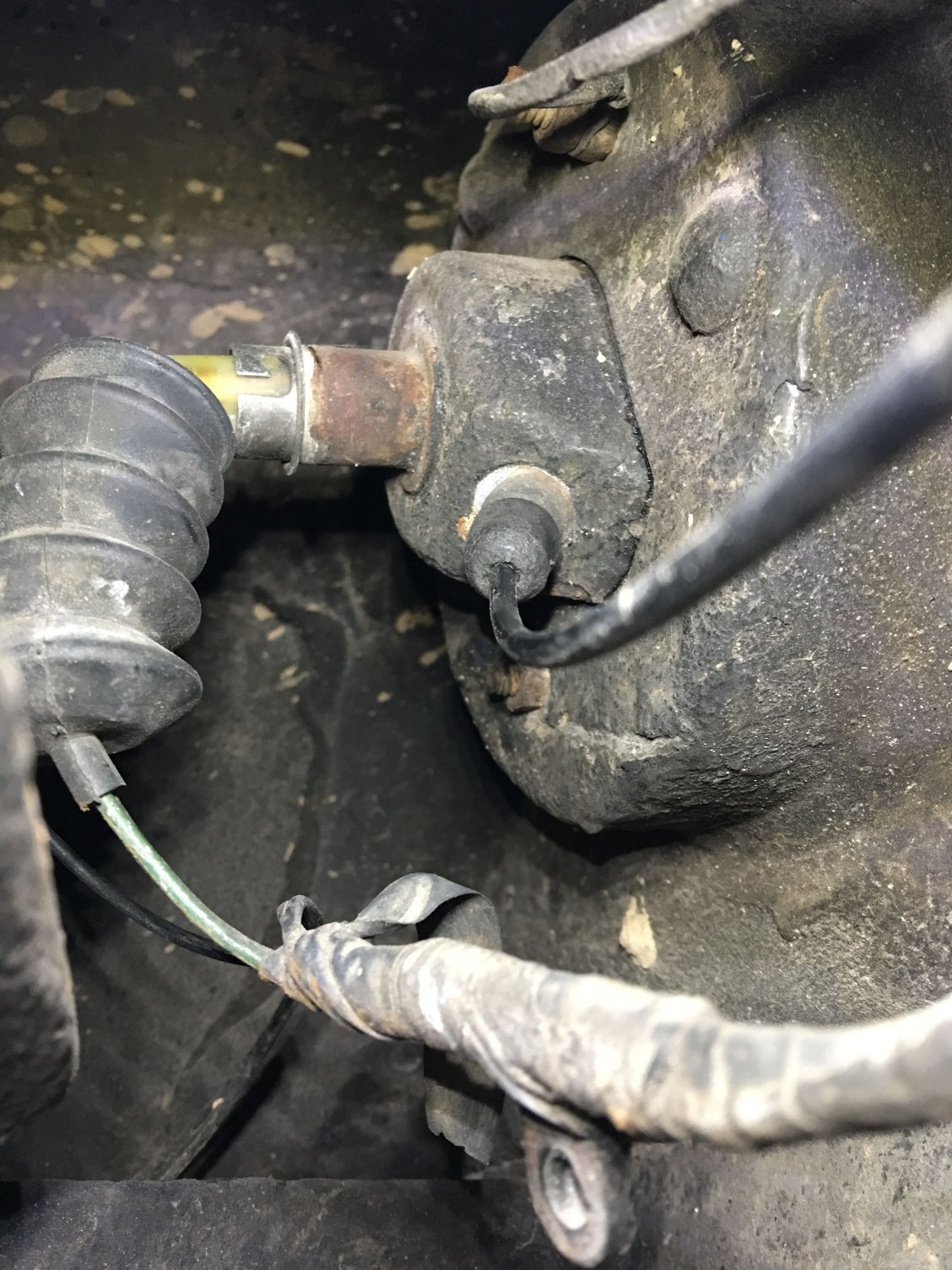

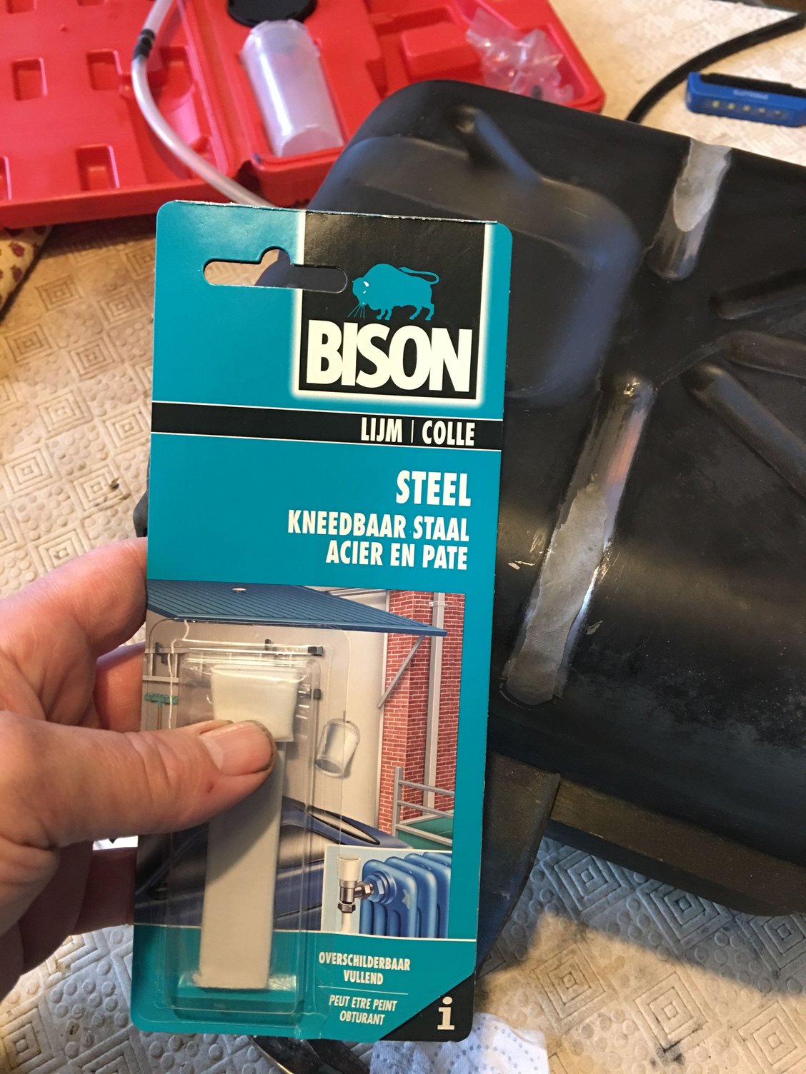

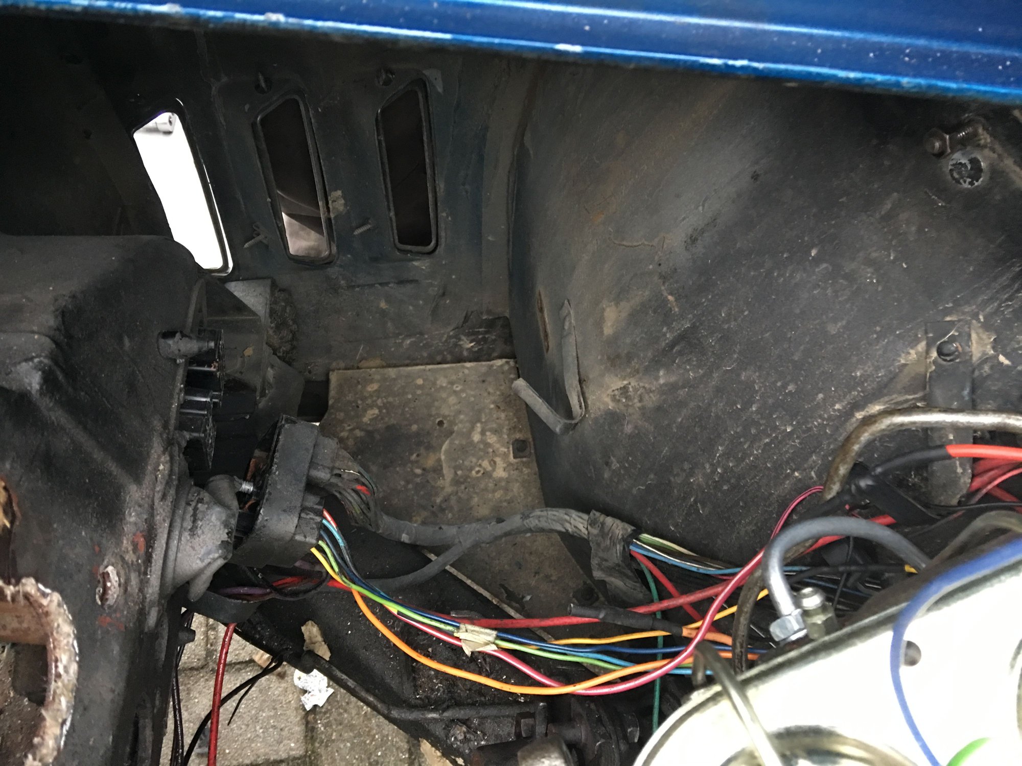

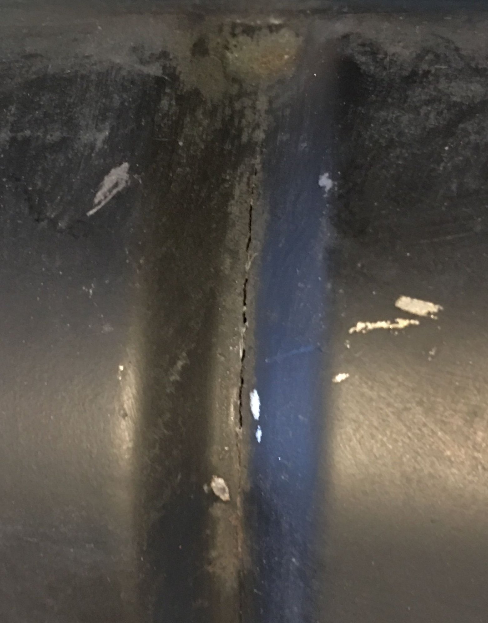

So I blew some compressed air in the vacuum tank and felt obvious leaks.
To drop the tank i needed to remove the clutch rod, brake booster, the horn relay and the harness to get it out.
The tank looks fine. Not rusted at all. It looks like it was pinched. You can see the marks. And this cracked it in three places.
This looks clean enough for me to to try to JB weld.
Old Jan 5, 2019 | 05:37 AM
  #200
DorianC3's Avatar
DorianC3
Joined: Nov 2017
Posts: 2,369
Likes: 520
I found three cracks in the tank. I bought some kneadable epoxy for steel and ‘Hail Mary-ed’ it.
I could only pull out a few inches before my hand got exhausted. The needle held for 5 minutes without budging after which I called it good. Sand and paint maybe tomorrow.
