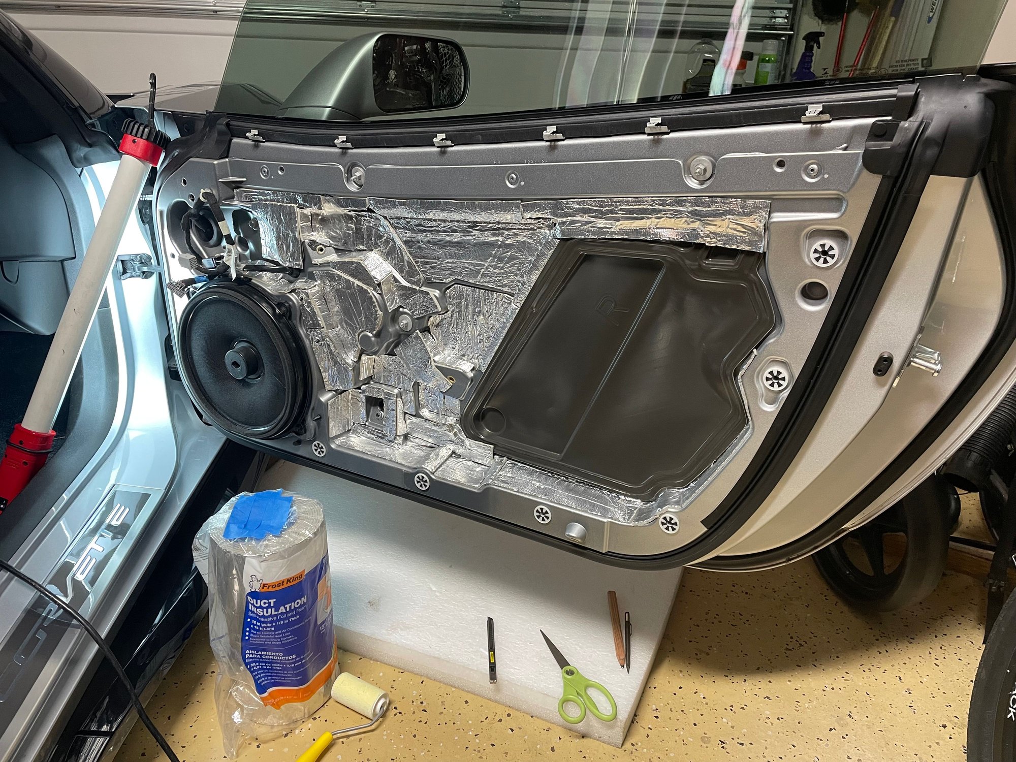

If you have a tight budget, you could go with this product. I did my entire interior with it. Not only does it reduce road noise, it's cooler in the Florida heat too! I used a 4" foam paint roller (with the foam ripped off) as an applicator. It was a fun project actually.
What's your estimated sound reduction or did you happen to message the decibel levels before and after?

I didn't measure before and after. Although, once I got everything put back together, the first time my wife went on a ride with me, she commented right away that it seemed quieter and she didn't even know I was doing this. I had it all apart doing my widebody conversion so she didn't see the sound deadening going in. I did it in stages. When I did the rear hatch area including the rear wheel wells, the road noise was greatly reduced. I think the doors were the next thing most noticeable.

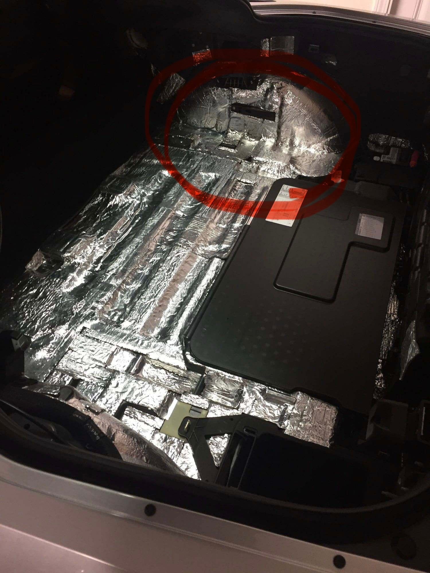

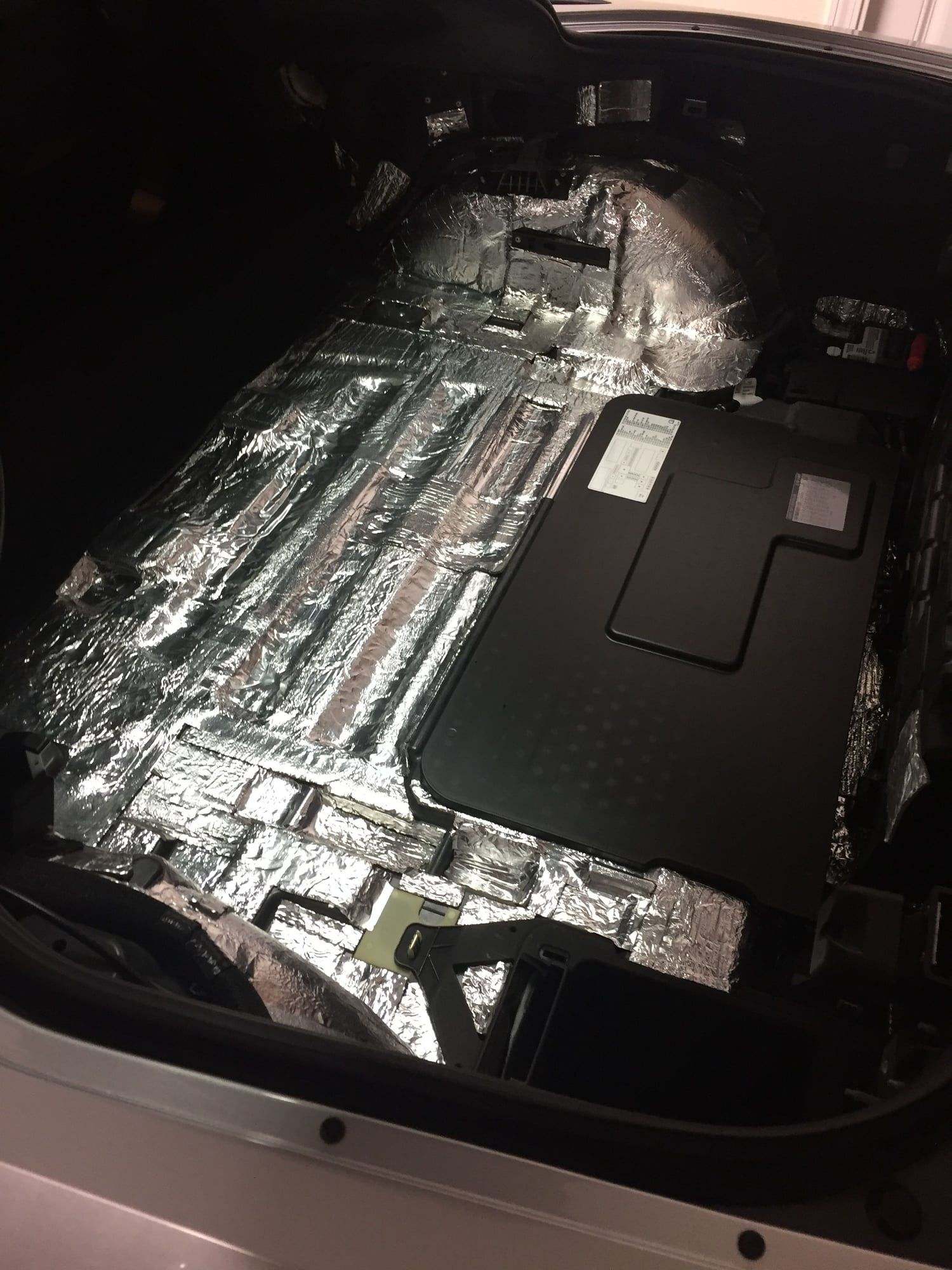

I installed some NVX 9mm butyl sound deadening recently. I put it on the floor, both sides of the tunnel, on the bulkhead behind the seats, and on the trunk floor. I did not cover the channels housing wiring, or over the metal plate in the passenger side at the firewall. My measures were made on a blacktop interstate going 70. Before was 72 DB. After was 69 DB.
a buddy who helped me said there isn’t room to place it on the outer skin of the doors because the glass is too close, and the fasteners holding the wheel wells aren’t strong enough to hold the extra weight of the sound deadener. But I’ve seen in the forum that others have placed it in doors and wheel wells. Have you had any issues in these places?
Old Dec 7, 2025 | 06:15 PM
stevettec7's Avatar
stevettec7
Joined: Jan 2015
Posts: 2,105
Likes: 949
From: Fleming Island Florida
I covered the tops (insides) of the wheel wells and inside the doors without issue.

FYI, when doing sound proofing, I’m pretty sure the elevated plate on the passenger side firewall covers either the ECM or the BCM. The space around it should not be covered as it allows airflow to cool it down. Best to cut around it and leave the gap in tact.
the shape of the roller for bonding the sound deadening to the surface looks like a wallpaper seam roller which i already had. It worked for most of the job but eventually broke. Avoid that frustration, bite the bullet and get the metal roller.
also, if you have an iPhone, there’s a free app called decibel X for taking before and after measurements.
if you’re doing the doors and have taken off the door panels, that’s a good time to install window tint. A good tint will eliminate UV and reduce IR.

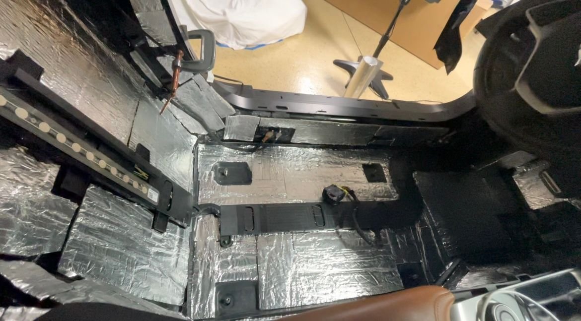

I installed the double extreme insulation kit in my 19 GS (took a long weekend for this old fart). The instructions were very helpful and the way the pieces were cut and labeled really helped. The kit cut down on the heat and noise. Good luck.
