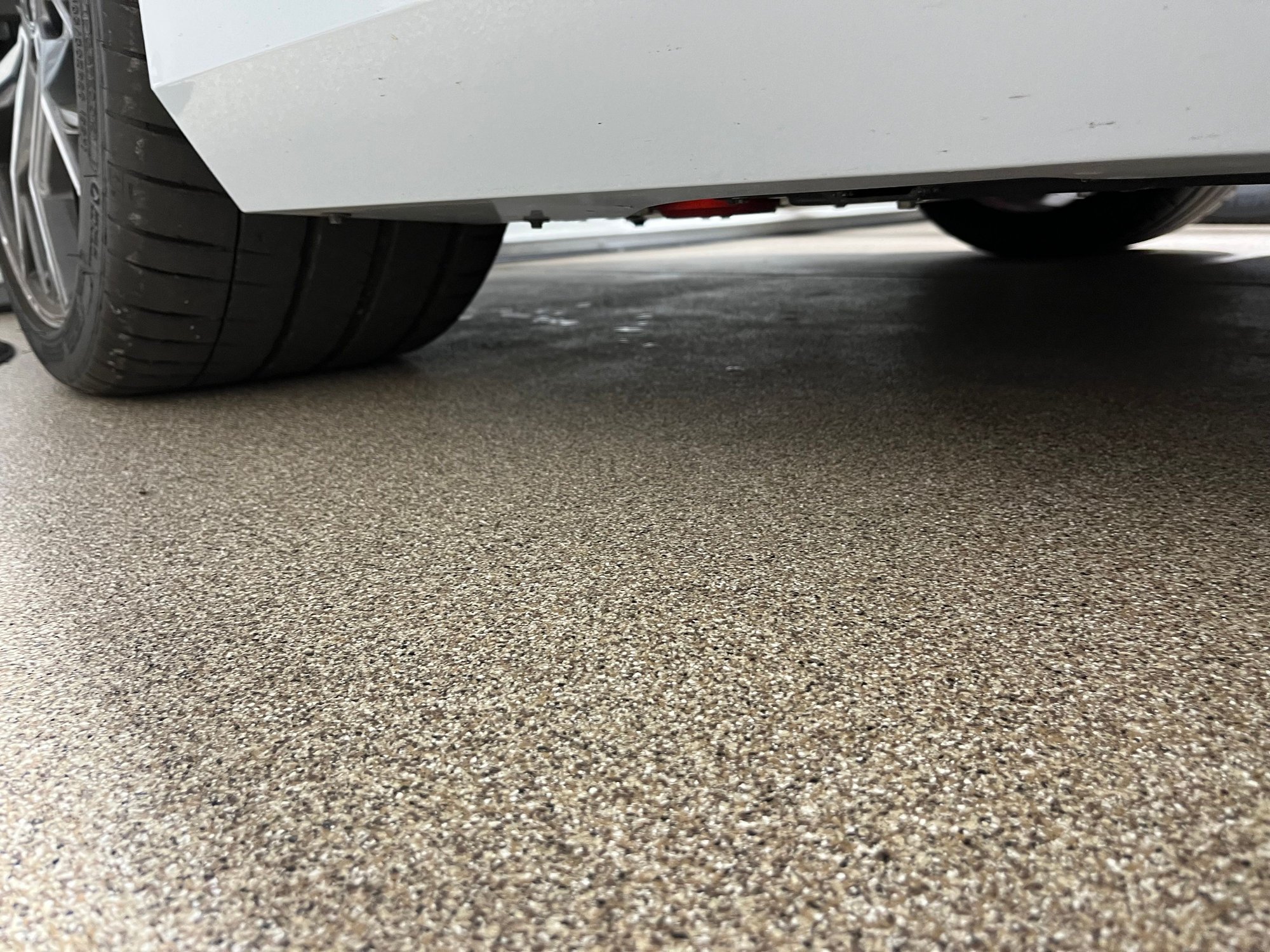

2023 CMG HTC 3LT MSRC Lift RC8 delivery on 09/13/23, now 5006 miles.
My bride noticed the pictured fluid drips (under right rear axle) on the garage floor two nights ago. I took it to Stephen Wade Chevrolet yesterday morning (the only dealer in Saint George, UT) yesterday morning around 10:30. The Service Advisor told me that, without an appointment, I was in line for their only Corvette Tech for at least a week to ten days. I replied that was a “disappointing outlook.” He responded that he would “do his best” to accelerate the timeline. I was not feeling well so I elected to leave the car at the dealership.
Much to my surprise, around 10:00 this morning the Service Advisor notified me via text that my C8 was ready for pickup. The diagnosis (after removing the”Rear Cradle Shear Plate”) was the “Transmission Fluid Filter Seal” leaking oil. The fix was replacement of the Transmission Fluid Filter (24045729), top off the Transmission Fluid (19418016) and clean up the leaked oil (also replace the Shear Plate). The warranty covered it, except my time and inconvenience.
Of course, I wish it had not happened. But, compared with the nightmare possibilities, I am a happy camper. Kudos to Stephen Wade Chevrolet and to GM for a great car.
PS, I am feeling healthier today.
Good to hear it was a simple fix, probably took very little time to correct as well.
I doubt they "replaced" the shear plate, as it's unpainted and probably not affected by DCTF in any way. Probably just wiped it off and then re-installed it.
Keep an eye on it though. It can sometimes take a while for the oil leaking to show up again and a common place for porosity related leaks is in the deep area just behind the left output shaft and it tends to run down the side of the DCT in the area of the filter. The oil on your garage floor is also on the opposite side of the car from the DCT cannister filter. Suppose it could be running along the shear plate to that area though.

In my poor description, I should have said they cleaned and replaced the Shear Plate they removed. Thank you for your advice regarding the location of the filter. Yes, I will be certain to monitor the area. I deeply appreciate your advice and the tremendous knowledge base of this forum.
