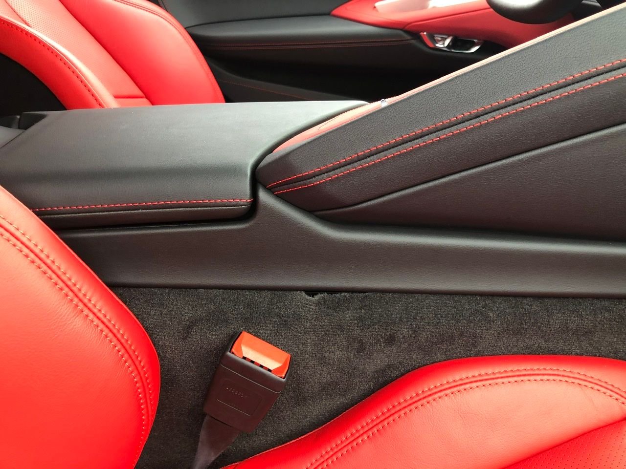

Our car has a few problems I’ll add to the list

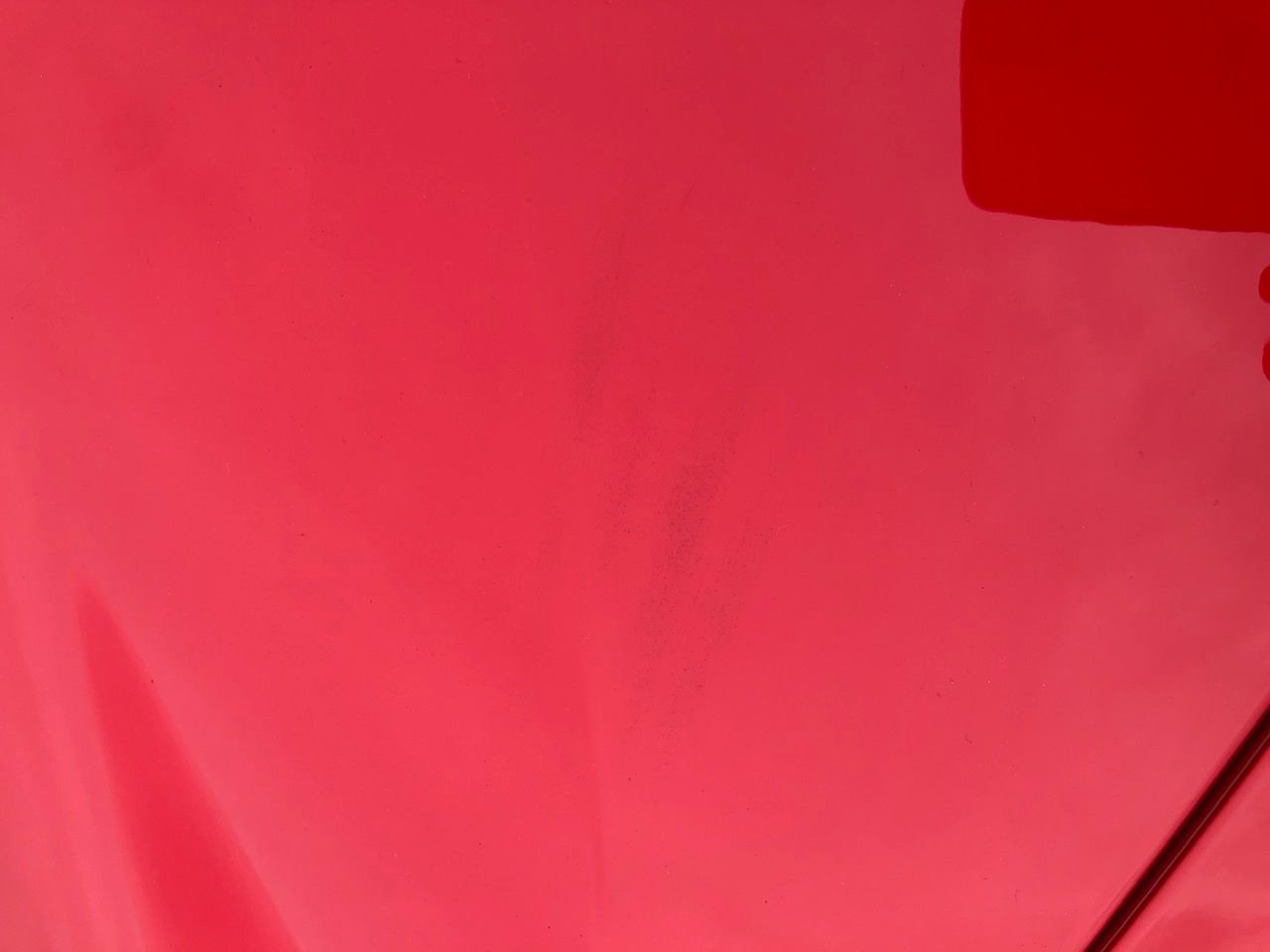

paint blem on the rear trunk drivers side below the window like previously reported on other cars Ncm
detailer gave it a quick rub but it did not disappear. Looks to be in the paint

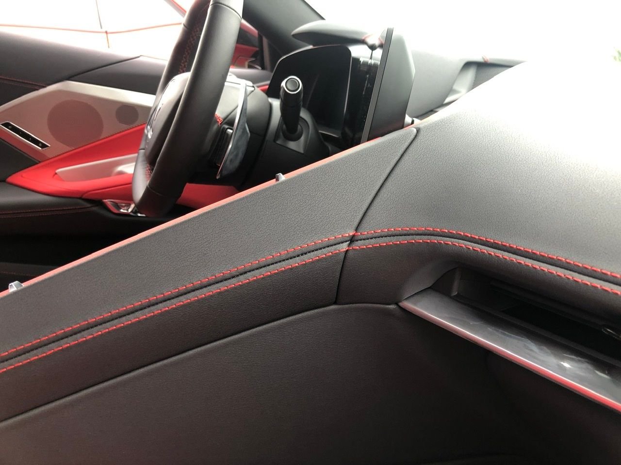

passenger carpet trim panel, looks like someone pried it open.
I got the rear axle system off error but it has not reappeared lately.
also when you guys accelerate from a stop like using launch control do you hear a clunk as it shifts? My first thought are my lug nuts loose? Really noticeable with the windows down. Does not sound like a shift actuation.
Stitching is okay but not awesome. Has some wave on the front part, but not as bad as I have seen
That clunk is the clutch engaging.

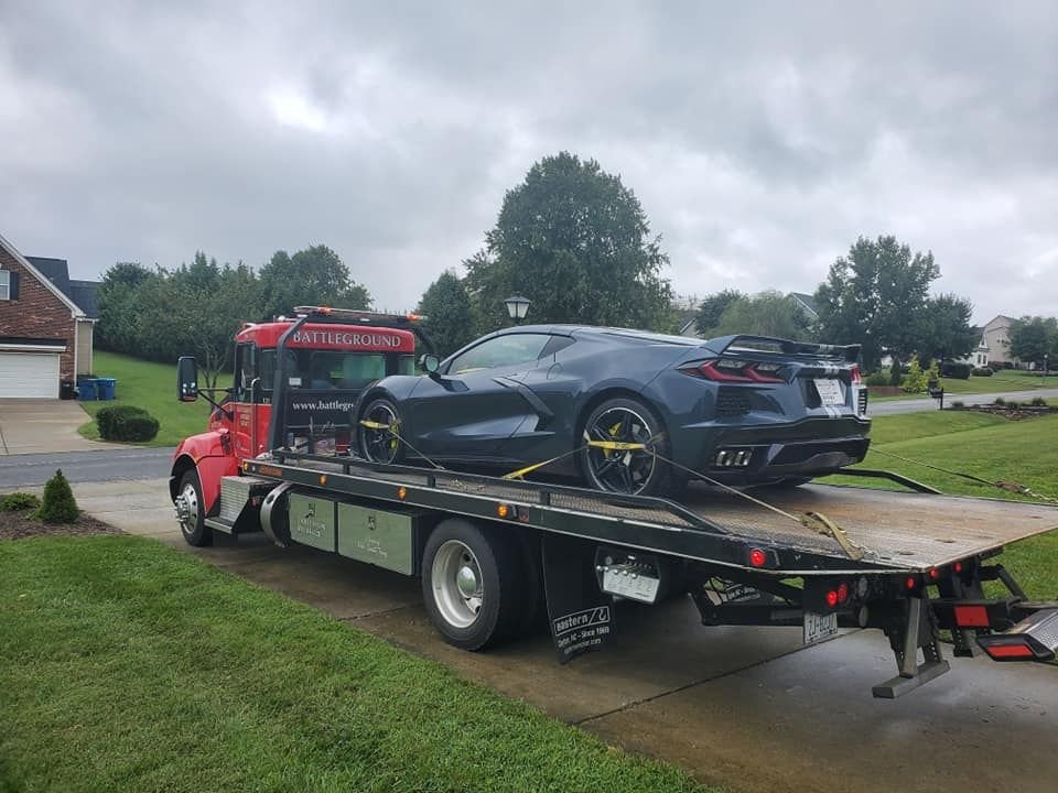

Found this one on another forum this morning...
Wife and I took delivery on Friday. We drove the car for a short drive then parked it in the garage with a total of 72 miles. That's correct....72 miles in total.
On Saturday morning (9/12/2020) I went to start the vehicle and left it idle for around 5 to 10 minutes. It was at this time the engine began to bog down with an erratic idle... like the car wanted to stall. I put the car in reverse to see if it was just a rough idle and that is when several indicators became apparent including a check engine, check transmission and check emissions alerts were sent.
I immediately called the dealer and they sent a flatbed.
Seems like GM is adamant that the tranny doesn't need the extra two quarts of fluid. But I'm also seeing a lot of people who are paying to add the two extra quarts. In one case someone had tranny problems and the dealership fixed the error codes by adding the additional fluid. I've also heard a lot of comments that the trannys are not being filled correctly from the factory. If this is true wouldn't the addition of two extra quarts of fluid be money in the bank for GM? If not the extra two quarts won't hurt anything. Kinda of like chicken soup.

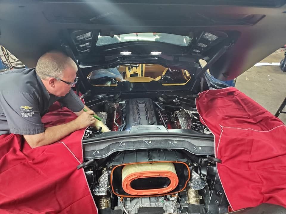

Great looking vette!! Hopefully soon it will be as much fun at it looks.
Is the trans oil fill behind/under that intake air filter?

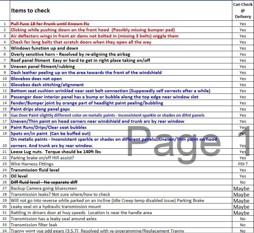

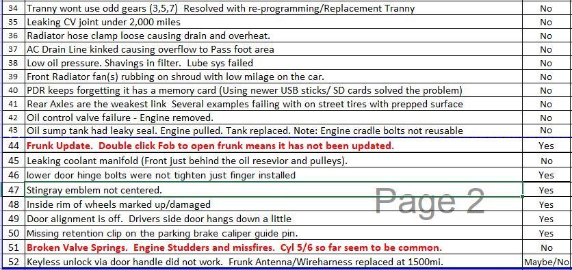

Now that we are back up to full steam and many people are taking delivery I thought I would post the updated checklist. The Excel is in a printable format for landscape orientation.
I could have missed a couple, but I think I have captured the lions share of reported problems that I've seen.
Item 52 - I would count mime at 7 miles (day-of-delivery mileage) when it happened - I just took my car in at 1500 miles when they finally received parts, but things escalated quick! But surely there are other electrical issues in other cars as I learned from another dealer today.
@MaxV UPDATE ITEM #52: Car was finally fixed. Based on their investigation, somewhere along the production when harness, connector and antenna came together -- the two connector pins got crimped and touched, shorting the antenna, and the frunk lamp and frunk ejector button panel. Master tech wanted to pigtail the connector in, but GM engineers wanted to hard-wire the as repair -- there's no space inside the frunk liner, so they settled on pigtail. Four items were replaced: antenna, wiring harness, connector, and frunk lamp/ejector button panel. Total repair and consultation time: four days. The magic of locking the car by just walking away will not get old!
Also got an oil change, car ran much smoother!
