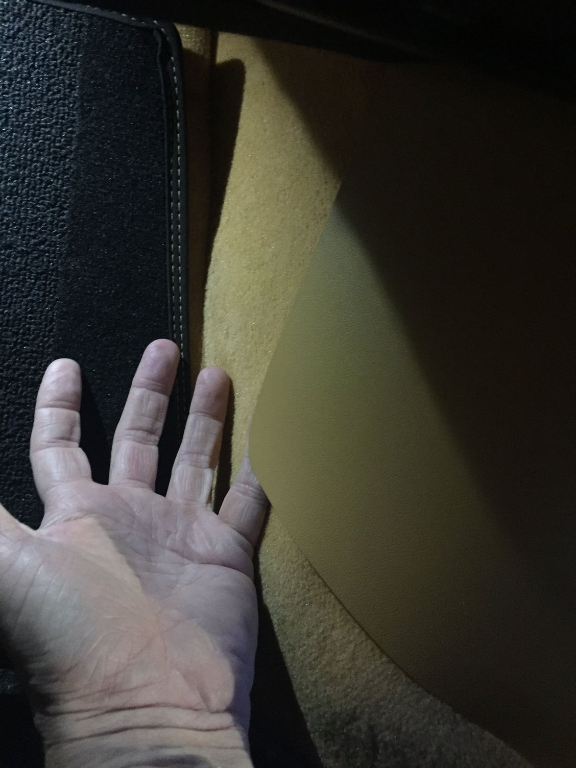

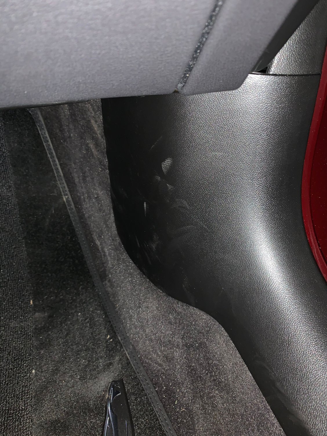

Default Passenger Foot Well Plastic Mouldig
Originally Posted by DebRedZR1
Making a sticky
Can anyone comment on whether the plastic moulding in right corner of passenger foot area is supposed to be anchored? Mine seems to extend over the carpet with slight opening that catches shoe if I’m not careful.

Mine is even with carpet.
Use a heat gun with a piece of aluminum foil behind it against the carpet to soften it up and bend it in or pull off the panel to do the same.

Small gap on mine about the room for a pinky

Ours is also about a pinky wide.
I see foot scuff marks are not unique to us. To avoid permanent damage, we have covered the vulnerable area with inexpensive vinyl with peel-back adhesive on one side.
